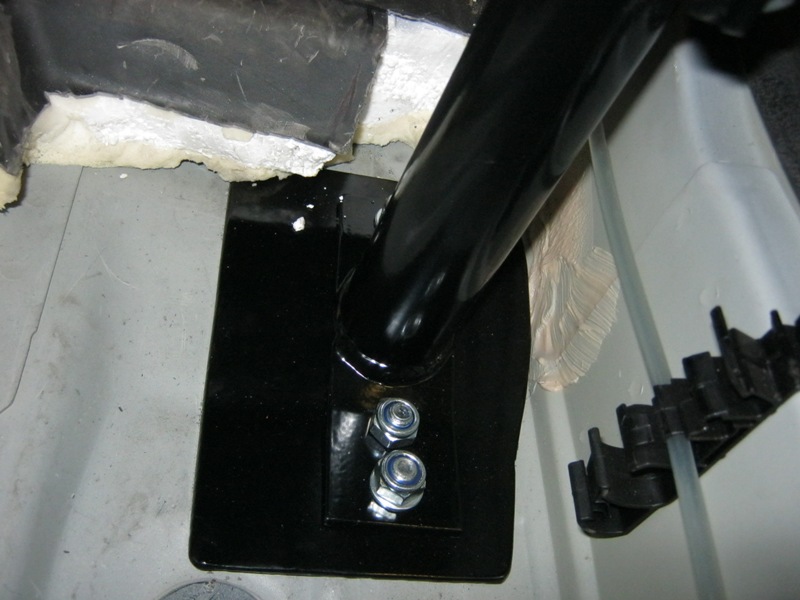

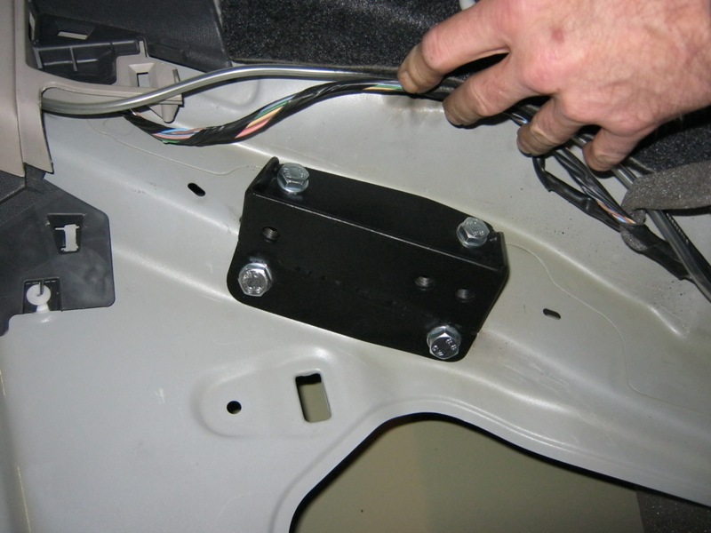

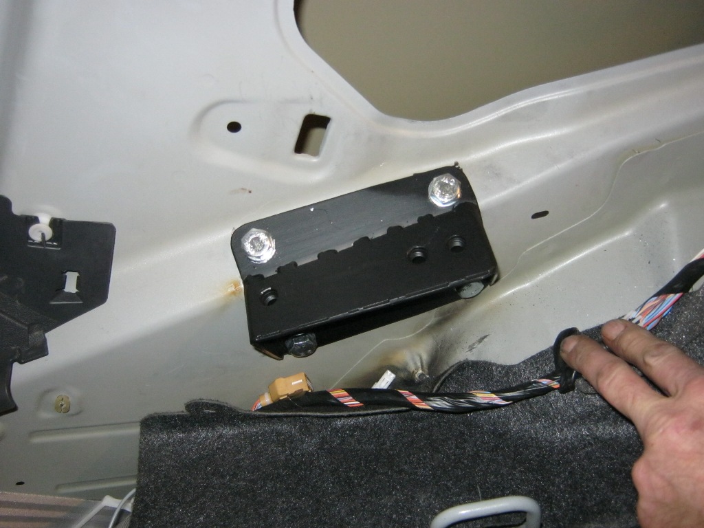

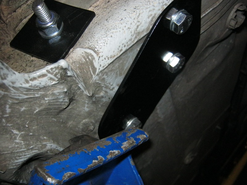

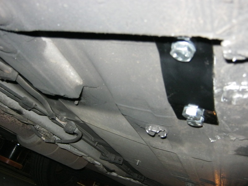

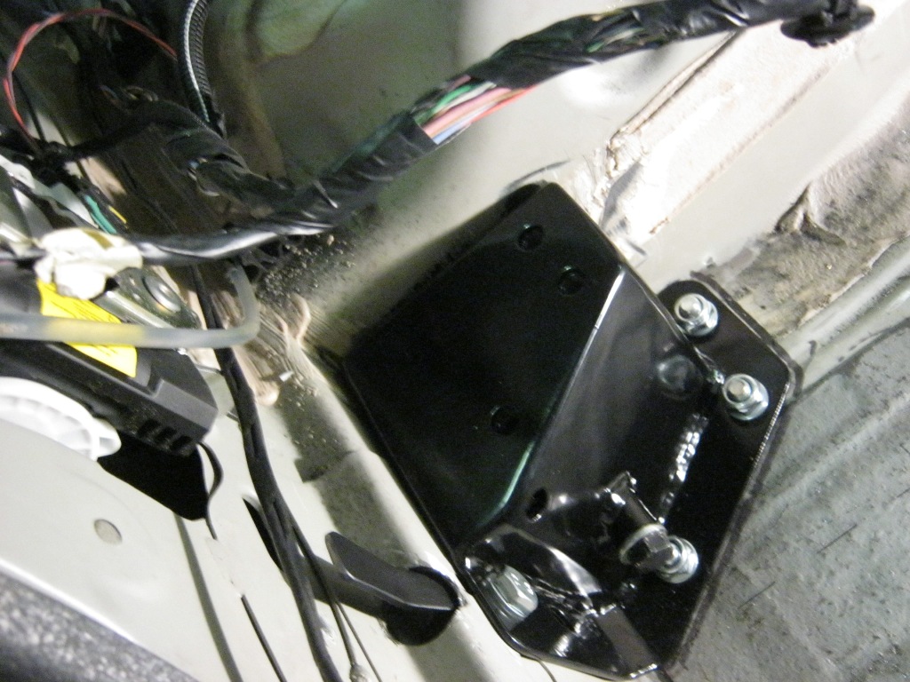

I’m looking for rear or full cage for my ly 200 . must be bolt in , its for road use , I fancy the k tec bolt in rear with diagonal but does anyone do a full bolt in cage ? Safety devices ? I don’t mind drilling a few holes , but welding in is not an option ! If full cage it must clear dash , advice on options and fitting much appreciated , cheers kev. Anyone have one for sale ?

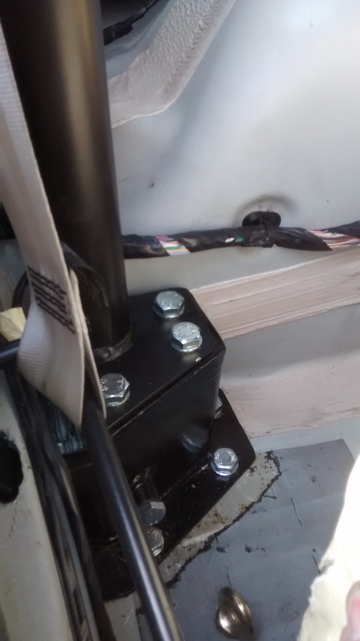

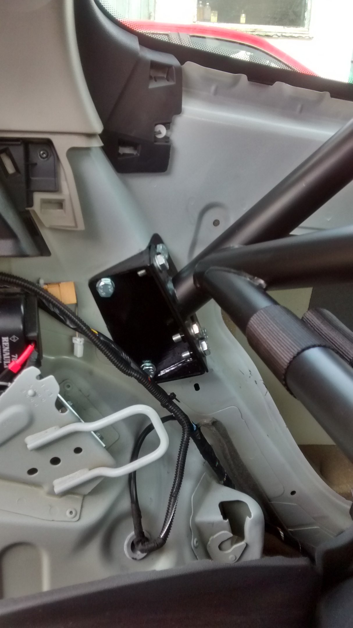

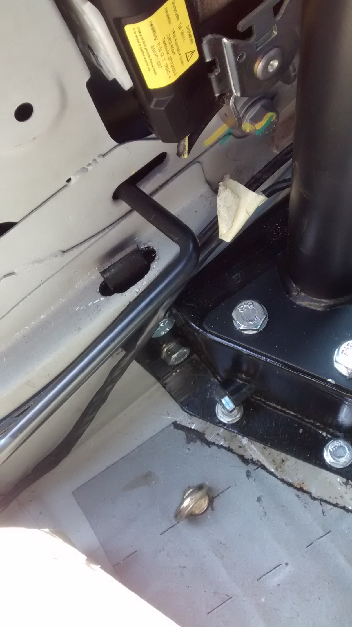

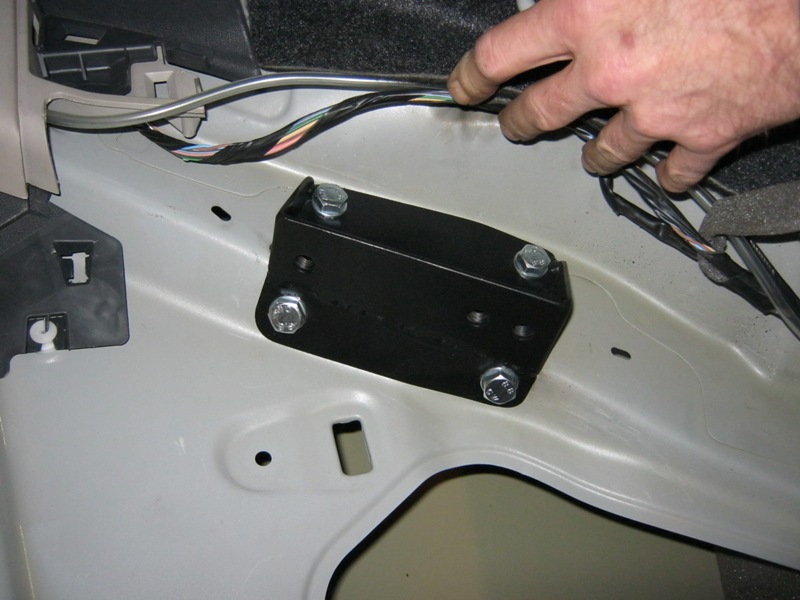

Yes that is the norm but SD designed this one so it could just be bolted it, you still have to drill the floor
Never knew that, all bolt in cages I have seen have had welded plates in
Hello M.C
I thought you would like to see some photos of how this cage is fitted as it might help.
Regards
Graham
