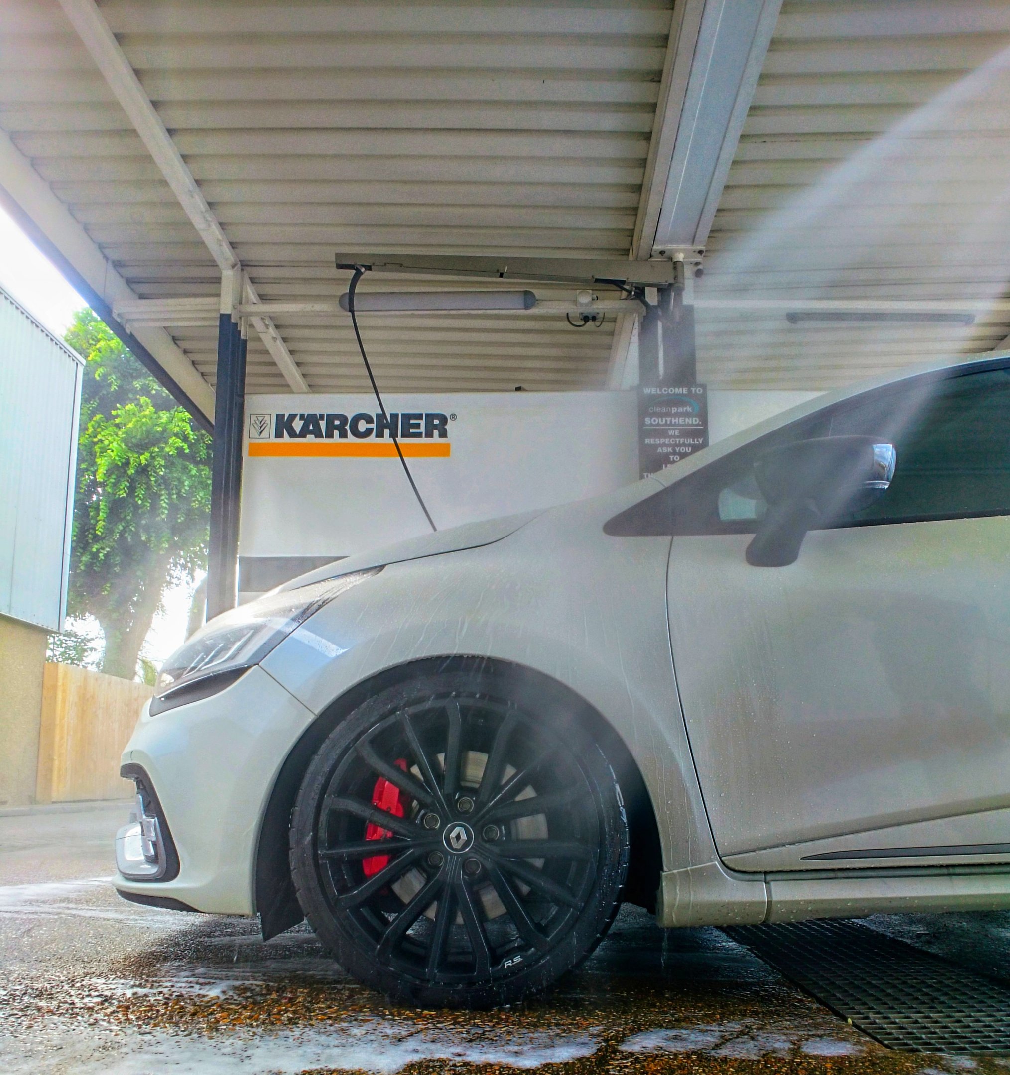

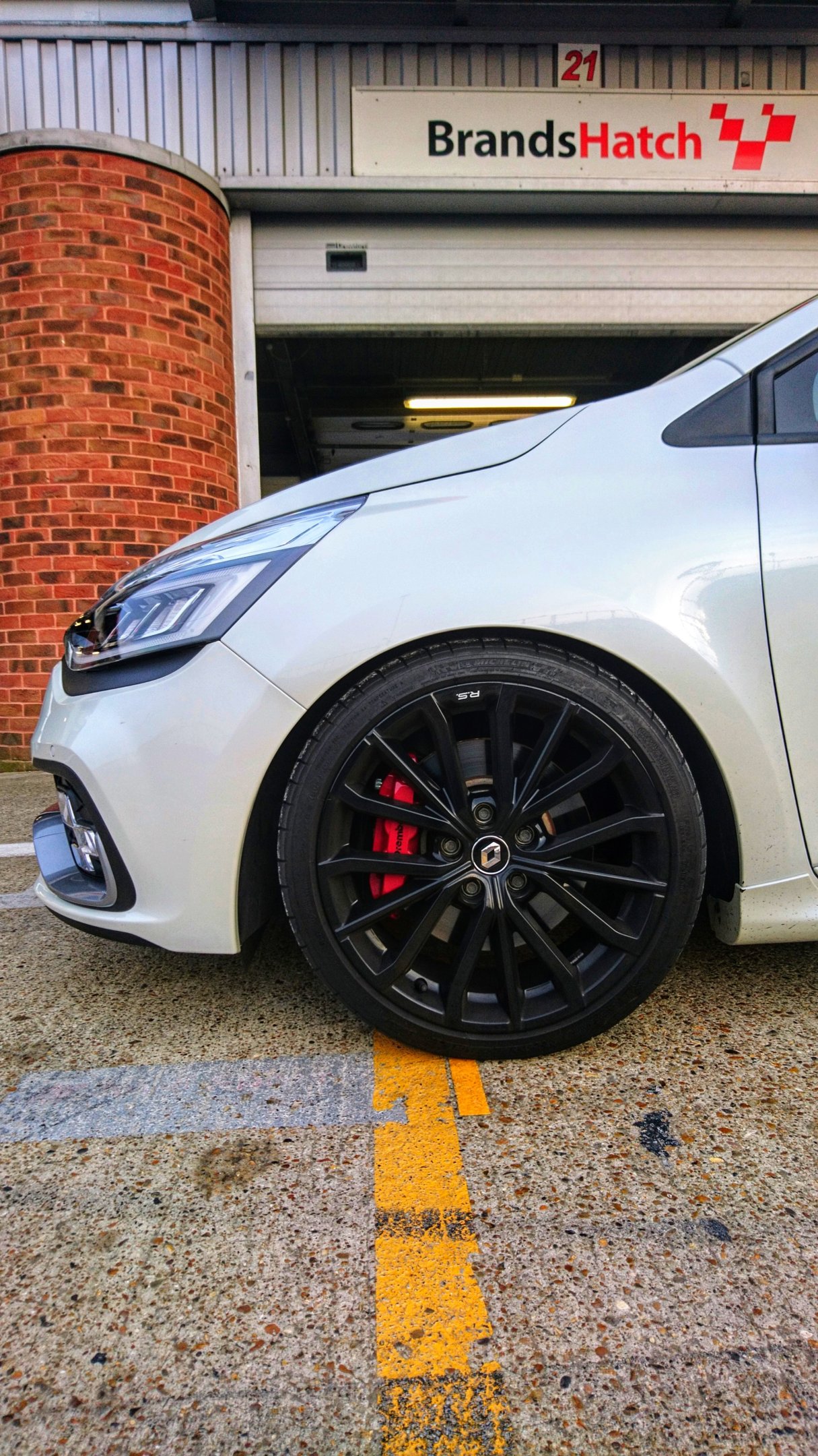

To make the 4 pots work
R26 calipers (Red to match OE)
PMS 4 pot bracket kit
Brake hoses from PMS sold separately
Brake pads, I'm using OE R26 brake pads
Have to use min 16mm spacers to clear the wheels
I bought Mr Pink pins as they're better than OE pad retaining pins
Motul 600 RBF brake fluid
Use the OE 320mm discs
Its about, give or take a couple of quid £600 for everything mentioned.
I bought the calipers 2nd hand in decent nick,
Bracket kit and brake hoses from PMS.
Brake pads from Renault.
Mr Pink pins from Turborenault
Motul 600 RBF fluid from Kam Racing
Pad retaining brackets 2nd hand freebie
