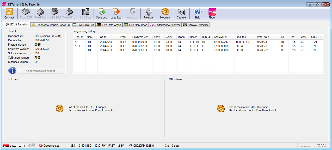

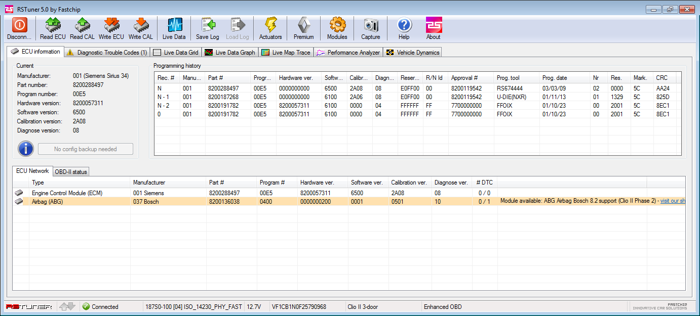

Henk sent me some new ECU software to install before ron98 map.
my software is 6100-****
He sent
8200-7208
Now from what I have read this will break the ECU if I write on it.
Did Henk send me the incorrect version? He said I need to update it to this so I can use the new map.
I don't want to do it and have a dead ecu.
And having to wait till Monday will piss me off.
thanks

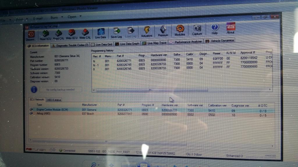

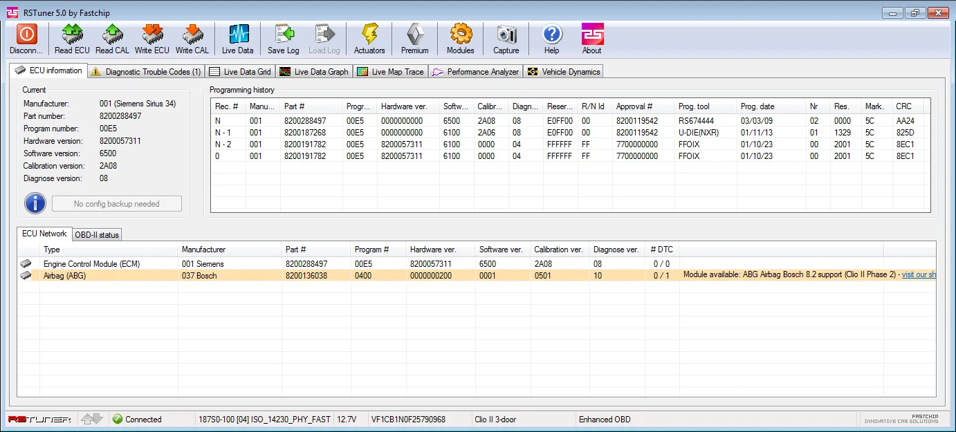

I got the software wrong its this one:
So mine is 7300-****
  Mazda3 2.2D 185BHP
I havent saved the Cal file yet.
I will do that in a moment though.

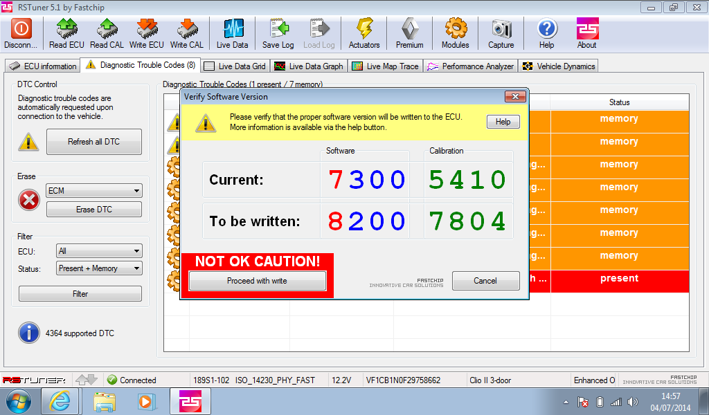

And yes i can also send you a screen shot of the Write ECU screen that shows its NOT ok to proceed if thats what your after.
Give me 30 mins and i will be back with the above.

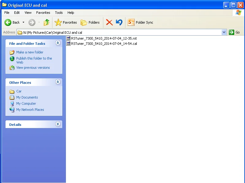

Ok here is a bunch of stuff. Too much info is good :)

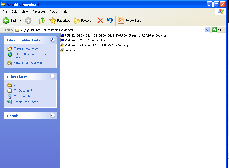

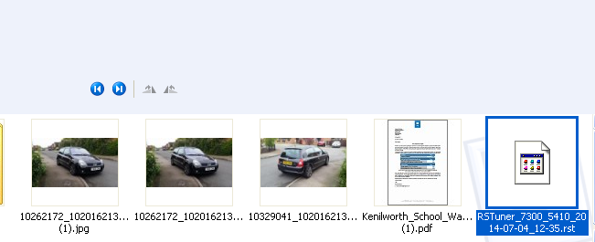

Here is the Original RST and Cal file names:

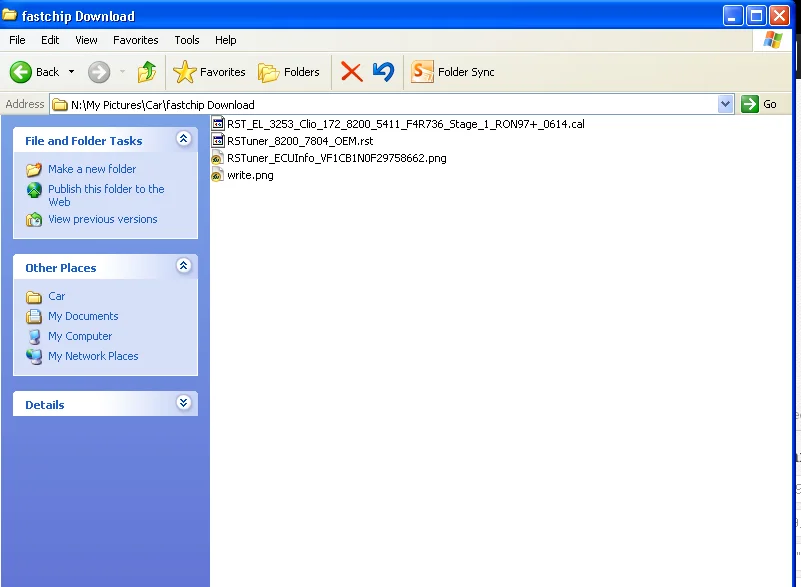

here is the New Ones from Henk:
this is what it says when i try to write:
As you can see the Filename of the Cal is for a 172. Which is odd.
Is this helpfull?

Personally id make sure you have backups of original data then go ahead and write them (rst first)

Whats odd is the new cal is useing the same version software as the new Rst yet is also named as a 172

Well Tbh i just said
"Hi
As i understand it from reading the help file, If it says its NOT OK then its the wrong software.
Did you send the incorrect software as i read that this one is for the 182.
If you did then im not too happy as your closed till monday and i wanted to get this done this weekend.
Please let me know asap"
Wasn't too rude. Plus i did point out HIS help guide does state that if its the wrong version its NOT correct.
So sending out the wrong version number to customers even if its correct is silly :/
If he does decide that he doesn't want to help i will just get a refund by paypal. Simple

is it very bad idea to try and write this 8200 file on it? What will happen if its incorrect? Will it accept a reflash using the backup? After all it is simply a computer with flash able memory lol
MartinR
  Mazda3 2.2D 185BHP
I would say so, yes. Just be patient it's not worth ruining your ecu!
Edit: Wait, 2004 172? It may have the ecu from a 182 with it being one of the last in production!
That could be the reason why he sent that File then.. Mabey Renault used a 182 ECu and stuck the 172 firmware on it :? As his Cal file is for a 172 but has the 8200 firmware number

You sent me a screenshot with 7300 software and not 6100-****. Based on that information I sent you the correct version.
  Mazda3 2.2D 185BHP
Yup you did.
Thanks for the fast reply to the email mate.
I can proceed with no worries now!
