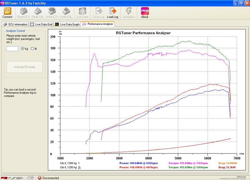

Well as per the group buy that’s just taken place on AngelWorks Matched inlets I decided I would try and be scientific and get a Performance graph comparison from my RSTuner.
Current Mods:
K-Tec Stealth
RSTuner 98Ron Remap
Espace V6 Airbox
What I’ve added to the car is:
AW Matched inlets
PTFE Gaskets
Cold air feed to grill under headlight
I wanted the performance analyser results to be as accurate as possible so I calculated the total weight with me and a full tank of fuel in the car to be roughly 1200Kg.
(Though the weight will affect the total power and torque figures calculated by RSTuner, providing I do before and after runs with the car at the same weight then the comparison should be reasonably accurate)
I did the before run this morning with the outside temperature at 12C and the after run this evening when air temperature was the same. I used a flat smooth piece of road and there was almost no wind today which improves the accuracy of the results.
Before I had got the graph from the RSTuner I could tell the inlets had made a big difference. Power and torque delivery was much smoother and torque was much more plentiful throughout the range.
Here’s the before and after graph.
Pink/Blue - Before
Green/Red - After
Though the figures produced may not be accurate (I think there are a tad optimistic) the results serve there purpose as a comparrison.
As you can see there are massive improvements throughout the rev range and the torque curve has smoothed out quite nicely. (Ignore the random peak that RStuner has produced at the begining of the 'before' performance run).
My inlets were quite bad but the improvements have amazed me and I would definately recommend this modification to anybody, even more so if you have a PH1. Very happy!! :D

interesting to see the graphs. matched inlets made a huge difference to my car so definetely worth doing.
  340i
Good gains there...
There was a definite improvement after fitting the AWT inlet/plenum on my PH-1 smoooooothed out the power delivery no end :D
  PH1 172 Sport
Peak BHP:
Before - 146 BHP
After - 158 BHP
Thats at the wheels so I think the actual figures may be a bit optimistic!

Caister, can You check Your Live data logs (previous and current) , and tell us the Air inlet temp. ?? Mine is about 35-40 degrees celsius on stock air feeds. I wonder how big the difference is with PTFE Gaskets.
  PH1 172 Sport
Before was: 44C
After was: 28C
This was after a half hour drive and temps were not going up.
Before was: 44C
After was: 28C
These airtemp differences make it very worthwhile , i know for example my car runs far better on colder days then warmer days.
How is the durability on these gaskets ? I mean does anybody know if they for example will start to perish/leak after a while in comparison to OEM gaskets ?
