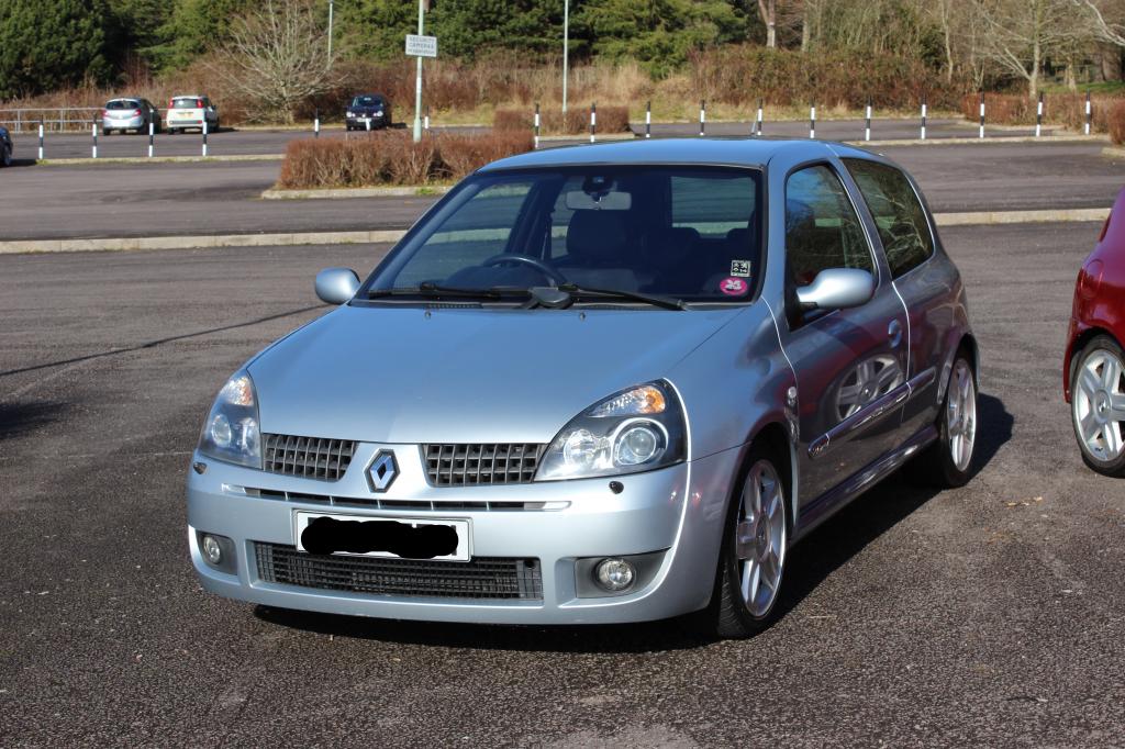

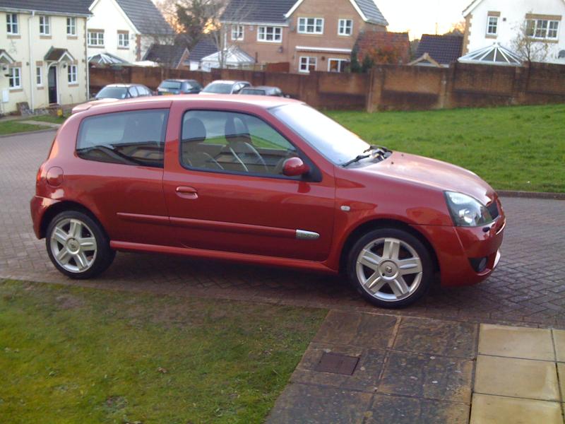

bought it 2 weeks ago its an 04 plate 172 with 57k on the clock overall fairly good but needed a really good clean and polish and lots of little bits as im fairly ocd with cars
heres what it started off like:
bought it on a sunday evening so it sat on the drive for a week before i could even start messing with it :(

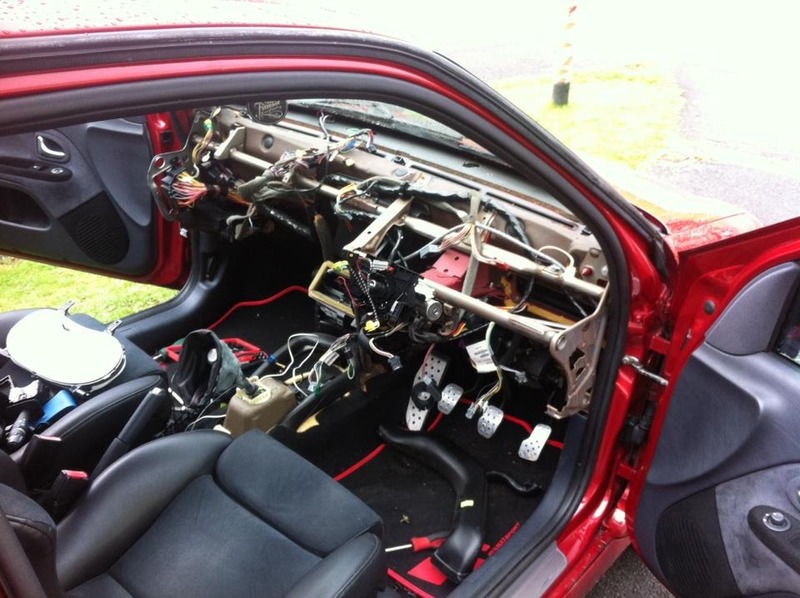

second day i stripped the whole interior out and scrubbed and cleaned it all up.
it now looked like this :)
starting to look good now :)

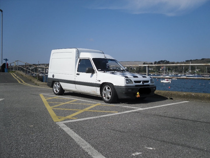

renault extra van

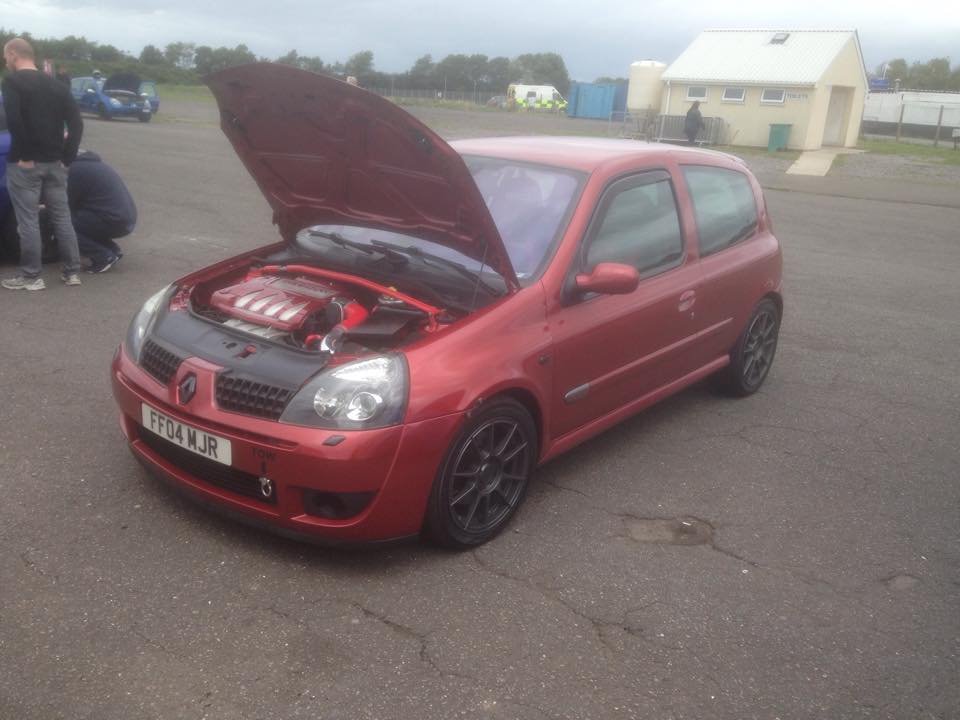

got some more work done on the 172 now its on the road :smile:
got a non repairable puncture the first day i drove it and found the spare was a bit ropey so whacked 2 new pirelli pzeros on to match the 2 already on there had these on my old gti 180 and found them pretty good.
then did the following:
fitted my painted engine cover
fitted eibach sportlines
fitted alloy aerial (is more pink than red so have ordered a short black one lol)
fitted silvatec bulbs
complete service including all the gearbox oil, coolant, pas fluid, brake fluid etc just got the auxillery belt left to do
painted my front diamond satin grey (still got the back to do)
swapped the kenwood headunit out of my beemer before i sold it
fitted the storm motorwerks alloy 12v blanker from my beemer
sold my beemer friday night so had a little shopping spree have ordered:
fabia splitter
carbon washer blanks
wind deflectors
new boot badge
new aerial to replace the stupid pink not red one i bought
powerflex dogbone bushes
also treated the missus's 172 to some new mats, silvatec bulbs and some carbon wiper blanks which should be here next week and finally fitted the eibach sportlines i bought her for xmas so im in the good books for now :smiley:
gave them both a wash this morning to and we went for a drive in the sun and took a few photos :smile:

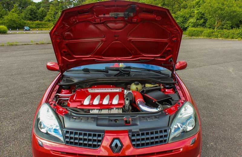

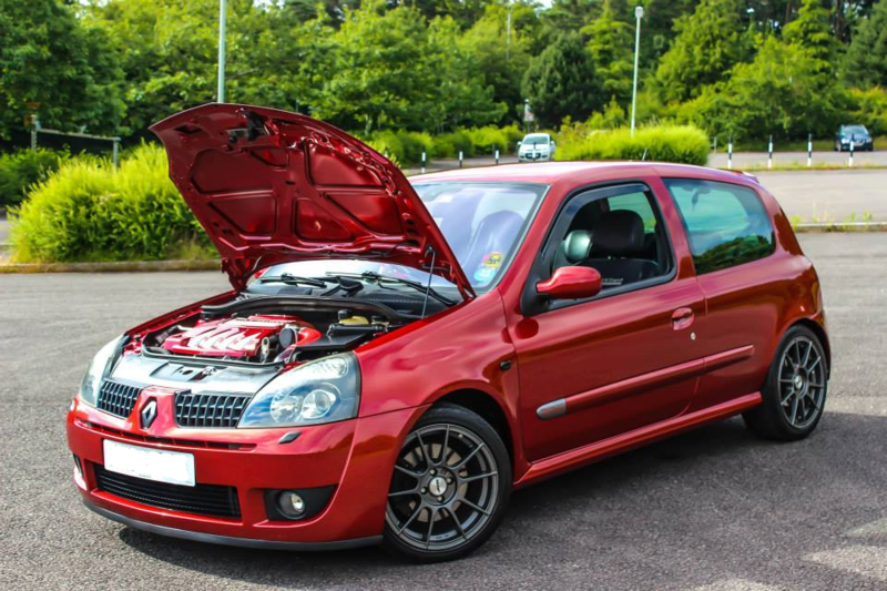

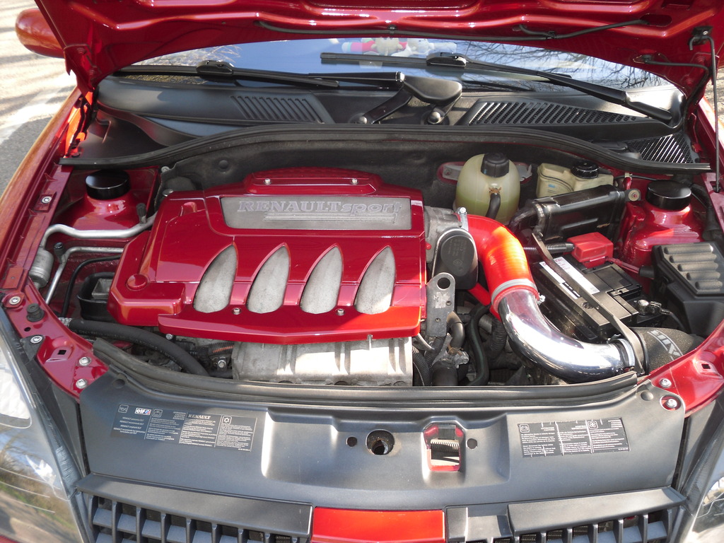

did a bit more to the bay
redid the induction kit with a red silicone bend and silicone breather pipe and mini filter
fitted some black strut top caps and alloy engine bay bolts from dan @ m.a.d.

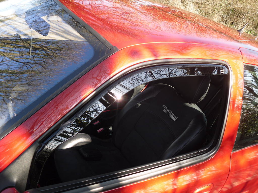

fitted the wind deflectors, carbon wiper blanks and fabia splitter

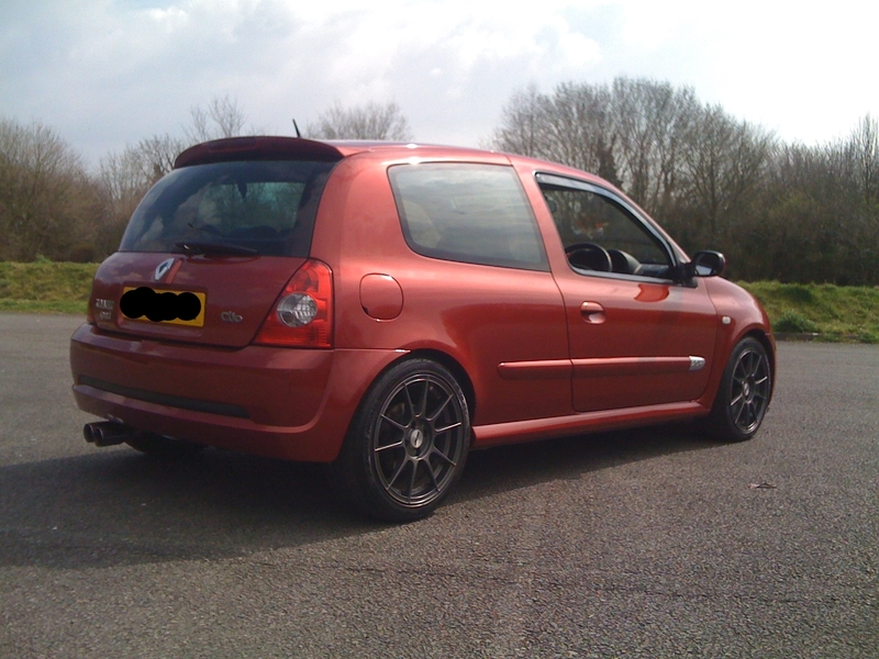

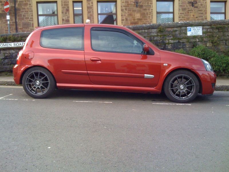

finally got my new wheels on :smile:

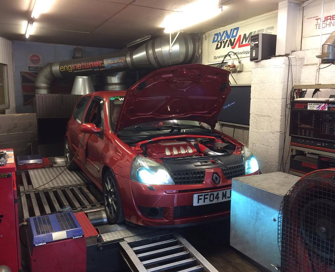

also popped down to a local rolling road meet last weekend to see what its putting out. despite being terrified it was either gonna blow up of fall off the rollers (we've all seen those videos lol) it put out a rather respectable 177.1bhp which im pretty chuffed with.

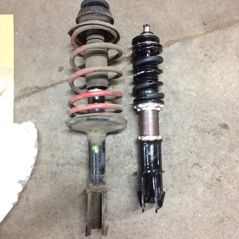

got some 182 cup rear shocks coming this week and need to swap one of the old 172 wheels with the bent one in the spare aswell
gonna get some 172 cup front shocks shortly too and debating weather to go for solid top mounts too or weather they will be too harsh for my 50 mile a day comute on countryside roads or not??

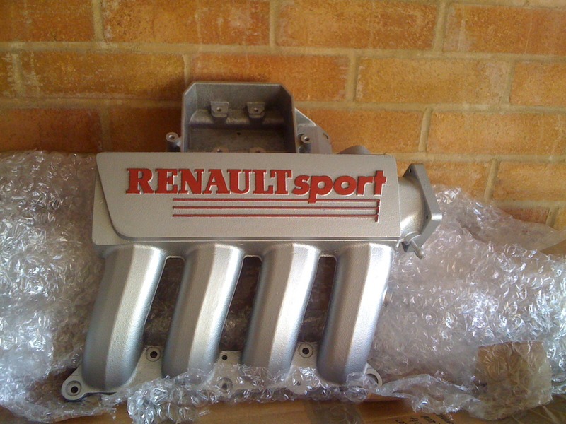

finished my inlet manifold off just need to get an rs lower one to widen the ports on now.

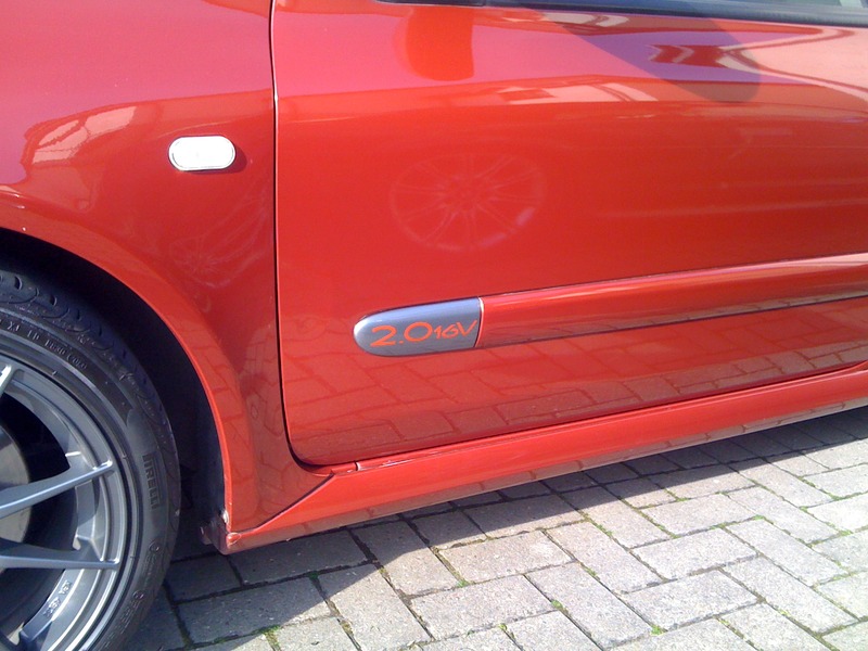

smoked side repeaters
grey sprayshack bullets with flame red 2.0 16v

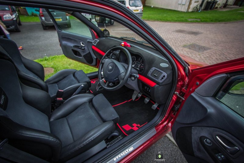

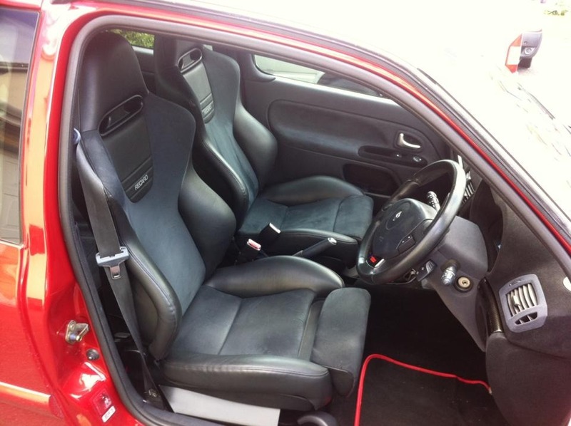

Been going a bit mad on the interior recently :p
full black flocked dash
red flocked dash strips
various anthracite flocked trim parts
carbon dipped dial surround and switch panels
recaro trophy trendlines
richbrook gearknob
black leather gaitor with red stitching
have black flocked boot lid trim, rear speaker covers and fusebox lid on their way.
also dewipered the rear with carbon blank :)

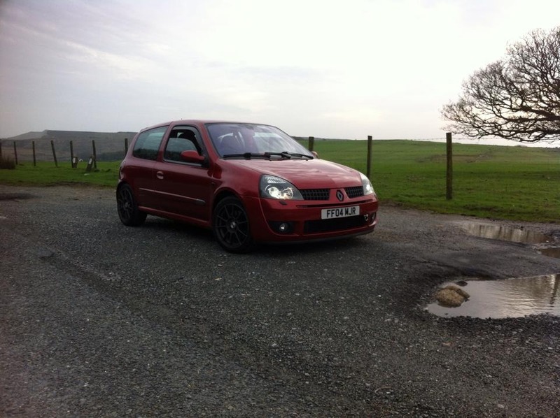

havnt updated this for a long time so thought id share my progress :smile:
first of all did the loooong roadtrip upto pfc expo show at donnington with the other half and her 172 aswell

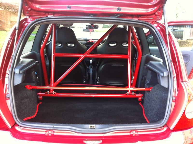

this gave me a bit more inspiration to carry on with the project so have done the following since:

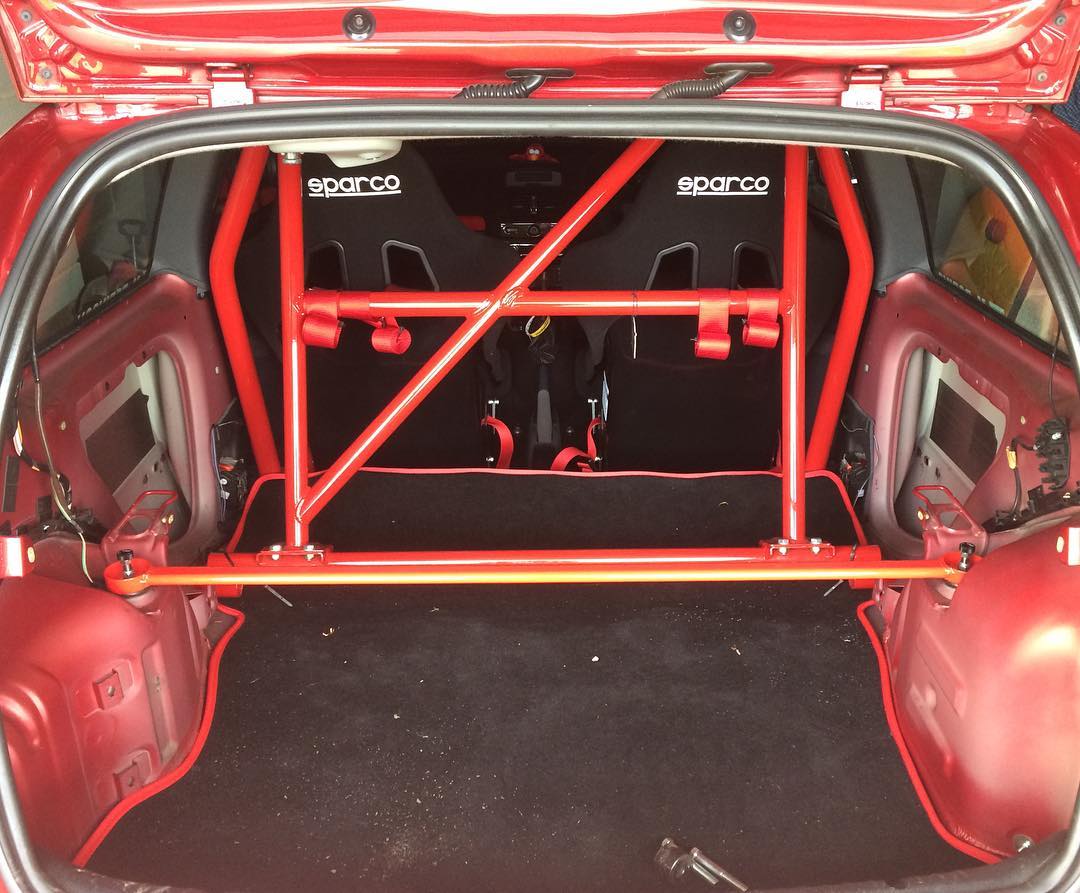

removed rear seats and belts
fitted full length boot carpet in black with red edging
had my inside boot panel and rear speaker covers flocked in black
fitted a red rear strut brace
fitted a bolt in half roll cage
had my steering wheel redone by snappy in black with red stitiching and top marker
had cruise control buttons carbon dipped and red decals done
the other half kindly bought me a dashcam for my birthday (lots of idiot drivers on my commute to work)
got my private plate on inc a 3/4 front plate
fitted a stainless front tow eye
removed the rear wiper and fitted a carbon blanking plate
fitted powerflex upper engine mount insert

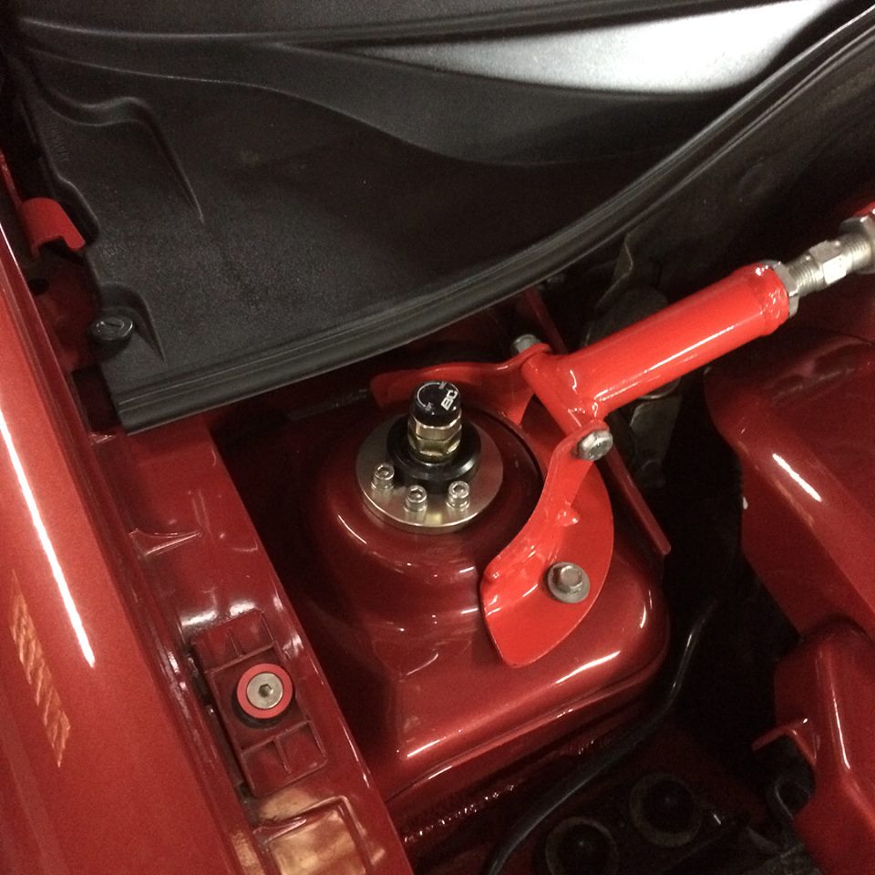

fitted an omp front strut brace
swapped my alloy strut covers with the other halfs black plastic ones so they dont foul the strut brace
fitted a bailey stainless header tank
fitted a full set of red silicone coolant hoses
fitted some nice new led sidelight bulbs
also had the whole rear quarter panel on the o/s, and the rear bumper completely redone as they were letting the car down. also had my boot button done and they touched in some small chips on the ends of the doors from clumsy previous owners.
maintance wise its ran like a dream :smile: my milltek rear mount started to break away so chopped that off and welded it on better and moved it slightly so the tailpipes sit up nicely under the bumper. also had to replace the heater matrix which is a ballache of a job anyway but even more so when i only had the dash out 6 weeks before to change it for the flocked one!!!
also got some aerocatches to fit when im brave enough and picking up a whiteline rear arb next weekend :smile:
anyway enough waffling heres some pictures

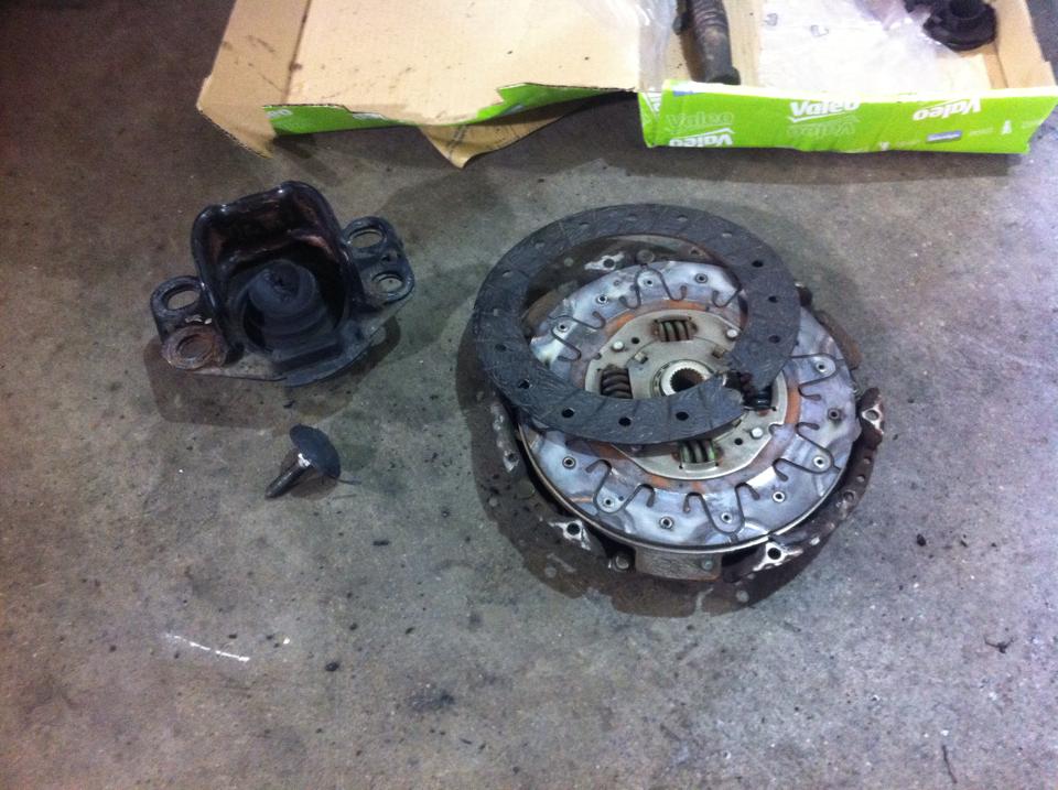

had a great time on track until this happened!
to be fair the clutch had been stiff for a while and i think the added stress of driving on track was the end of it.
although i was clearly extremely slow and nervous i really enjoyed it and this started a expensive journey into turning the car into a more track orientated car.
the car was currently still my daily and i was going on holiday the day after fcs so this left me in a bit of a predicament.
i had the car recovered by the aa back to my parents house and i got this from my sister as temporary transport.

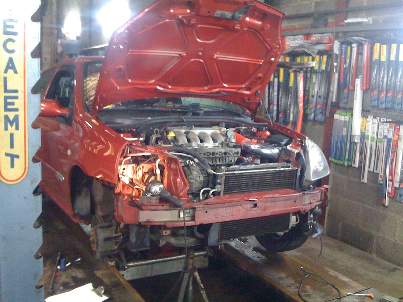

the car then had quite a bit of work carried out now i didnt have to rush to get it back ino everyday use
i finally fitted my aero catches, a new clutch assembly, new engine and gearbox mounts, 4 new injectors

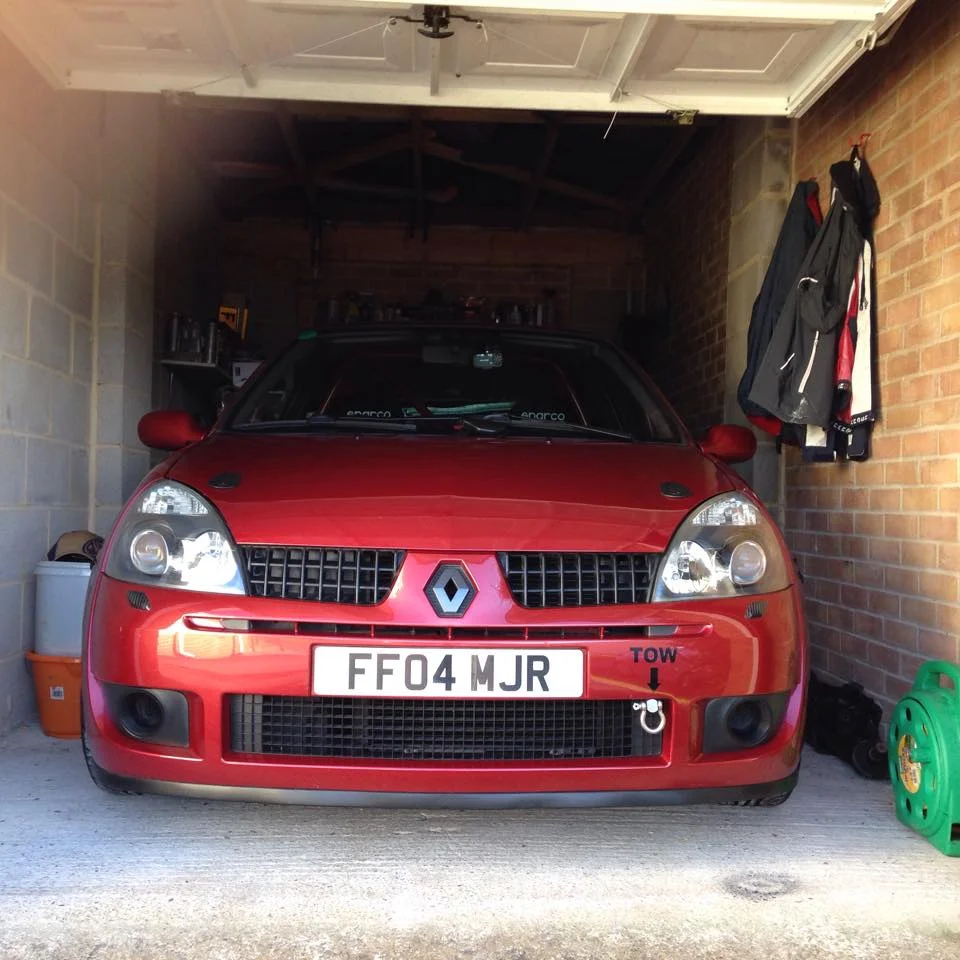

i then finally cleared my garage out so i could squeeze the red clio in

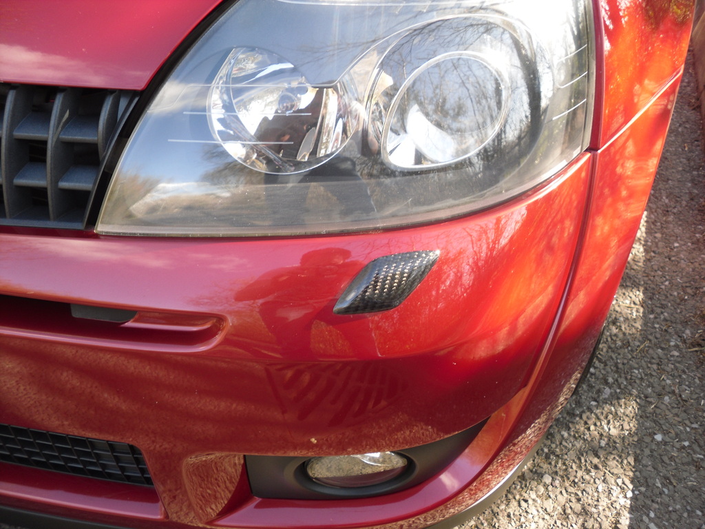

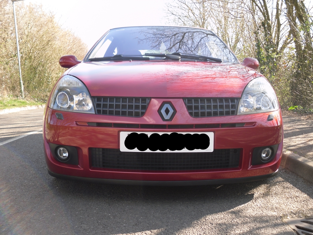

i finally finished my headlight intake

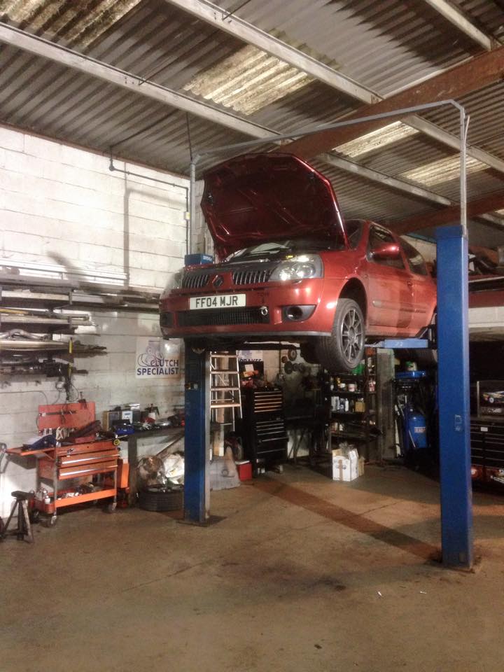

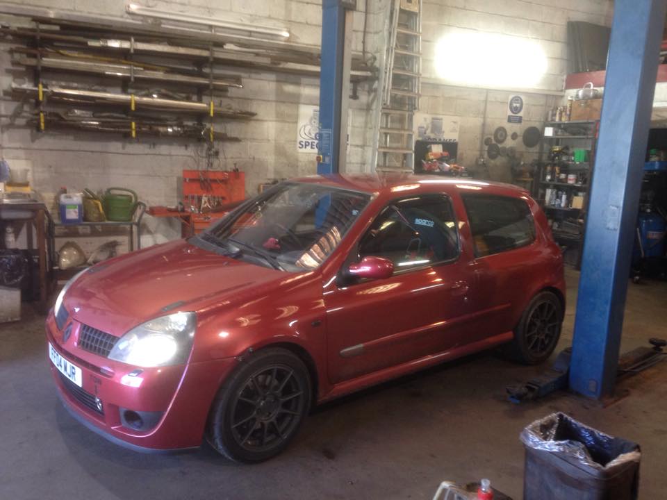

got the car back in the workshop turns out the sarting issue was the terminal 50 wire on the start wasnt making a good connection so fitted a new connector along with replacing a split cv boot ready for its mot. i also finally fitted my cup racer tow eye which had been sitting in the garage for months

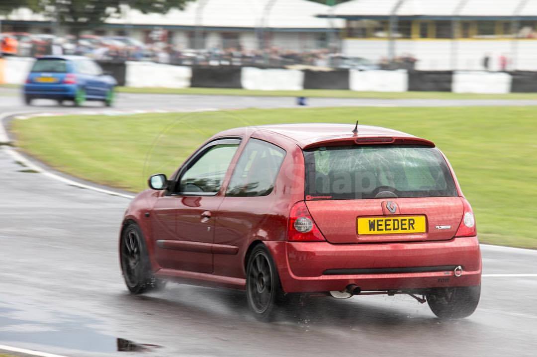

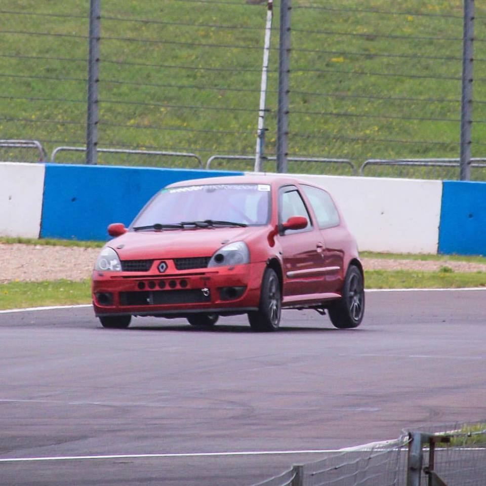

set off on the trek upto donington for french car show 2017 and booked some track time.
had some issues when we got to the hotel with a leaking bottom radiator hose but luckily it was just a loose hoseclip
other than that had a great time on track with no issues and definately want to head back to donington at some point.

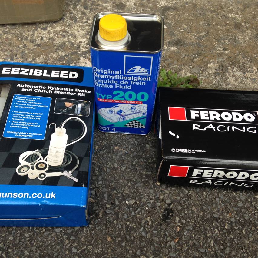

fitted some new ds1.11 pads for track, braided hoses and super gold fluid

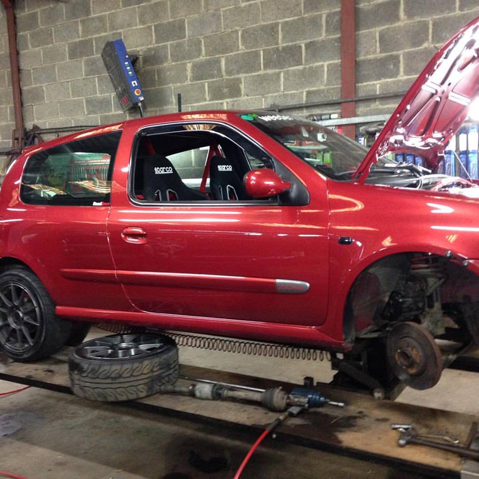

finally sorted the suspension!
went for bc racing ds series with 8kg springs all round and dampers valved to suit
i also went for their solid adjustable top mounts. the wheel alignment was set with 2.5 degrees of camber and 1 degree of toe out

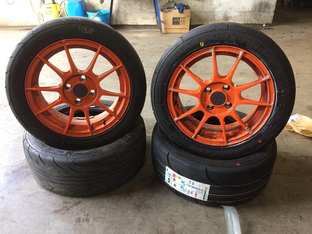

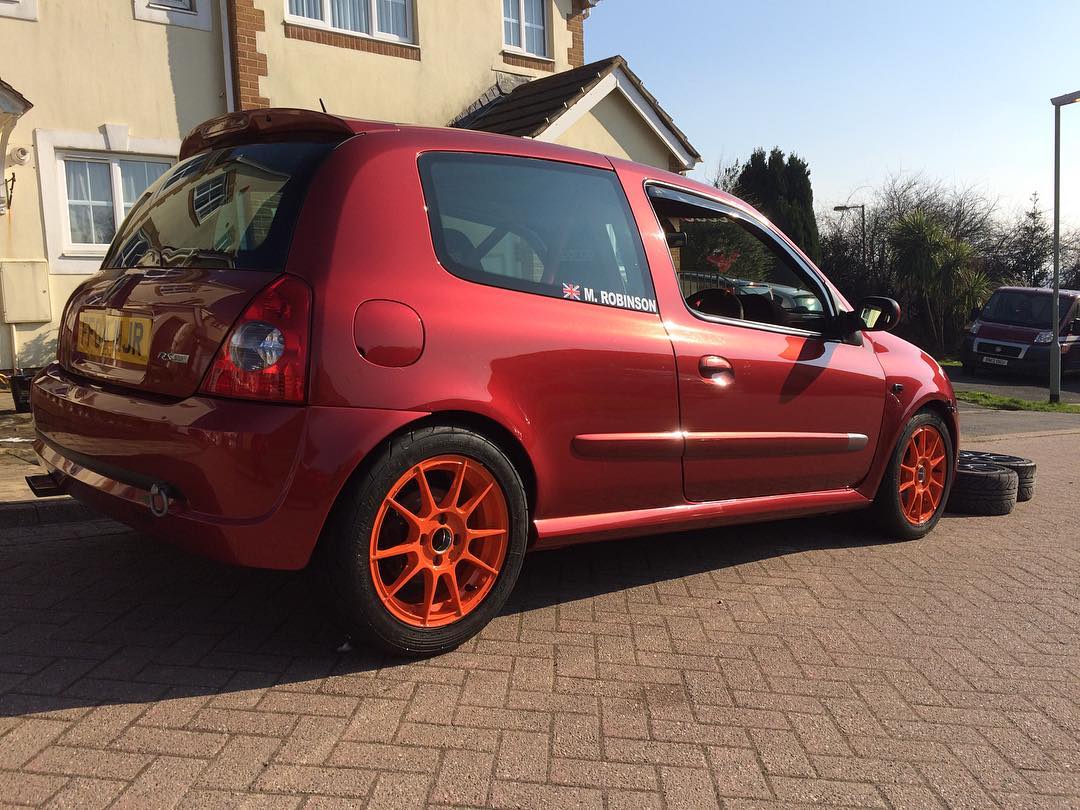

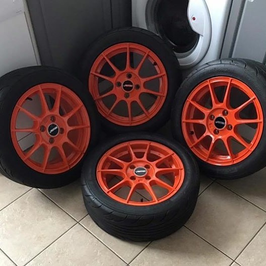

i sourced some secondhand but brand new 15" versions of the autec wheels i already had with brand new ns2r tyres
wasnt sure on the orange but i kinda like it just for track.
i swapped the ns2r for somr nankang ar-1 as some mates had recommended them
i also stripped the rear interior out
i had the car rolling roaded locally as some friends were getting theirs done.
the guy told me these cars never get stock figures even when modified and not to be dissapointed. the car drove fine and i wasnt really worried more curious to be honest.
the car ran 188bhp and even the tuner said that was amazing power considering it only had a pure motorsport exhaust and an induction kit!
