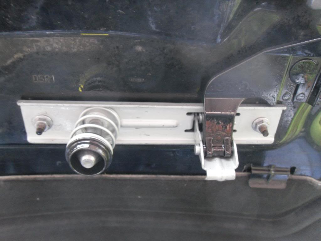

Loosen the two adjustment bolts, close bonnet, pop bonnet up, tighten bolts, et voila!

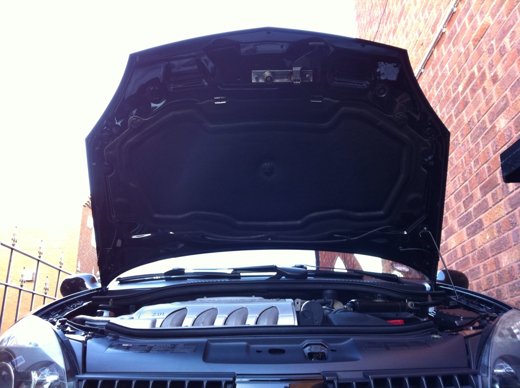

This is mine. No sticker, no letter. :(

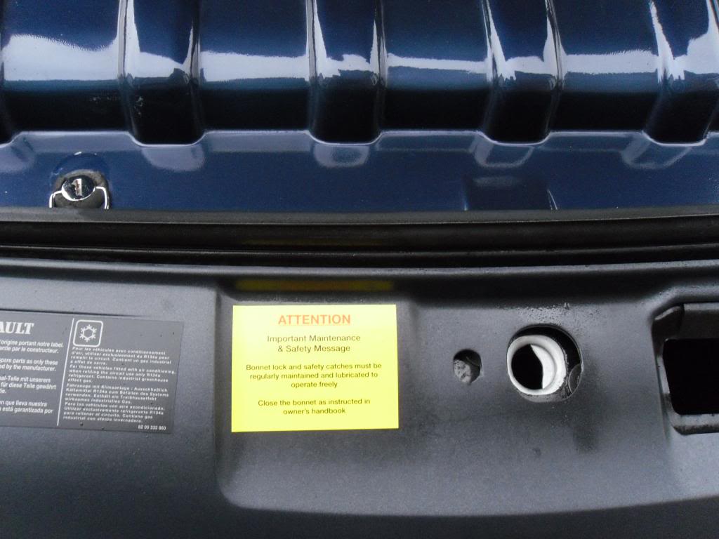

You can check to see if your car has been checked before as a blue matrix box should be affixed in the engine bay somewhere (normally on the grille) and the box K4 will have an X in it.
In a nut shell if your catch/lock is rusty it could come open whilst driving and should be replaced. Keep it regularly lubricated.

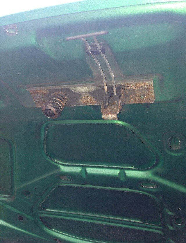

does anyone know if this is the bonnet catch they are recalling? or if it isn't should i take it to renault anyway as it looks kind of rusty! by the way this is my girlfriends clio lol.
  182
They look really bad!

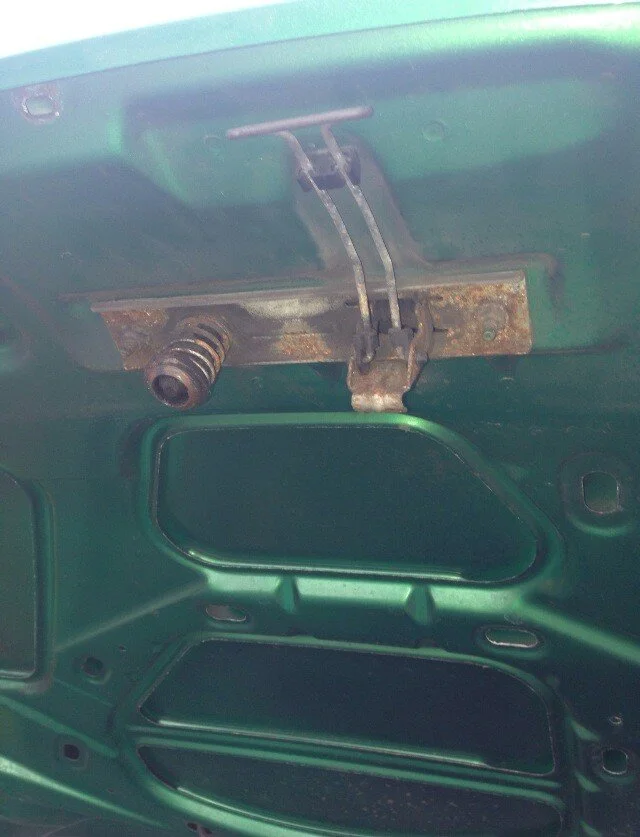

heres mine,
im going to take it to be done, i presume they will give an invoice of some sort to say it has been done which will add to the history file i keep for the car.
