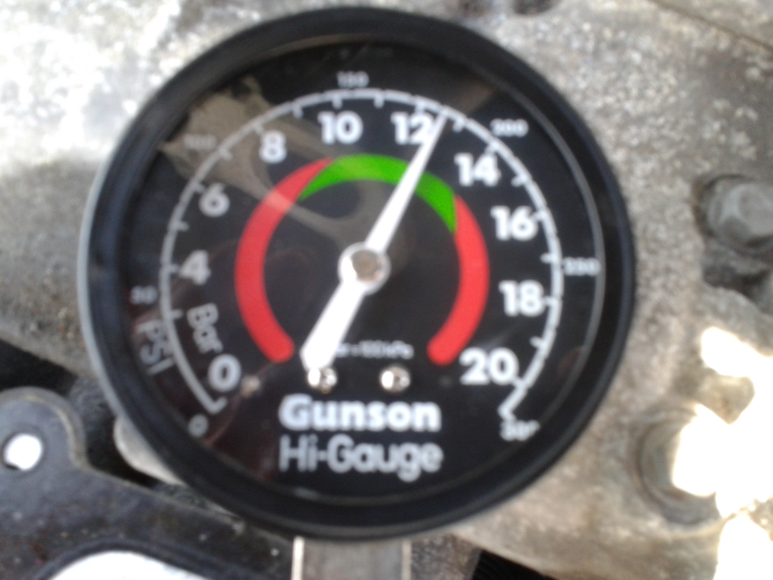

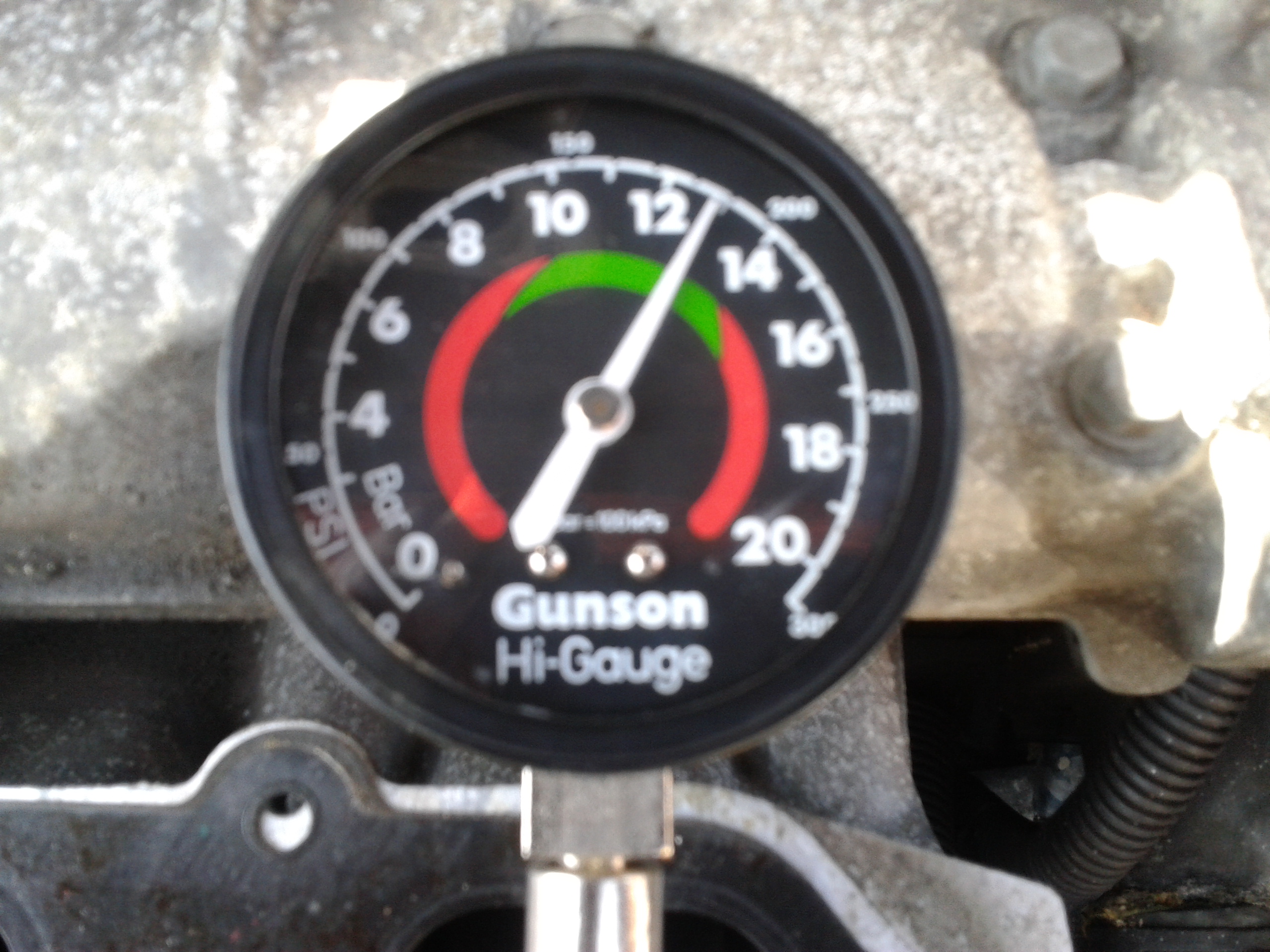

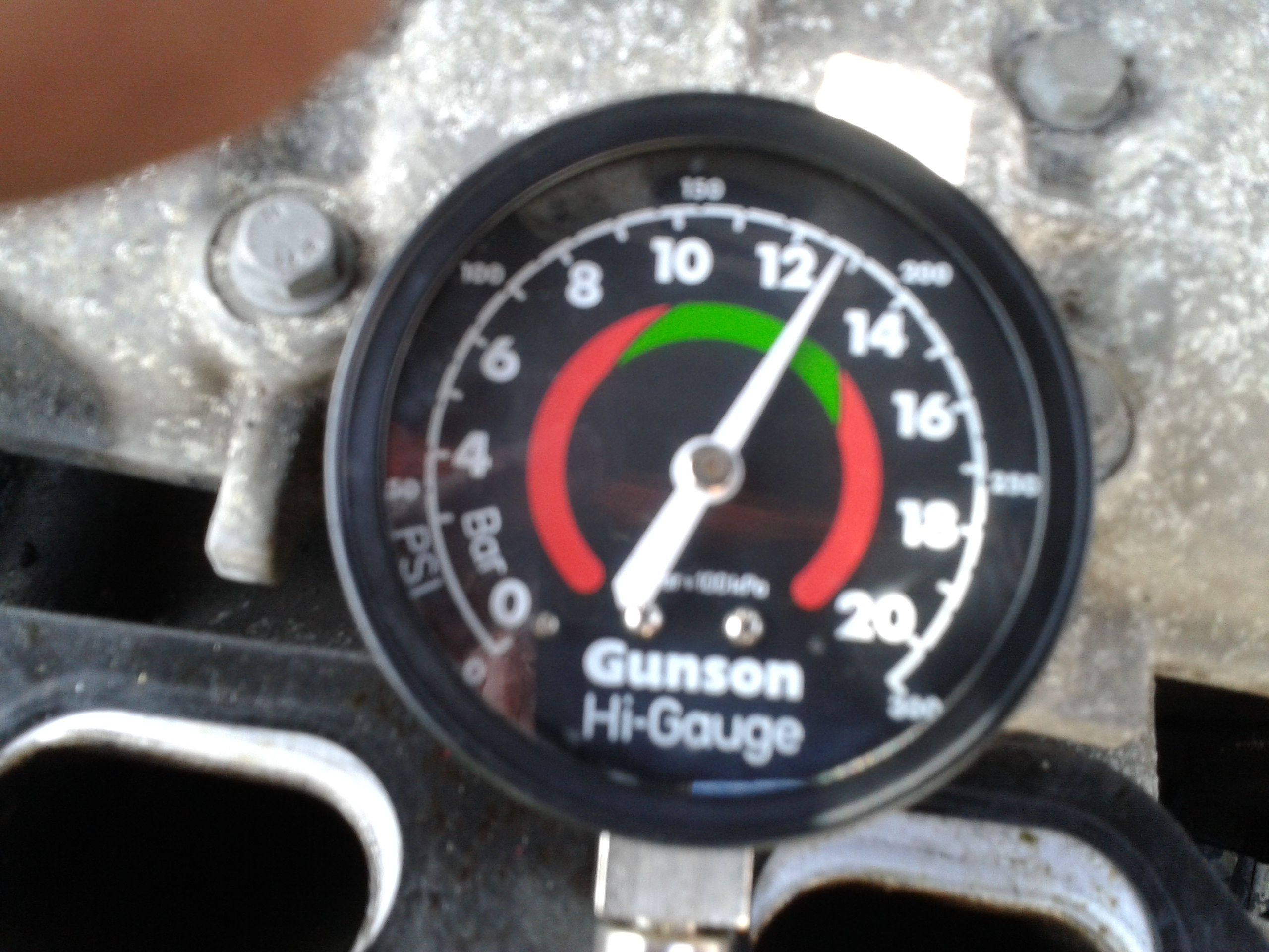

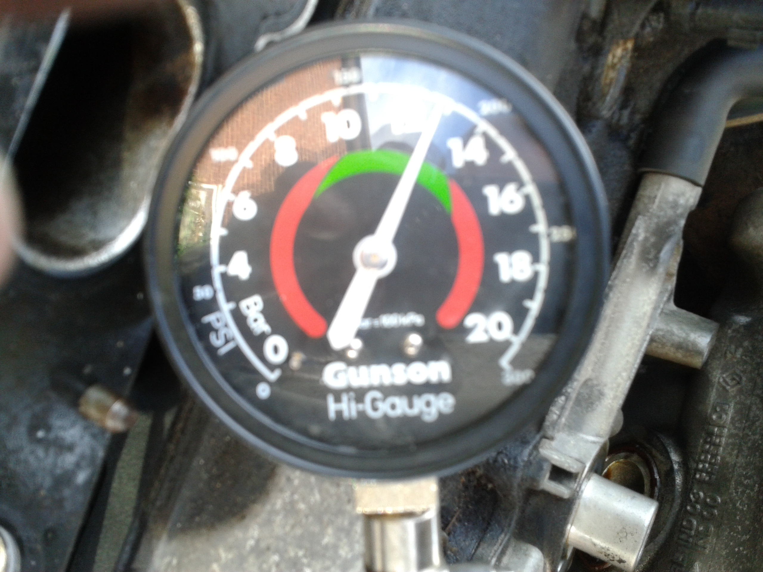

Sorry to bang on about this but I'm trying to get to the bottom of a running problem so have done a compression test.
When started from cold it does the normal raised idle but as it drops it begins to sound rough and the idle struggles and will sometimes die while sounding like a tractor (miss fire)
What I have also found is that if when this happens I unplug any injector plug it sounds smother although now on 3 cylinders. What is interesting is that when plugged back in for a 5 to 10 second period it ticks over really nicely before returning to tractor mode.
Could this be a fuelling issue and are my varying compression results concerning?
Any advice

Bit low bit nothing to worry about. Compression test doesn't really tell you much anyway.

it's a bit low but i'm guessing it was something like a gunson tester and you had injectors plugged in?
Can't remember the brand of tester as I borrowed it, but no injectors unplugged
I should be worried then, as I used a Gunson tester, with the injectors plugged in, and they all read the same, when in fact, they should have been all over the place?

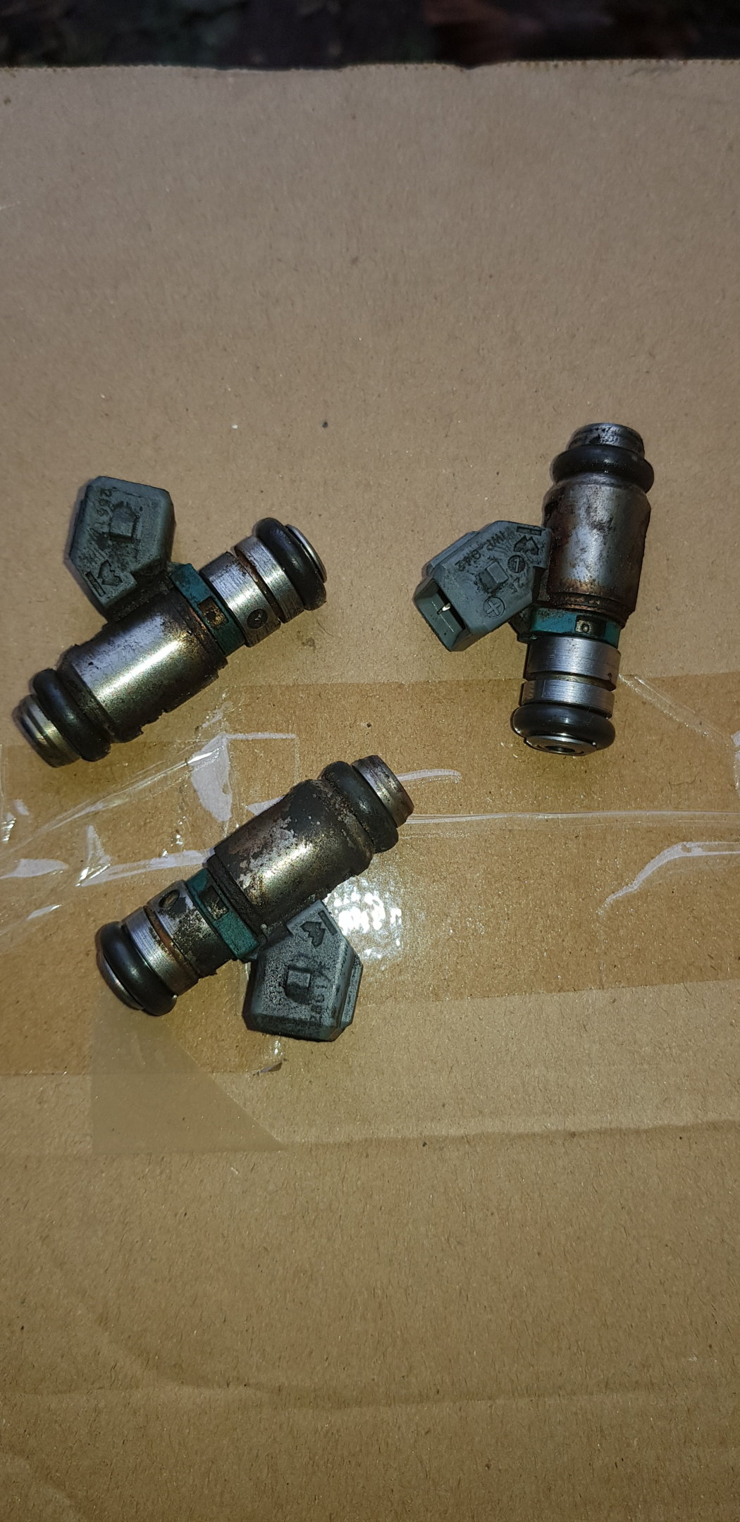

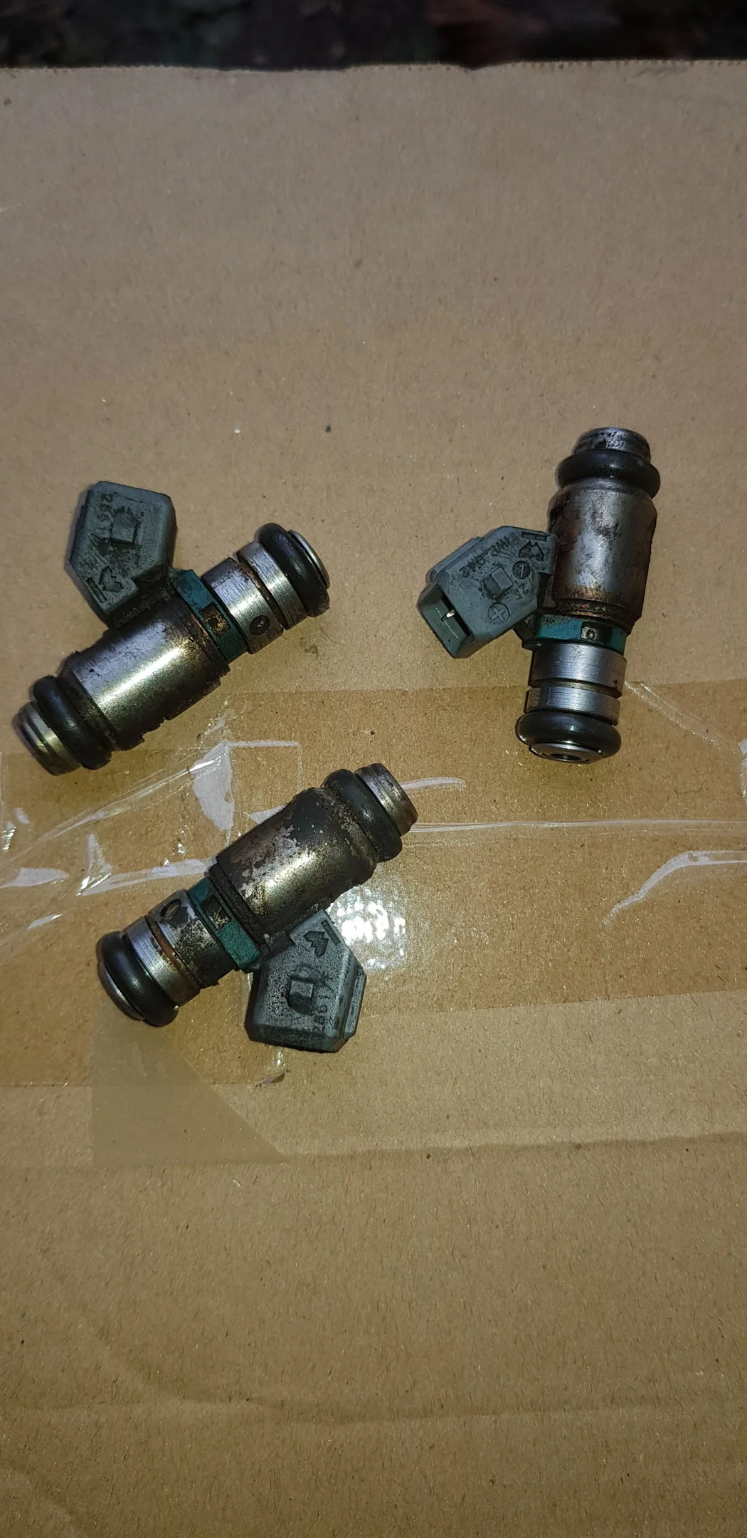

Also removed fuel rail and did an injector flow test, all four produced equal spray pattern. While off I removed all injectors as they were pretty dirty and rusting, I ohms tested again but this time one came out slightly higher than the others at 15.3ohms vs the rest at 14.7ohms.

My injectors look rough to be fair

The injectors are rough to say the least, man they took some removing, ended up taking the clips off to get the rail away and tackle them one by one.
