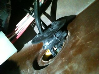

See what i mean? Only the wiring has a hole, the middle/top is moulded :S
Screwdriver throught grommet to open up hole a bit.
Failing that use the bonnet cable grommet, thats the grommet i used to take the wires from my oil gauges to the senders in the engine bay.
P.s a bit of lube may help ;)
That is the bonnet cable grommet. Lube sounds like a plan though

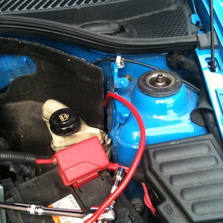

Nearly came when this happened ;) thanks for the help all

  440i + 182
Went to put through my battery cable and someone had already cut a nice hole ready for me, I was more than happy! :D
Glad you sorted it mate!
