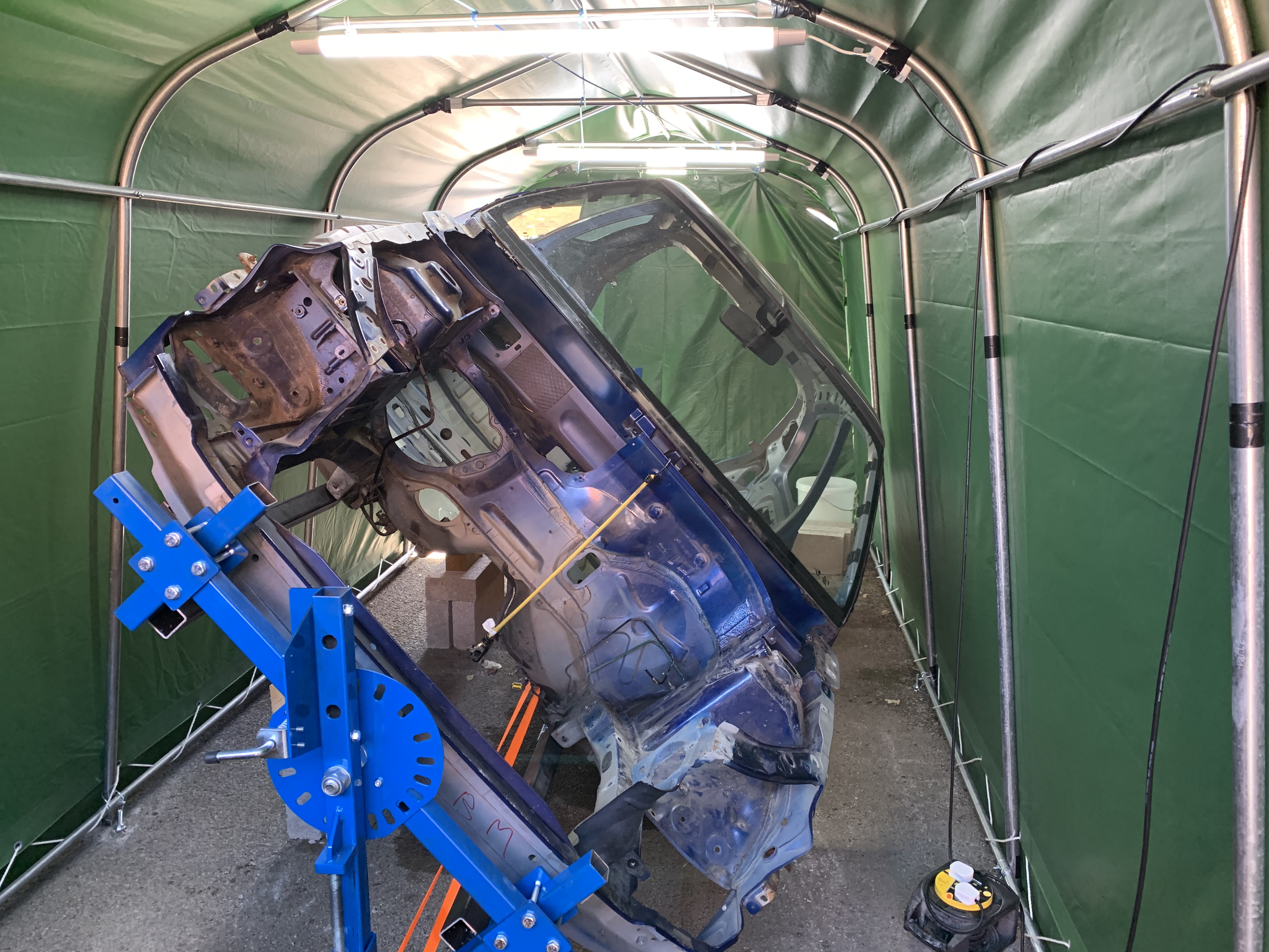

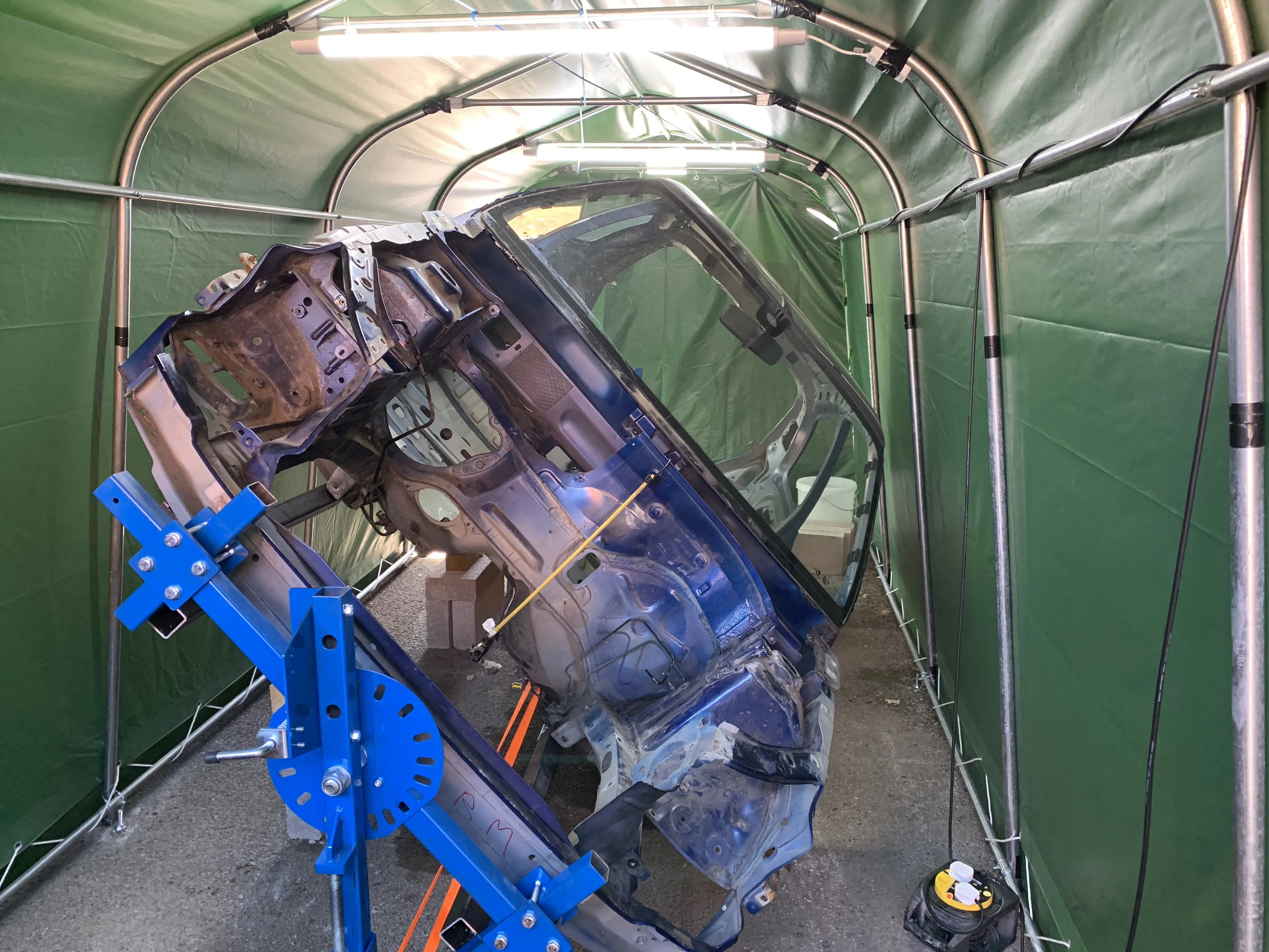

Why not join me in the god tier restoration... 😂
s**t balls! I am tempted. Just nowhere to store the parts off the car whilst I did the work. Be a proper labour of love and would save me lying under the car with an angle grinder just above my nose

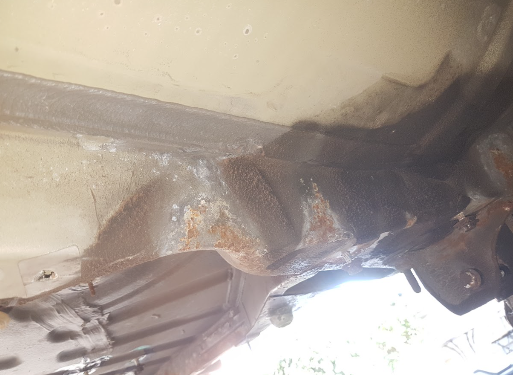

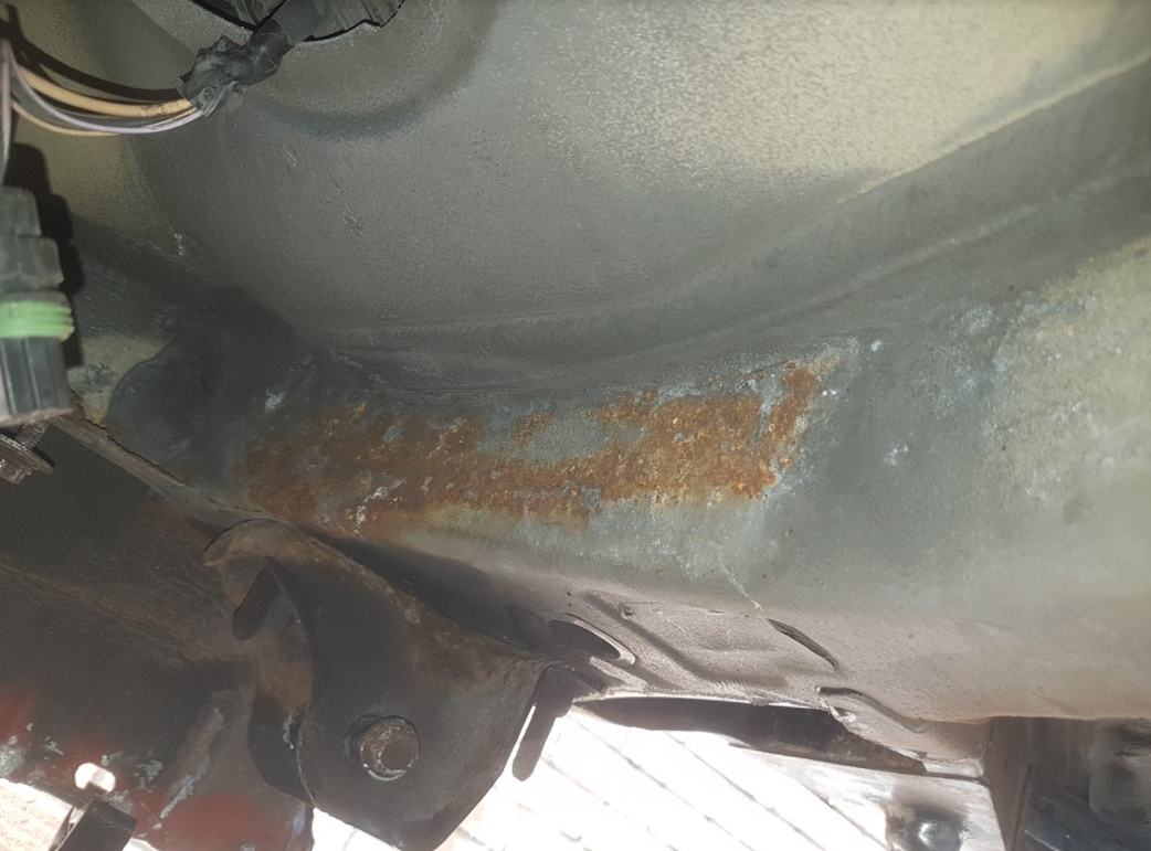

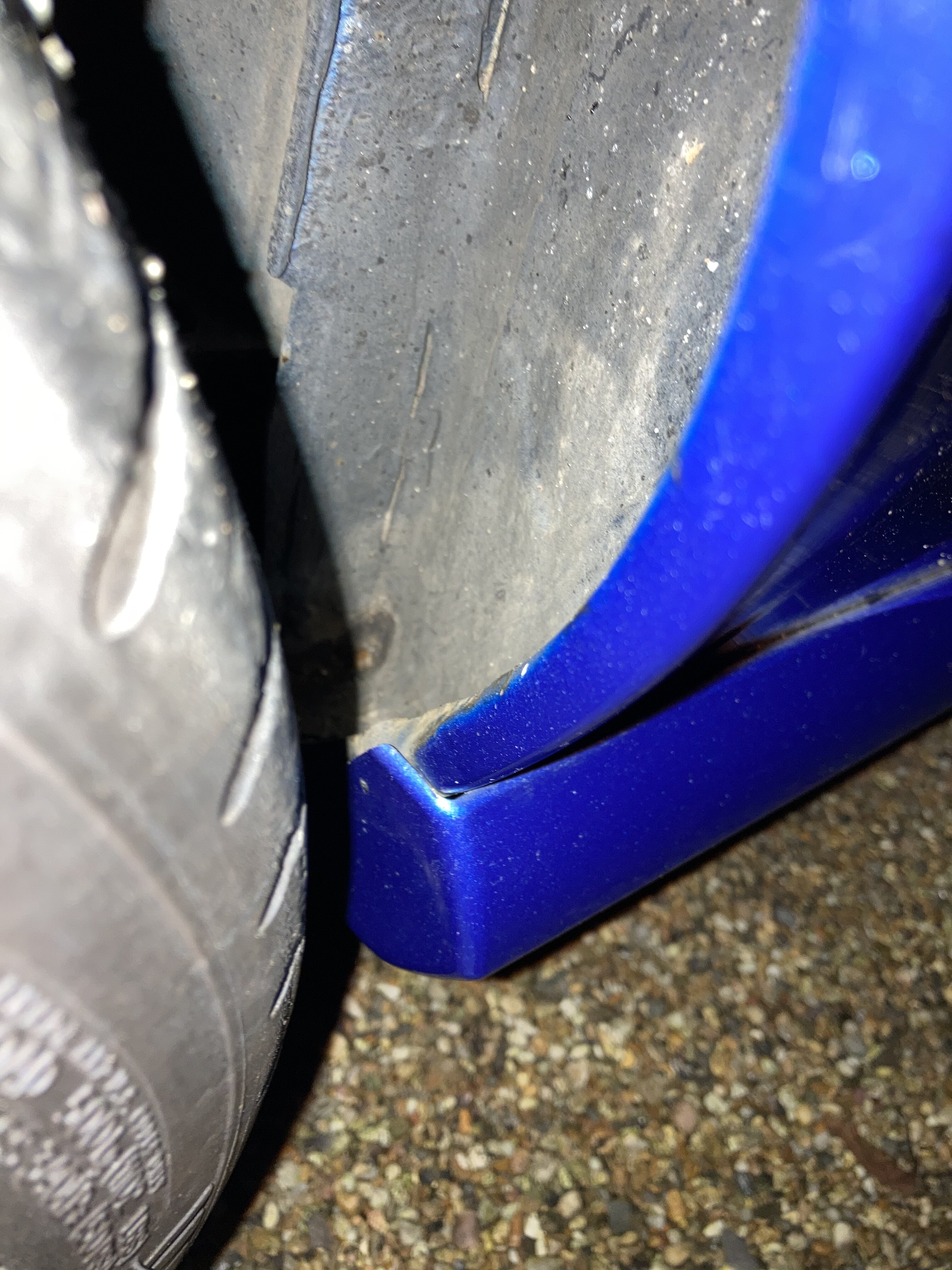

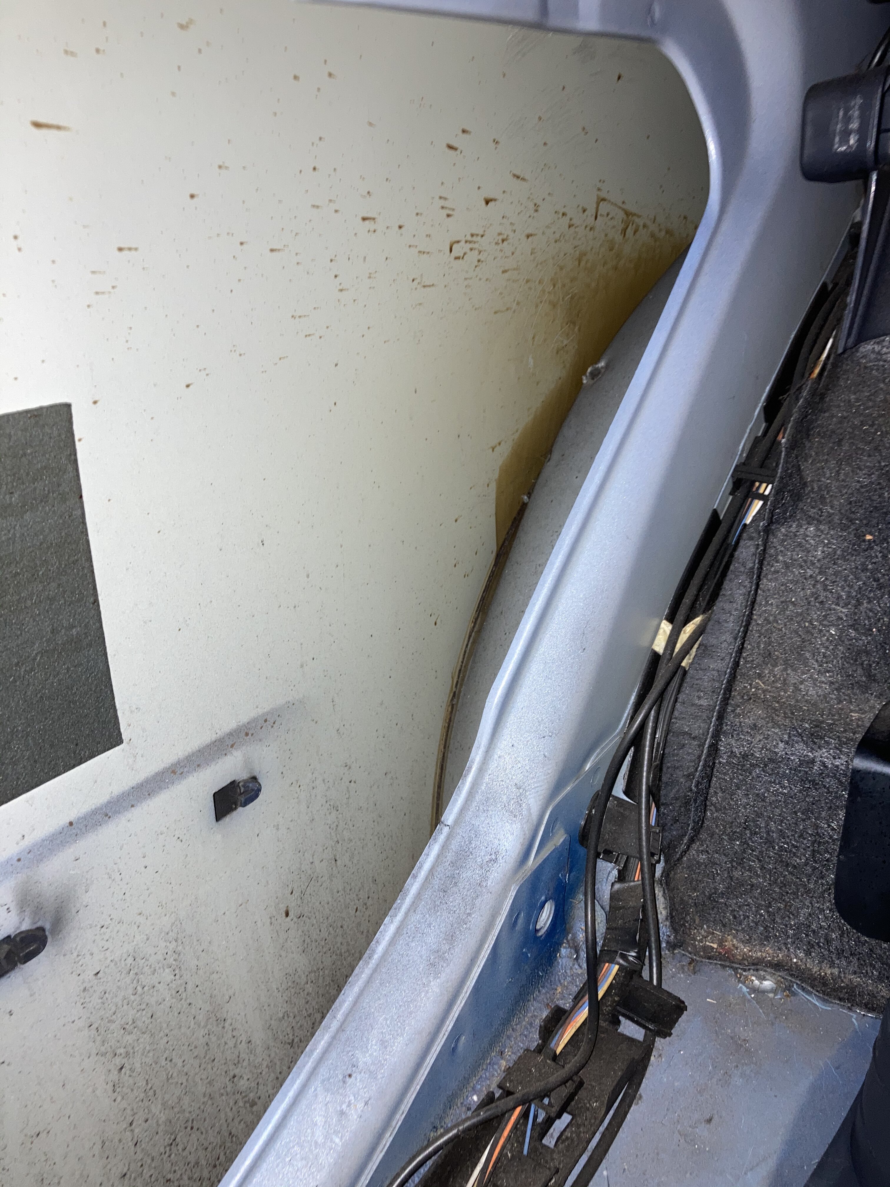

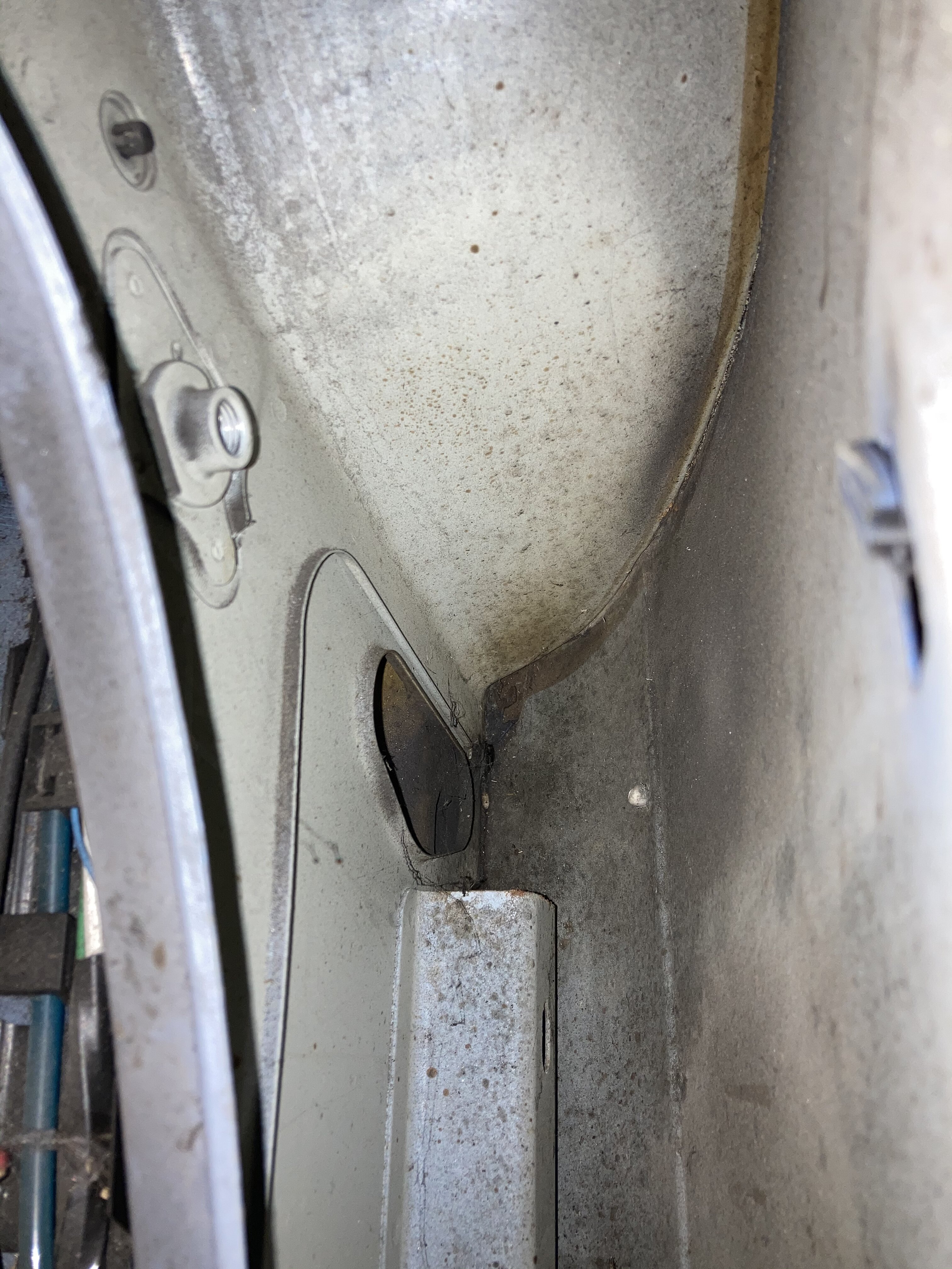

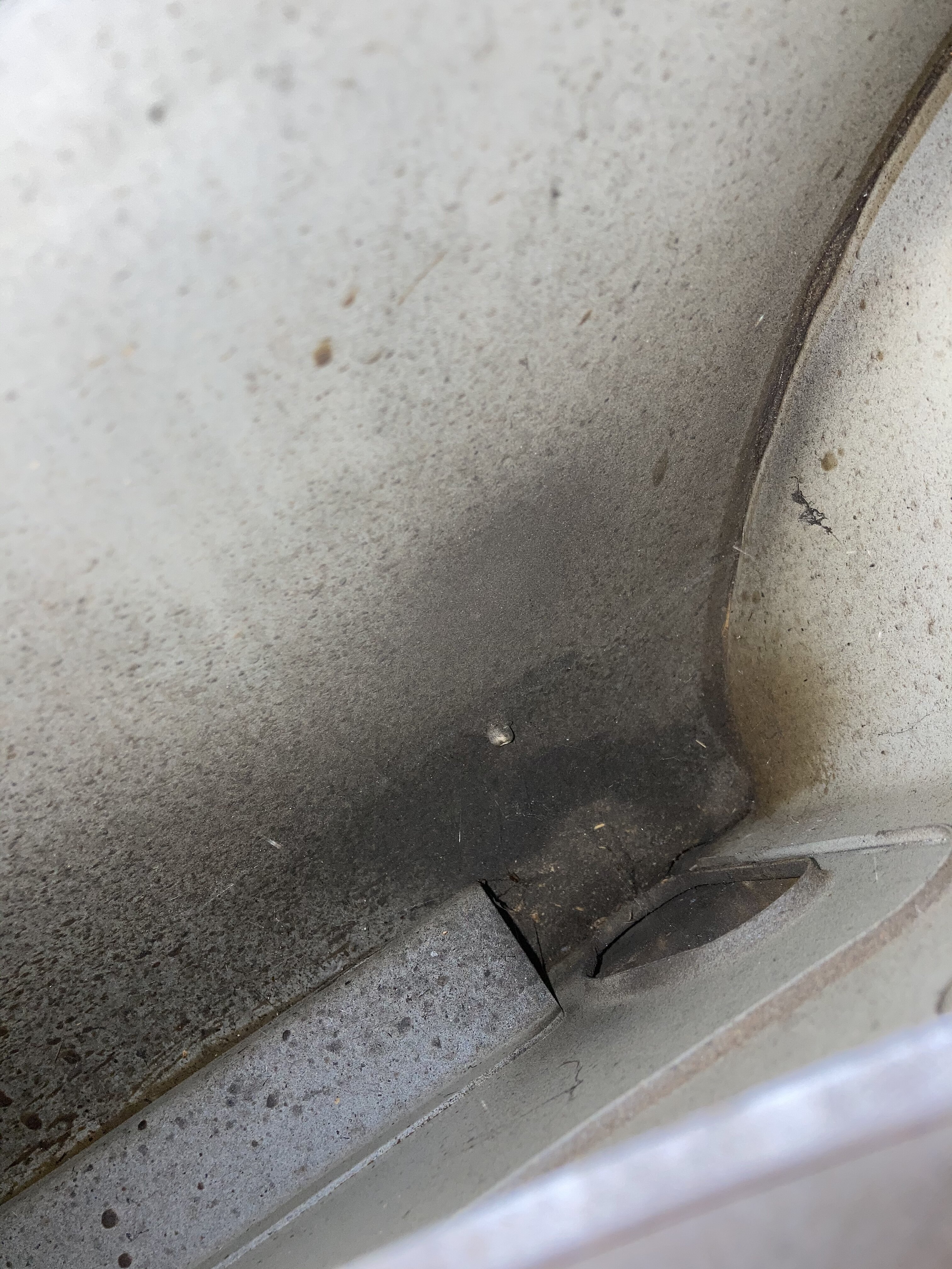

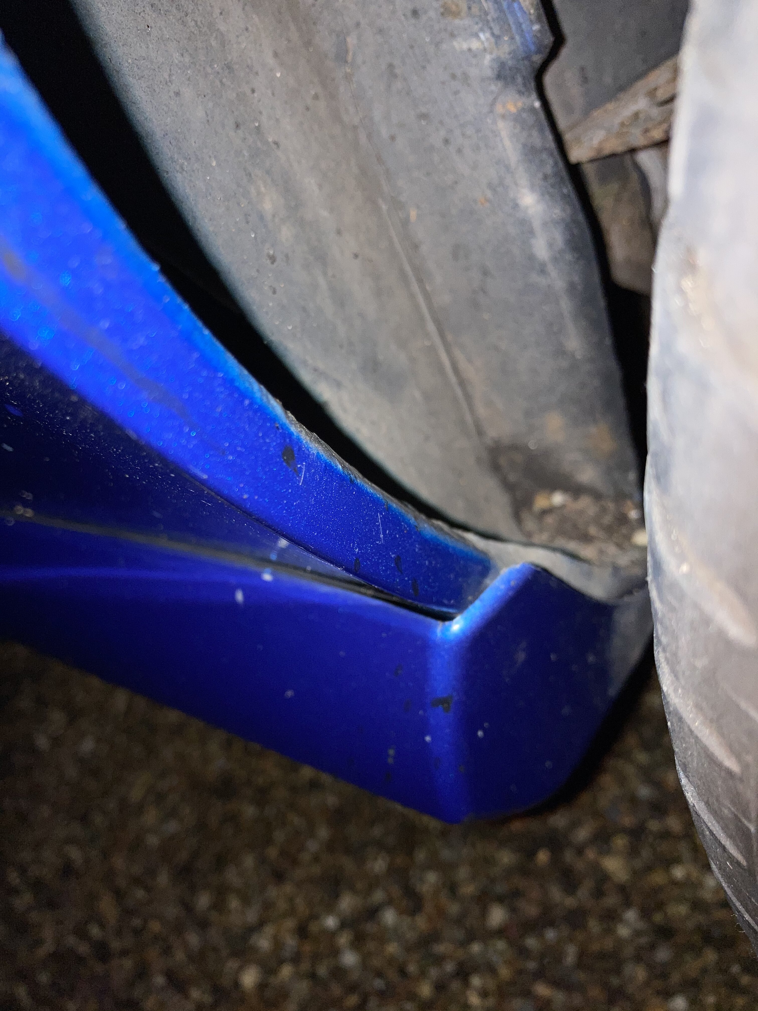

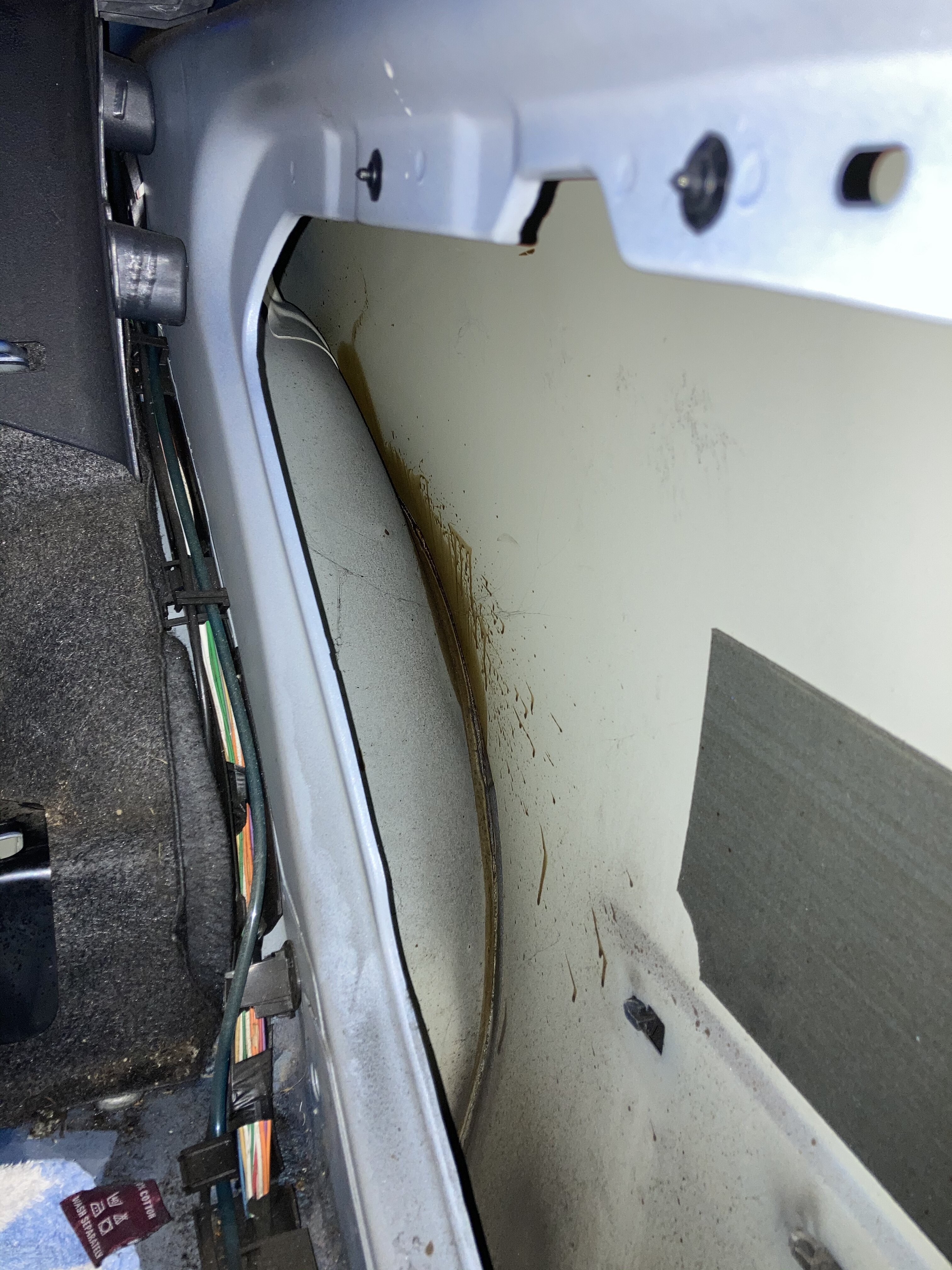

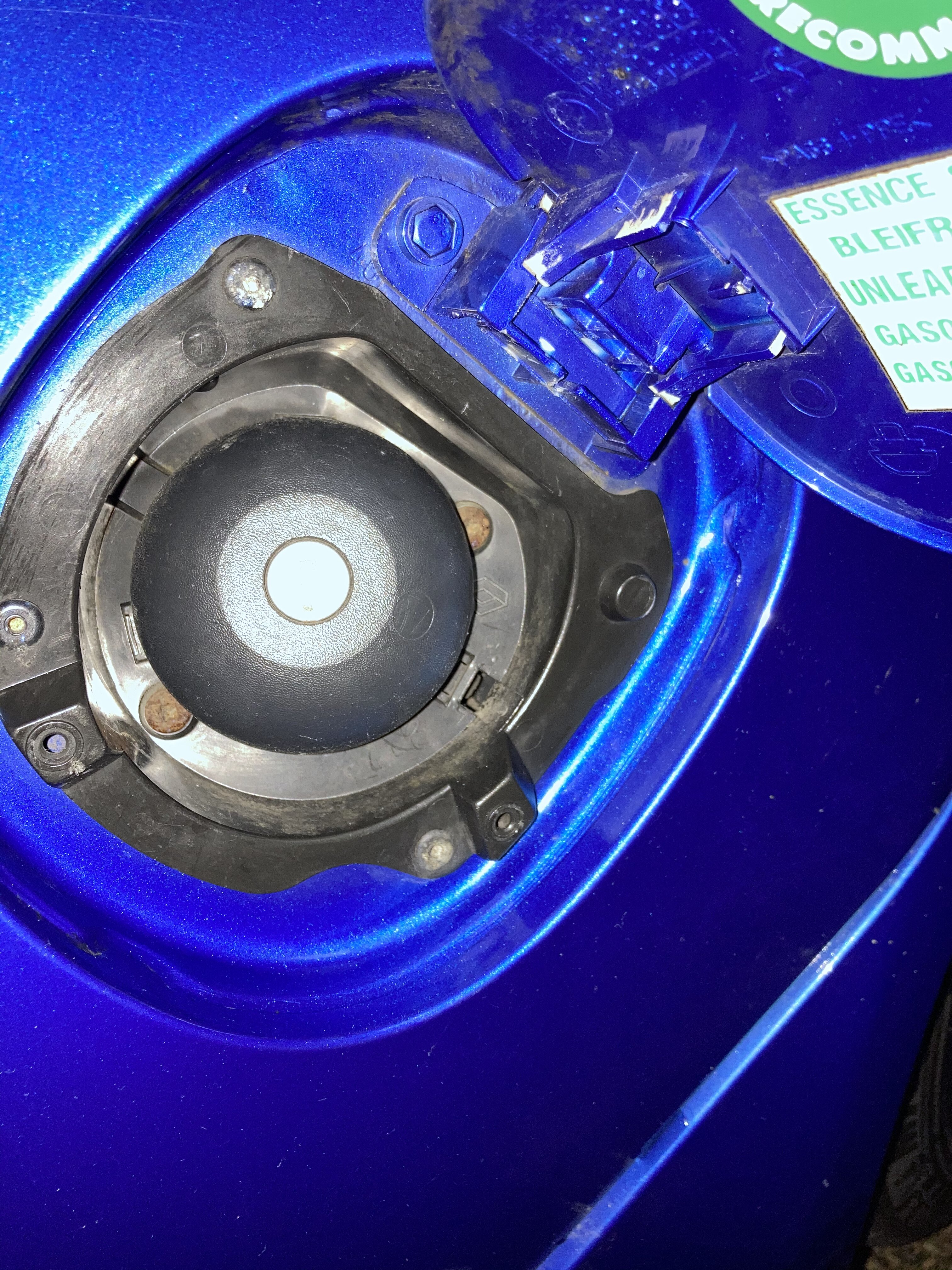

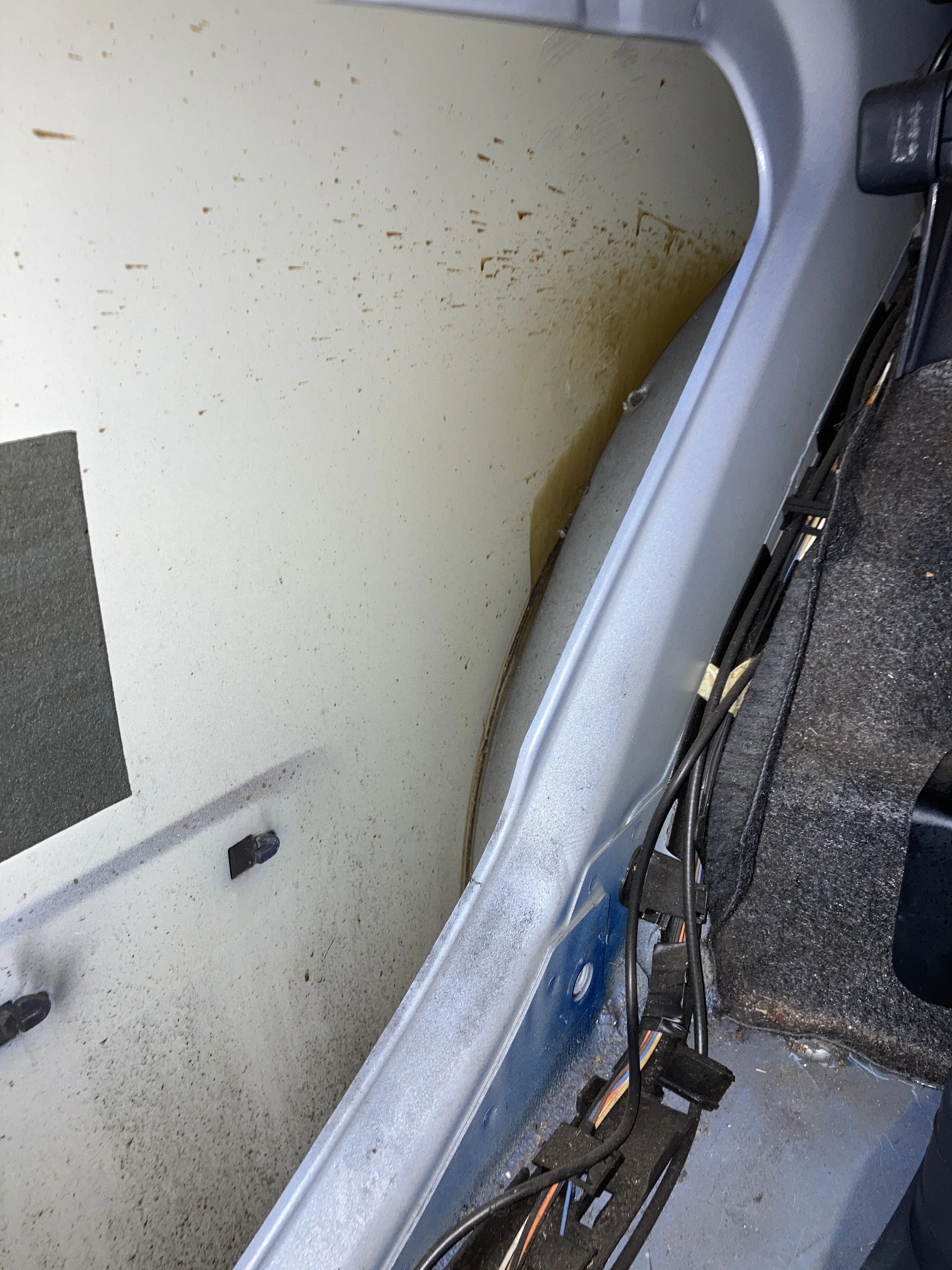

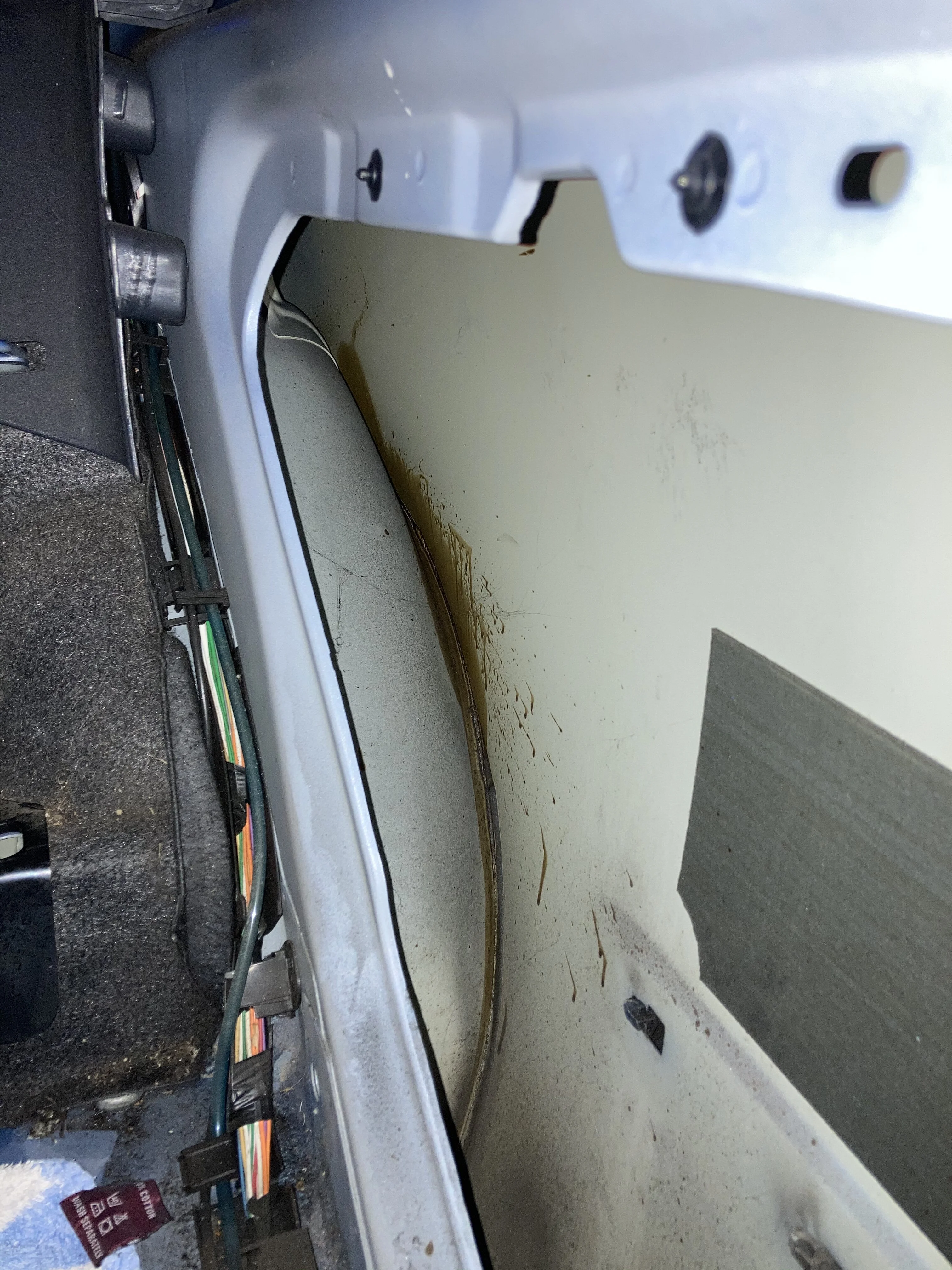

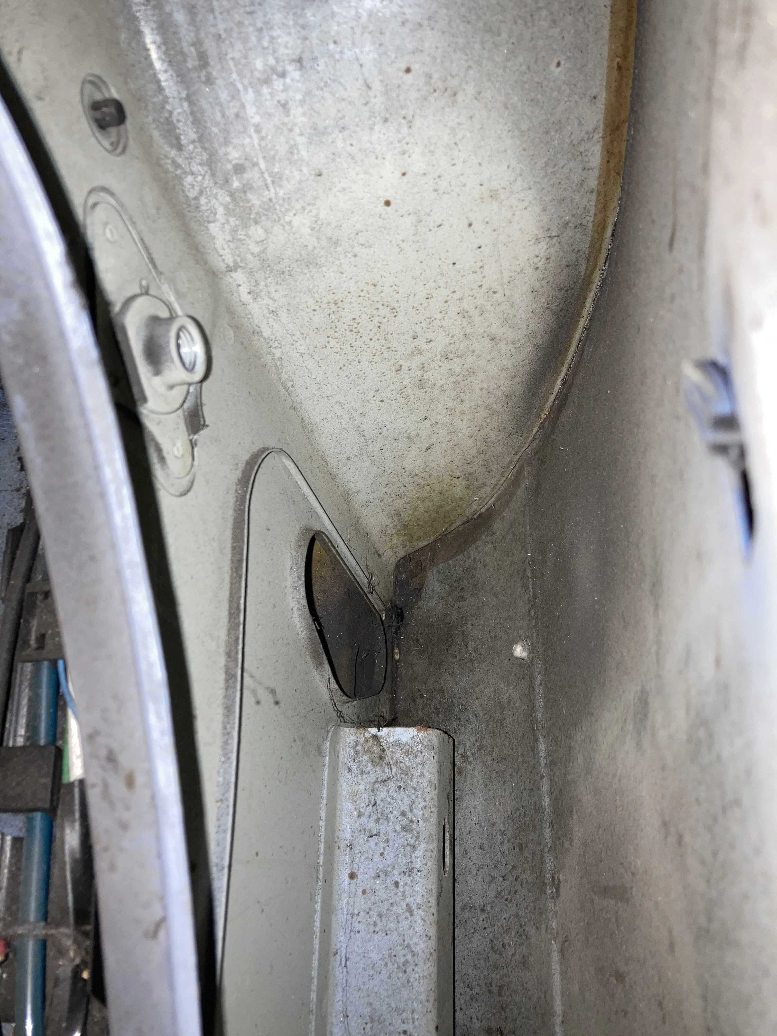

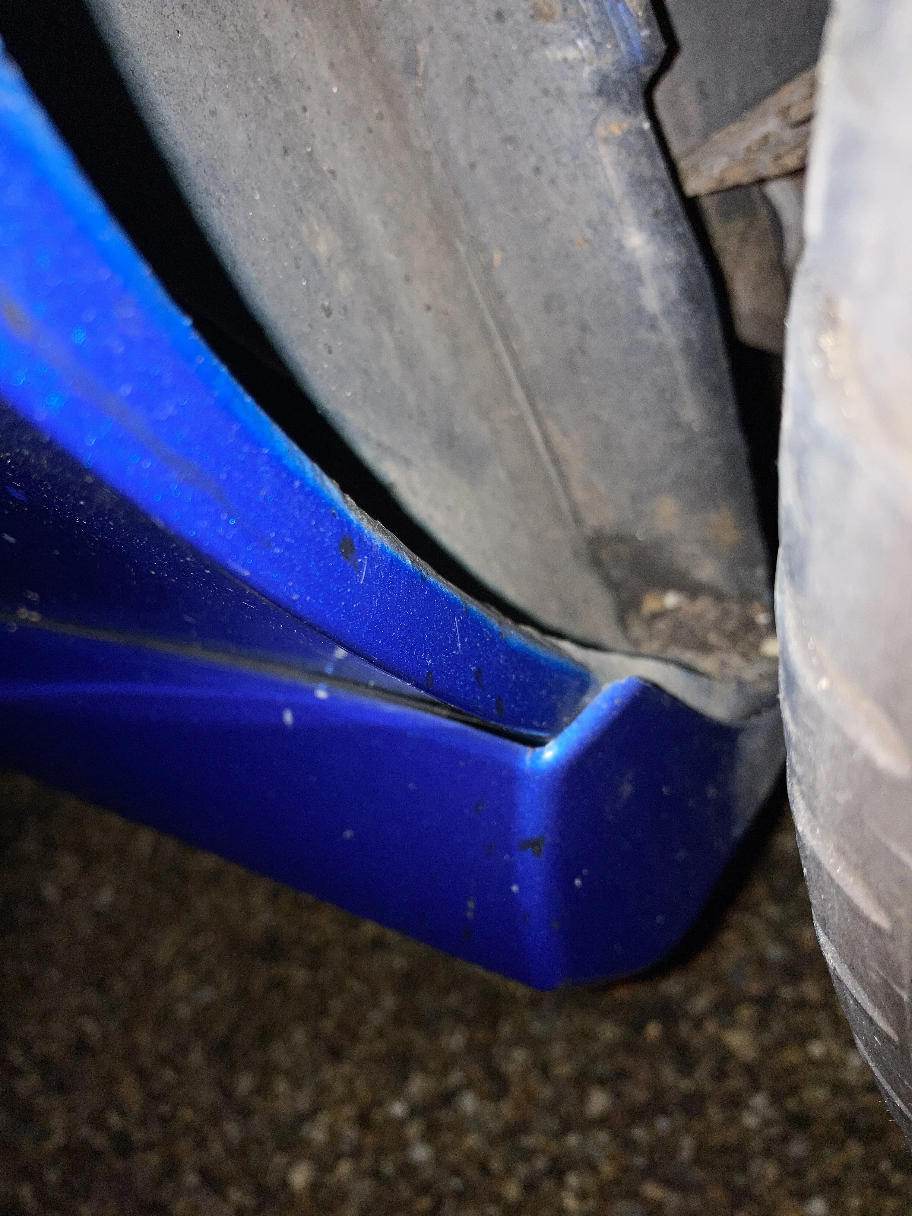

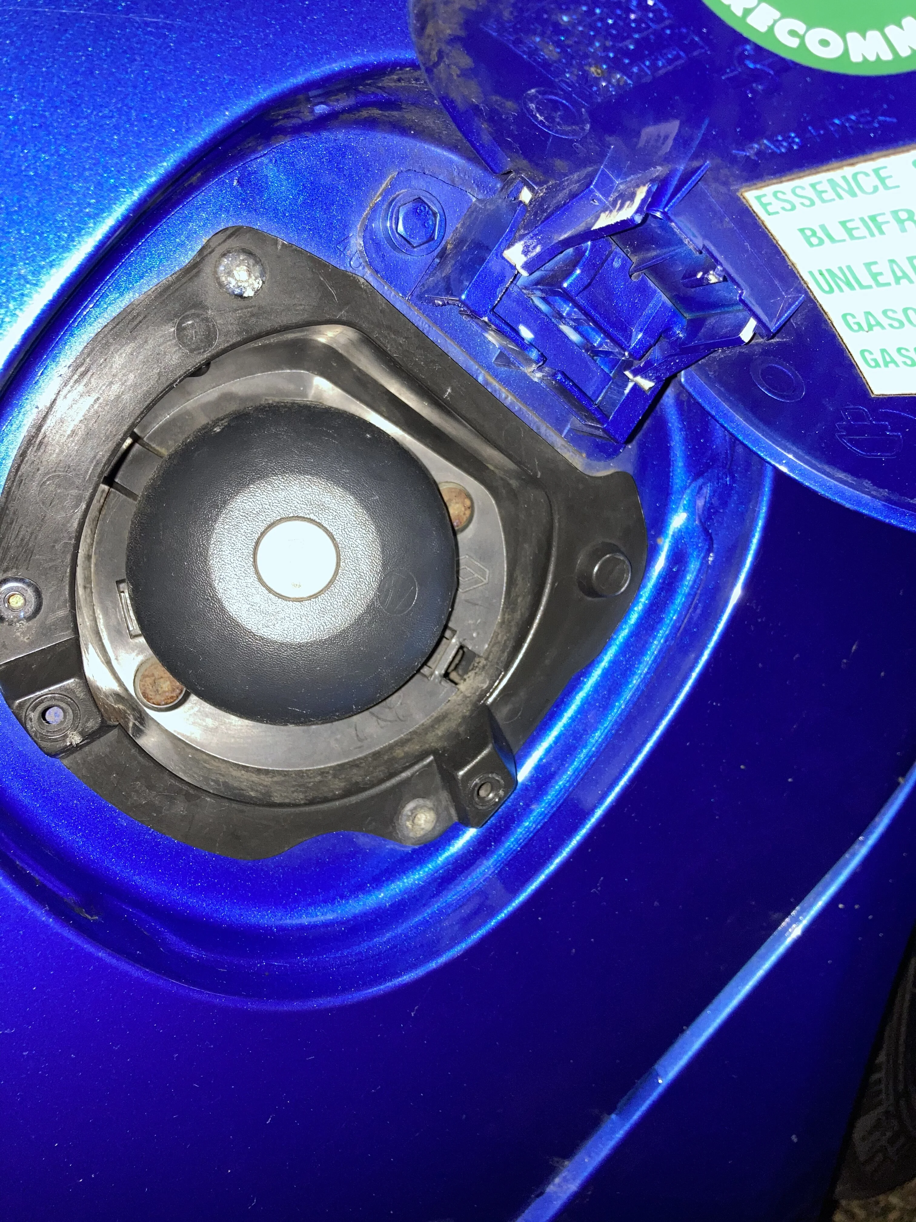

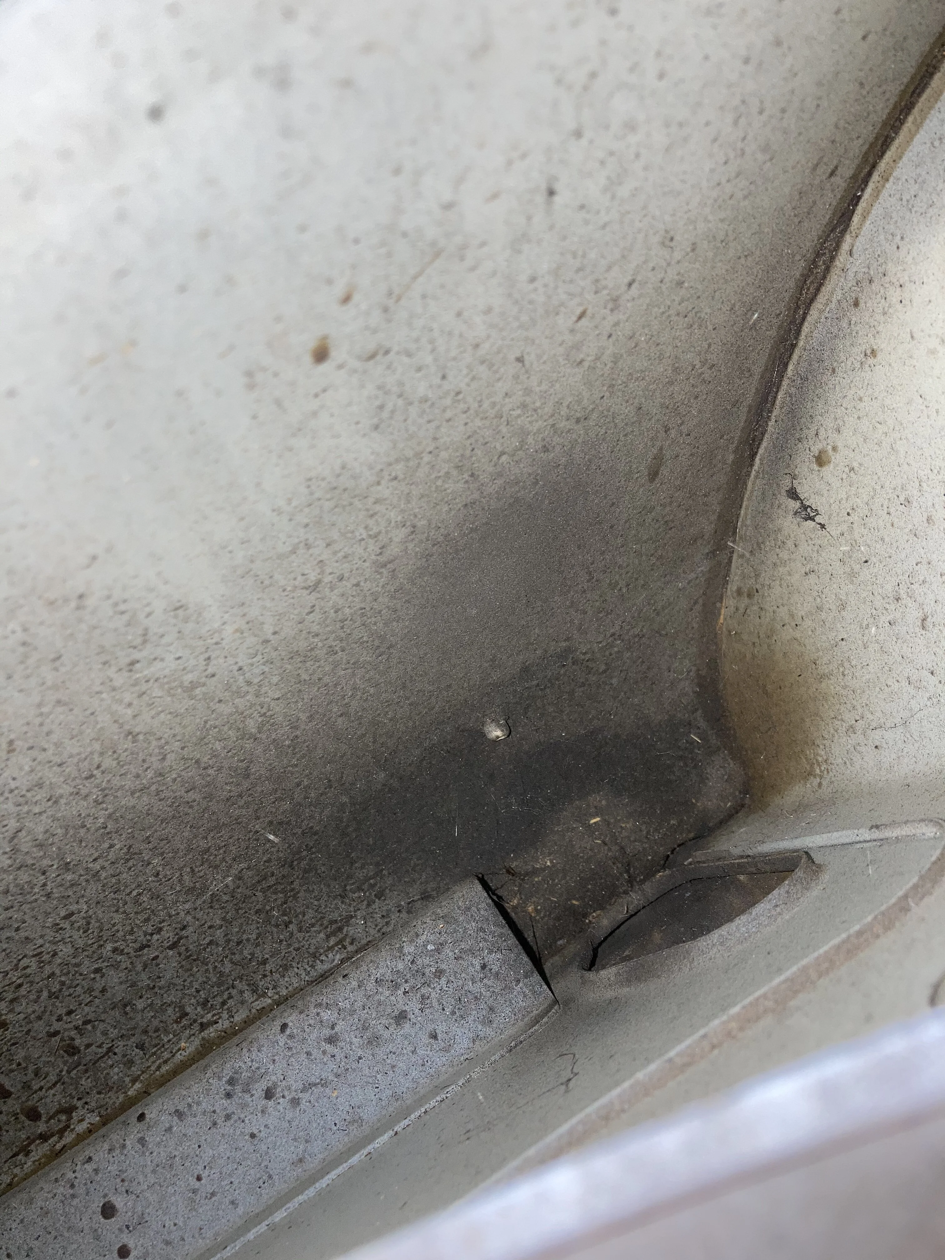

Had a bit of time today to check around the rear arches, filler cap and take the rear door cards off and inspect the inner sills. Need to give it a clean yet but looks good from what I can see so far. It also looks as if someone has sprayed some cavity wax around the inner seals which is good to know but these will be redone with a more generous amount.
Will post some more pics in the next few days of the other areas.

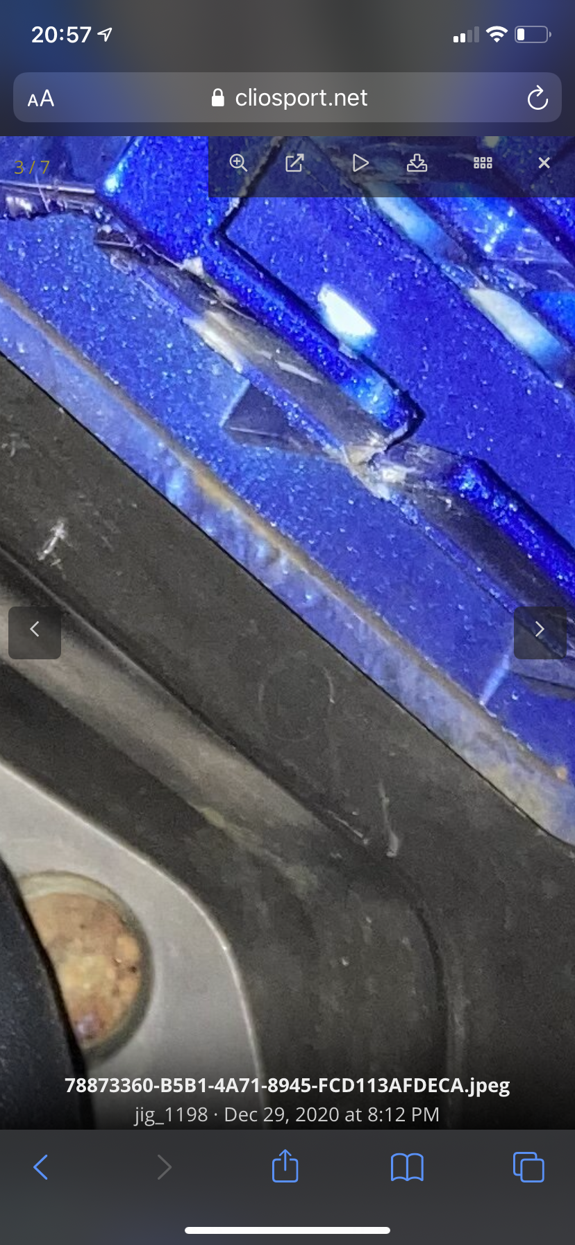

Your rear arches look like they need some more looking at as well mate. Like I said before drop the arch liners and have a good prod. If it were me I would remove the skirts and have a proper good look
It’s gone on the filler cap mate that bubbling will need sorting View attachment 1512943
Well spotted, didn’t notice that. Will take a better look at that.
The areas I took pictures of were the worst bits so not too bad but I will have a better look at the car once I give it a deep clean and get it in the garage. Will take skirts, arch liners and bumpers off and have a poke around. Once I’ve assessed the condition I’ll then start protecting.
I got an eye for it now mate, I am currently sorting all this out on my second 182. Trying to sort all this out over the winter. But it’s constant!
Painful process, especially when you do it for a second time in as many years hey @RustyMojo 😉
Looking back I would have spent more time on the fuel flap area on mine, It might be an idea to cut out add a second layer from behind the fuel flap, filling the edges with seam sealer to strengthen it?
Same here mate, I got the car early November and haven’t really driven it a great deal since as I’ve wanted to get it protected before it sees the roads again
That looks well tidy.

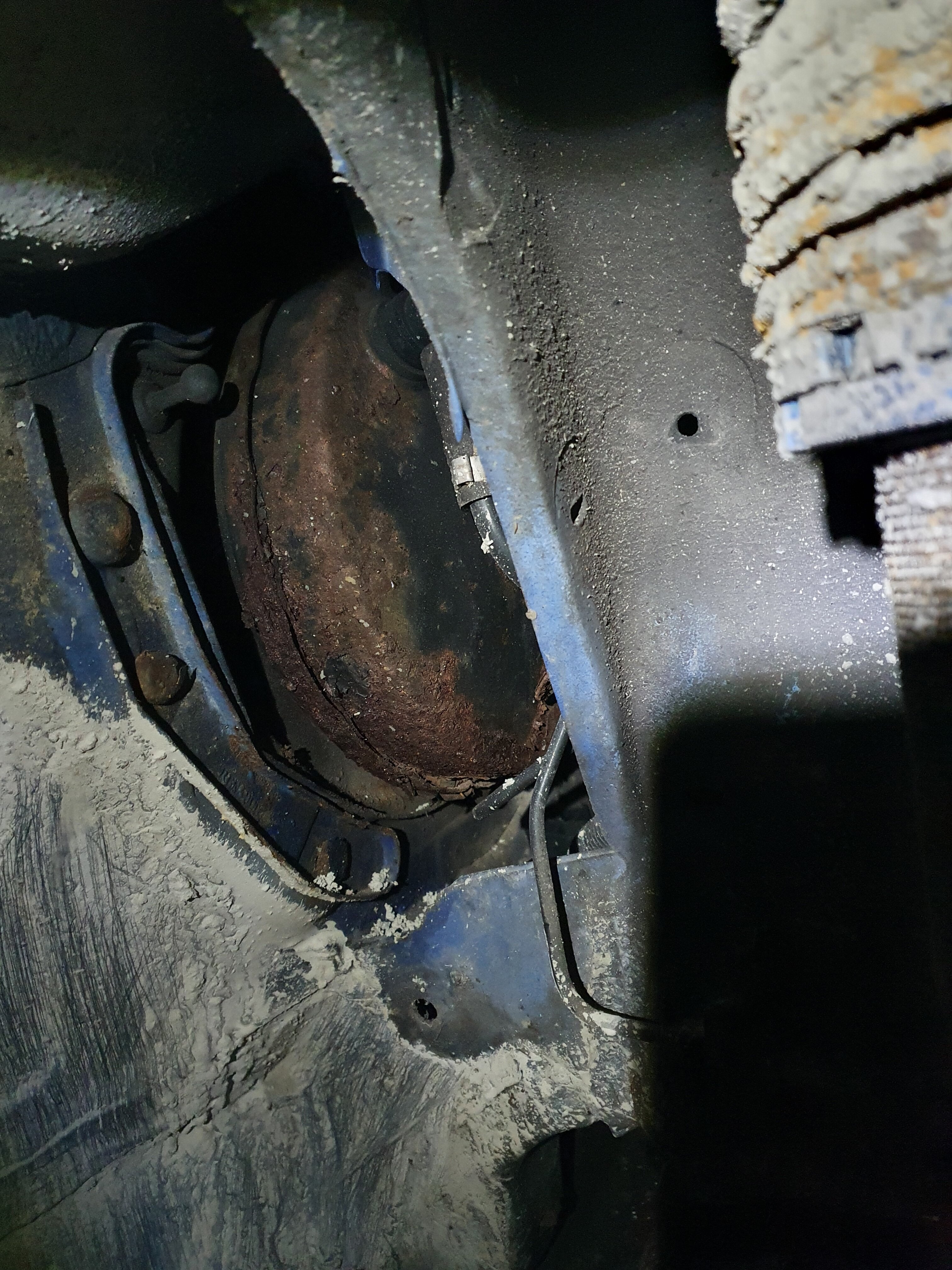

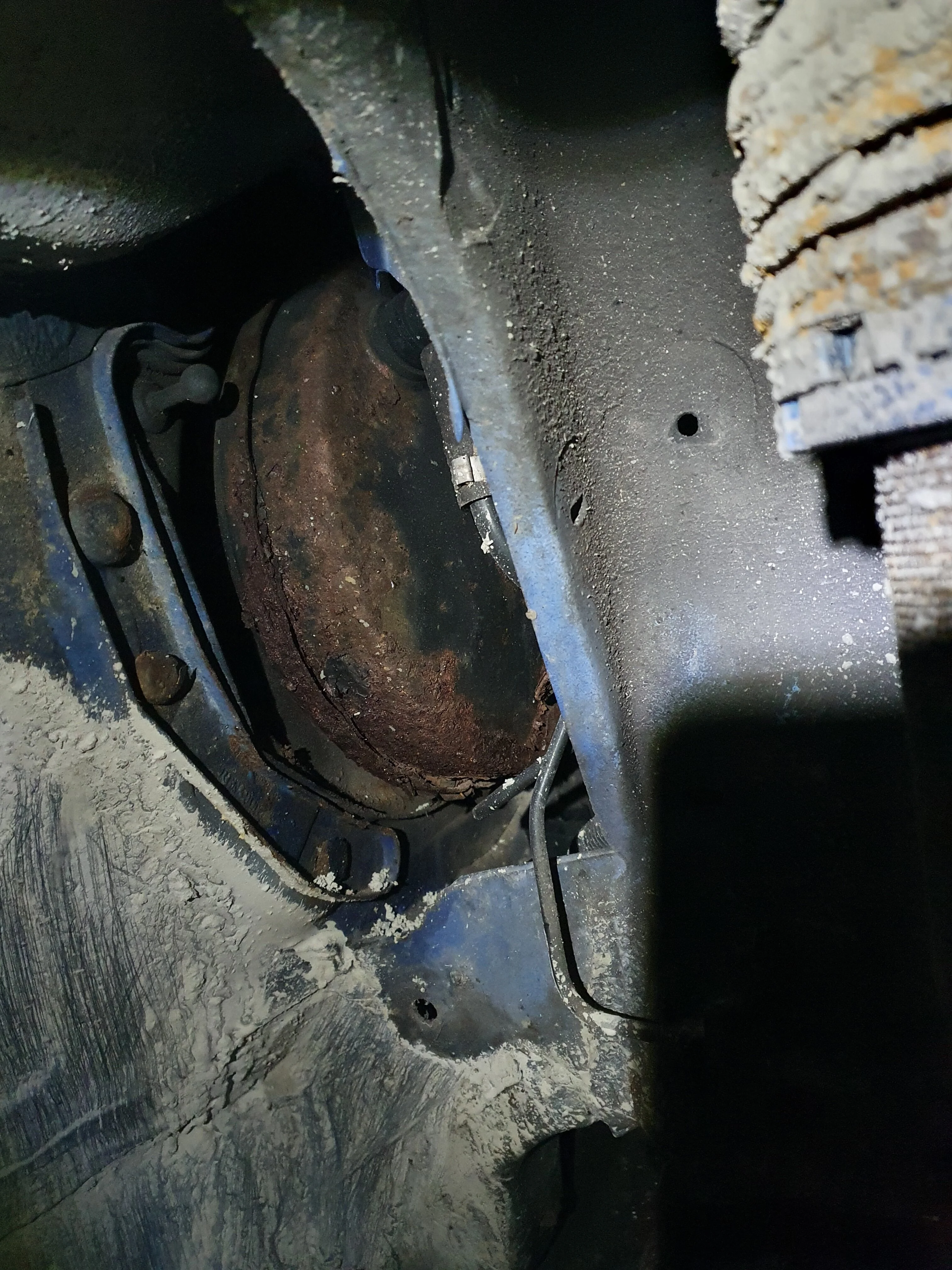

From my experience you need to have a look under the car in front of the rear spring mounts there is a cavity. IMO that is the worst spot on these, close second is the filler cap (have a good look behind with liner removed), then front bumper mounts then sills.
The rest is just ugly but not especially harmful to the car (brake servo, rear brake line/hand brake bracket etc).
Getting into those triangular cavities is near impossible too, I resorted to a less than ideal liberal coat of hydrate 80 and dynax. Hope for the best and look back at it next spring with eyes half closed.
Good on you.... why the hell are you doing this to a Clio though :ROFLMAO:
Also, where did you buy the rotisserie from.... looks nice!

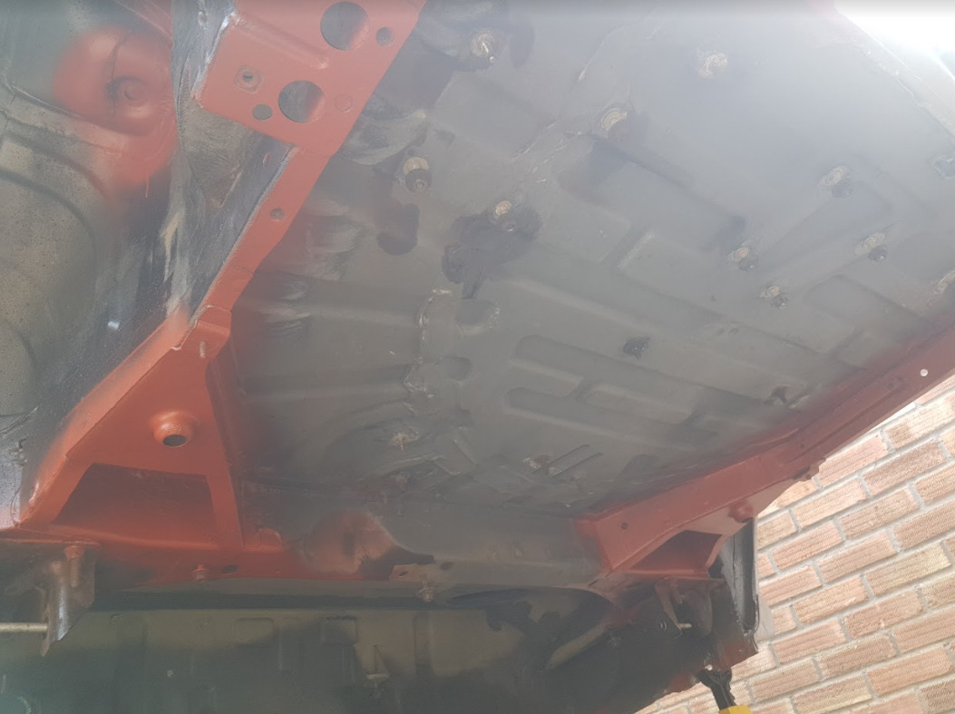

I've just done a full underside resto on a trophy for a customer and there were early signs of rust in a lot of places. Front and Rear chassis leg and the rear spring mounts fuel flap and both sills.
When you root out the rust, clean it up then coat it with Bilt Hamber Hydrate 80, then Bonda rust primer, then paint and then Gravitex underseal. If you apply the gravitex with an air gun you get a good thick coat with a nice finish.
They also rust between the fuel tank and body on the driver side, up high so essentially beneath the rear seat but above what you can easily access. I think to properly resolve would require dropping the tank.

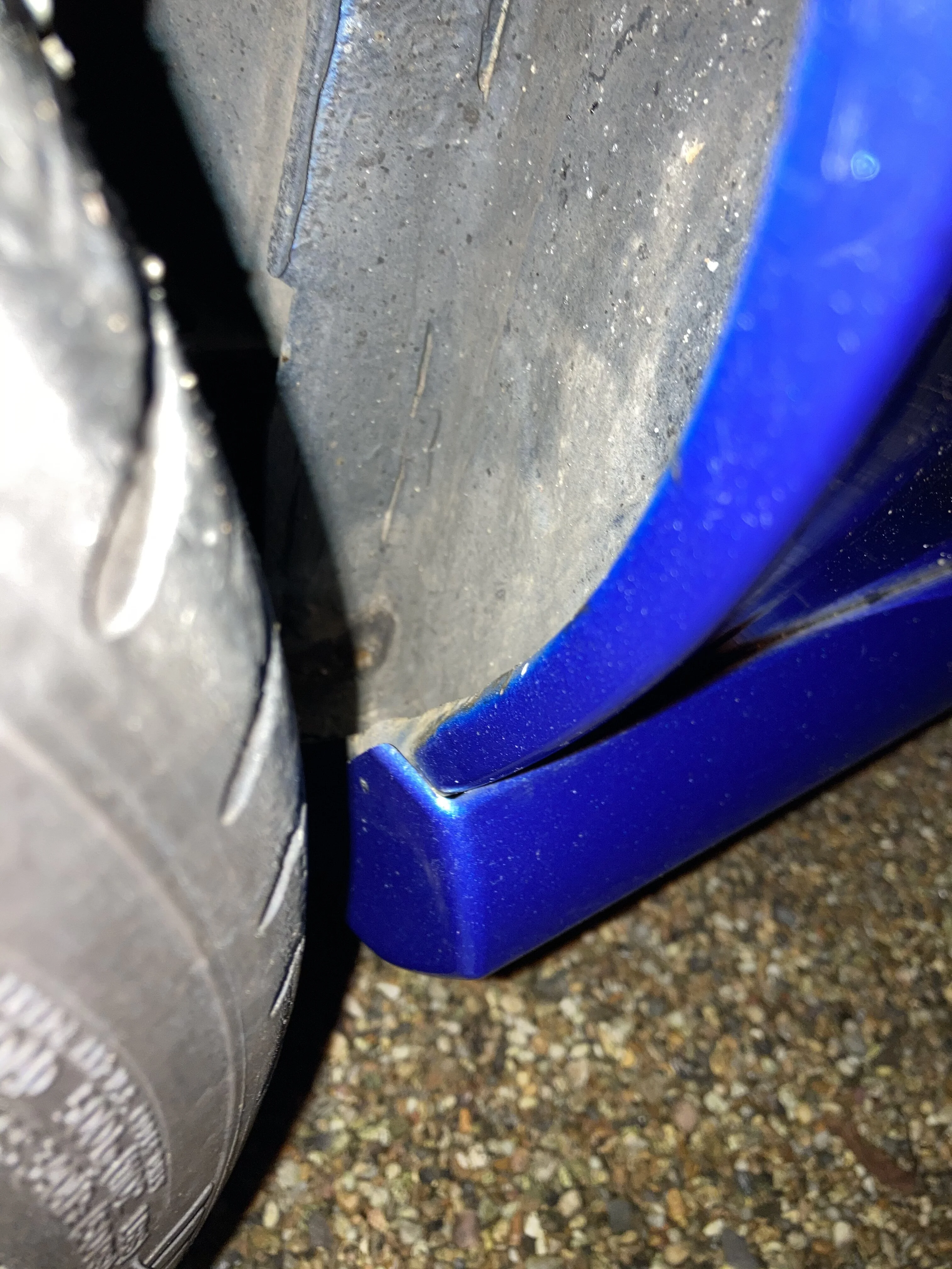

Surprised the sideskirts havent been mentioned. Majority are still rivetted on, drill the rivets out and inspect the rear portion, and around the jacking points. Mine appeared ok on the inside but was going outside and perforated in some areas.
I mentioned the sills earlier, but having just sorted mine I completely agree

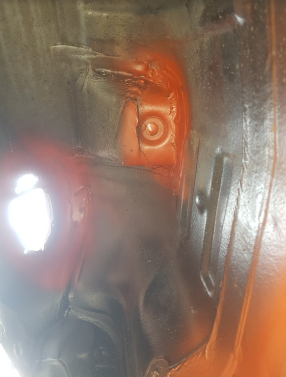

Stripping mine down at the moment and I find this.... I don't think would have been spotted with arch liner in place.
There is a damp spot right under it. I'm not 100% if it has started leaking yet though, or if it's from elsewhere.
Can confirm. Well hidden by the tank so would suggest removing and treating if planning on keeping the car for a while.
The red oxide coated areas conveniently highlight where i found surface rust on mine!
