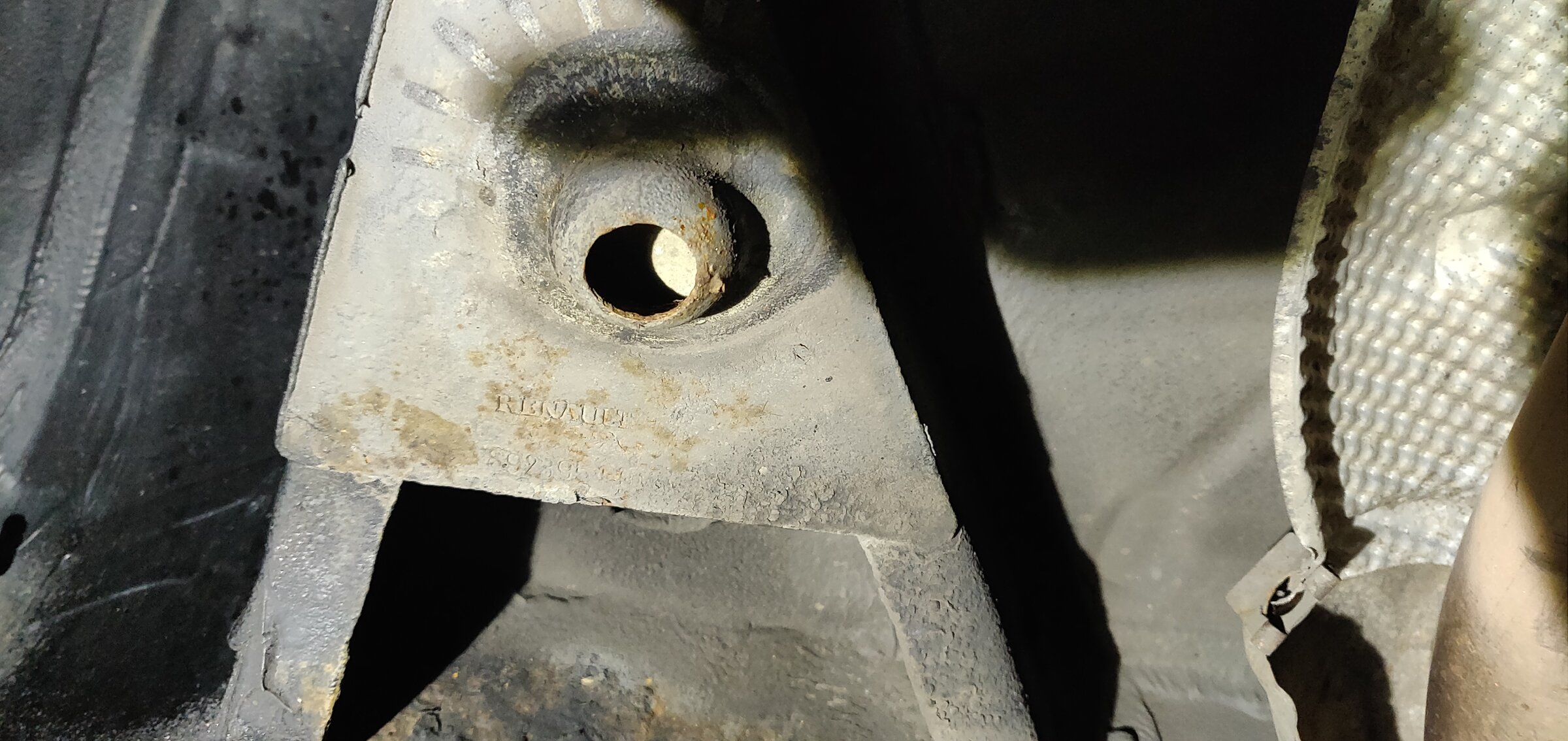

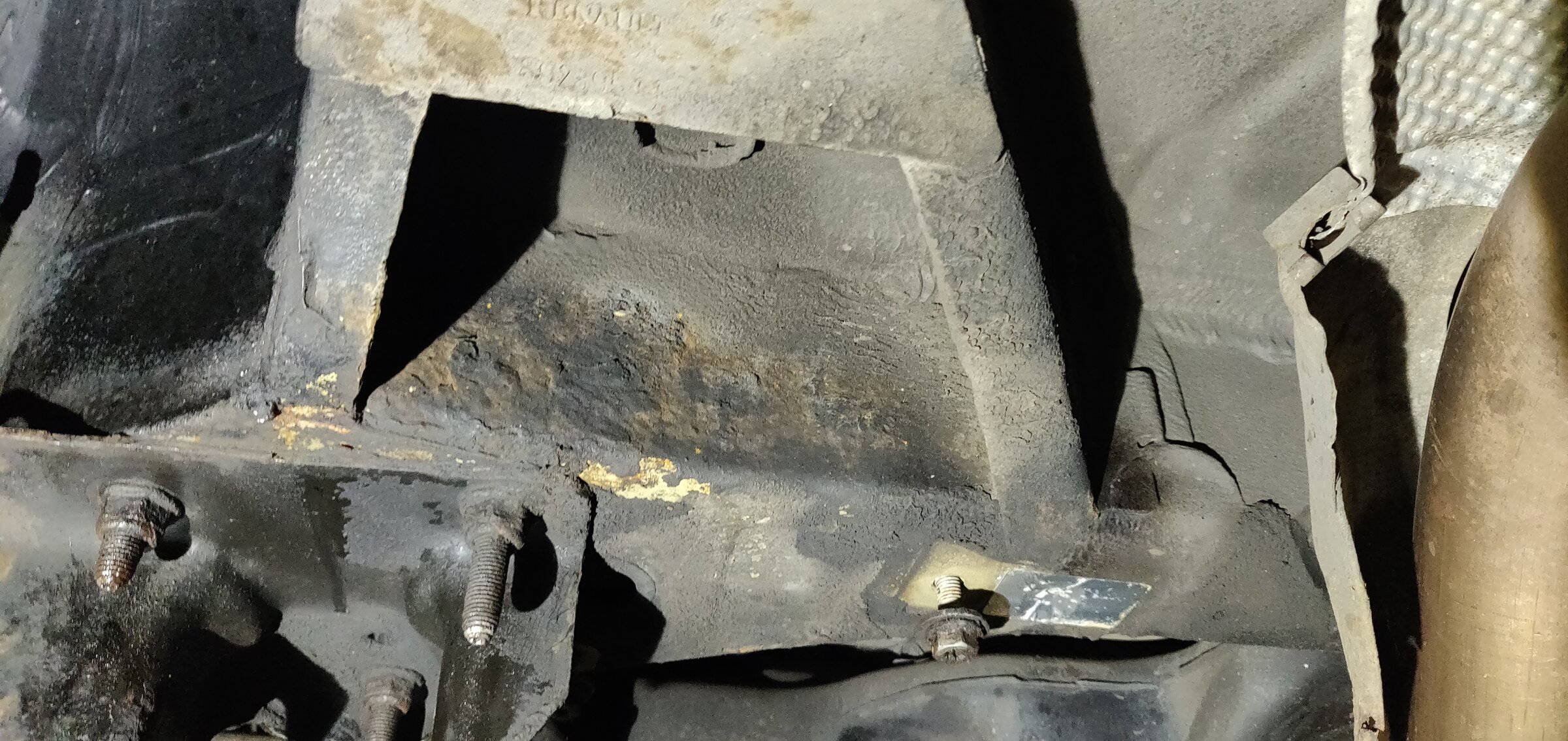

Hi,
I have been doing some corrosion maintenance on my Clio 182, and have discovered a few mud traps which don't appear widely discussed.
My findings were:
  1. A triangular shelf area between the rear axle mounts, tucked up high;
  2. Beside the fuel tank on the driver's side, adjacent the axle mounting point;
  3. Behind the front wheel arch liners, bottom of the A-post;
As the cars are now getting to an age where corrosion is properly setting in without preventative maintenance, may it be worth compiling a list of areas to inspect, clean and (if required) prepare, treat and paint / protect?

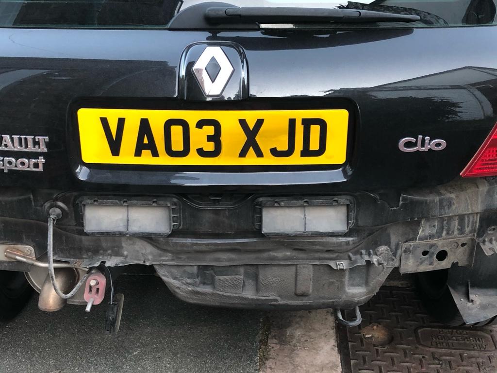

Same for the rear arches where they meet the bumpers. Grit gets trapped between the 2 panels and wears the paint away. Then the metal panel begins to corrode.

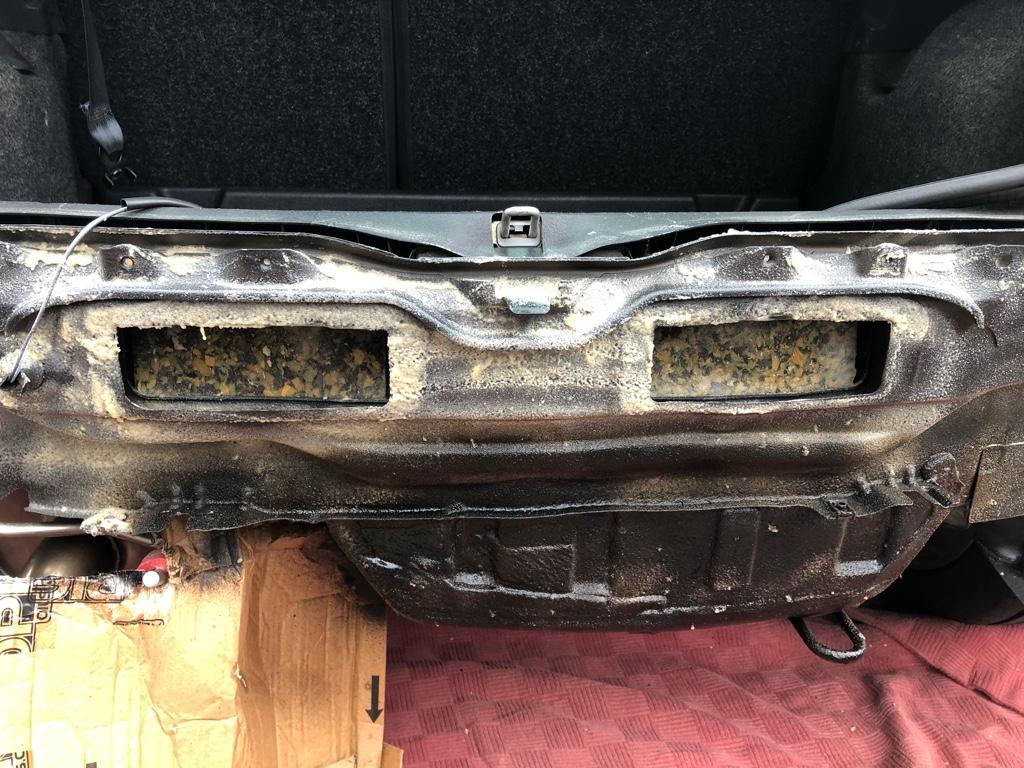

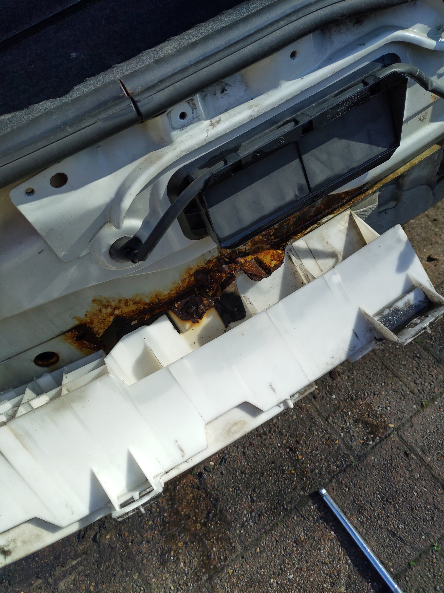

behind the rear bumper where it mounts to the body. This wasn't mine, was a 200k car but mine looked like if I didn't treat it it would start to go in the next few years

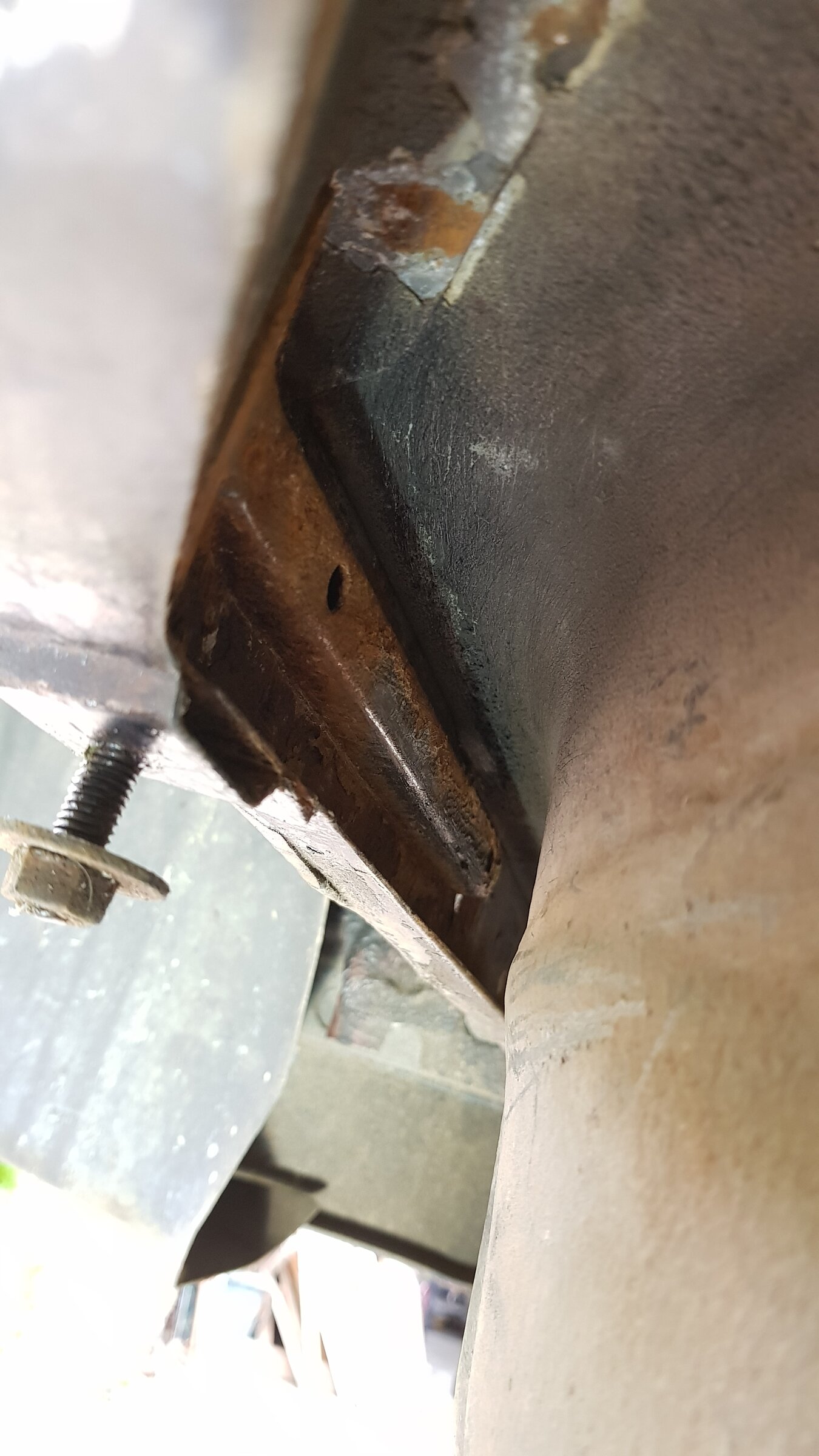

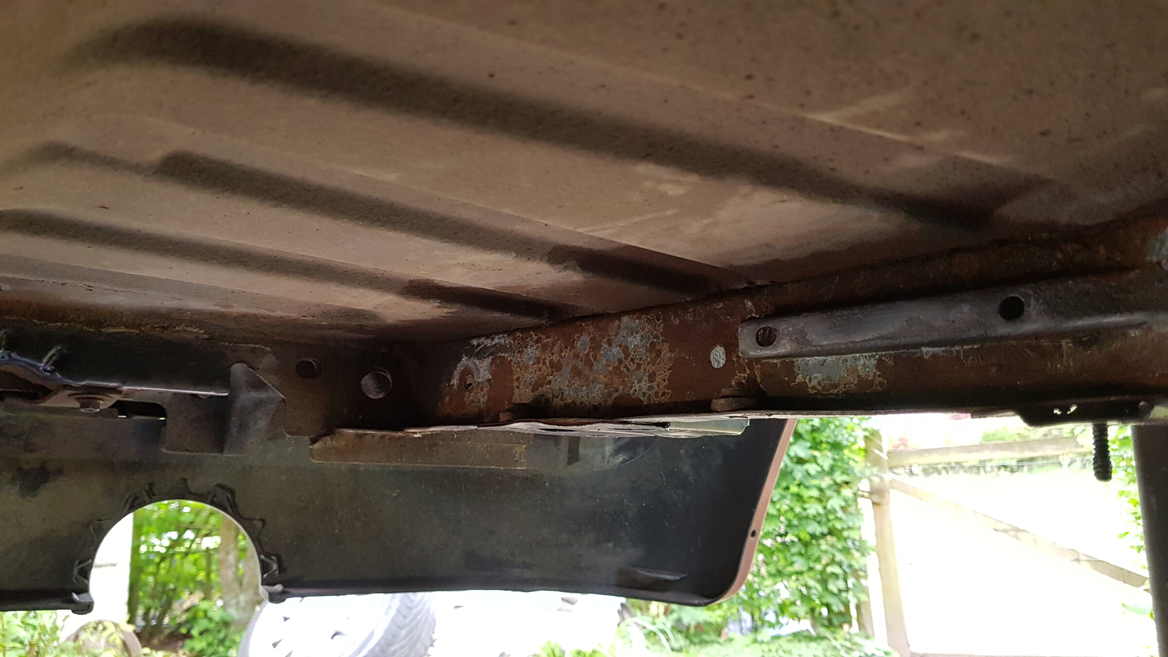

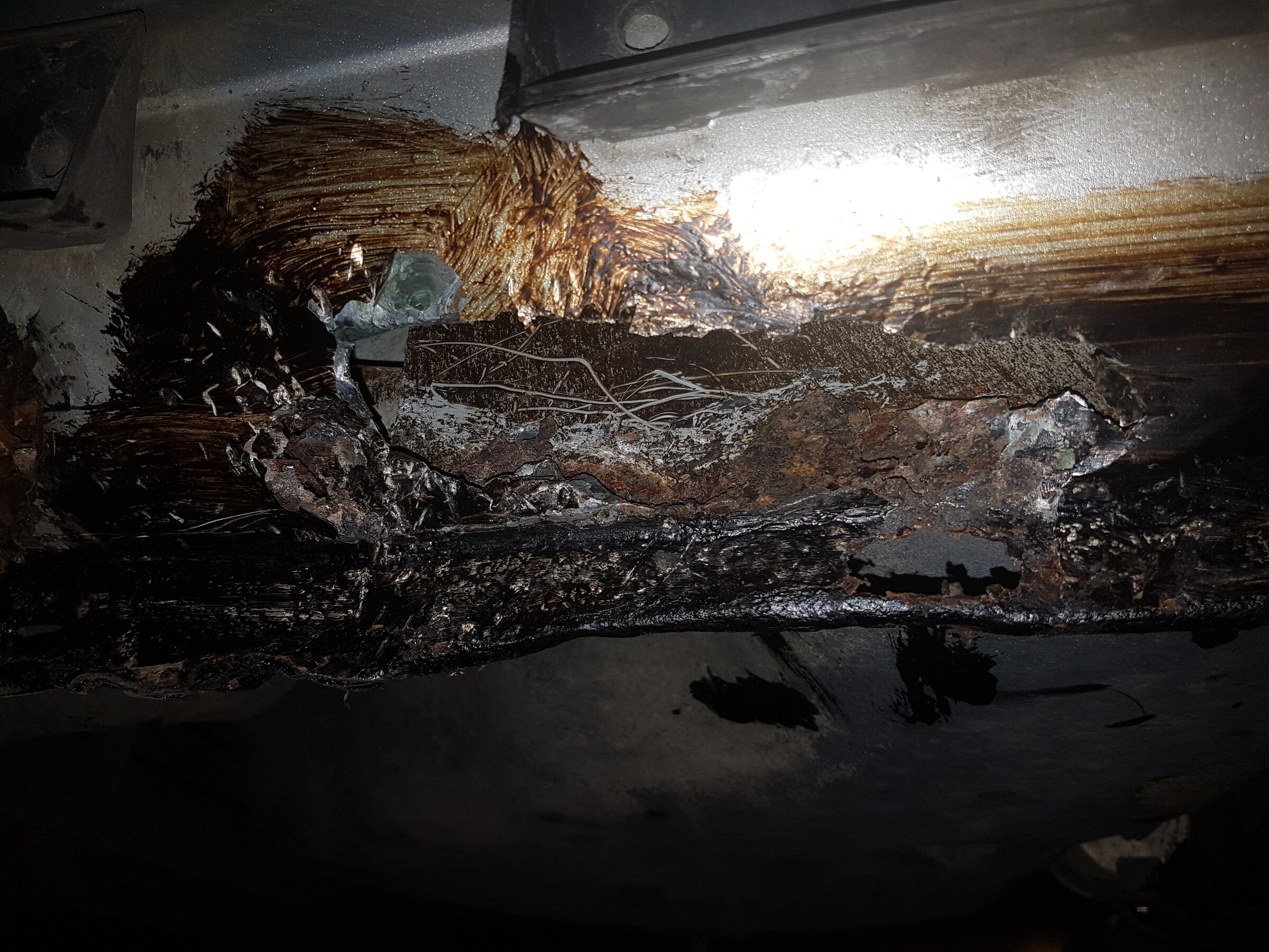

Look at this for rust trap that in a 172 is near to inaccessible, no problem on a 182 due to the boot floor.

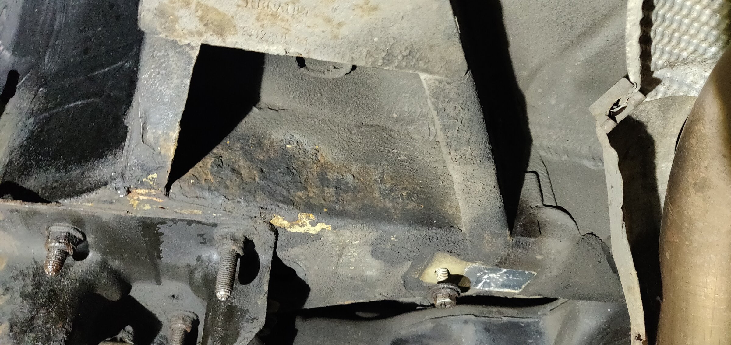

Started checking the areas on mine-
Good under the bumper, but gave it a good clean and the waxoyled
One small rub mark on the exterior of wheel well (no corrosion though) - so wafted some under-seal on it .
Few rub marks on the interior of the wheel well so painted with some satin black

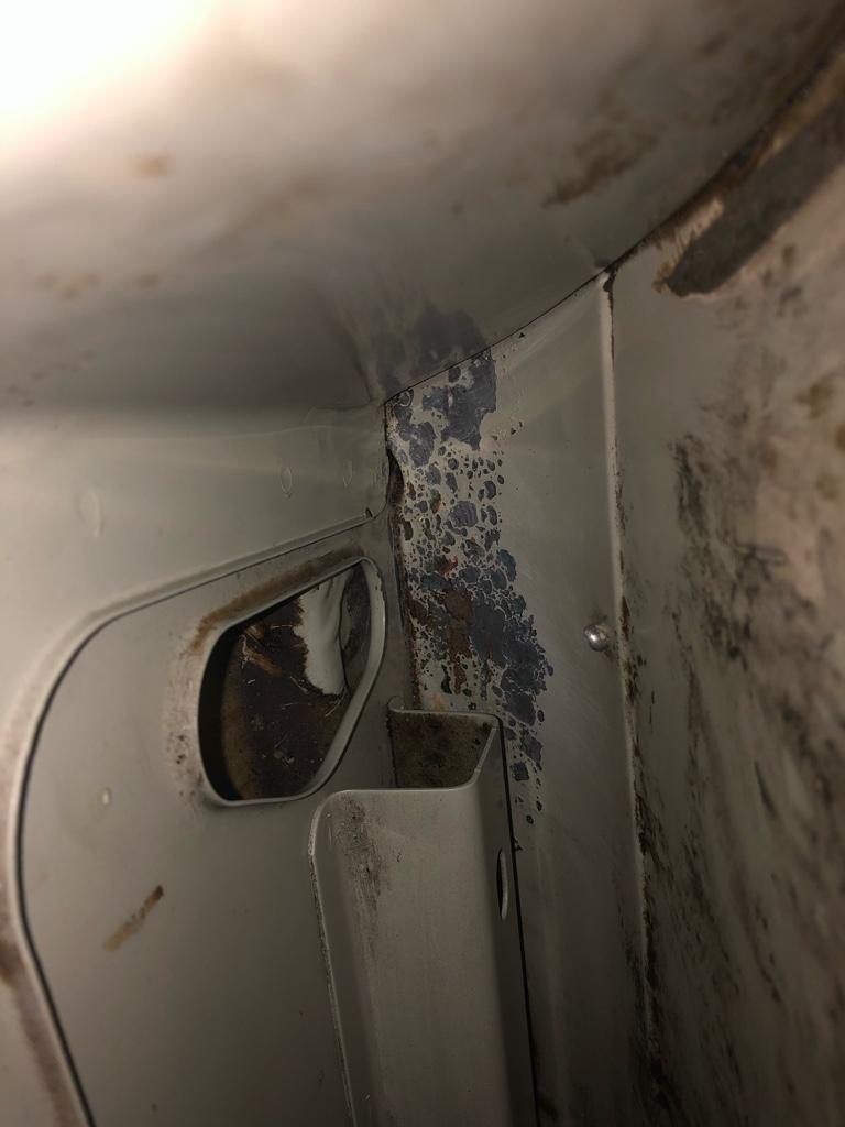

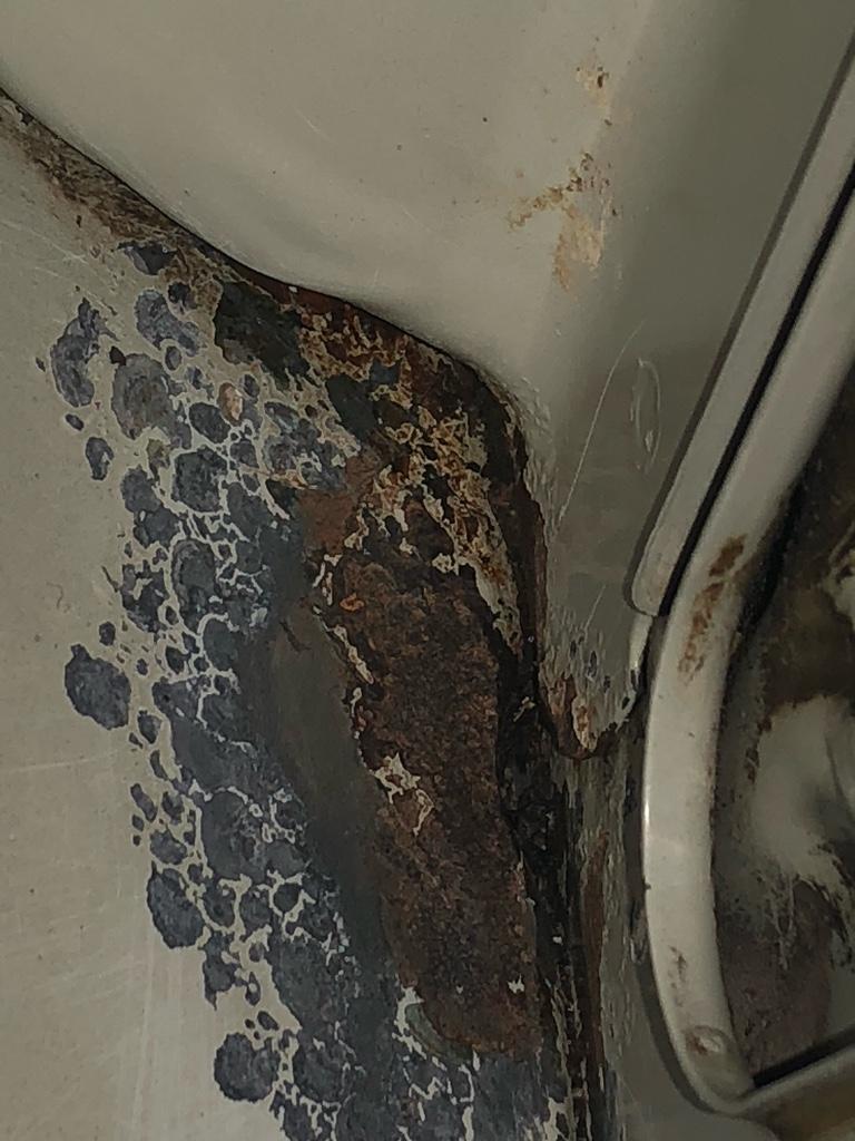

Next I checked behind rear cards in the inner sill.
Small amount of surface rust both side but absolutely solid
Actually looks far worse in pic than it is
I scraped/ sanded as best I could, then it’s had two coats of -
I have some POR 15 paint on the way and then some cavity wax
Above rear beam and petrol filler need some attention but going to wait until I can get on a ramp. Might use it as an excuse to replace the beam mounts for ployflex

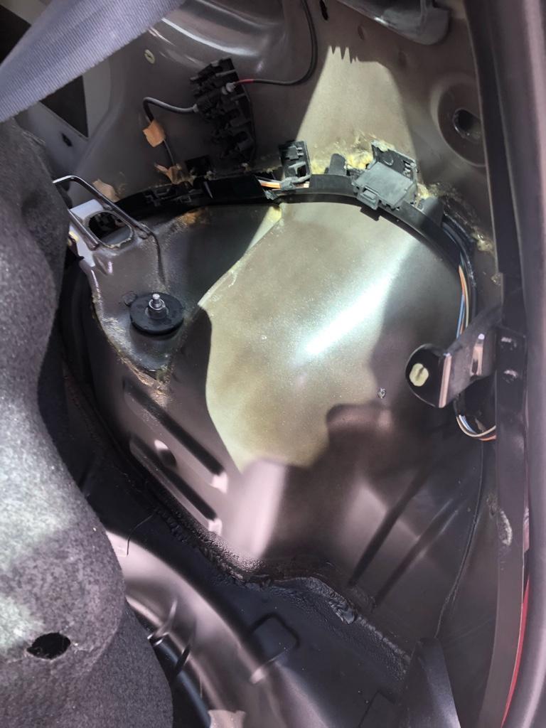

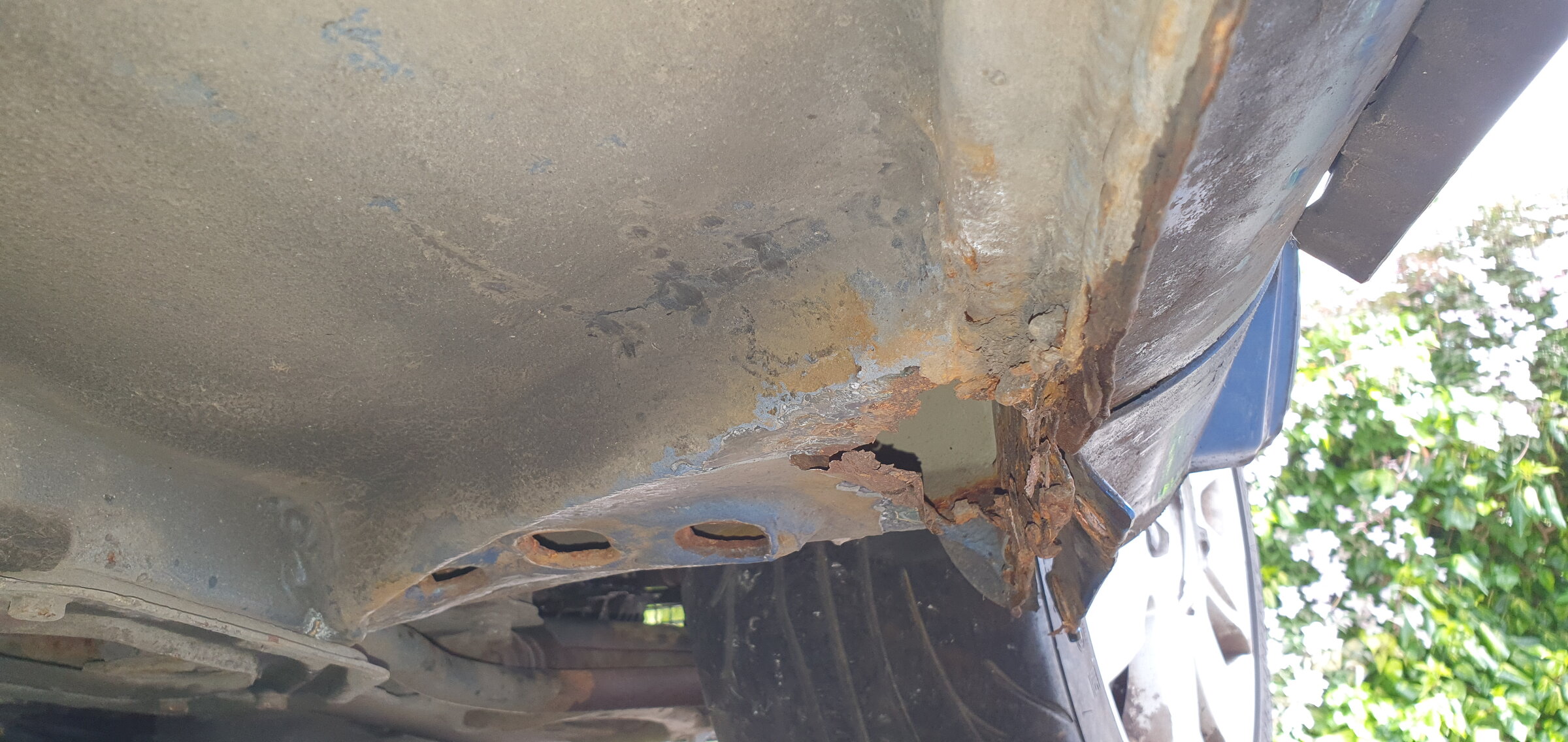

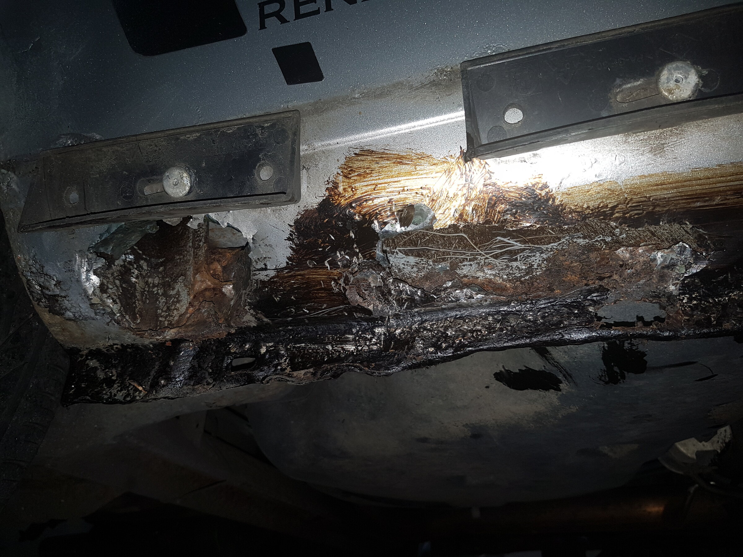

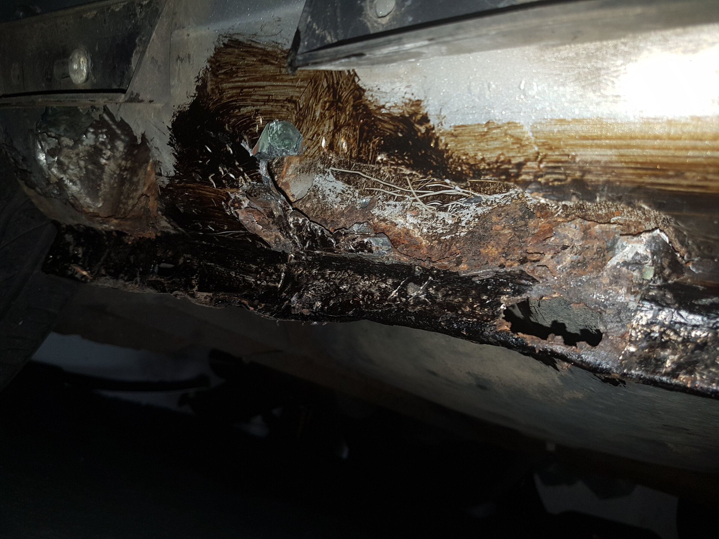

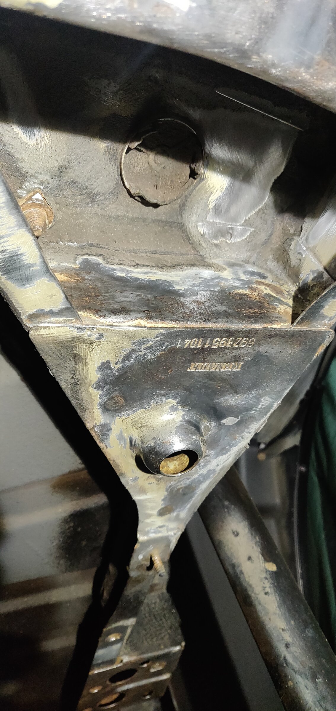

Where the rear inner arches meet the outer panel, if the underseals been punctured by a stone, water can creep under between the seam, visible from the inside of the car once rear side carpet in the boot is removed.
This area ?
Yes, if you pull the loom off its usually hidden by that!

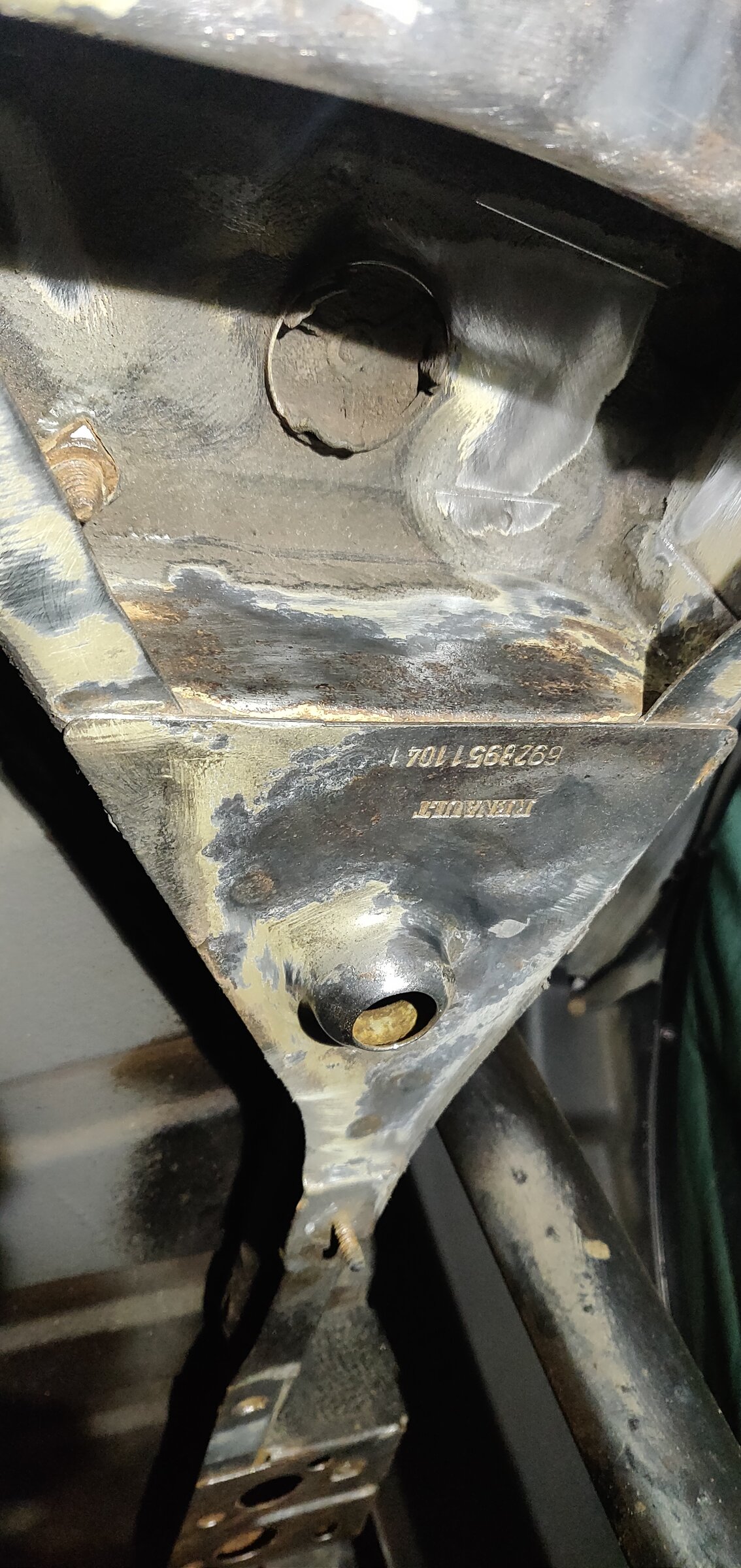

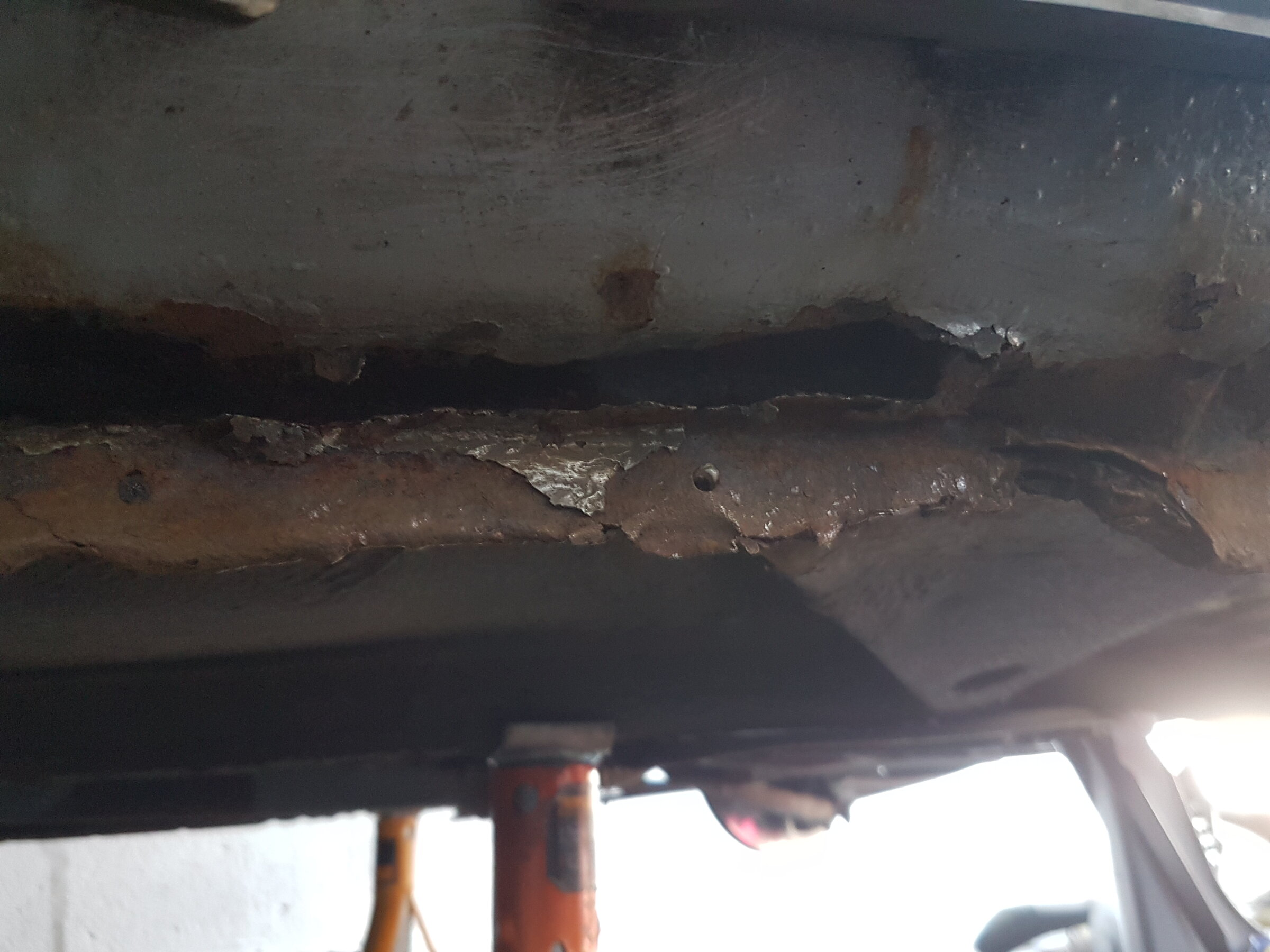

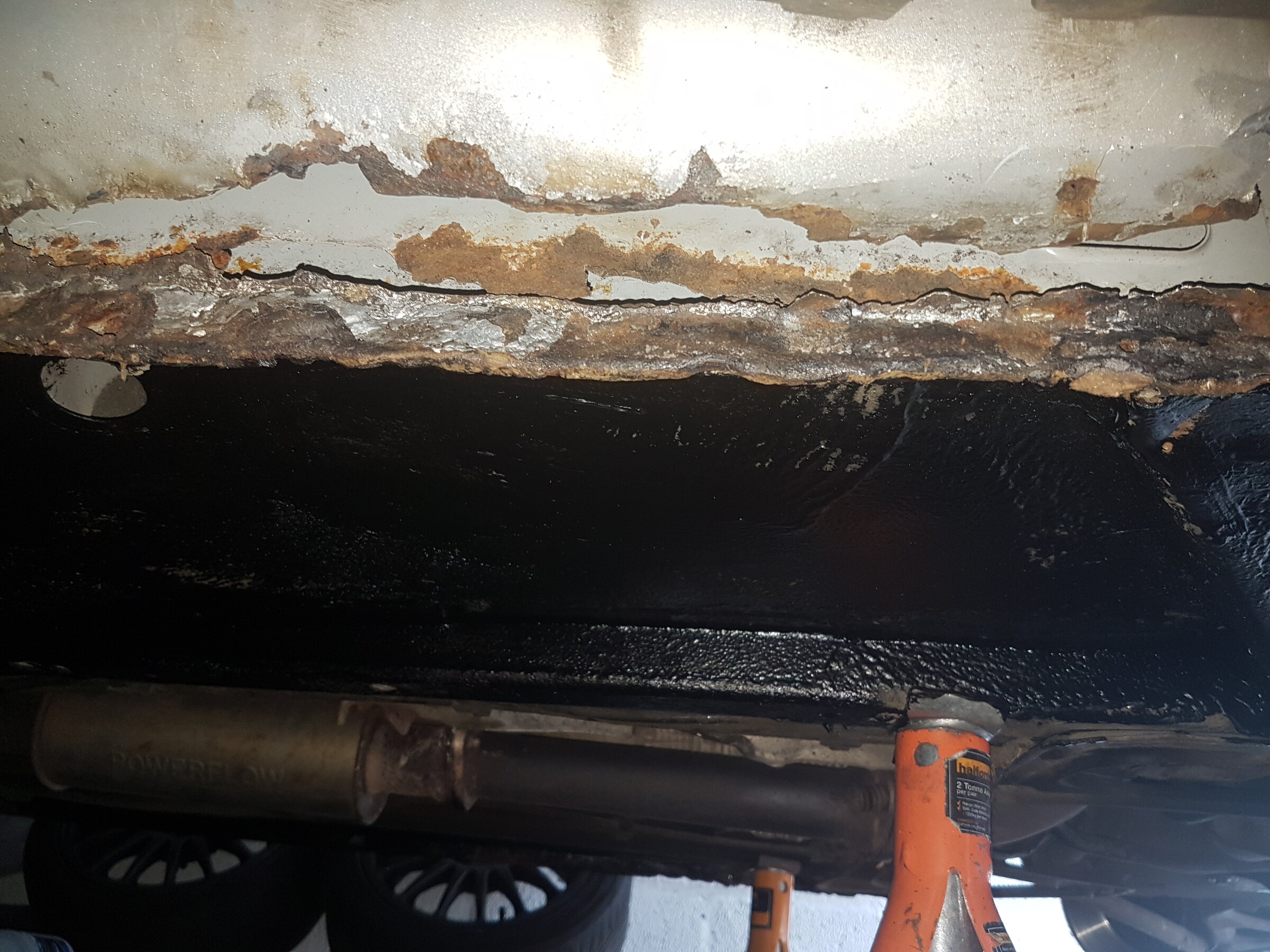

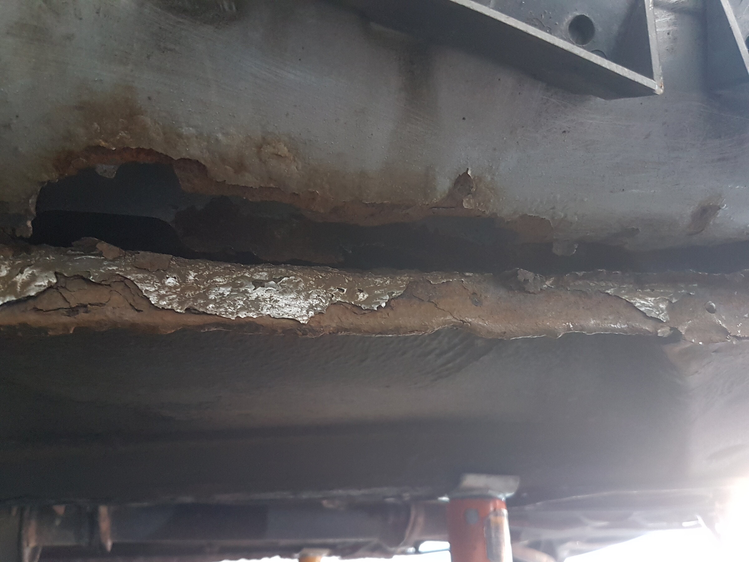

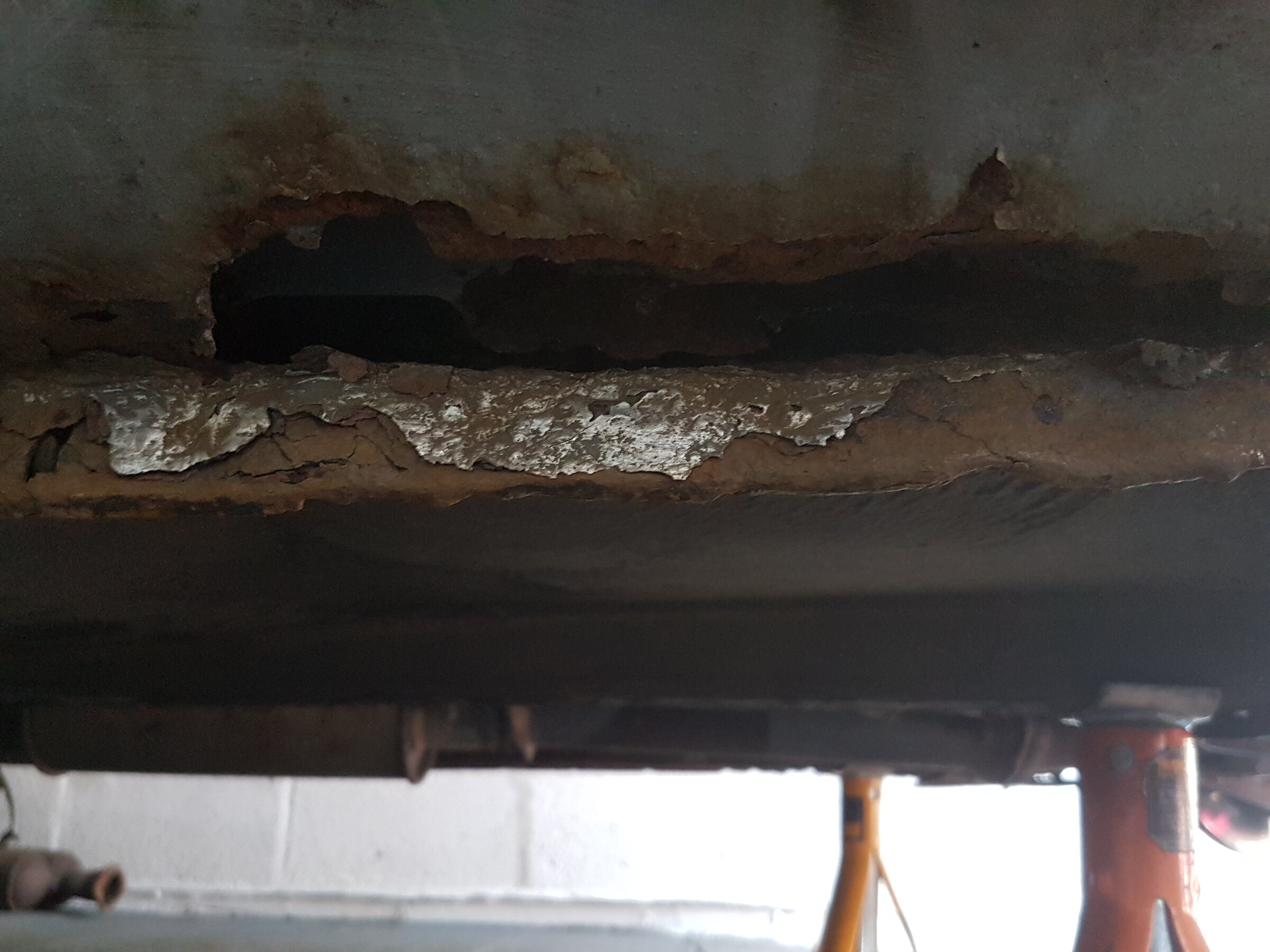

You can add the little floorpan strengthening sections with bungs in to the list. I think someone has jacked up on there before but it's taken out a big chunk of sill with it.
above happened to my 182 as some animal made a mess of jacking it up, had to have it chopped out and welded up
