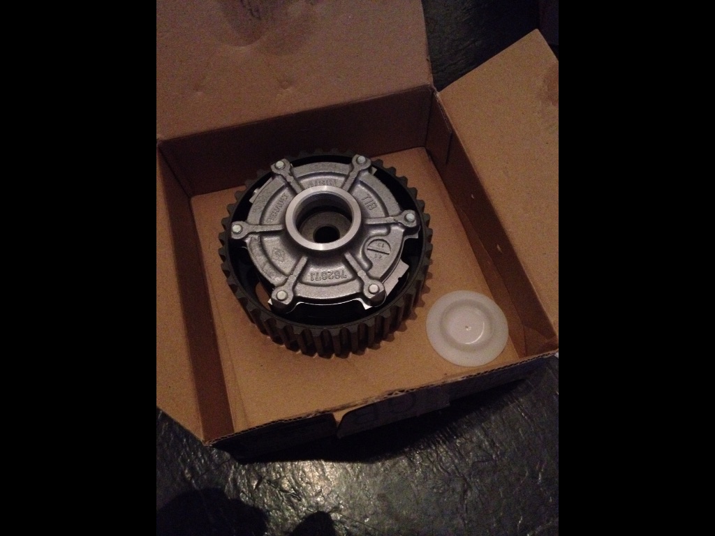

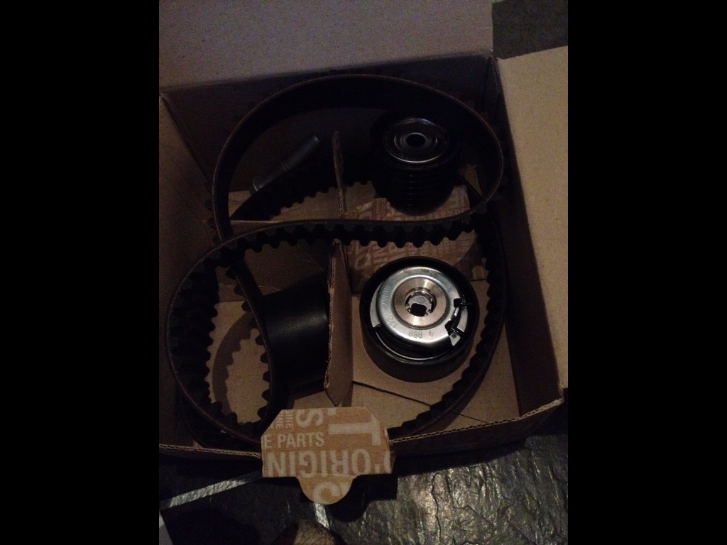

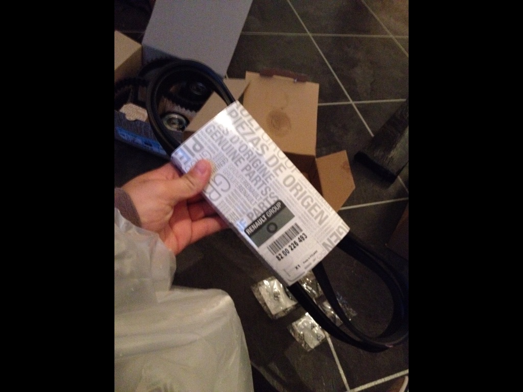

Booked in with Engine Dynamics for a Cambelt, Aux Belt, Dephaser and Waterpump change.

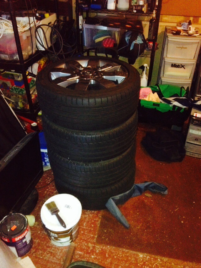

Going to clean and seal the new 182 alloys this week and fit them at the weekend, then its tracking and balancing.

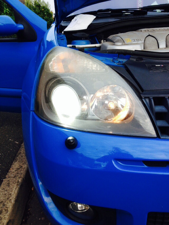

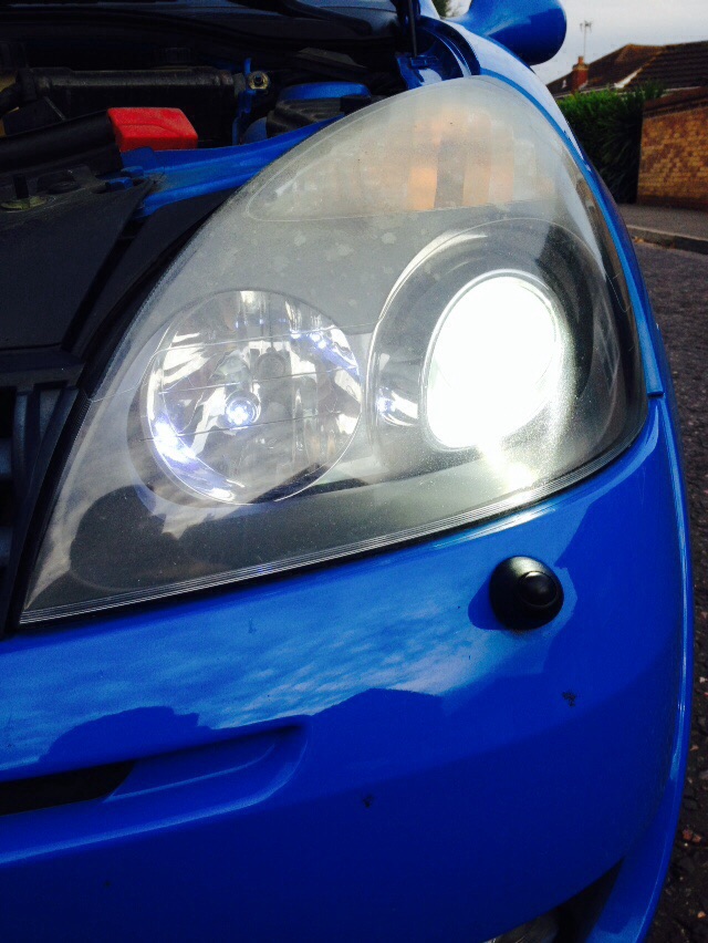

Are these bright at night? I bought some some months ago and they were so dull so put standard ones back in.. If so, possible link to where you got them from? Cars looking good, in need of a headlight refurb like mine [emoji4]
I'll have a look tonight and take a picture for you.
Yeah my headlights need a refurb really badly. I put silvervisions in after that, went to take a picture but you couldn't even see the bulb lol.
  Clio 182 - RB
Cheers pal, i'm in same position, can hardly tell that silver visions are in due to headlights [emoji85]

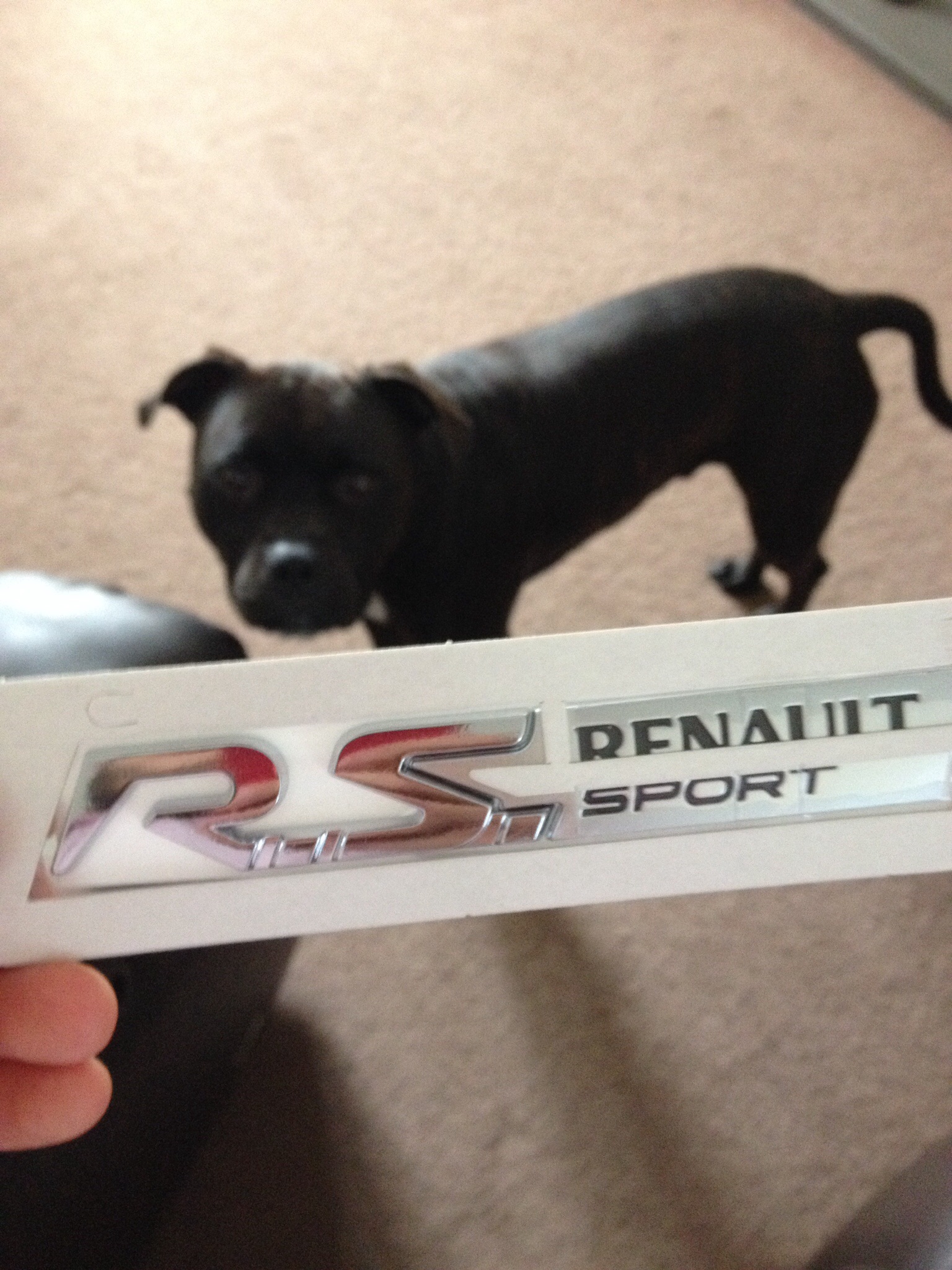

Tomorrow I fit my new alloys and tyres. Then I will get the tracking/balancing done.
I will also fit my silvervision side repeaters, and order a 3/4 front plate.
I have new white stripes in my basket in ebay. I will fit these at some point, along with my new style RS badge.

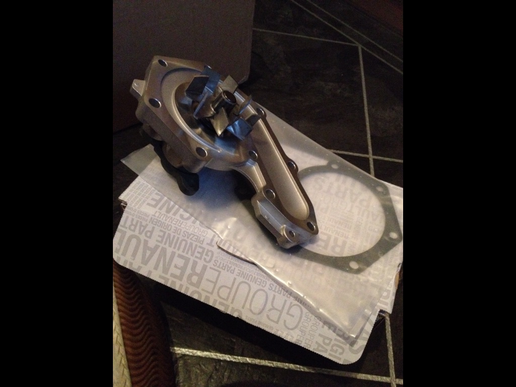

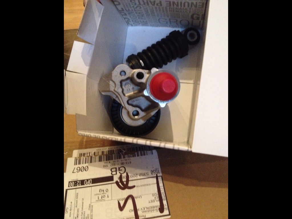

12th of September my car is getting:
Oil + Filter
Cambelt
Aux Belt
Dephaser Pulley
Water pump
Spark Plugs
Should drive like bloody new. (If you ignore the shagged engine mount).
