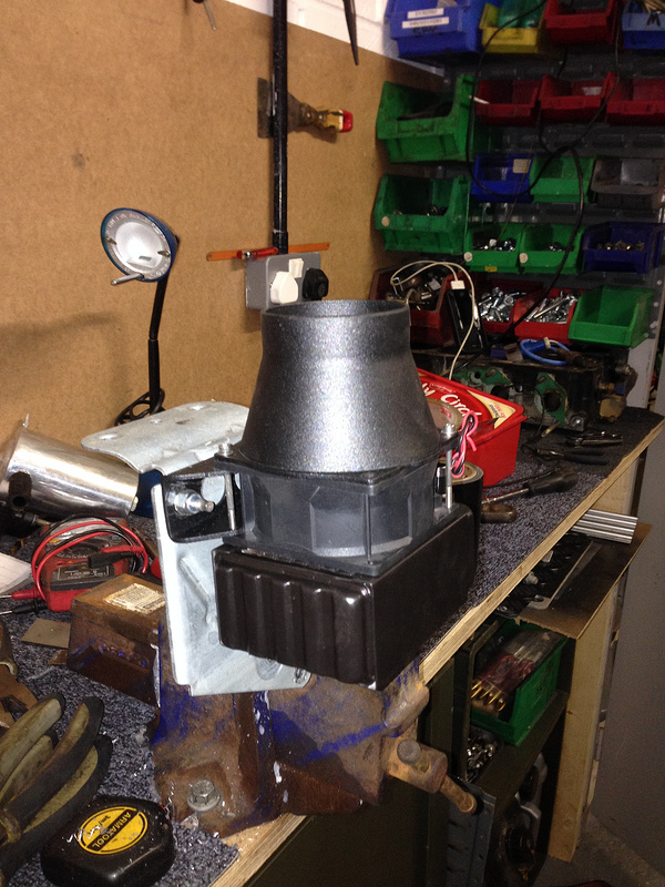

I have just ordered myself one of these.. I can now do away with the standard heater box and heavy fan! I only really need windscreen demist so its perfect, there is one fitted in the nova and it works brilliantly :)

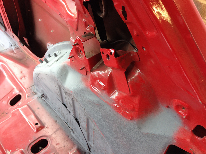

I started prepping the car to start painting it and cutter the final brackets out of the car. I had planned on drilling the welds out but the metal is so thin that when we pulled away it tried taking the rest of car with it.
Just some of the brackets I cut out, which the old rear bench used to bolt to.

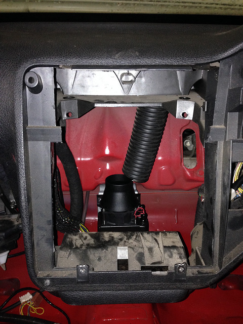

I also removed the old heater matrix which is being replaced by the one pictured above. Its quite amazing how much it weighed and how much room it took up behind the dash.

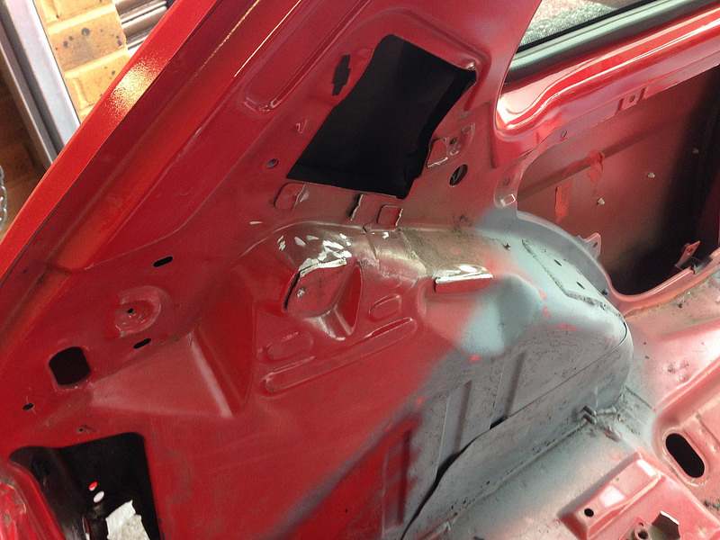

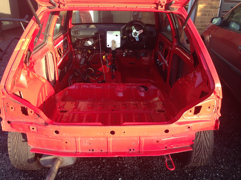

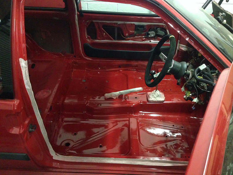

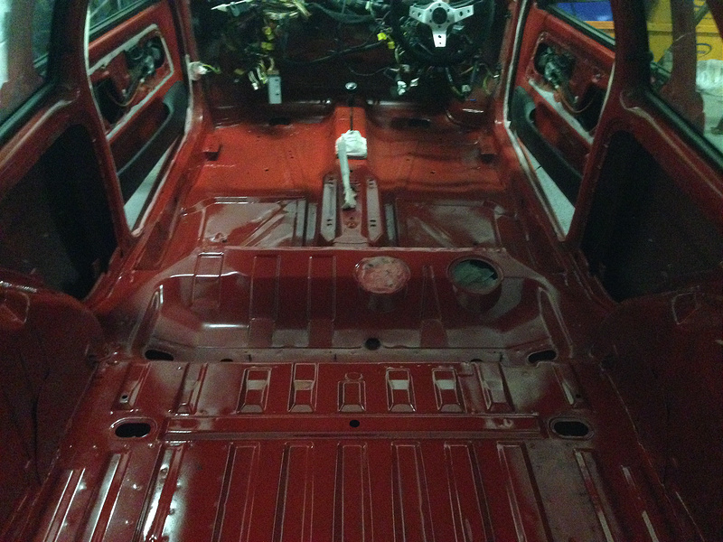

I then set to masking a few bits up and started painting the floor. I am happy with the results I applied around 2 coats before running out of paint. Halfords will hopefully be back in stock on Thursday which should allow me to finish the boot floor.
Its Finally looking red again -

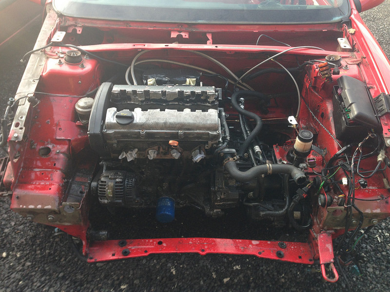

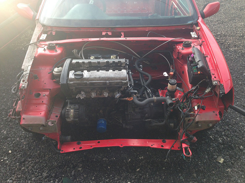

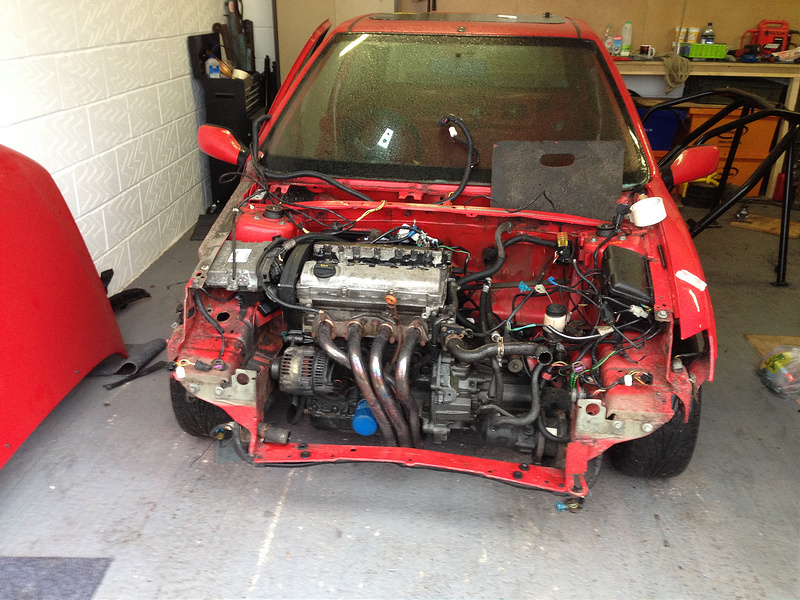

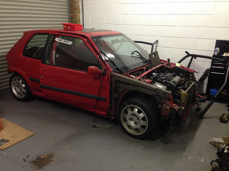

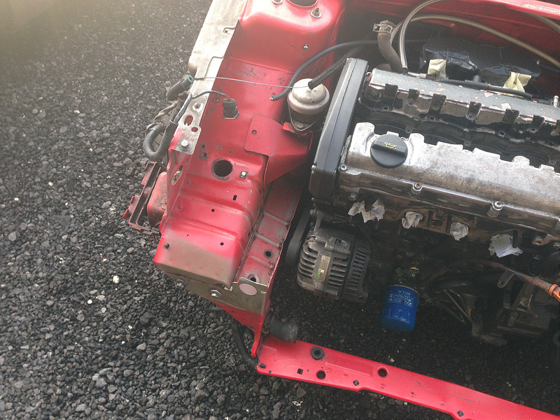

While waiting for the paint to dry I set on removing the brake servo so I could get access to the bulkhead to install the new brake and fuel lines. I also removed the bonnet as it was doing my head in and also the front slam panel so I could get it painted up. I removed the radiator so I can get the manifold out easier to heat wrap and also cut out the old support which the radiator sits on and weld a new one in which isn't bent up and also fit a bracket for the oil cooler.
While it was in bits I also got the wing off ready for underseal and got shot of the charcoal canister.

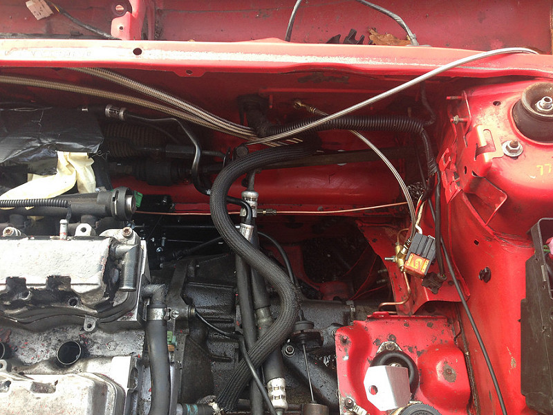

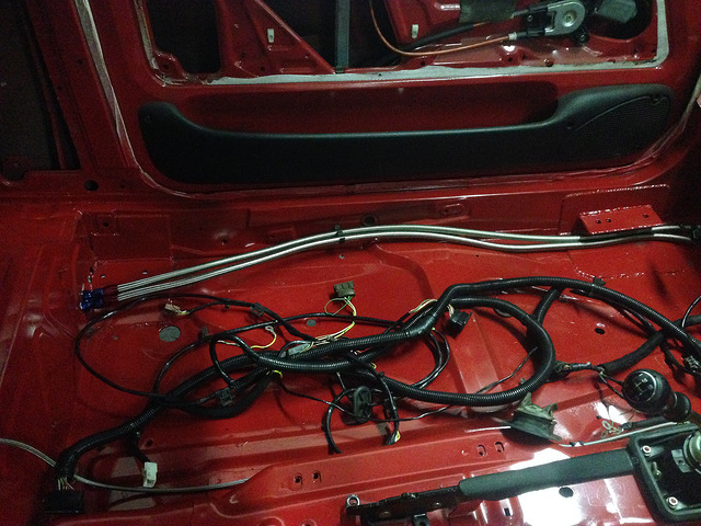

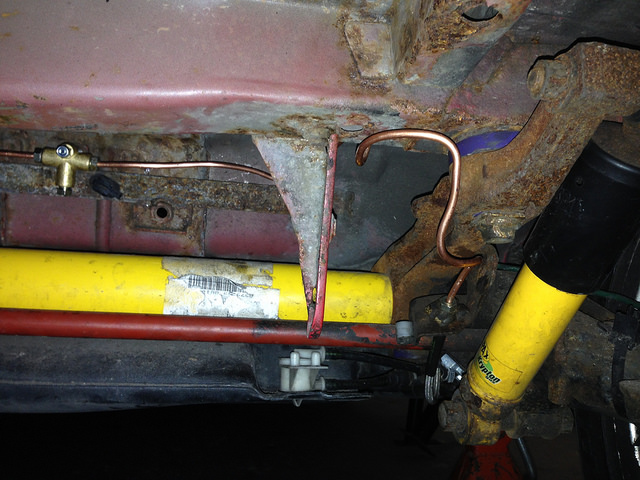

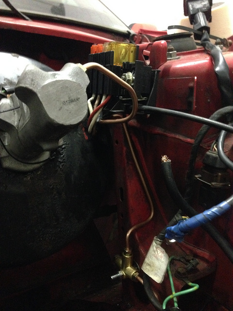

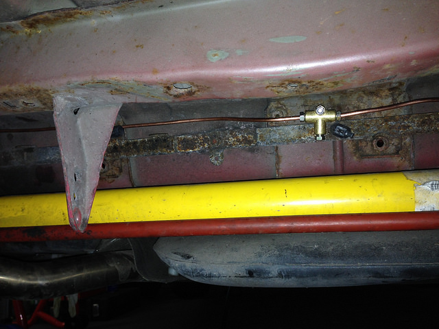

So Saturday morning, I started fitting the rear breaklines as I couldn't contiue painting the rear of the car or fit the in car brake lines because I forgot to order the bulkhead connectors ... Doh! I opted for copper brake lines purely because of cost at this stage and I quite enjoyed learning to fit copper lines.
The rear brake lines -

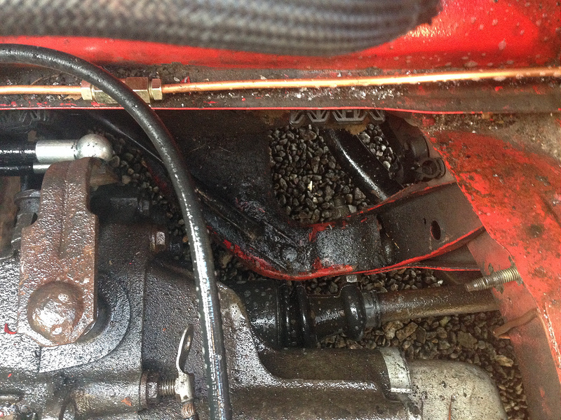

After getting the hang of making them up, I popped the servo and master cylinder back in place, got adventurous and started the fronts -

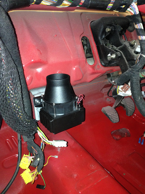

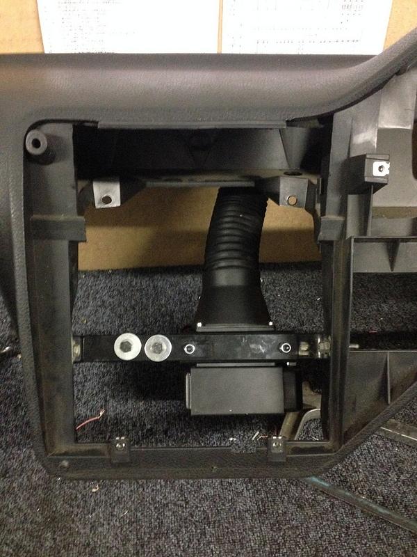

Feeling rather happy I then started on making up a bracket for the new heater which arrived on Friday :)
I modified the old airbag ecu bracket which worked perfectly.
The heater in its new home..
I made up a new panel that the ducting fits in to and puts the air in to the correct parts of the dashboard. The only issue was the ducting was about 100mm to short.

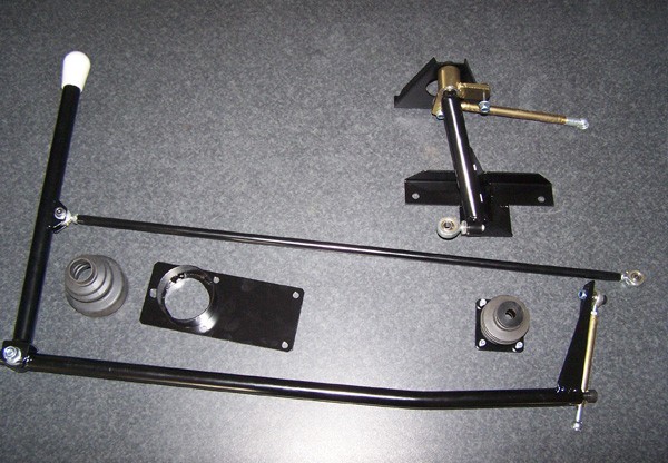

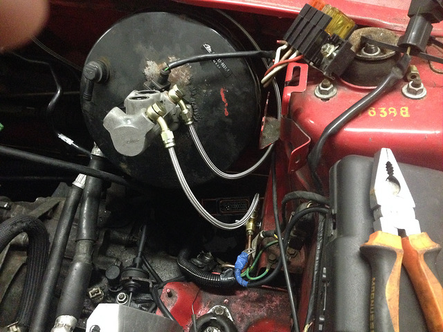

Ok so this month is getting expensive... I have just ordered this -
braided Fuel and brakelines are now fitted in the car along with bias valve, its slowly coming together now, but I still have a massive list of jobs left to do.

Cracking choice on the satchshift.

Not yet mate it's on order ATM. So should arrive in the next 2-3 weeks.
Awesome!! Let me know if you want a hand fitting it or getting it fitted.
I miss my GTI. Would be perfect in the garage to tinker with.
Cheers, They are fun to work on and quite easy most of the time.

You wont regret that satchshift. Mine is probably the best mod ive done to the car. Can be a right b**ch to fit though.

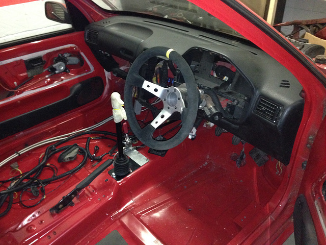

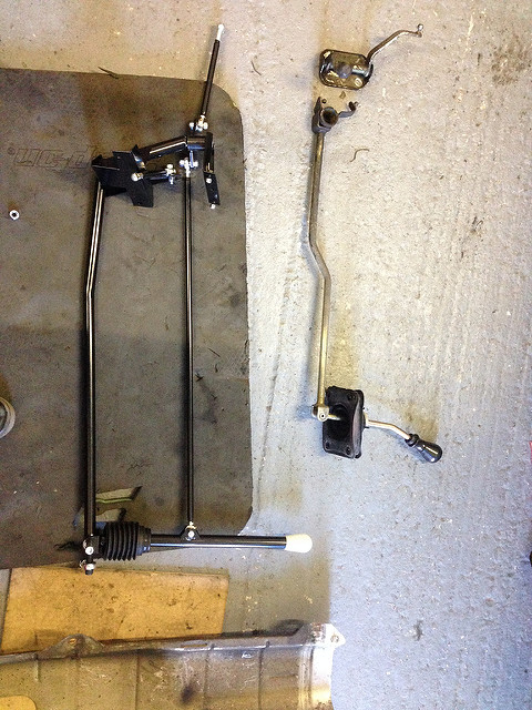

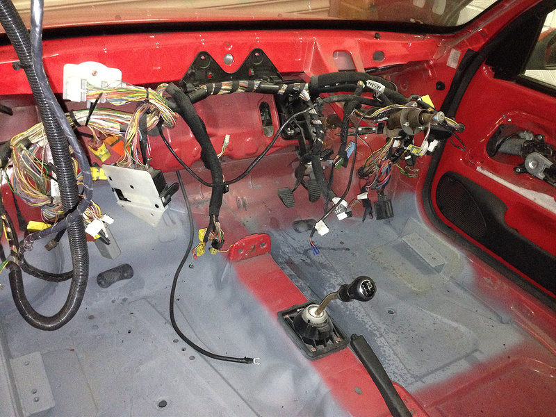

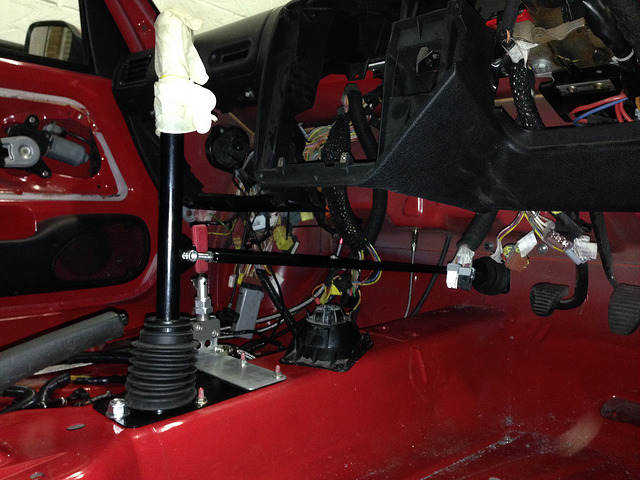

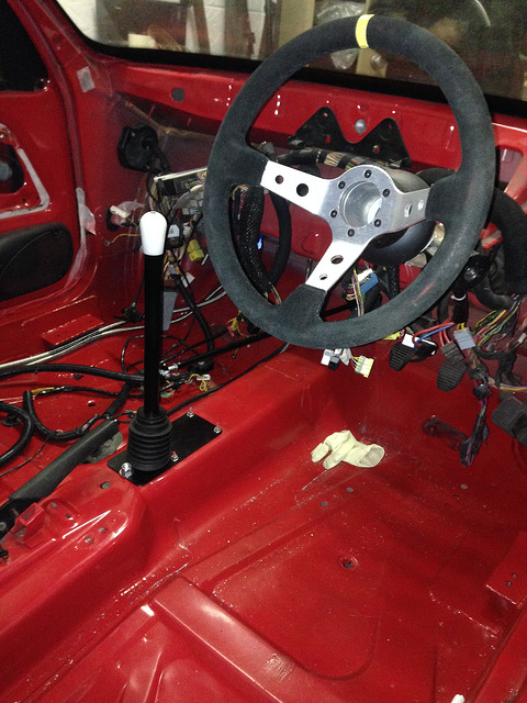

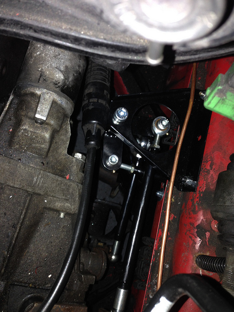

Well I got pretty much a whole day on the car today got the satchshift fitted finally which after many many swear words, cups of tea I got it fitted.. First of all I had to remove the old linkage.
Out with the old in with the new..
By this point Fletcher had arrived for a catchup and to see the car.. he even helped a little!! I didn't take many photos of the fitting process as I was rather vocal about it and it involved me swearing at it, hitting it and by 4pm this afternoon the car was getting scrapped lol! But I persuaded myself not to and plodded on after a sit down and a cup of tea.
This is finally the new kit fitted.. excuse the wiring thats next!
The linkage ..

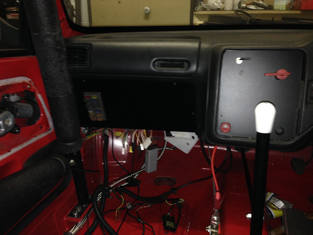

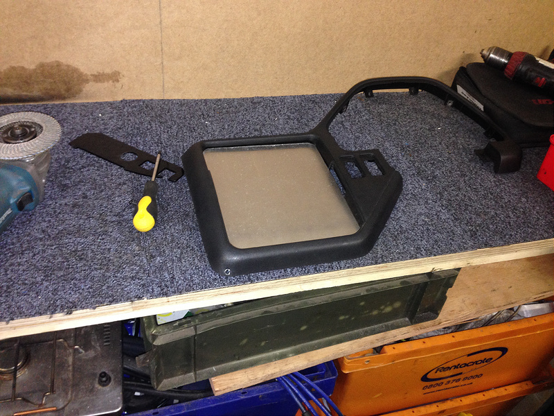

After I got it fitted I had to modify the dashboard to fit around the top bar.. so instead of just making hole or cutting small bit out of the bottom I got rid of the ashtray. I think the dash looks so much better without.
Dashboard in place..
Excuse the glove I didn't want to get the white bit dirty and oily.
No ash tray..
Over the past few days I have also sorted the fuel lines and brake lines out.. I have now changed the ones going form the master cylinder to braided line.

Yea it's just a very snazzy short throw kit for the car. The full setup is rose jointed and does away with any existing linkage. I can't wait to test it out.

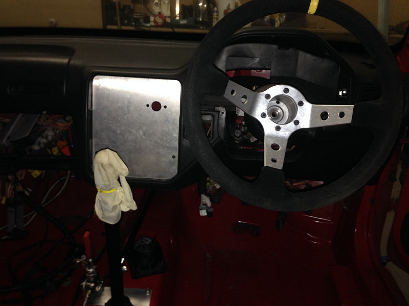

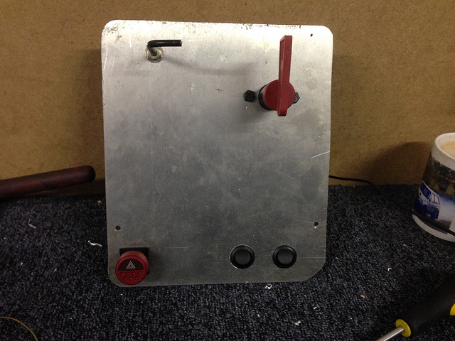

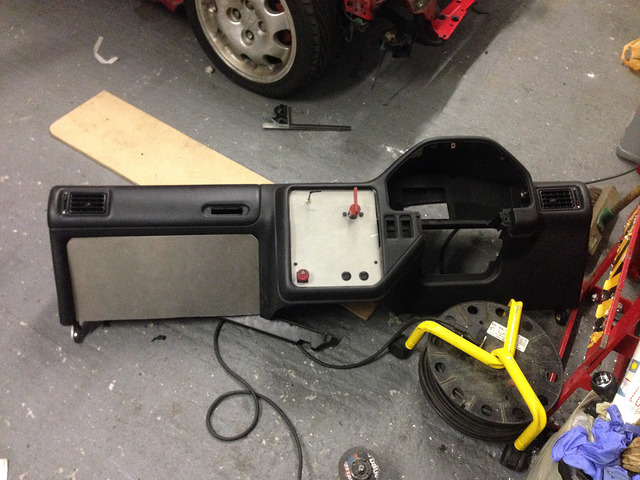

I got a few bits done Sunday, I started making the new centre dash panel which I am going to get powder coated once all the wholes are drilled in the right places.
dash panel in place.. I just need to get the switches fitted.

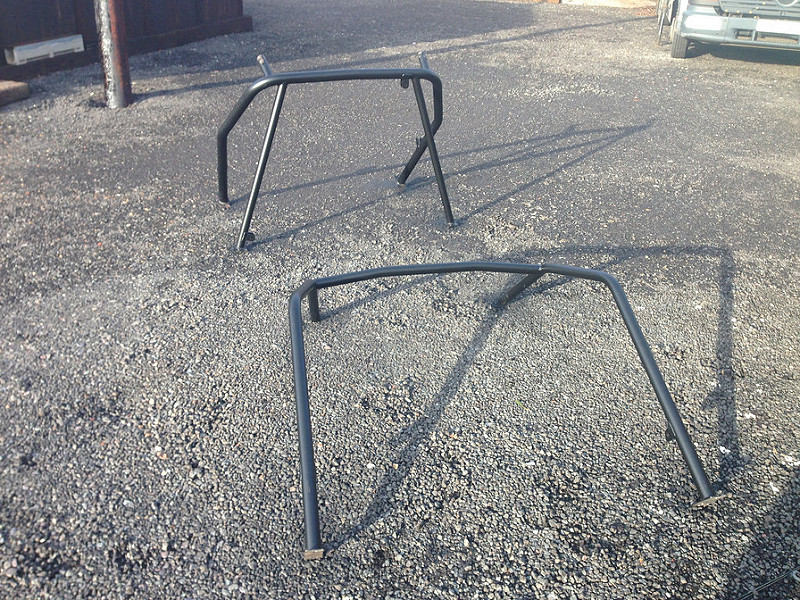

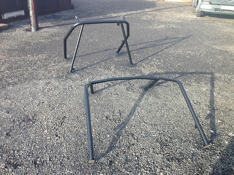

I also got some paint on the roll cage before the rain arrived, just gave it a quick blast with Matt black to cover some of the scratches, its going to mainly be covered in cage padding so it doesn't need to be perfect.

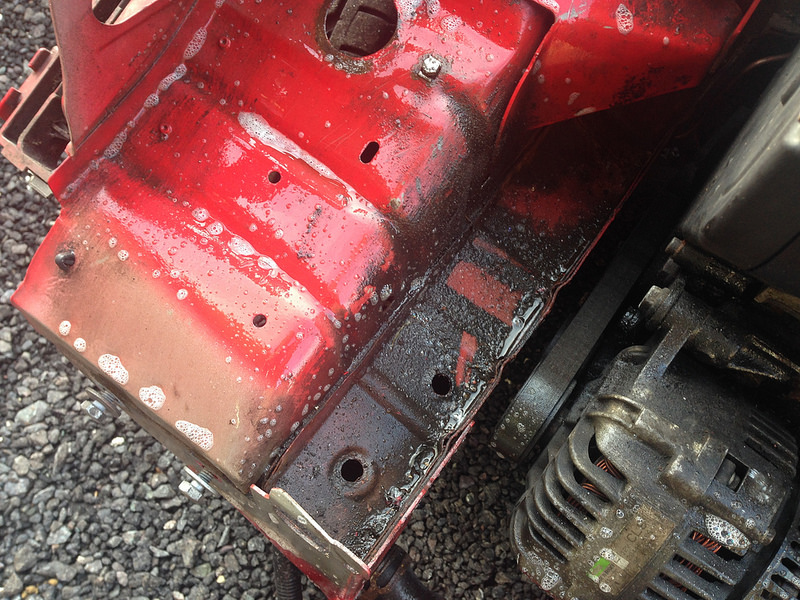

I decided to get the bulk of the dirt and grime out of the engine bay so I covered in degreaser and started scrubbing. Its by no means spotless and never will be lol.
before -
After -

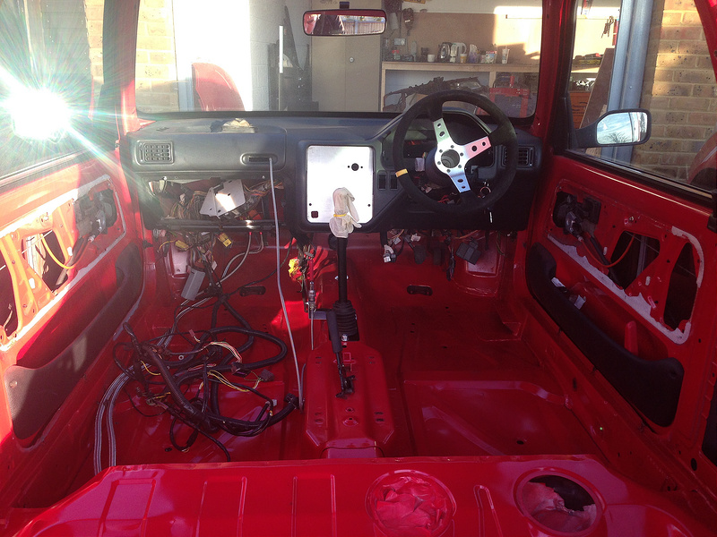

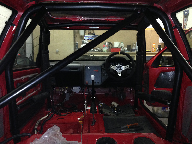

Lots of progress made over the past few days...

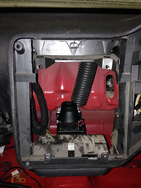

remounted the heater in to the dash and got it piped up.
I cut a new dash panel to replace the glovebox and also got the bits fitted to the centre dash panel.

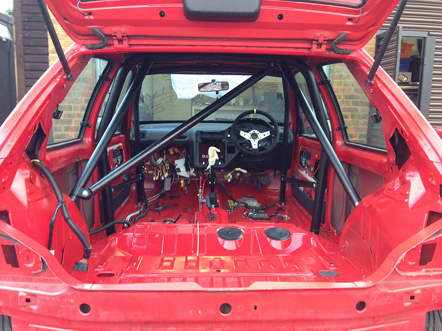

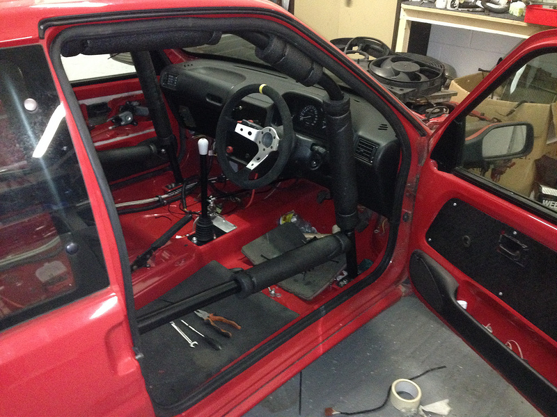

I then got the cage fitted, which went in very easily thank god..
Once fitted I finished painting up the dash panels and got the rest of the dash fitted along with the roll cage padding. The car is finally starting to look like a car again.
Few more bits to finish up inside next week and then I can move on putting the outside of the car back together :)
