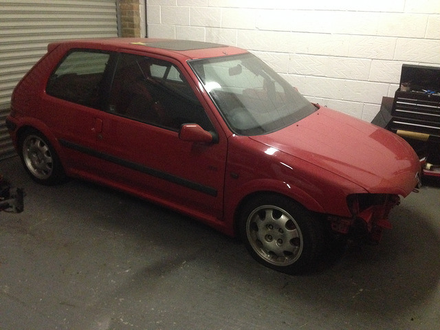

Update..
Well over the past few weeks I took sometime off from working on the car as I was starting to loose my motivation for going down nearly every night.. not to mention my wallet was becoming thinner by the day.

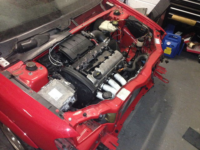

However during this time a few things have changed, while the cam covers where off the car I decided to try and find out what cams had been fitted to the car (Supposedly) when I bought it. There is even a receipt with the car for fast road cams, after getting measuring the duration I discovered the the cams are completely standard!!
I did at the time feel rather hard done by but after thinking about, the car pulls really well and I now looking forward to seeing what the car is like with new cams later on in the year. After all power isn't everything and I would rather spend the money doing some events rather than throwing money in to the engine for the sake of a few more BHP.

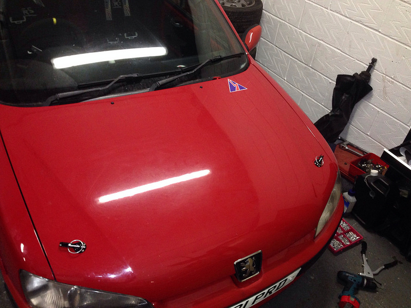

In other news the car is now looking more like a car and is now back together (ish) I refitted my heat wrapped manifold and also got the all coolant pipes and electrics plumbed back in the engine bay over the past few weeks. I have also decided to get shot of the simota enclosed style air filter and just go for a standard foam filter as it was a ball ache to remove and refit.
I know I still need to get the rocker covers painted but I do have a spare set that I will get sent off for powder coating in the next few weeks. I started the engine last night and got everything back up to temperature, however not without issues... I relied on a friend to help me with the car a few weeks back, he refitted the rocker cover and did a totally dog s**t job of it, so it was spraying out oil everywhere so I resealed that before I left last night. The bleed screw on the thermostat housing snapped so I had to replace that luckily I had spare sat on another engine but again not ideal and of course a small fuel leak in the car which was just a cad elf tweaking up the fuel lines.

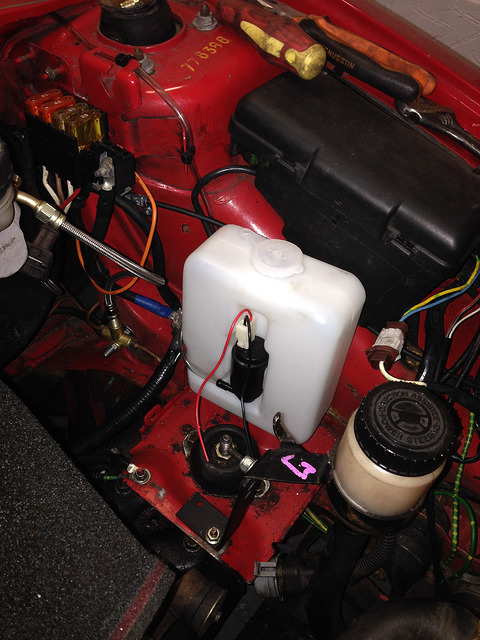

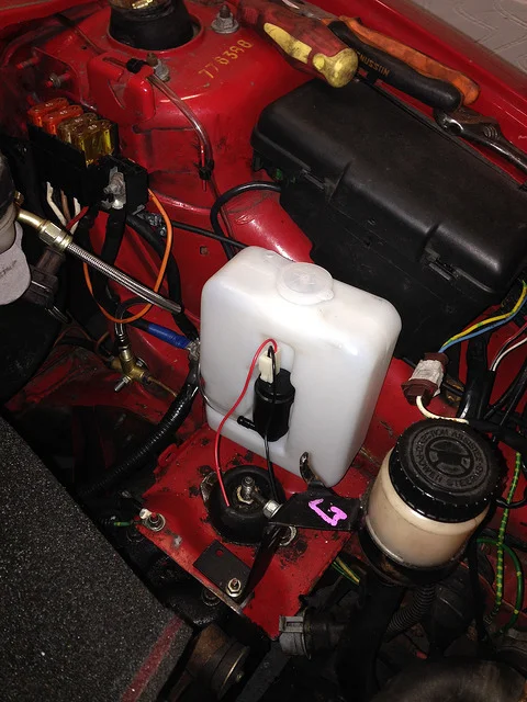

Another job was to fit my new washer bottle.. I got shot of the standard one which just hangs in the wheel arch.

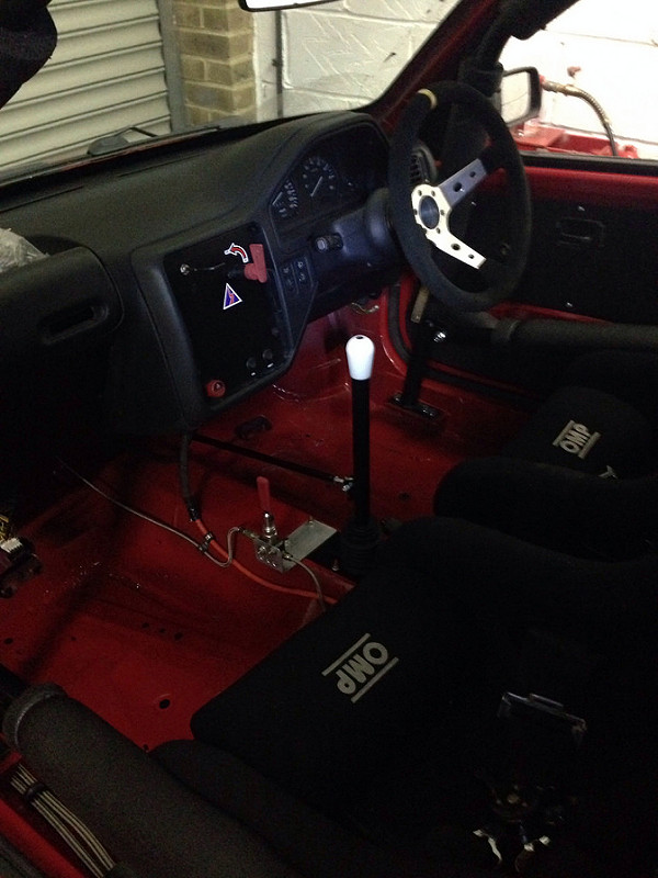

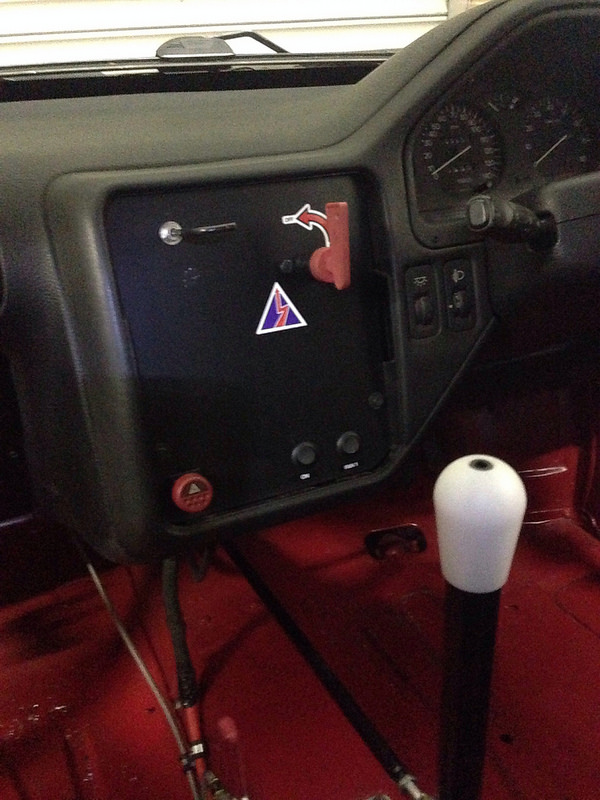

I have also got rid of the stupid fuel cut of switch which used to pop if you hit large bump in the road, we also found a way of bypassing the immobiliser without sending it off to be unlocked.. which was a total bonus :)

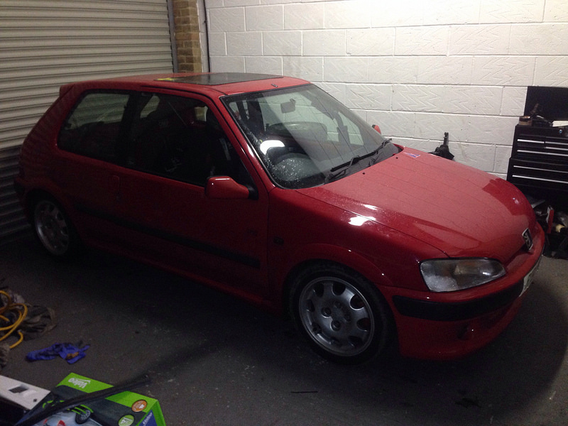

so the car now stands like this and I hoping to have it all sorted and back on the road for the rolling road day on Saturday.. however it is French and anything could happen in the next 3 days!!

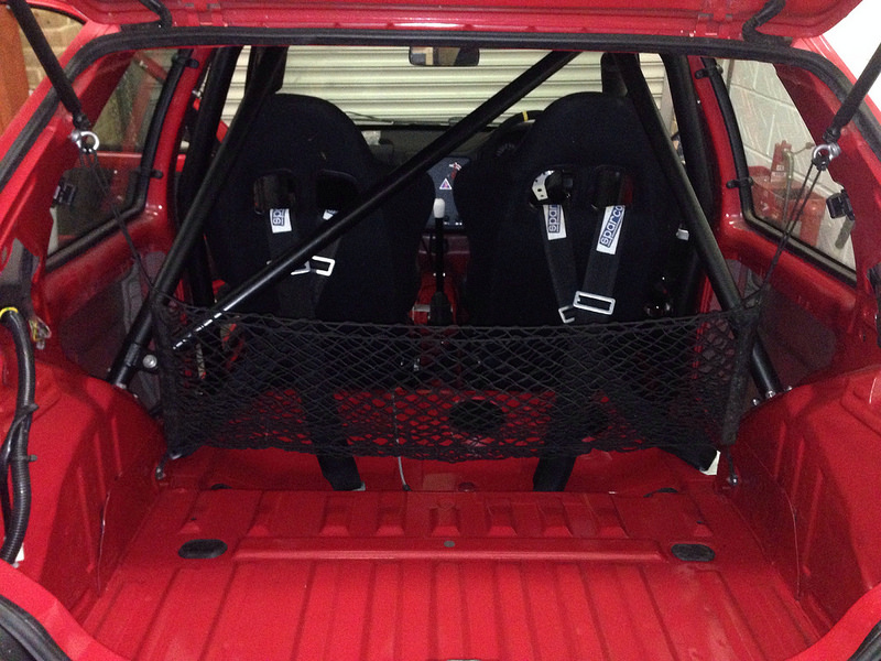

I got the passenger seat finally fitted in the car and also got the cut off switch stickers and a few other bits sorted inside.
I also messed around fitting the cargo net and used some p clips for the bottom hops and some left over harness hoops to suspend the top of it.

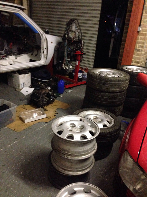

I am also going to collect 14 205 gti wheels on Wednesday evening which I have picked up for a bargain. I really can't wait to give it a good shake down and then get out on track before the trip to the ring in April and the first sprint in May.

On another note I finally picked up my wheels.. I just need to sell a set to get my money back. I am now the proud owner of 18 205 Gti wheels. I picked up 14 of them for under £200 :D

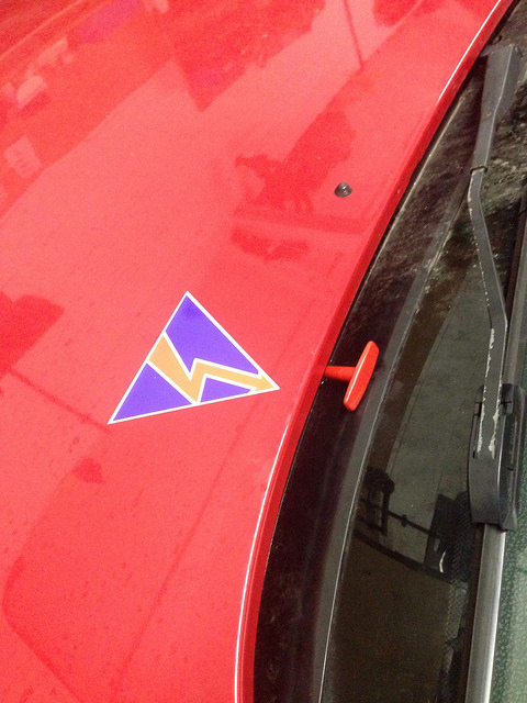

I also got round to fitting the pull cord for the kill switch, actually rather difficult finding somewhere easy to place without it looking like an eye sore. I made a bracket up and fitted it to the very small scuttle. I will get a better photo at some point.
The car is finally a car again and not a pile of bits.

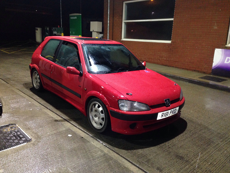

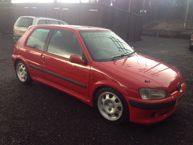

Well I am a happy guy.. did over a 100 miles in the car tonight giving it a shakedown to make sure everything was ok. The weather was awful and it highlighted a few issues with holes that need filling to stop the water getting in apart from that it was faultless.
A sneaky photo filling it full of loud pedal juice!

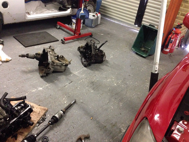

Another one bites the dust (gearbox)!! 5 weeks before I go to the ring, this one was always a bit noisy so I suppose it lasting a year wasn't to bad! I have sourced a box out of a 1000cc XN which actually should be quite fun (£20), the gears are similar enough to the GTI box but the diff is 4.2 instead if 3.9 so it will accelerate quicker in theory which is perfect for sprints. The car it came out of was well looked after and had two female owners so it hasn't had a hard life unlike all the GTI boxes, for the price I paid if it lasts the ring and the first sprint in May then I will be smiling.
Matt_90
  Sprint/climb 106 gti
The car is now back on the road and so far covered 100 miles with the new box, fingers crossed all will remain well. I plan on putting a few miles on the car before going to the ring to make sure everything is ok.

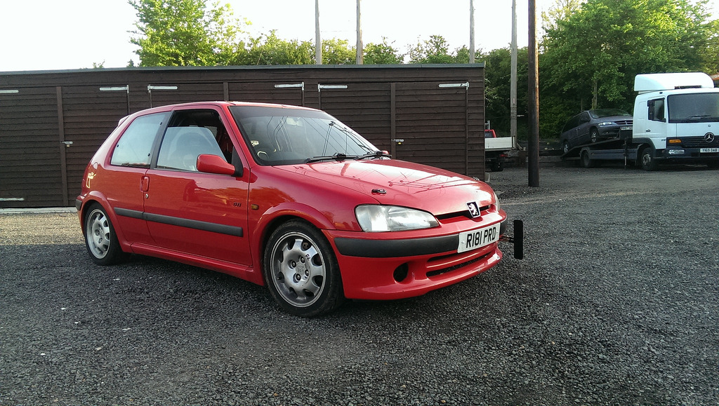

Its all been a bit quiet in here because I am far to busy/lazy to update the thread.. however I thought I better add some photos.

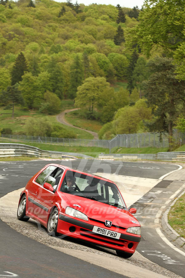

So I took the car out to the ring in April, after months of me getting the car ready and planning for the trip it ran perfectly. All apart from two of the lower arm fixings coming loose which I fixed on the euro tunnel and a wire coming loose causing the fuel pump not to prime on the morning we left to come back home.
Massive thanks to @Fletcher & @TimR26 for coming on the trip we had a good laugh and hopefully we can get the numbers up for the next trip.

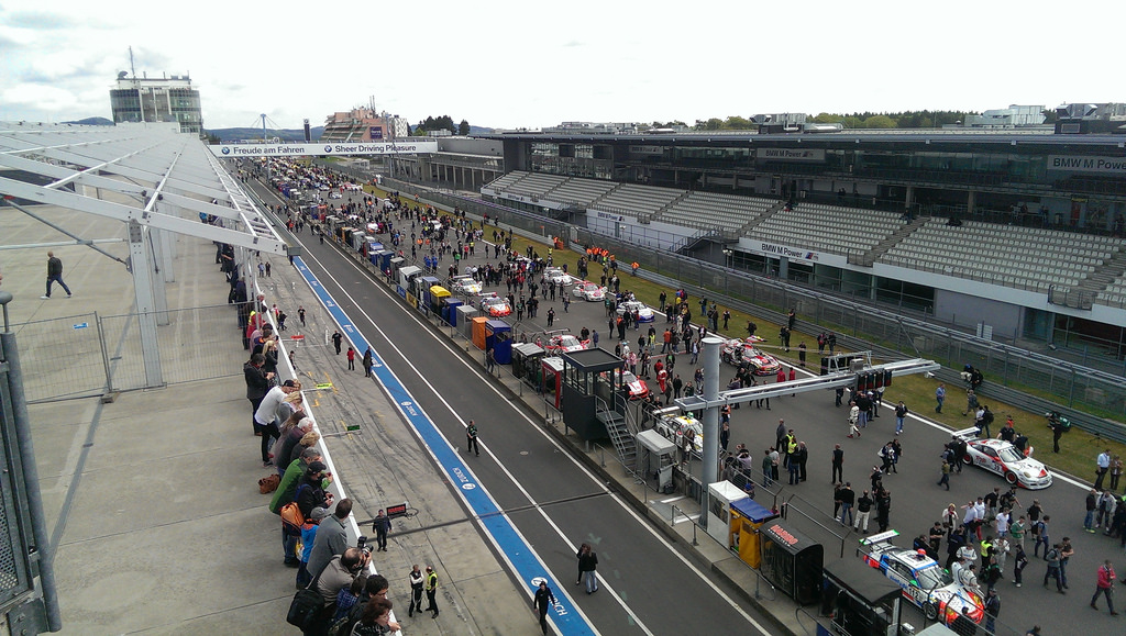

The following day we decided to head over to the circuit to watch the VLN race, the grid was massive with awesome mix of cars. Not to mention you could spectate and actually see something, unlike the UK full of fencing and s**t views.

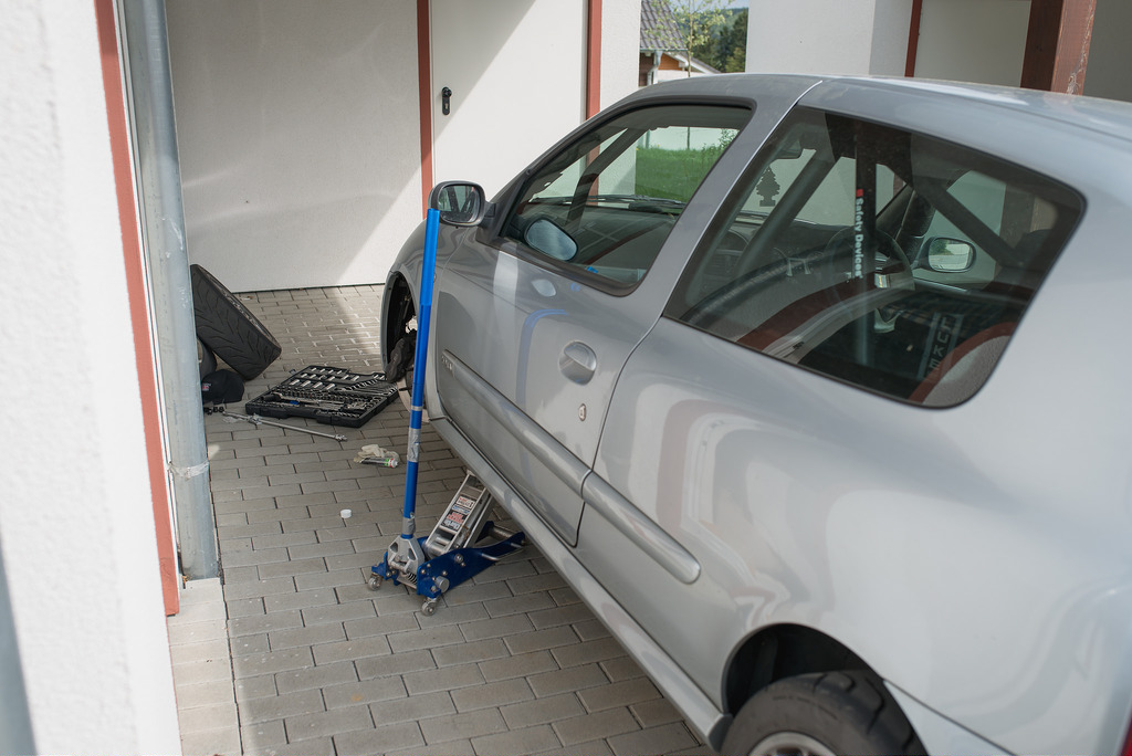

After lunch we headed back to the house to take a look at the 172, Fletch and Tim went off to RSR and got some CV grease, I filled the joint back up and put the gator back on with cable ties.

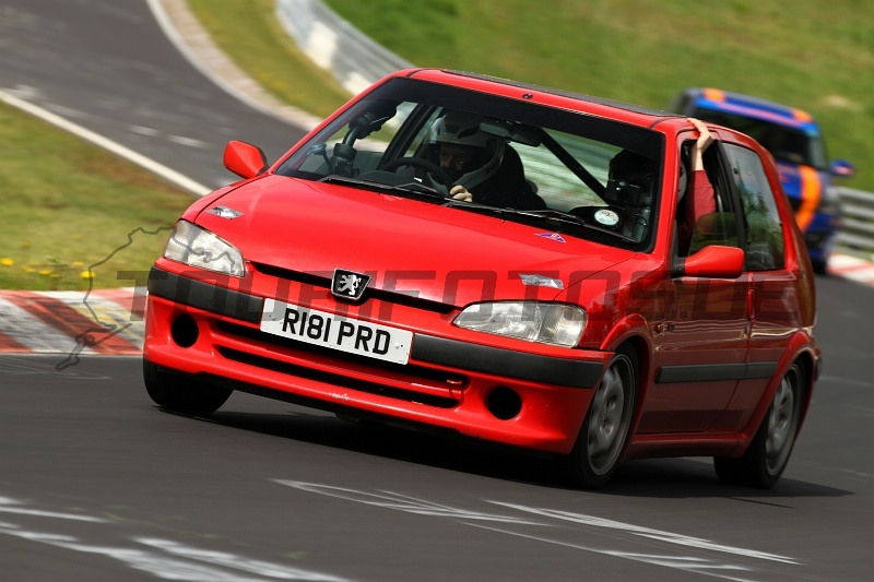

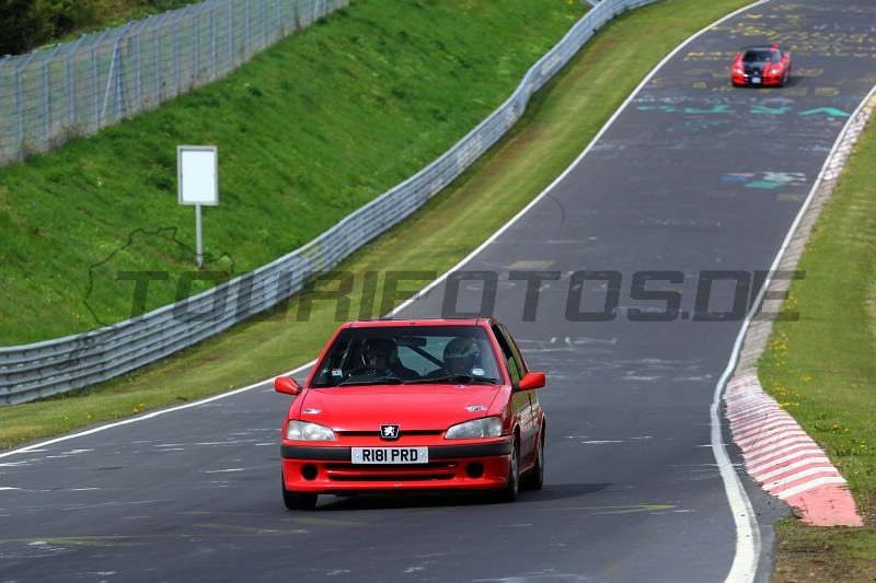

After checking the cars we then headed over the circuit to do a few laps. Fletch jumped in with Tim, the circuit got closed after 30 minutes because of some plumb in his 3 series decided to stuff it.
I completed 2 laps before the track closed, I felt confident in the car and was looking forward to the Sunday to push on and have a good day. That evening we headed to the steak house, the food was brilliant. the Mood however wasn't Fletch was one minute selling the 172 and the next keeping it..... and then undecided if he would actually do anytime out on circuit.
Finally Sunday arrived, we all woke to find it damp and decided to hold off, Fletcher had got up early and completed a lap which was a relief and was happy to continue for the rest of the day. The weather cleared up and I completed 7 laps in total before calling it a day knowing we had to drive home the next morning.

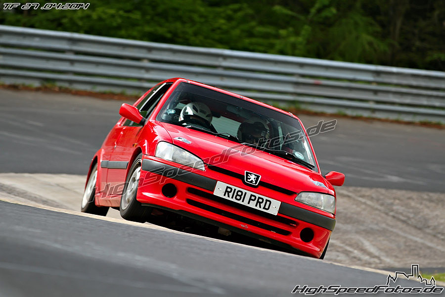

After completing all my laps with a passenger I decided to out for the last time alone, I went as passenger with Tim which made me realise I could go quicker in a few places. Tim was pushing on hard, its amazing how capable the megane's are.

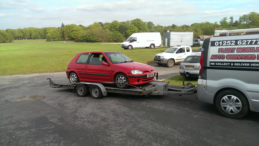

Monday morning we prepared for the drive home .. which dragged! I will be taking the car on a trailer next I go as its just to noisy and uncomfortable, it will also allow me to take some spares and not worry to much about crashing it!
