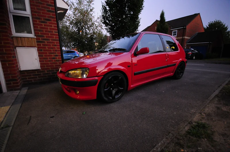

Anyway a quick picture - (Sorry its crap compared to what I normally post I really CBA tonight)
I will post more photos tomorrow and as the week goes on. My plans are to get it looking a bit smarter and get the bits above sorted. Over coming weeks I am hoping to order new dampers B6 or B8 Bilstiens, steering wheel and boss, new seats and new short throw shifter kit.
Its gone down like marmite at home... I love it the girlfriend and mother hate it which makes me love it more :)

Always had a soft spot for black 106 GTI's. Very nice mate .
  Liquid Yellow 182 FF
Re: My new project - 106 GTI
Very nice mate, id like to see this in the flesh at some point :)

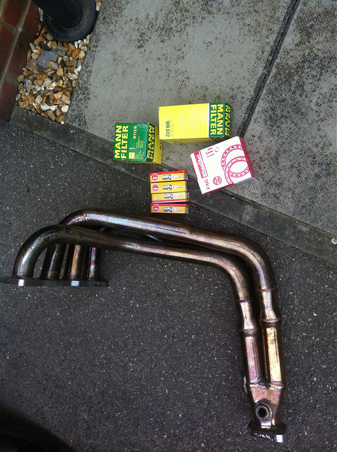

Also gave the car a full service, just need to change fuel filter tomorrow night! I might also change the temp sensor just for good measure since I bought a new one, its this sensor that can cause them to run like crap and the first one I was recommend to change!

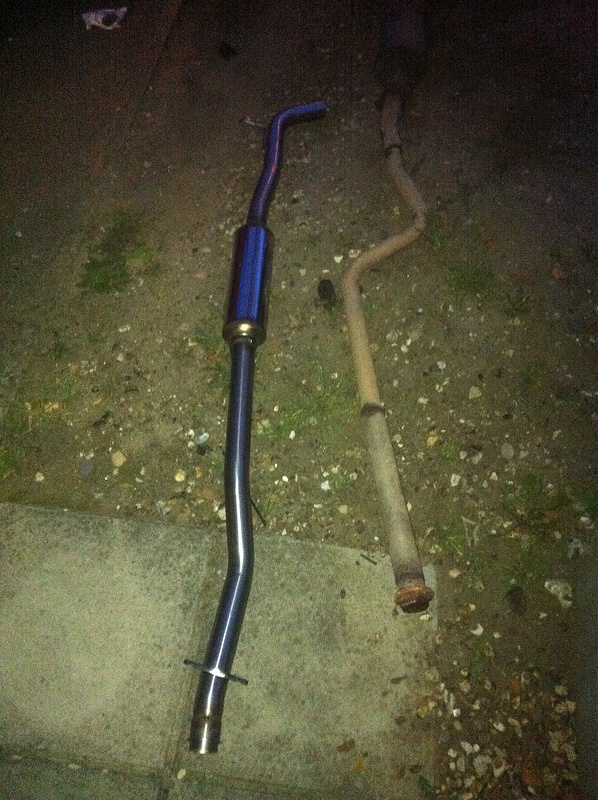

Over the past two days I got the pugsport system on, not overly happy with the fit. But its on and working.
started out fitting the manifold.. that was amusing quite the trickery to get it on but did it in the end. Much better than the mild steel jobby that was fitted.
Sorry for lack of photos etc.. I need to get use to taking photos as I go! So more to follow in further updates.

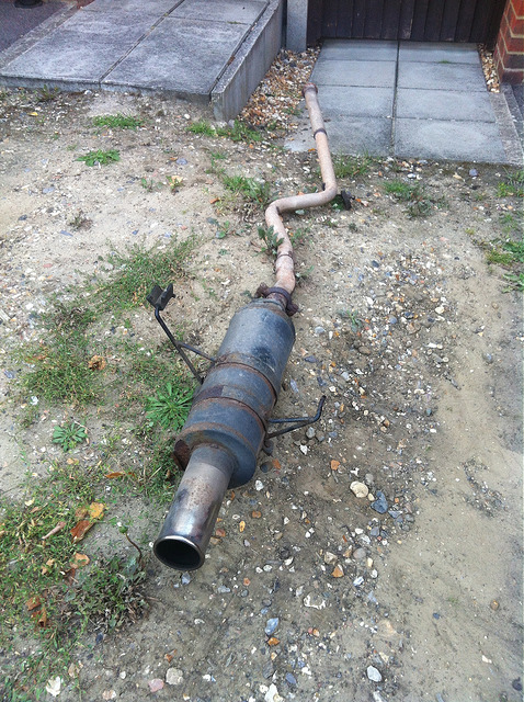

I didn't get any pictures off the whole pugsport system before it went on but it was out with the old [
You can see why I wanted rid of the old system.... Total pile of scrap!

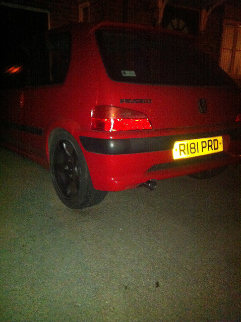

After arguing with the system, I got it on and all sealed up and sat right my only complaint is I don't like how it sits. The tail pipe is far to short, it sticks out on the S1 rallye's but on the gti it sits slightly under. I now have the car booked in a local workshop on monday for a new tail pipe to be fitted. I do however love the sound of the pugsport systems.
I got it sitting better after this picture .. Also need a new rear bumper where the last owner let the exhaust burn it :mad:

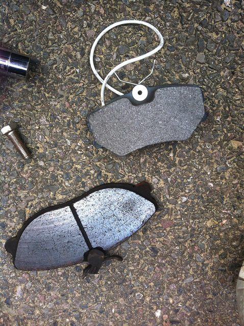

Next on the list was to fit new brake pads all round ..
Got my new pads ordered, wasn't till I got home I realised they gave me incorrect ones for the fronts! Quite a difference in size. They front pads were not as bad as I thought so I will get them swapped out next week.
So before finishing up tonight I gave the car the once over and checked everything was tight and working as it should be. I also attempted to clip the side skirts back on and the front arch, but had no joy and fixed it with trusty cable ties. I have a got a new arch on the way and side skirts :)

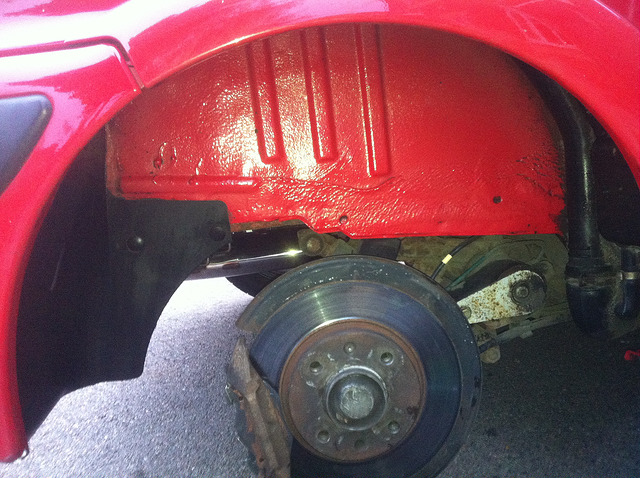

While I was doing this I took the opportunity to clean out all the arches as they need a big clean and hadn't been cleaned for a very long time. They came up well next week I plan on getting them all cleaned up and sealed. I only got a quick pic of the rear arch.
rear arches after a nice clean -

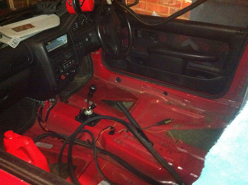

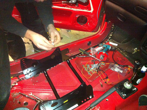

After making this decision my first move was removing the standard interior .. including the soaking wet carpets, headlining and front seats!
car went from looking standard inside to this in no time at all - (door card was later removed)
The aftermath and the helper -
Once stripped out I gave the car a good hoover and a clean and got rid of the years and years of dirt and dust which was living under the seats and carpet. I also found £7 which was a bonus! Once I got this out I could see where I stood with my leaky sunroof and it was clear that both the drains were blocked and the seal was knackered! I didn't see the point in buying a new sunroof or seal as it would need to be removed anyway.

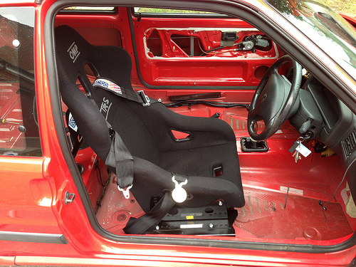

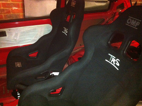

Next on the list was to order seats, rails, harnesses, front shocks and various other parts. After looking on the net for days and working out I had not as much in the piggy bank as I thought. I settled for the OMP TRS seats with OMP side rails and sparco frames.
Fitting the frames and seats was a doddle - made easier by us being fuelled by peroni!
Seats fitted, ready for harnesses!

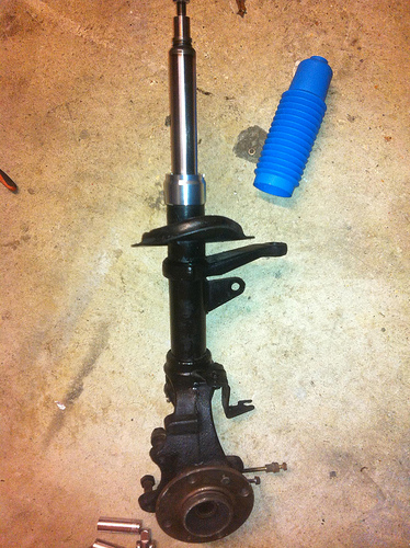

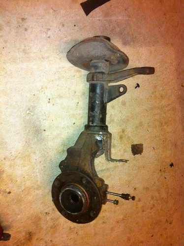

Next on my list was to sort out the front suspension, it was knackered! It was squeaking and knocking when driving which I blamed on the top mounts but after getting the struts off it was clear the front shocks had loads of play in them.
While the struts where off i decided to clean them up before fitting the new shocks.
Before -
After, with new Bilstein B8 -
Before being able to refit the struts I had to change various bushes, droplinks, wheel bearings. Once I had got wheel bearing pressed in I managed to get a full day working on the car, I got the front end back one and back on its wheels! as well as fit the new sunroof panel which I picked up a cut to size sheet of 3mm aluminium for £10 and then rounded the corners. before painting it back ready to seal and rivet on to the roof. Before we could do this we had to remove the old frame for the sunroof which involved drilling out the welds holding it in place.

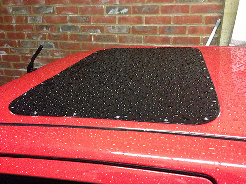

the new sun (lack of sun) roof - Just needs the tiger seal cleaning up in places and the rivets painting black.

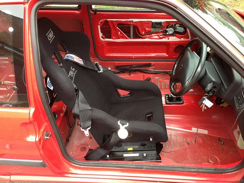

On the same day we finished up some of the inside of the car and fitted the new harnesses. We had to fit some plates underneath the car so got the seats out to do this and got the holes drilled. while doing this I managed to clean up some more of the wiring and get stuff tucked out of the way.
one seat back in with harnesses -
We than finally got both seats back in and got the car ready for a test drive before an evening of Go-karting :)
Ready for a test drive -

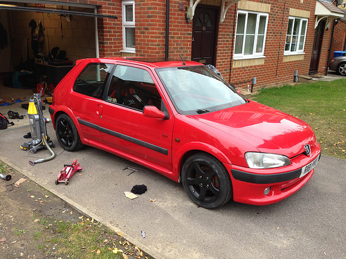

Sunday arrived and I got talked in to doing a slalom event with my local motor club (Farnborough District motor club) and I can say I had the most amount of fun for £25 ever! Me and a friend double drove the car so my car effectively did it twice and we where not shy in the slightest!
The courses were on a loose gravel surface that made it very eventful and taught me a lot about how the car handles at high and low speed. The car performed really well wit no hiccups what so ever just and no battle scars. Only think now is I have a few extra squeaks and rattles. It did however highlight that the front brakes either need new pads or replacing they work well but not as well as I had hoped.
I placed well in the event with a 13th in class which I was happy with for my first ever event considering my amount of c**kup's getting wrong test on some of the courses.

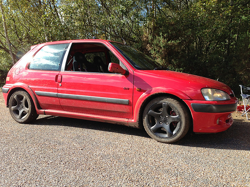

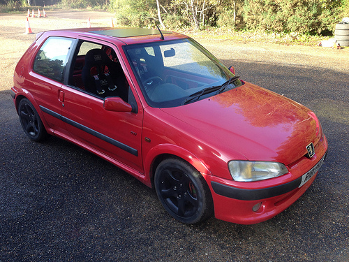

Anyway before I got it muddy -
After -
