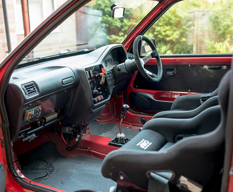

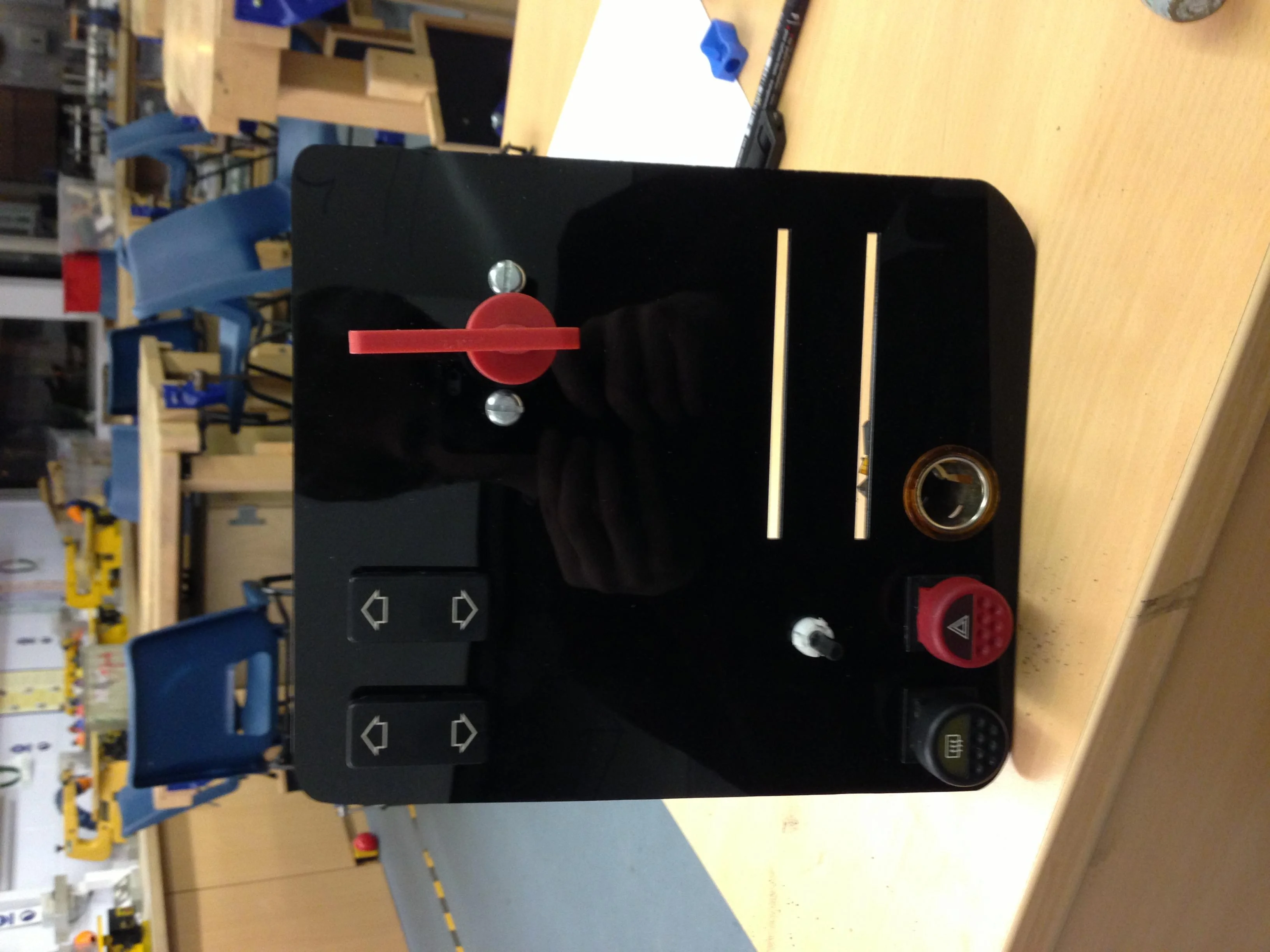

Last night I made up the new panel for the centre console at work using 3mm acrylic.

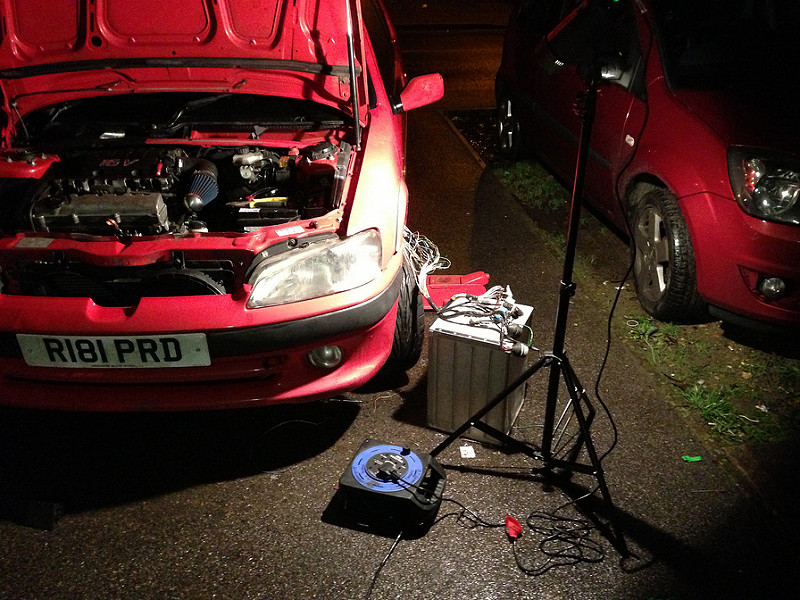

So after many swear words, I set about sorting the issue and had the pain staking job over soldering wires back in to the loom! This was clearly nice and easy when all the colours matched....... NOT!
So after two evenings sat outside in the pouring rain and minus temperatures I got the wires all matched up and soldered, heat-shrunk and put in some conduit. However with it being crap and french it turned out that it had blown the majority of the fuse box so once I traced back what it had also buggered up, I started it and it sprung in to life. We were back in business and I could now start making progress with the things that actually mattered and needed sorting.

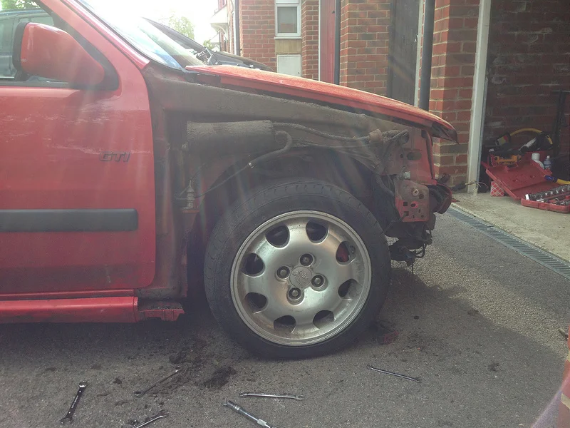

After pottering round in my brothers car for work I came home to find my car looking like this outside my house....
A neighbours friend had reversed in to it and just driven off and not bothered to let me or my family know. I managed to figure out who had done it after knocking on his door with a piece of paint left on mine from his car, asking if he had a friend with that colour car after first saying no, I threatened to call the police what do you know an hour later I get a knock at the door.
I didn't really want to bother with insurance, so I suggested he purchased the new wing and paid for it to be painted and he agreed, thank god!
June..

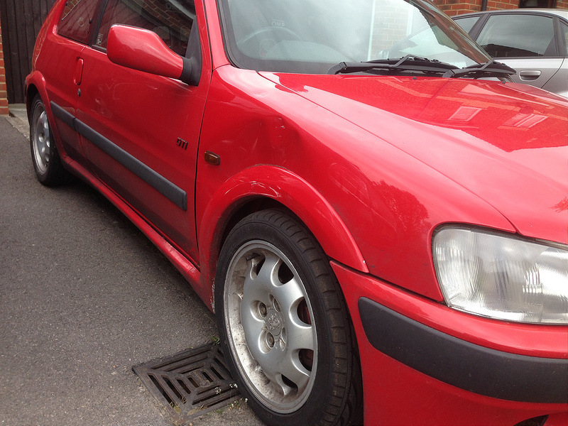

After finding an indigo blue wing on ebay for £28.00 with arch I got straight round to fitting it.
I sent the car off to the paint shop the following week, and got it painted up however a 13 year red car it which is had faded pretty bad in places I wasn't expecting great things for this new red wing which stands out like a sore thumb, the door is pink at the bottom and the wing is red and matches the new wing lol!

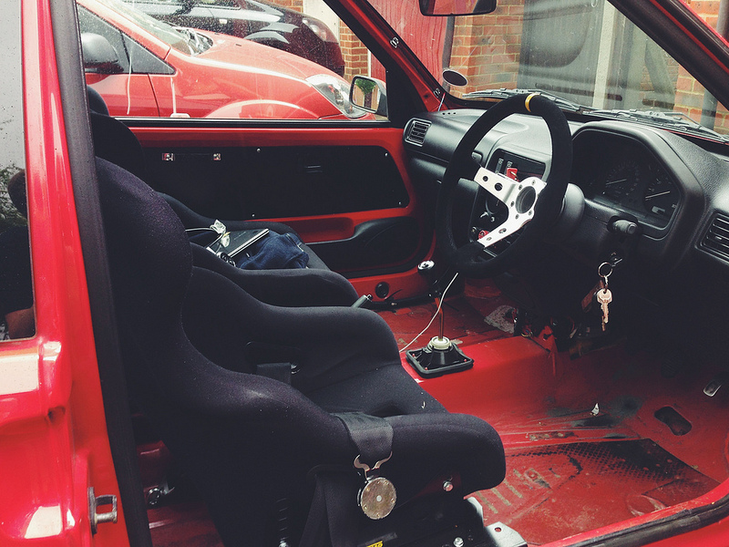

While the car was getting paint done a friend offered me a dished steering wheel out of his mk2 escort rally car he was breaking, so I couldn't say no. I knew I had to bring the wheel closer to me as I felt cramped with the old wheel and couldn't bring the seat as far back as I needed to.
With the new wheel fitted the car feels great to drive, so much more comfortable. So after getting the car I finally sourced another Gti box off an a forum instead of ebay, I arranged courier and got it fitted last week. The car is now driving so much better, no more knocks every time I lift of the throttle.

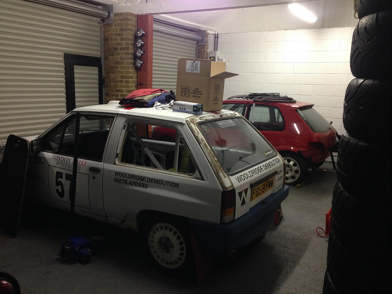

I bought the silver 106 above and started stripping it down for parts and have ended up with a good stock of spares including spare 360 gti6 brakes, bilstein B8 front shocks, good condition rear beam etc etc.. The plans are to pull the engine from that car and overhaul it with the intention of having it spare and ready to go in if I need it. Then eventually strip the shell bare and start from scratch!

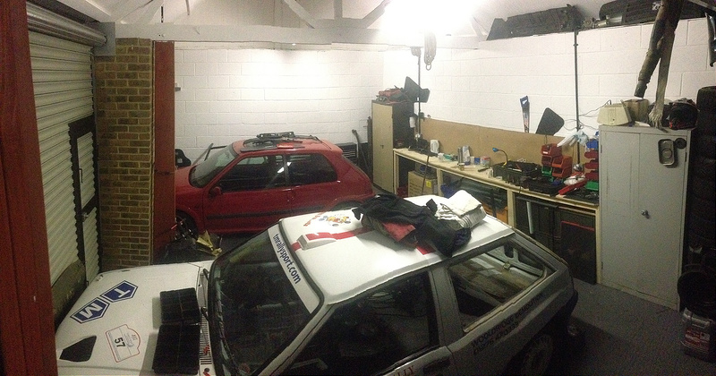

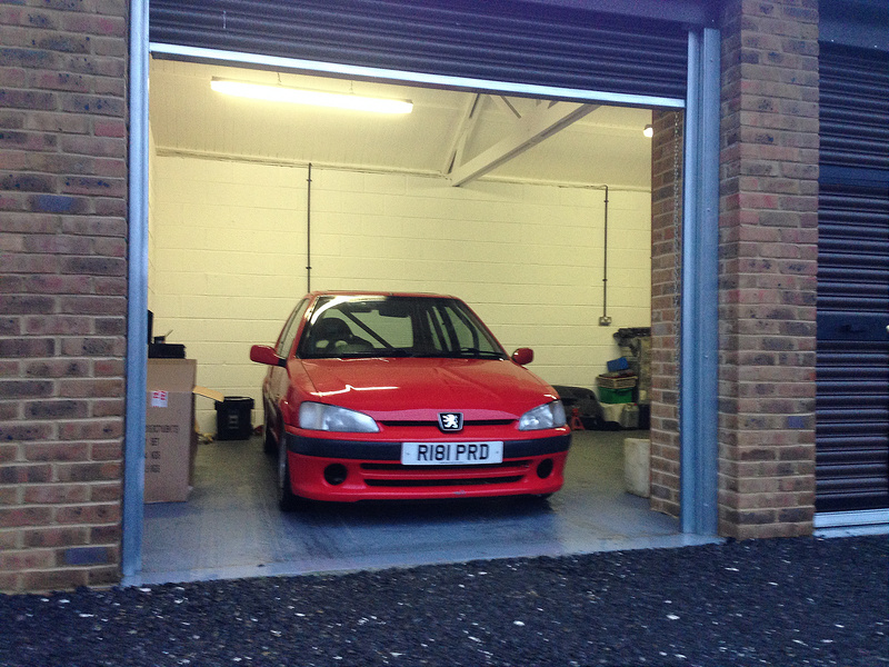

Once the cage was fitted I got the car home and started to scope out a new workshop, I initially thought about building a large shed but it just wasn't finically viable.
Luckily a few weeks back me an a friend found a unit really local to me, just built and at a great price so we did got sorted and got ourselves a move in date which was Saturday.
The car in its new home -
We spent sunday building a new work bench and moving the rest our gear and cars over.
The workshop sorry for the terrible iPhone pano -

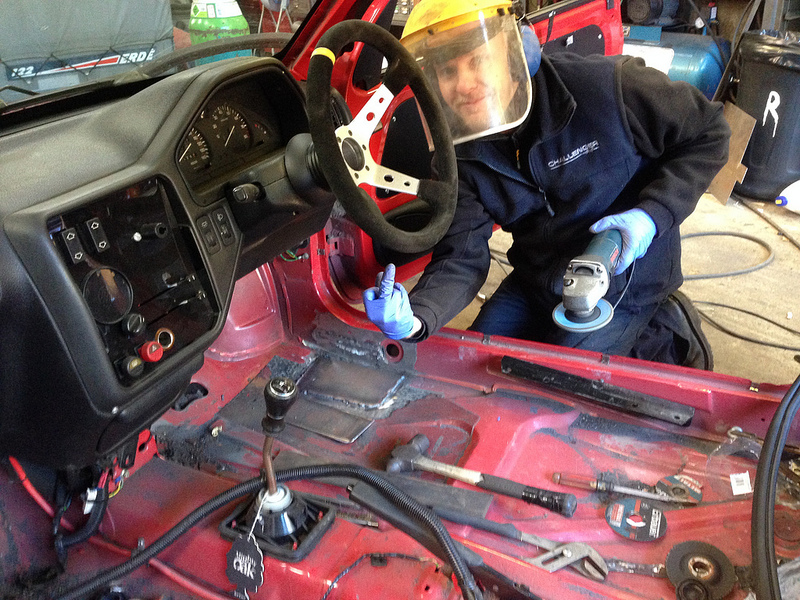

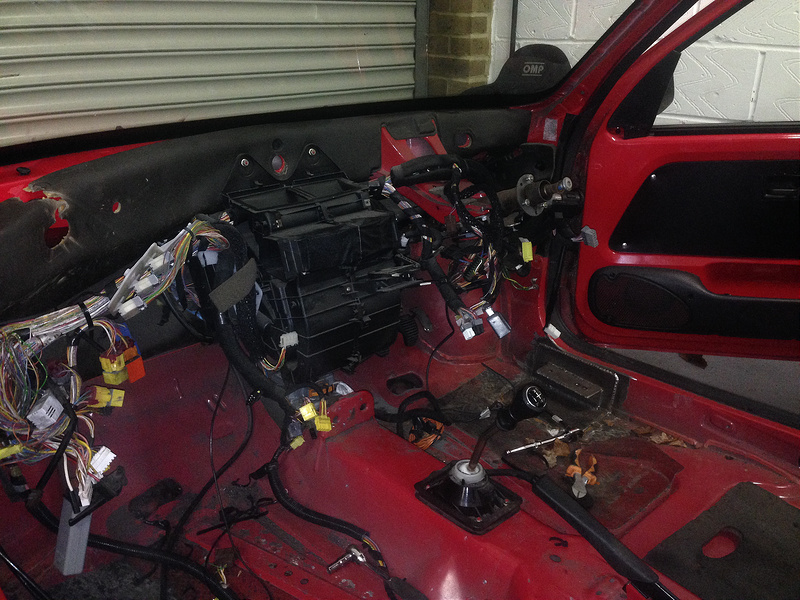

I finally got work on the car today and got the cage out along with the dash ready for paint and also so I can start stripping the loom back.
Thats it for now but I think most of my evenings are weekend are now going to be spent here :)

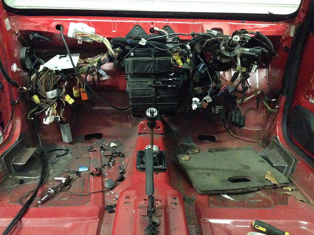

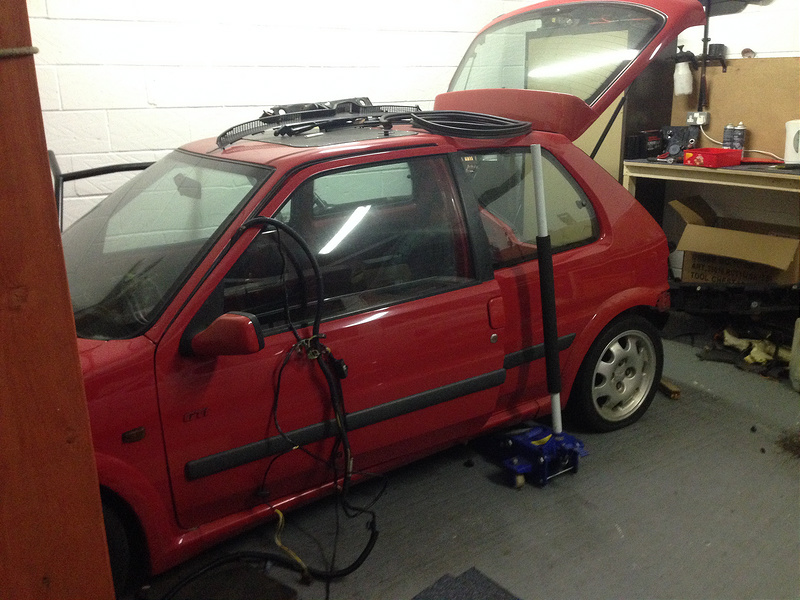

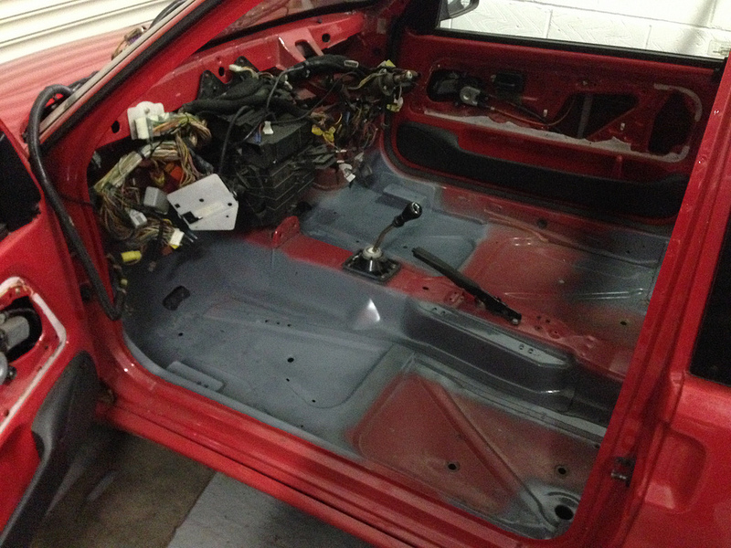

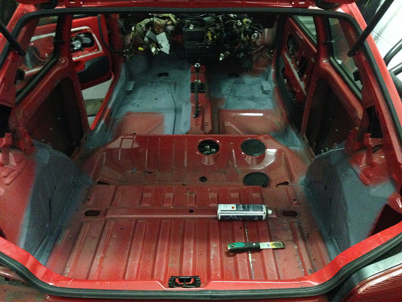

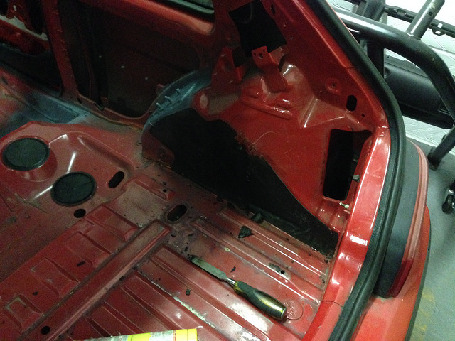

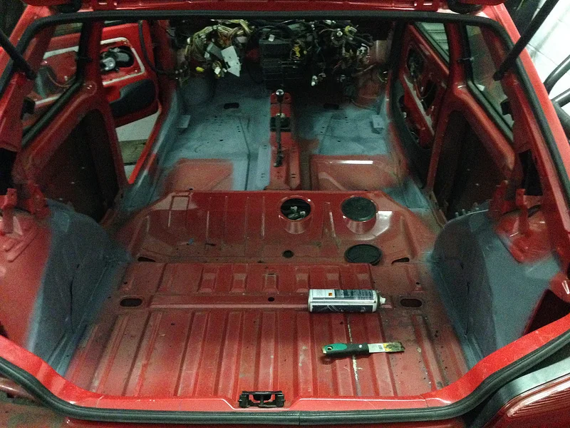

Another productive day down the workshop..

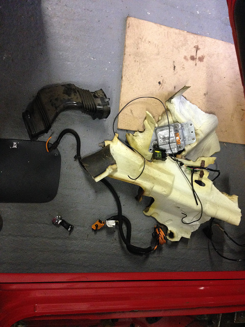

I stripped the rest of the sound deadening out from behind the dash and heater, then removed the airbag unit. I am thinking of removing the heater and replacing it with a small one that my friend has just fitted in to his Nova which is much smaller and much neater.
what was remaining of the deadening and the airbag ecu.

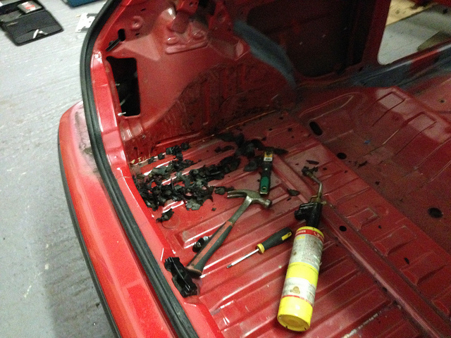

I then removed the fuel lines and cracked on removing all the horrid sound deadening in the footwells. Not the funnest of jobs, but needed doing. I then cleaned it back and put down some primer on the new cage mounts and the floor.
Next it was to remove the sticky crap from the back of the car.. This stuff was a little harder but nothing that a blow torch couldn't sort out.
Before -
After -
After scraping and sanding for the most of the day, along with usual banter from my mate getting his nova running I got quite a lot done, I just need to mask and clean up other parts and cut out the brackets that aren't needed and it will be ready for some nice gloss red paint.
Hopefully I will get back down there tomorrow, I also need to remove the bumper and taillights. The car decided to remove the nearside one itself after I knocked it while crawling round in the back of the car.

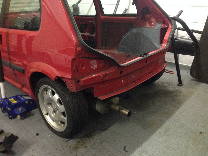

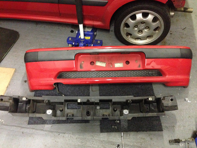

Well tonight I managed to get down to the unit for a few hours.. I am buying the paint for the inside tomorrow so decided to productive and remove the rear bumper and unscrew the plastic crap from behind it and find a way of remounting it.

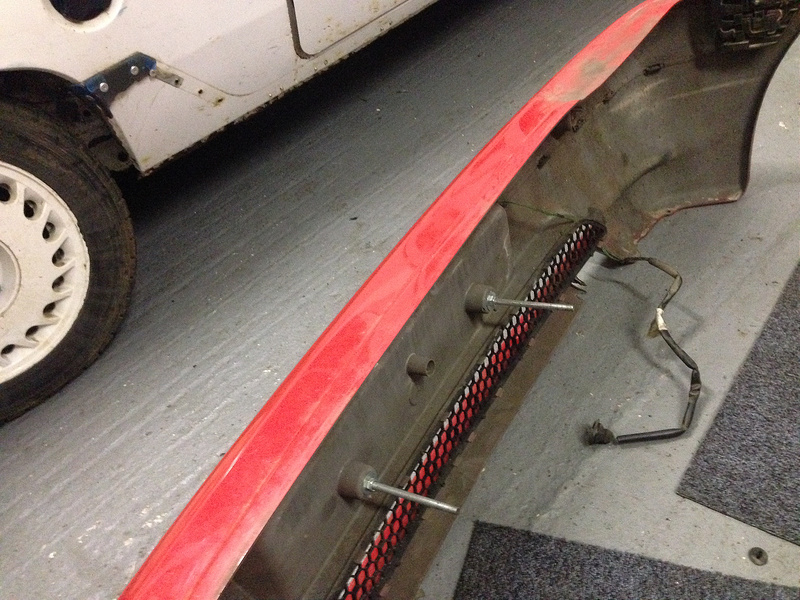

The black panel actually weighs more than the bumper when separated, I also removed the other taillight which easily had over a pint of water in it :/ French crap!
All removed.. I give you the bare Arse of a 106!
Once cleaned up and removed I drilled two holes in the rear of the car, so the new bumper bolts that go straight through in to the boot andfitted the threaded bar to the bumper.
I now just need to do a similar thing to the front bumper.
