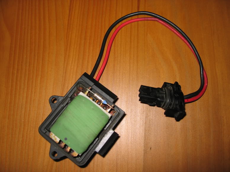

the heater resistor has gone ( doesn't help that the blower fan fills with water and then sprays onto the resistor!)
its located under the driverside scutle pannel
it looks like
and cost £100 ish from renault (rip off)
speak to MATT BLACK on here he should be able to get one cheaper

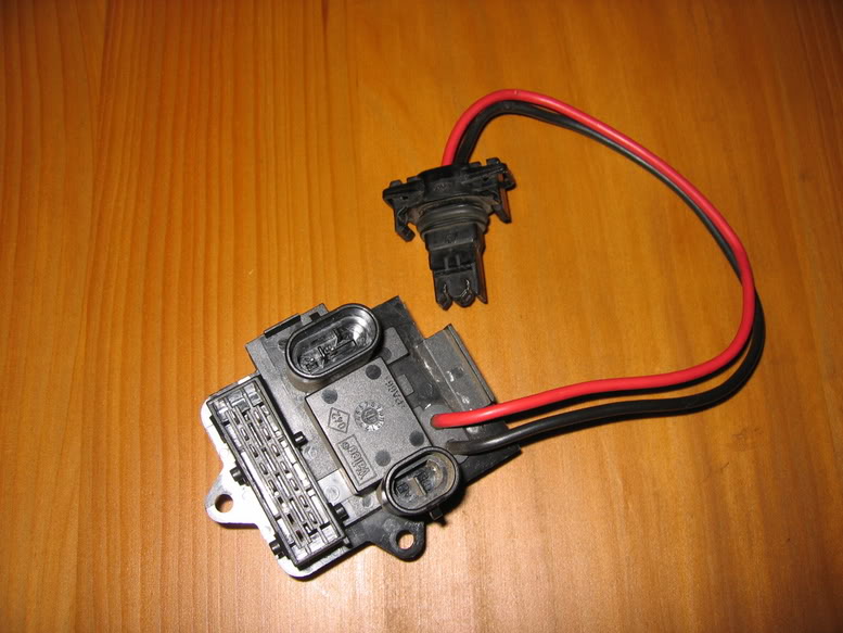

cheers mate.pulled the car apart today and looked for all of that.had the heater out and everything else. ive got a mark2 with climate control and think its in a different place or something.cheers anyway
ive looked mate. that cable that goes to the fan is not the same as yours.its just another cable connector, i get well peed off with these cars i want to sell it everytime things go wrong,can u believe a xenon bulb is a £100 to buy

dont know if this has been said cant be arsed to read all the posts! My heater went on an 05 182 , put it in the garage turned out to be the connections had got a bit dirty! I thought it was the resistor ! So check that before you spend loads of money
