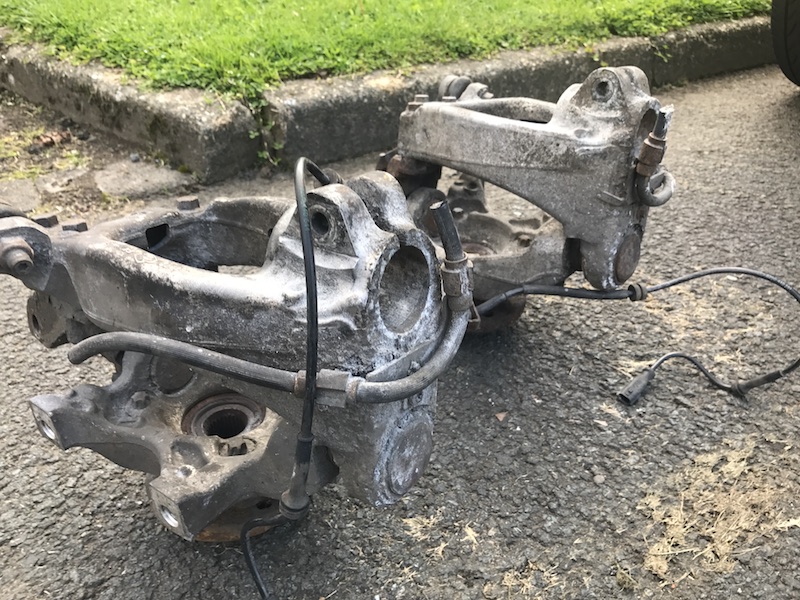

Bought some used 60mm hubs to press new bearings into but i'm wanting to clean them up of all their rust whilst i'm at it.
I had thought sandblasting, but hoping to avoid removing the ABS sensors as they always break. Is this doable if i tape it all up beforehand?

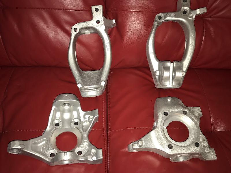

Here is a picture of my hubs before vapour blasting and then a picture after.

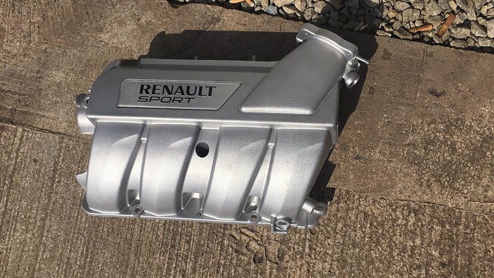

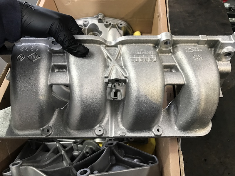

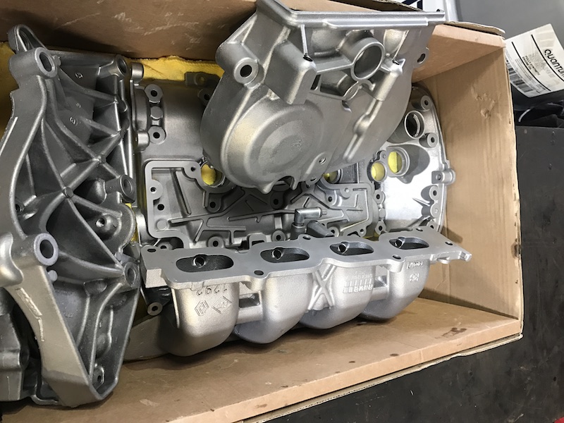

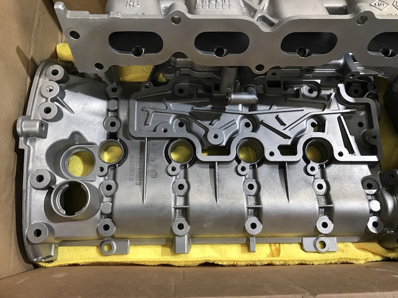

This is my inlets and rocker cover also. This was done almost exactly a year ago and it still looks the exact same with no marking on them.
Here is my inlets and rocker cover also. This was done almost exactly a year ago and it still looks the exact same.
The difference is though mate that your bits are alloy and needed to be a nice finish.
If you blast steel hubs and paint them straight after then they will be fine. But if the are left then the damp will get to them and start them rusting again.
