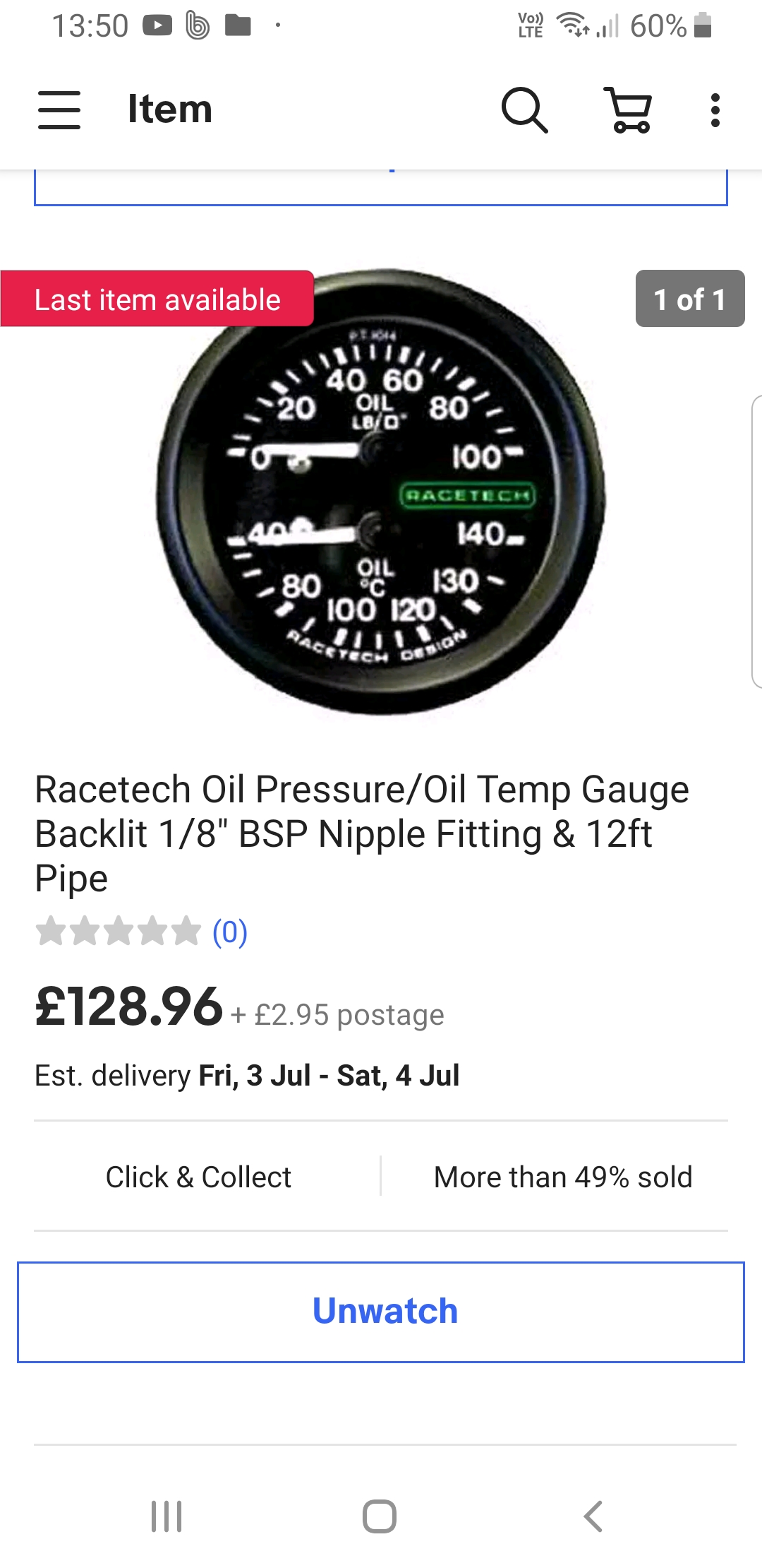

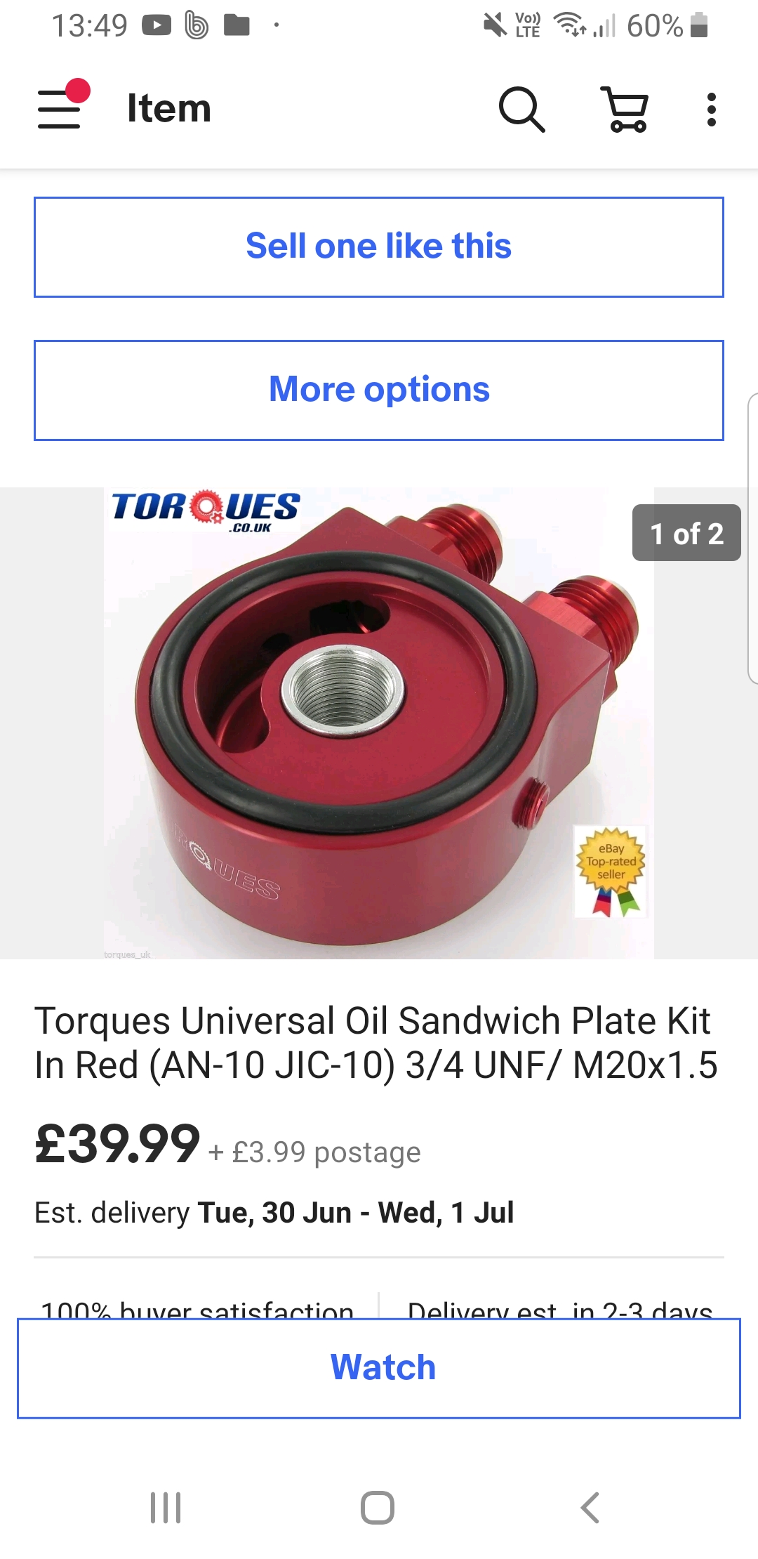

I have a torques sandwich plate incoming with 1/8npt and my racetech gauge connection is 1/8bsp how is everyone overcoming this issue or will it fit, the internet says it wont work and I have looked for a bush or adapter and not come up with anything yet.

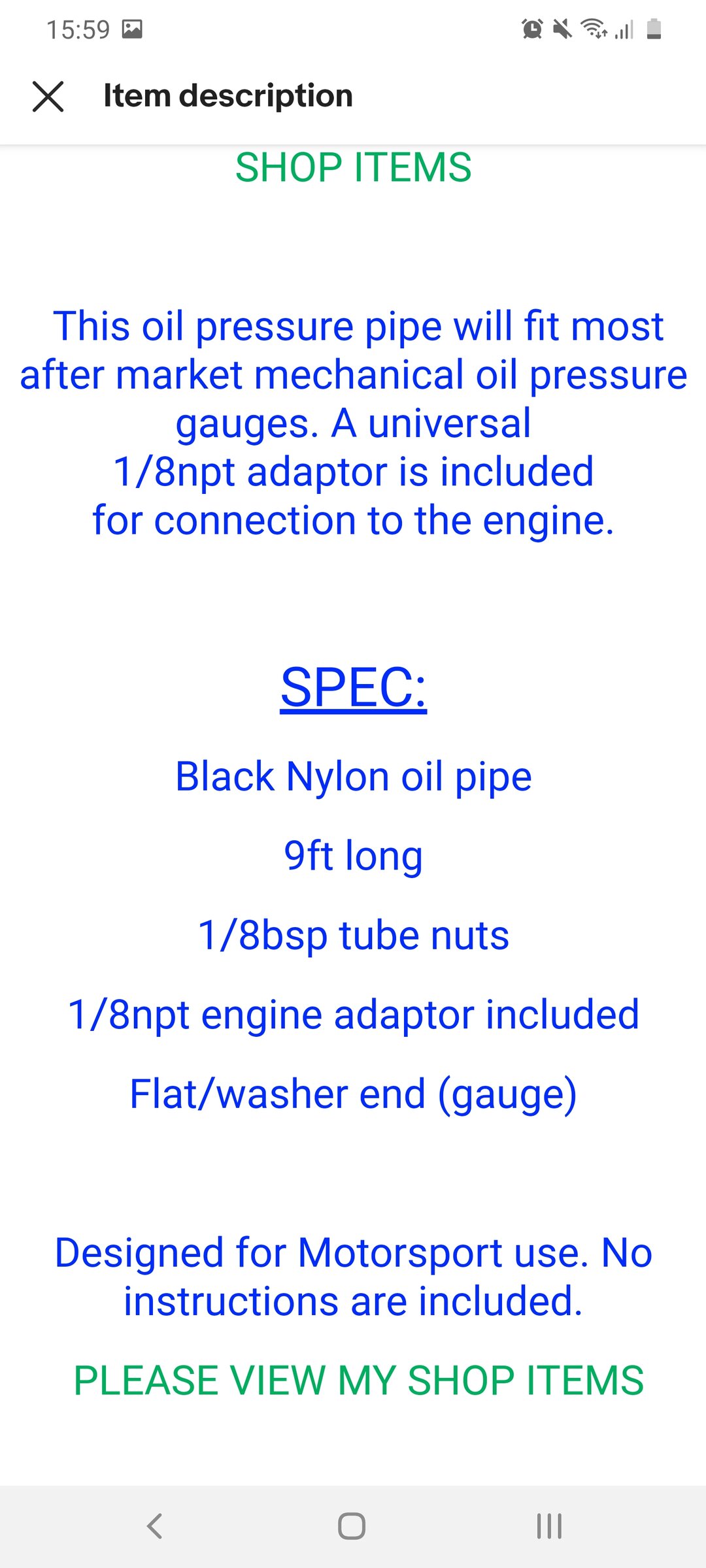

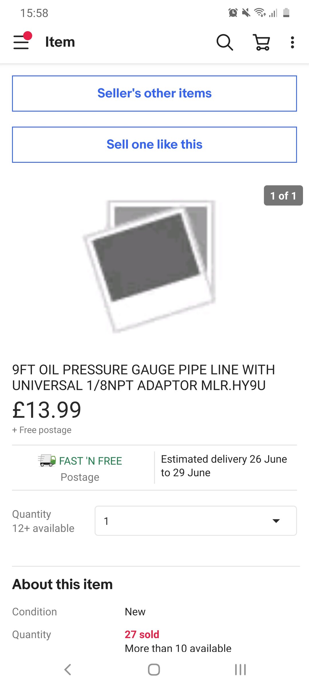

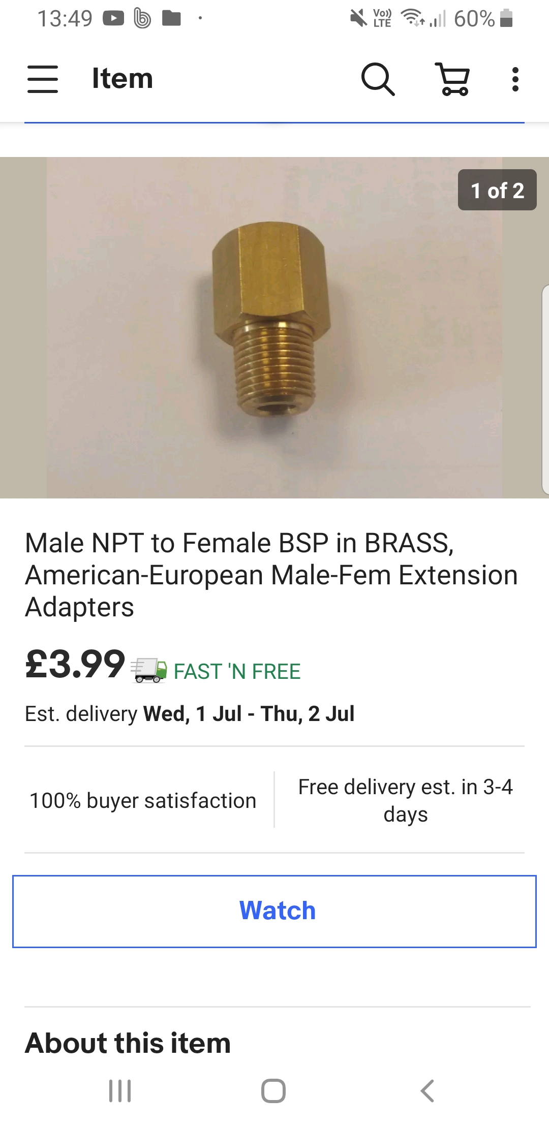

Or you'll need this hose that adapts it. I have the same gauge
So hopefully this will all work
