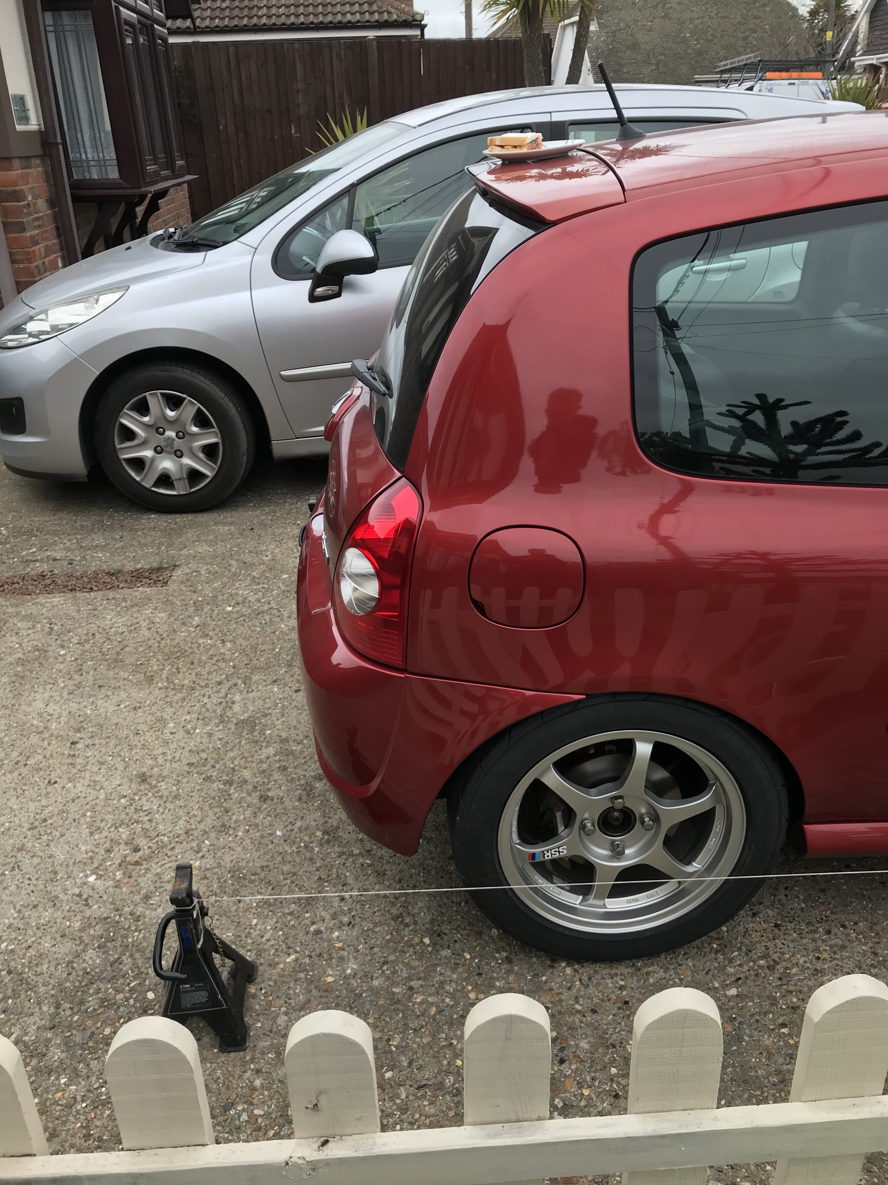

Forgot to say, I’m going to need to find a cup or trophy spoiler so my sausage sandwich is more secure when working 😂

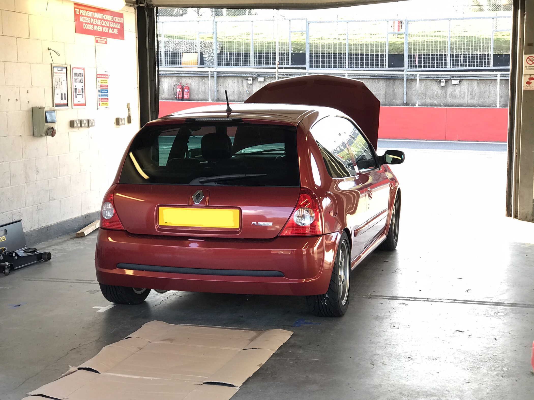

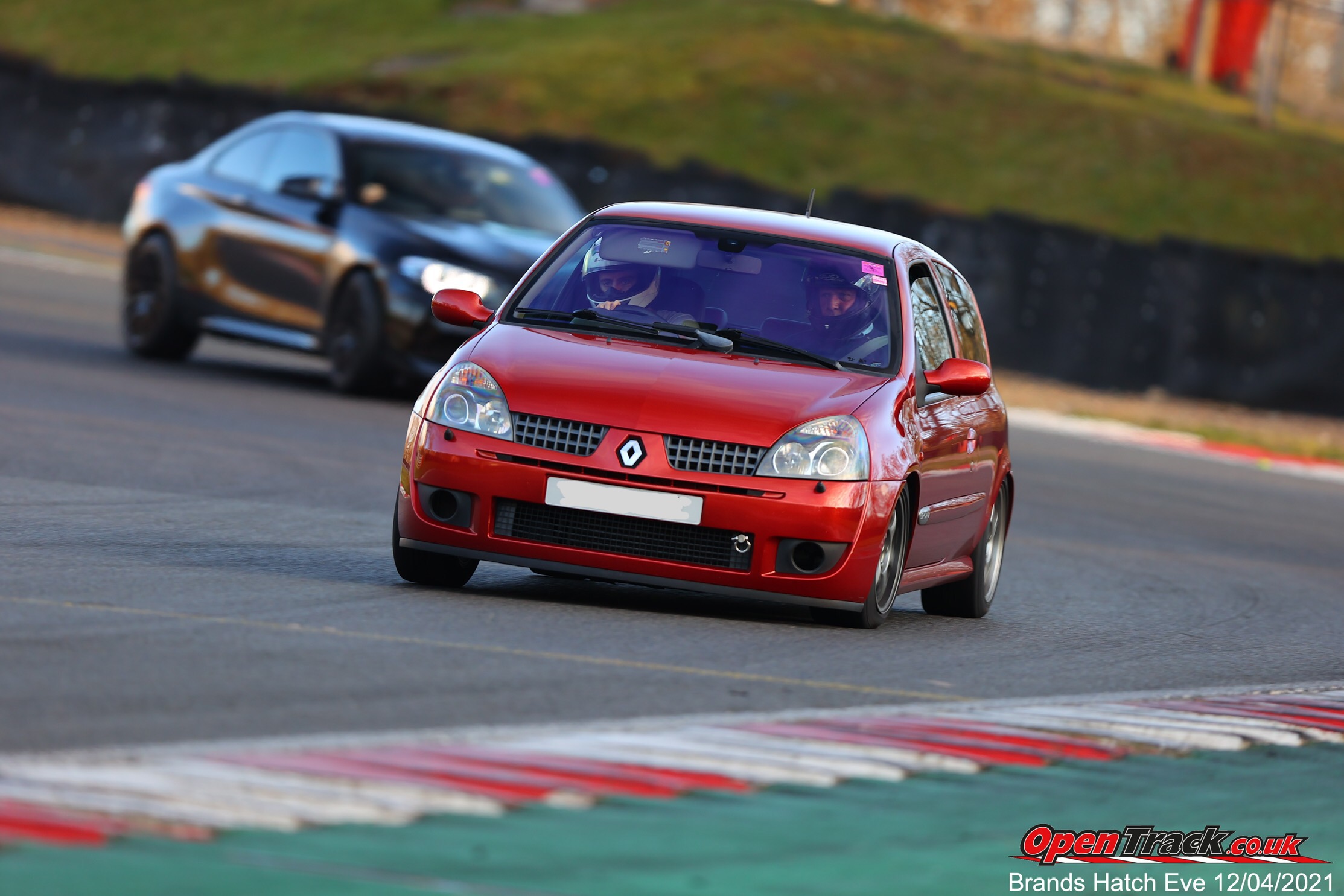

Trackday success!
I left work early on Monday and initially it wasn’t looking good. At 12:30 it was glorious sunshine, 13:00 it was smatterings of rain, and 14:00 it was torrential snow (if there’s such a thing?). Brands is only about 30/40 minutes from me on the Costa del Essex so the changing conditions followed me on my journey, but on arrival the clouds seemed to part and the sun shine returned.
I’d invited my dad along as he’d never done any trackdays as such, and he never got the chance to come along to the drift days in the R34 so he kind of missed out. Part of my plan with the Clio is not only to make it a daily which is nice and capable on track, but also make it accessible so people with little experience like him, my Mrs, other family members can come along and have a crack at some fast driving.
We got checked in, noise tested and had a bite to eat while we waited for the day session to finish. I did some minor alignment tweaks, swapped the front & rear tyres (fronts had been scrubbed in through the week) and sorted the pressures.
Although he’d driven Brands on experience days approximately 800 years ago, my dad hadn’t really been on a busy track session before, so I put him in the hot seat for the sighting laps and gave him some pointers as he went round. Once the sighting laps were done, we came in to check pressures and toe again briefly while the initial mad 15 mins kicked off on track.
I jumped in for a quick couple of laps, then came in to pick up my passenger and go for a rip.
I have to say, I was mighty impressed with the little Clio.
The BC DS coilovers felt decent, the car was nice and flat for the most part and very progressive and predictable. I think having 9k front springs rather than the usual 7k (I think?) was a good choice as it seemed to keep the lift off oversteer really minimised unless really deliberately provoked. This was a huge benefit for my novice co driver through Paddock Hill Bend this is somewhere that the rear of most cars goes very light, and it’s easy to carry too much speed and lift/brake yourself into a slide if you overcook it.
The stiffer front meant ol’ papa was able to learn the limits without ending up upside down, and I was able to carry more speed than I think I ever have mid corner with some lovely delicate oversteer. Very confidence inspiring.
I carried on fettling dampers to just manage the compression at the bottom of Paddock Hill Bend as we had some minor rubbing with two of us in the car, and we were having a blast.

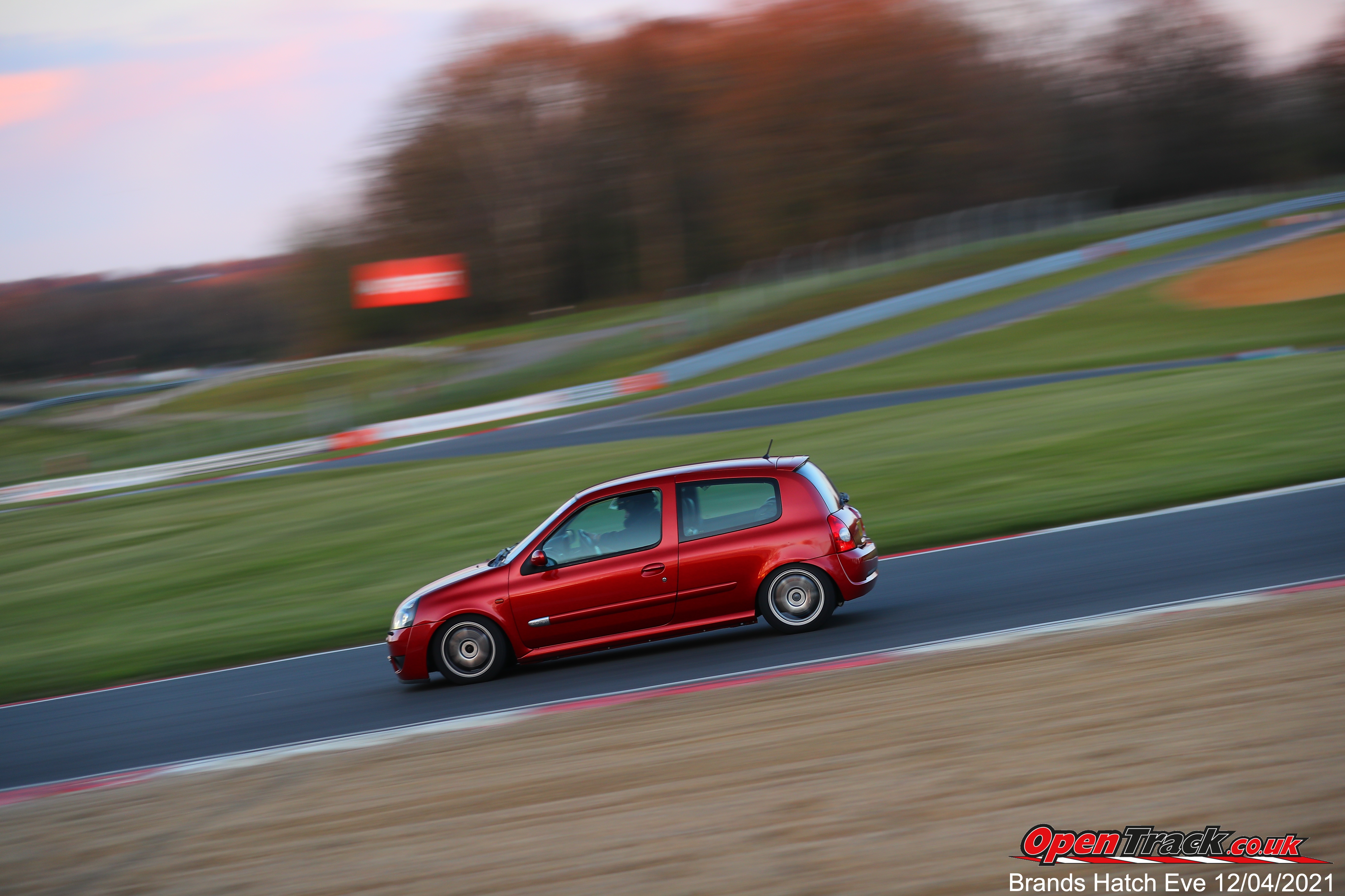

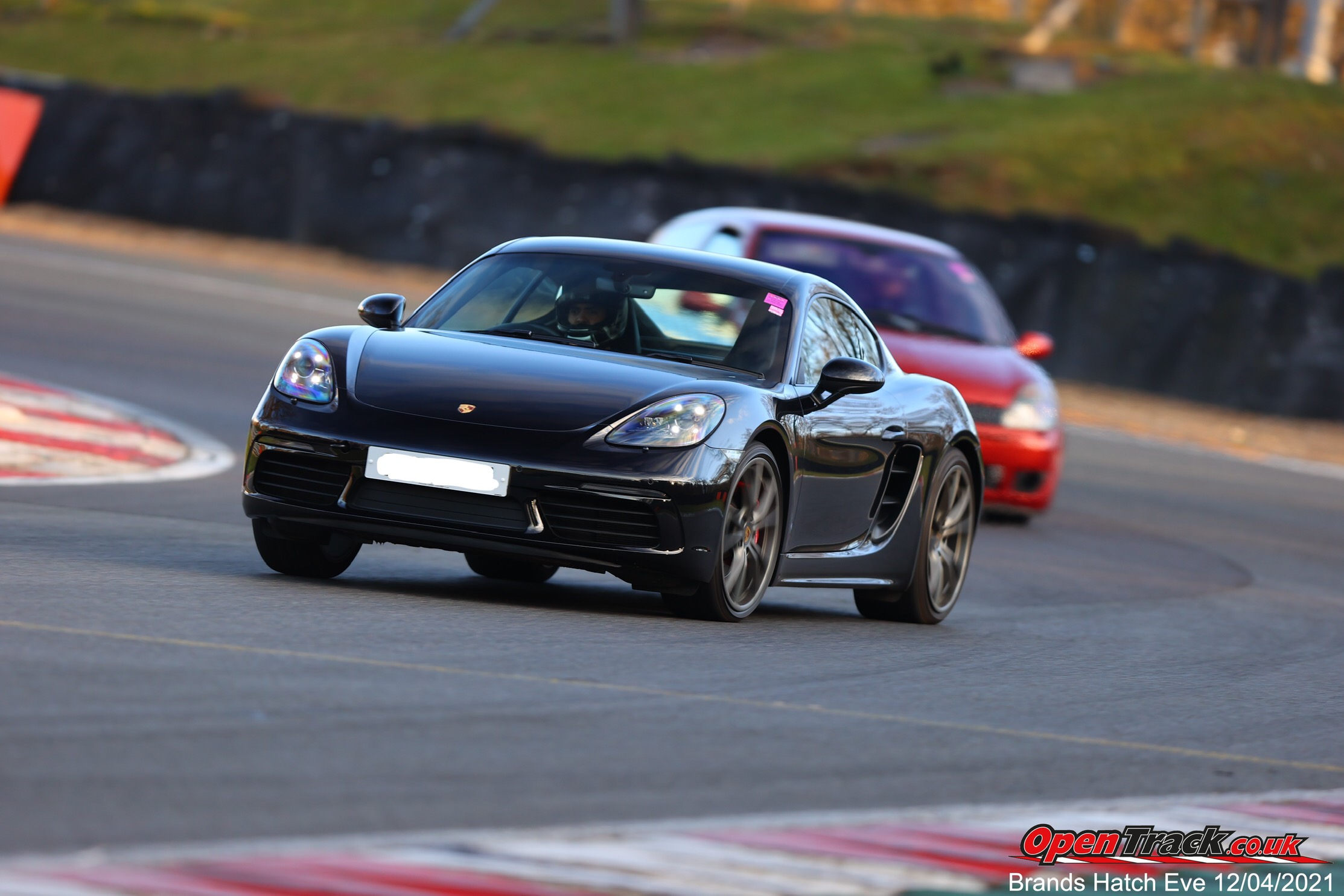

I had a monster session where I got warmed up and was around 3/4 of a lap behind a new Cayman 718 2.5 Turbo thing, not all that clued up on them I’m afraid but it was on a bit of a rip so I made it my mission to catch up to him. The track was nice and clear and we managed to reel him in over the course of about 10 or 12 flat out laps, losing distance on the straight and gaining through mainly turns 1, 3 and 4 where we could commit harder and carry more speed. A very rewarding session and the car took it in its stride, we were chuffed at the pace of the little baguette
Having caught up to our target I slowed up for a cool down before coming in, the NS2Rs had gone very jelly as I’d overworked them a little and although I had no real fade, the brakes absolutely stank. That, and I think we both needed a rest, OEM seats are hard work 😂
We had a break, a cup of tea and gave the car a good 20 mins to cool off, then as the light went down I sent my dad out on his own for the first time to finish the session off. It was cool to see the car corner from the outside and make notes in my head as to what I can see, versus how I felt driving it.
All in all, a good day. We packed up about 7:45 and I was home by 8:30, the car was absolutely faultless, and we had a blast. That’s what it’s all about!

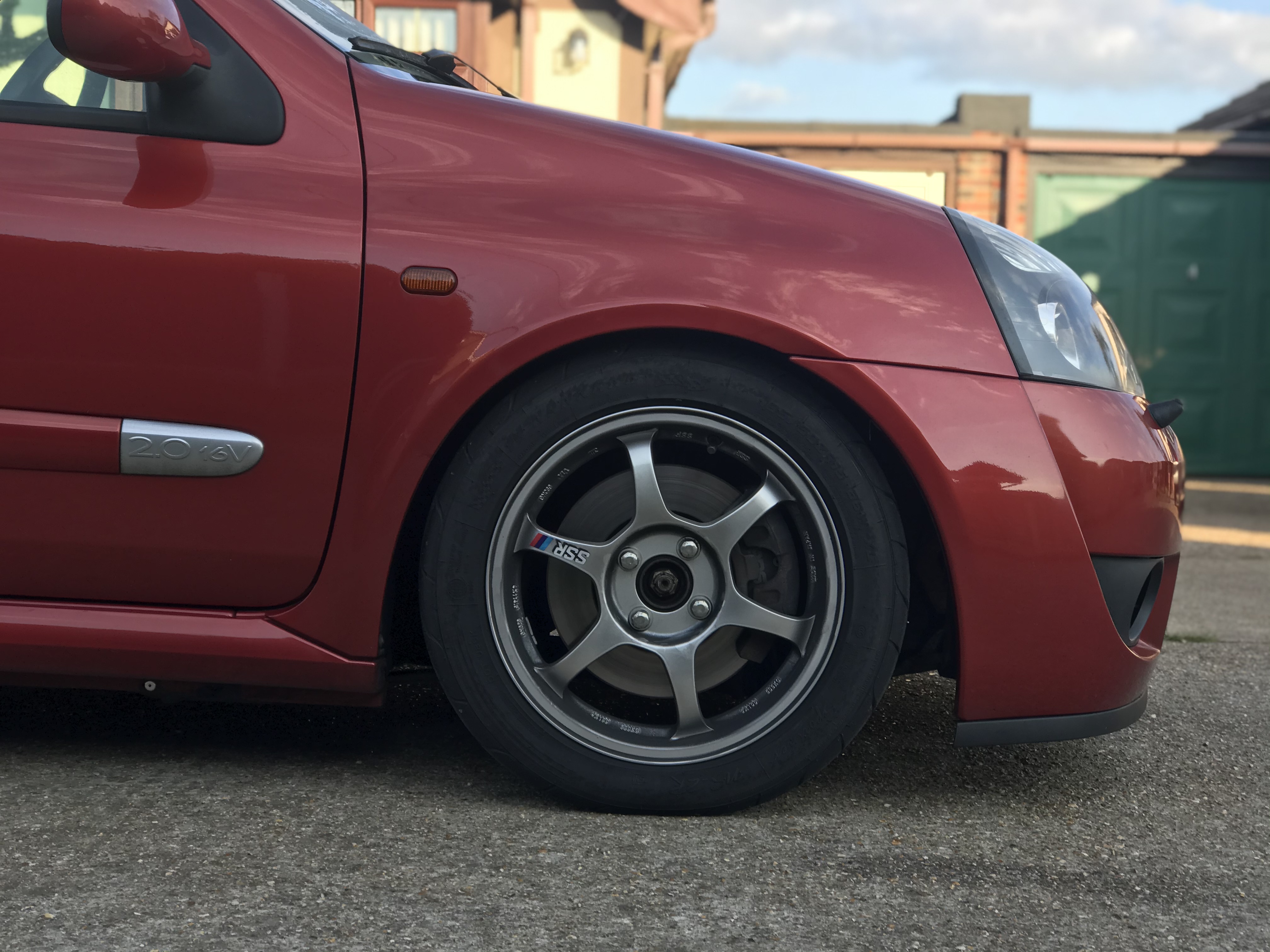

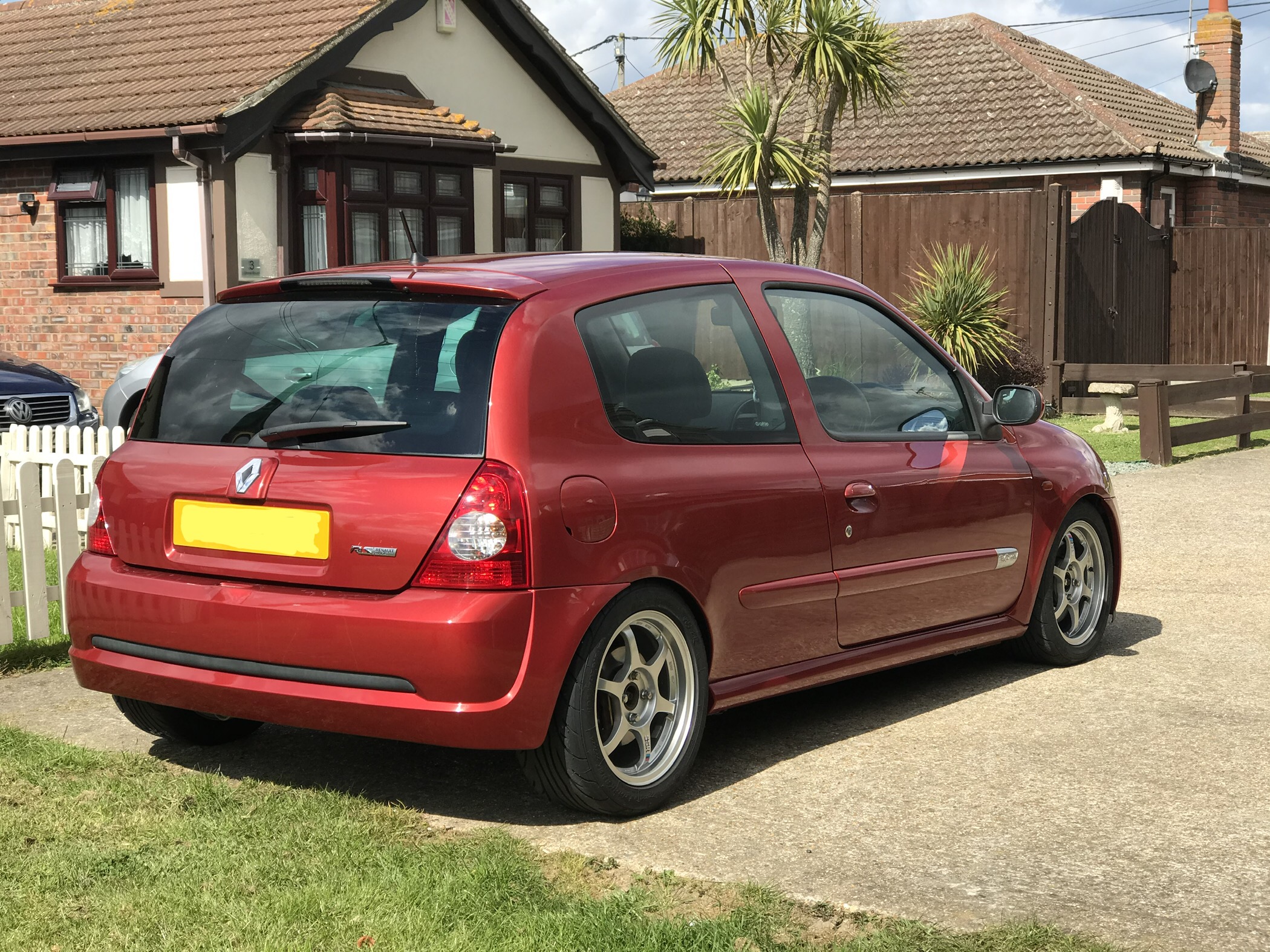

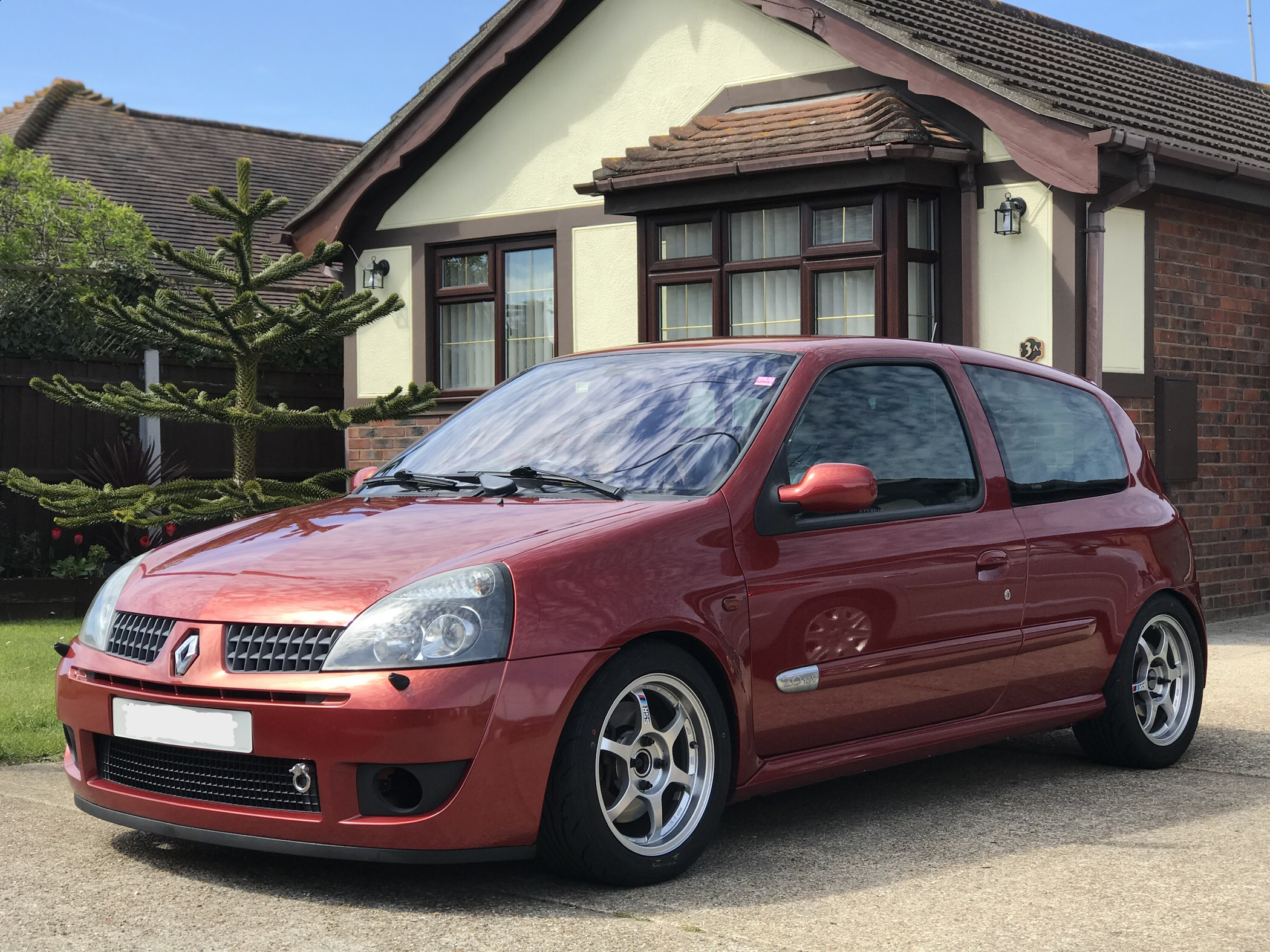

Fitted PMS stud kit and front spacers for thiccness.
Then raised the front suspension a heap to deal with my dad’s thiccness 😂
Also washed the car, it was hugely worthwhile coating the SSRs with sealant as they came up like new as soon as the water hit them.

I was chuffed with how it looked on the spacers, but I took them off a week later as the car drives like shite with them on.
Having said that, I took it out Sunday morning for a country road run and it still doesn't feel happy, I was constantly fighting to keep it on the road into and out of the bends (on application of brakes and throttle basically).
I've since realised that I adjusted the front coilovers a few MM when fitting the spacers so I've probably just been a numpty and left it with too much toe out and the car is more sensitive to poor alignment than I was expecting, so I'll tweak it at the weekend and perhaps do a back to back with/without spacers.

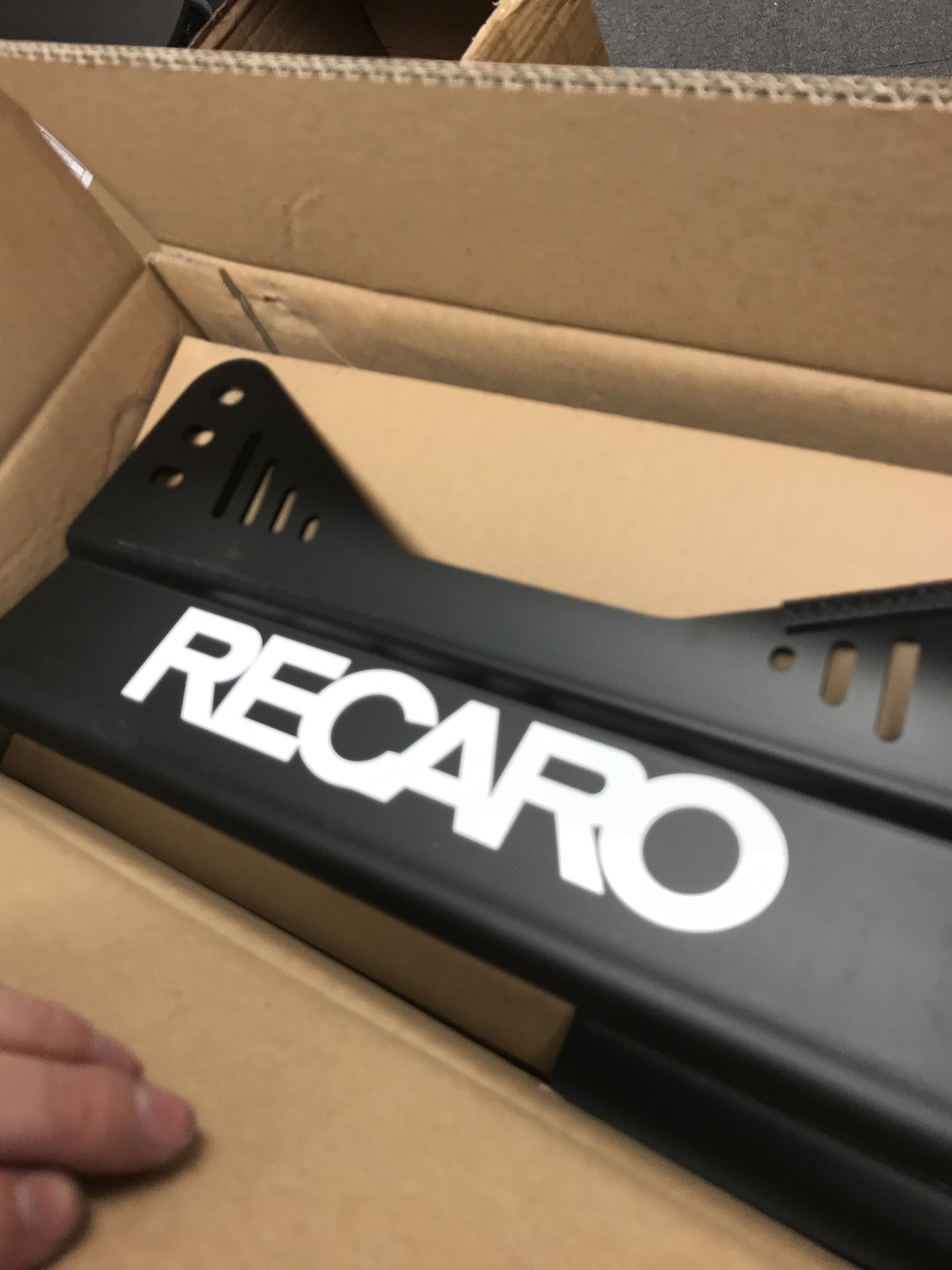

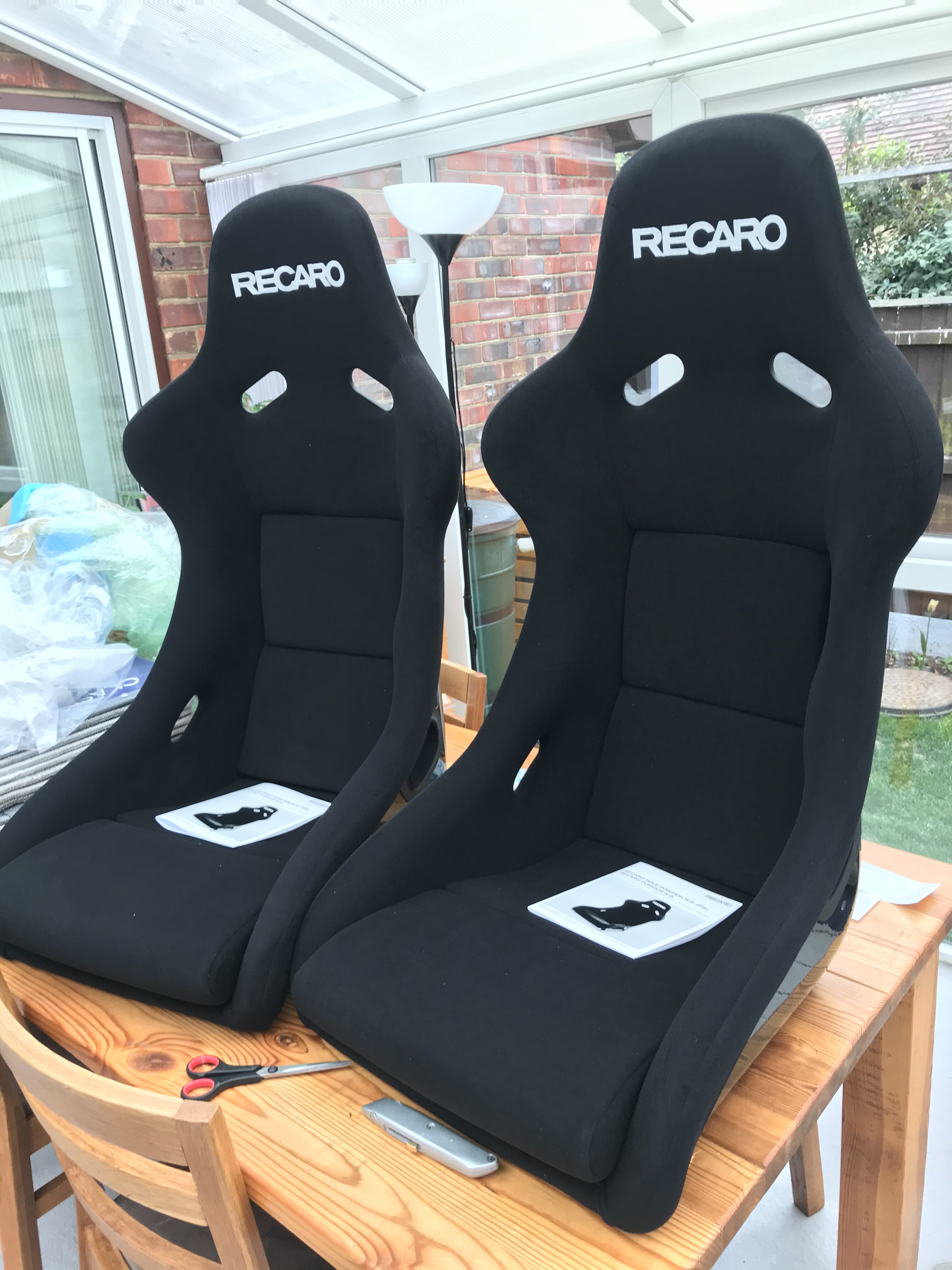

So - in an unexpected twist - I received this pair of new Recaro Pole Positions this week which will find a home in the little red turd.
I wanted to resolve the seating situation in the car ahead of the next trackday (June, not long!) but had reservations about spending money on seats that I didn’t particularly want. I’d been wanting a pair of pole positions for a long time now but the cost was something that put me off, especially for two.
I’m fortunate enough to work in the outskirts of motorsport so one of the guys at work managed to secure me a really good deal on a pair that I couldn’t say no to. Especially as I’d heard so many people complaining about the lead times being quoted for them.
Just waiting on some rails from the man himself Jon Foz and they’ll go in.

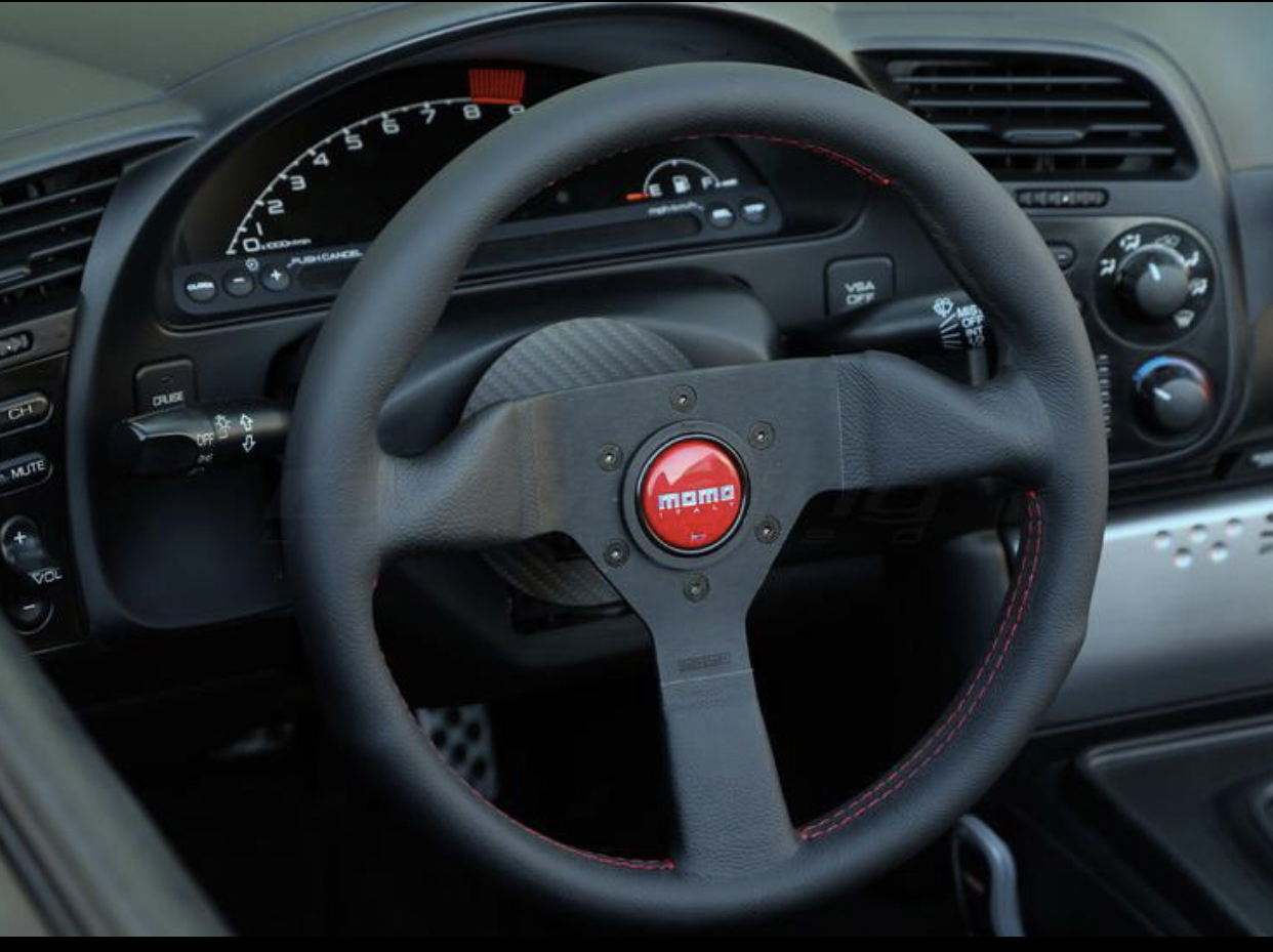

I also picked up a Momo Monte Carlo through work at an equally ridiculously low price so that’ll go in at the same time for a nice clubsport feel.
(Not my photo)

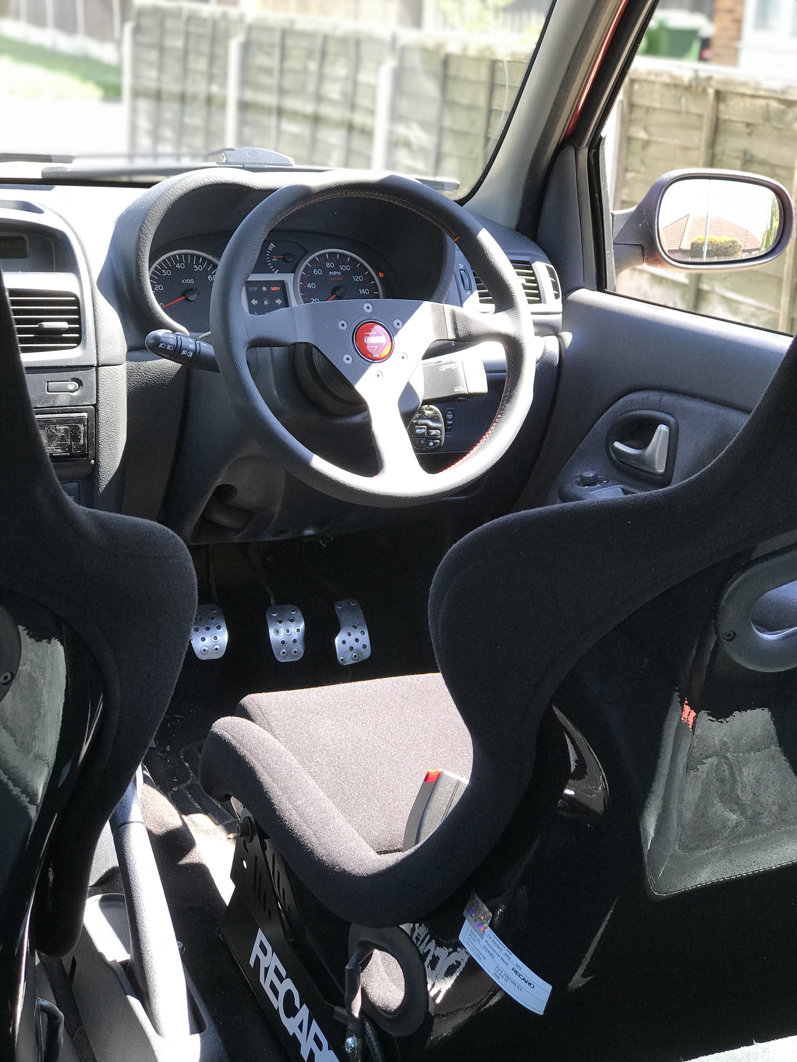

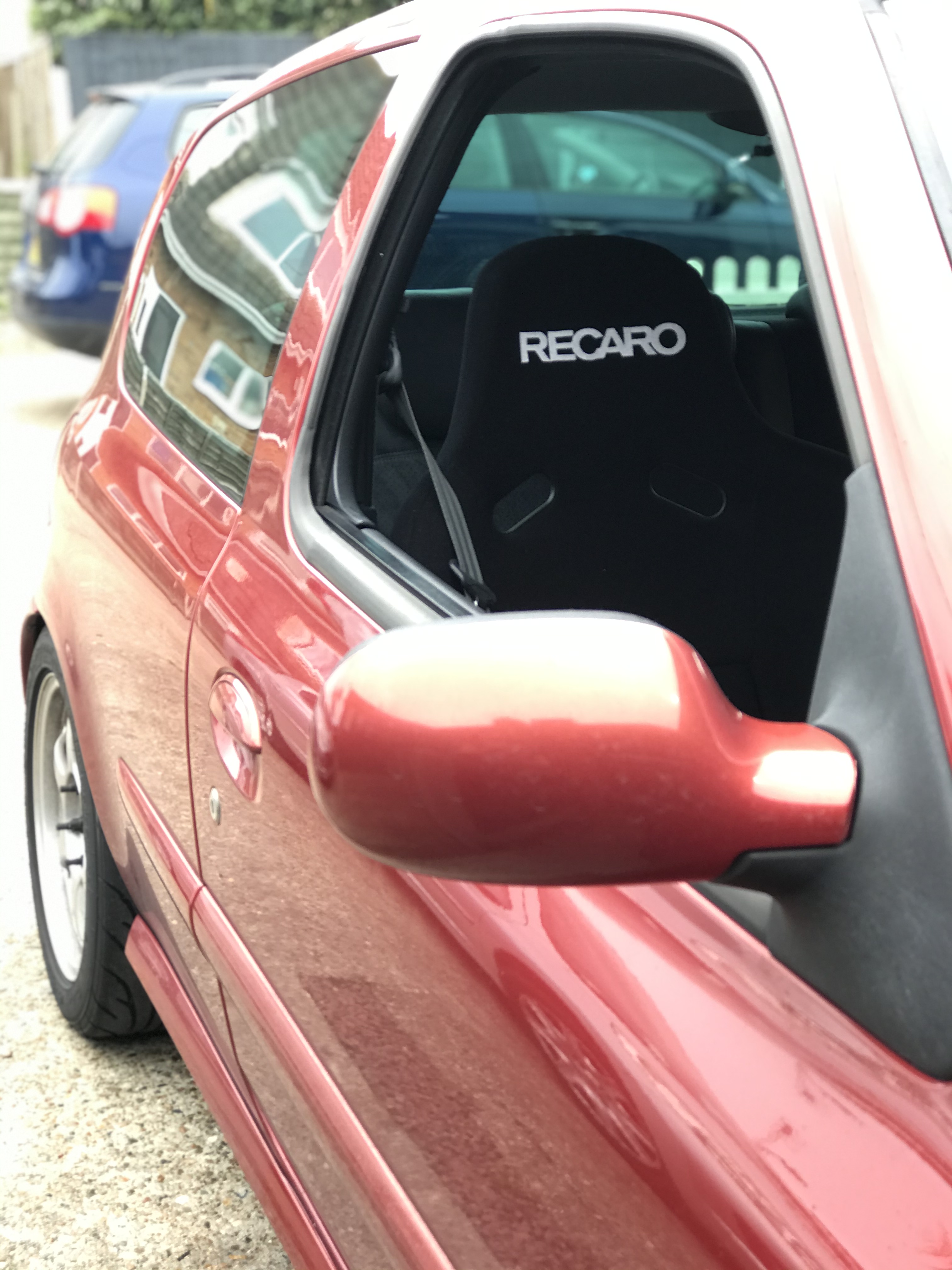

Prepping for Brands Hatch on Monday..

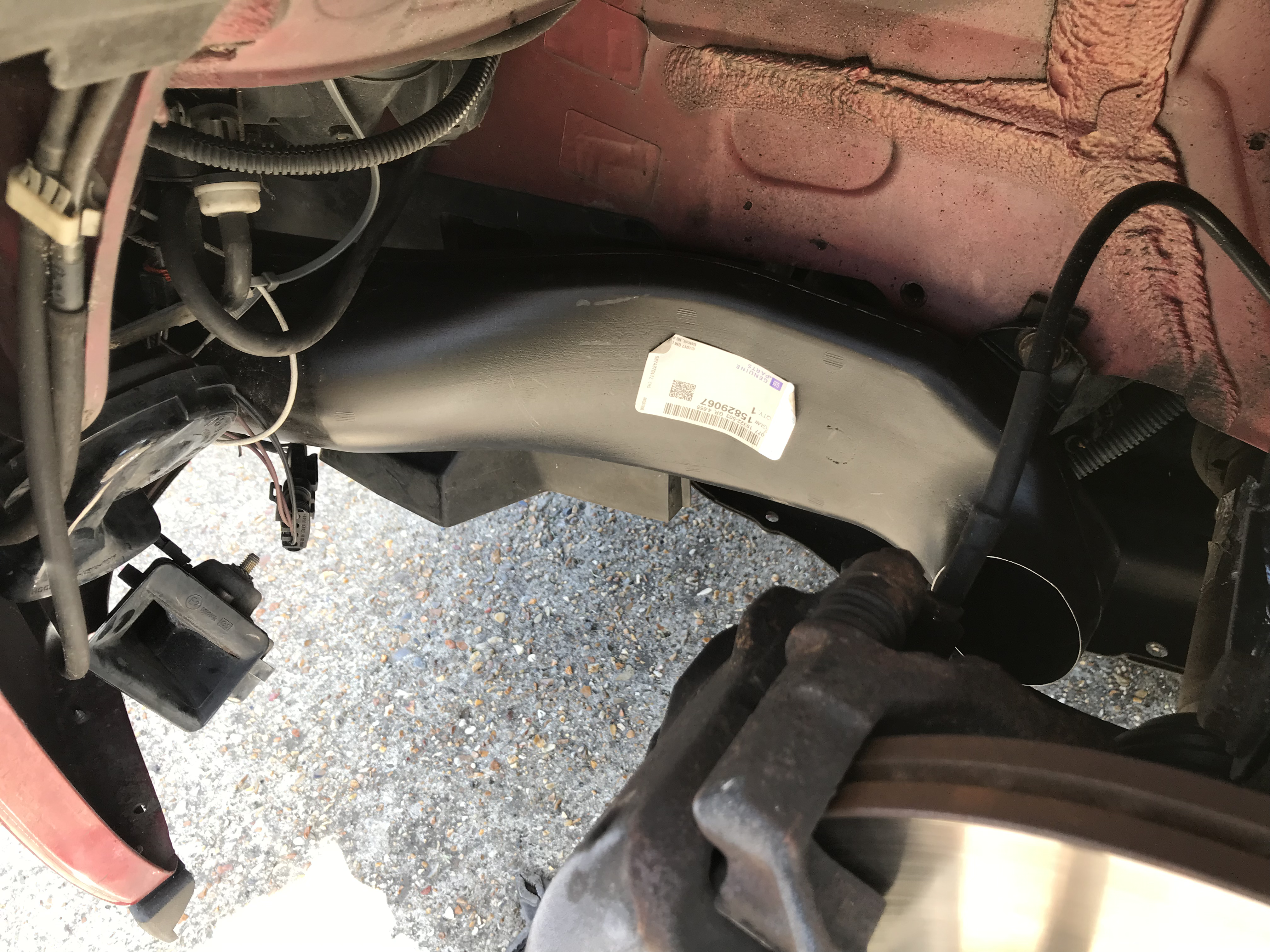

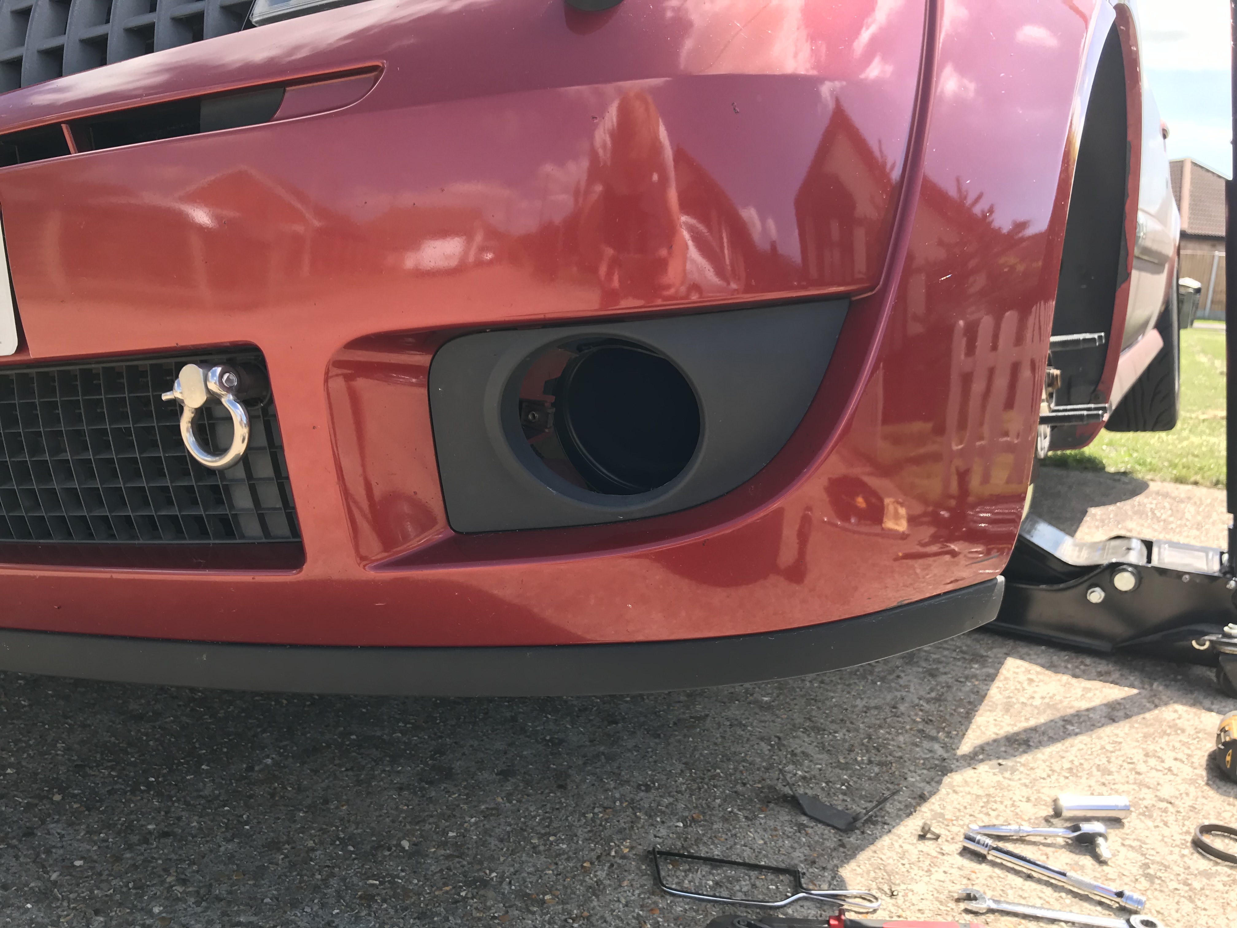

Quick alignment, and fitted the Corvette ZO6 brake ducts. Took some massaging to get around the canister in the drivers arch but the passenger side was easy peasy. Need some fog light ducts to tidy them up but I’m pleased.

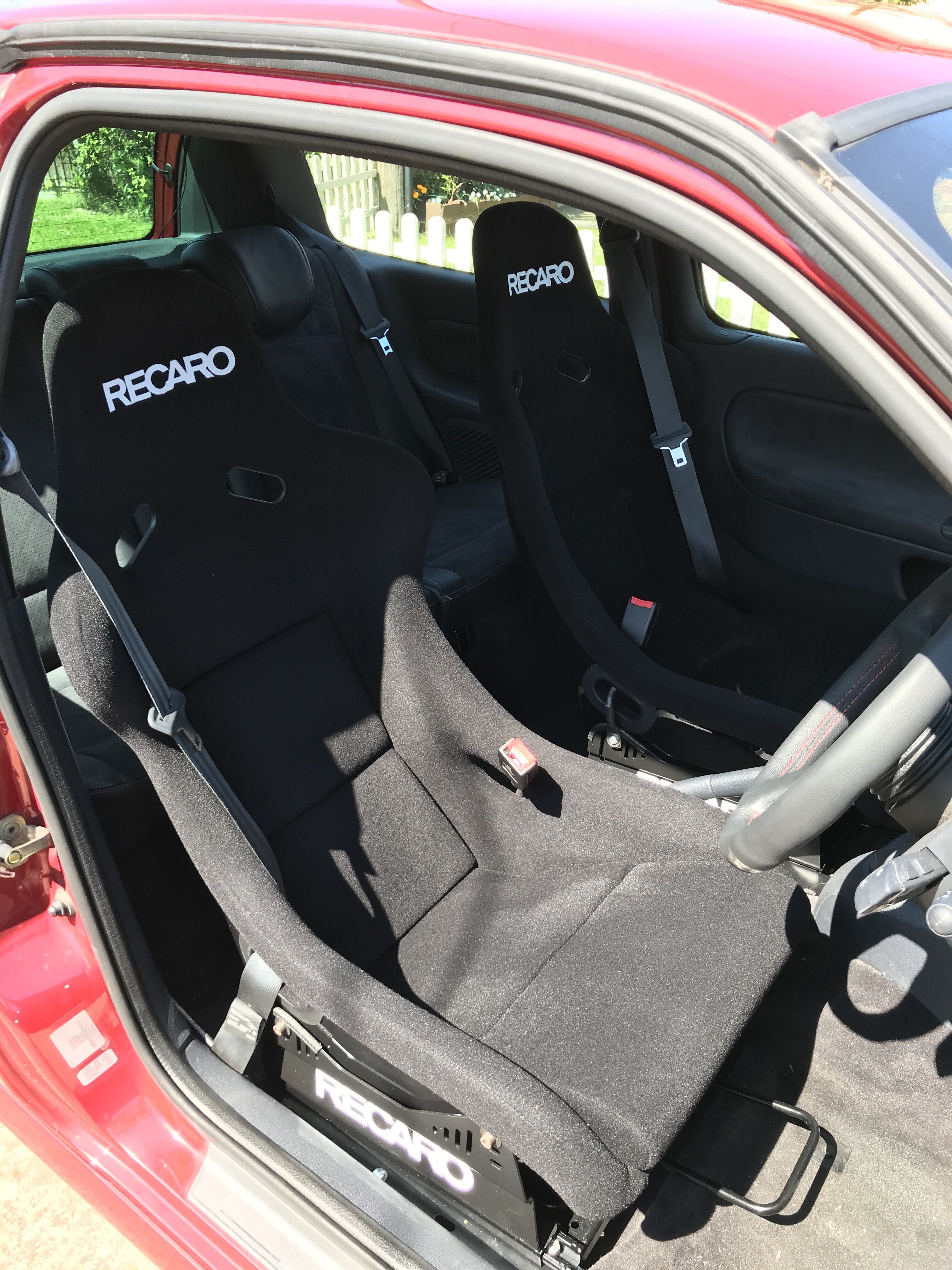

Seats are all buttoned up now and should hopefully make Monday much less of a fight to stay upright in the car 😂

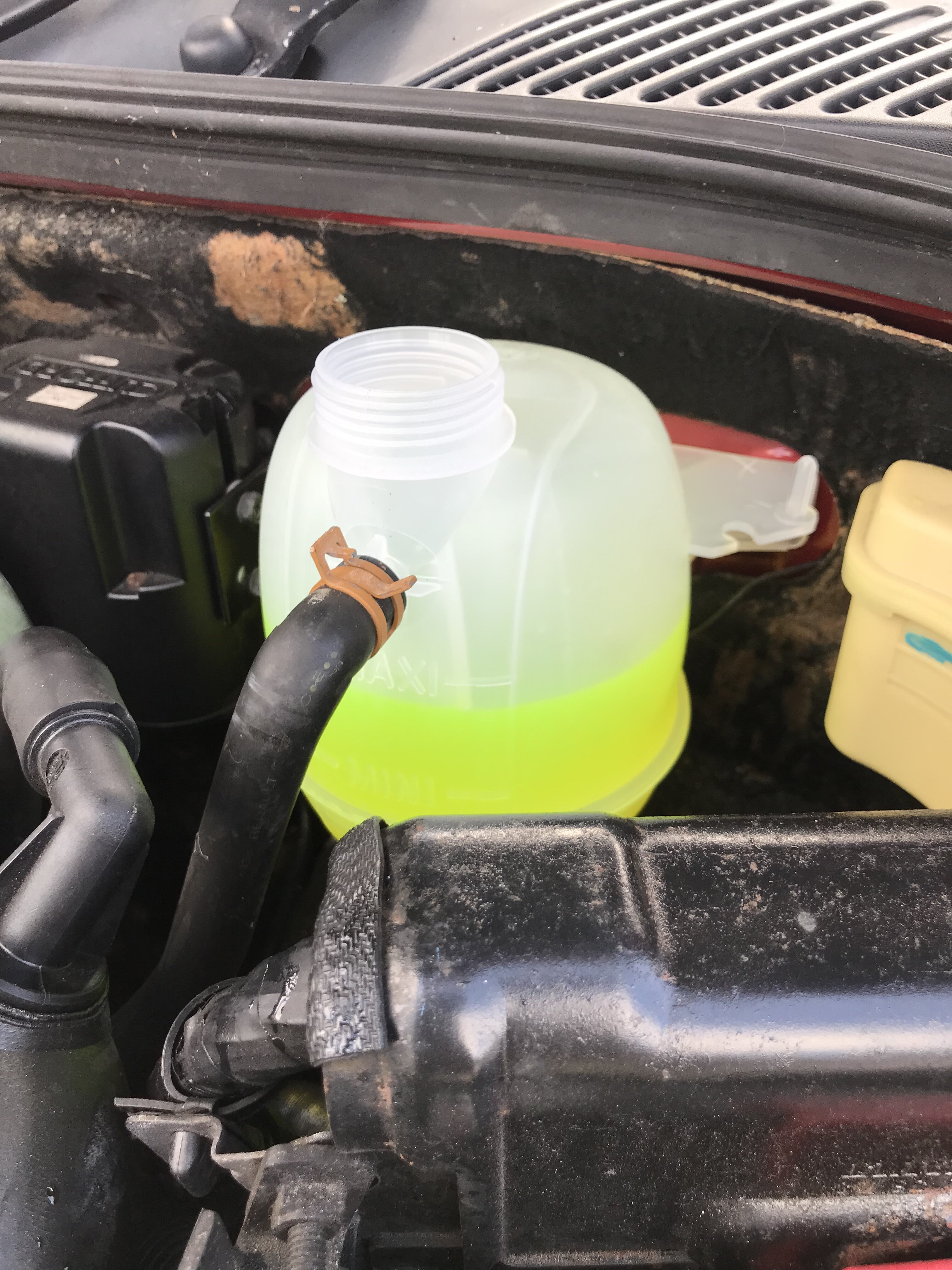

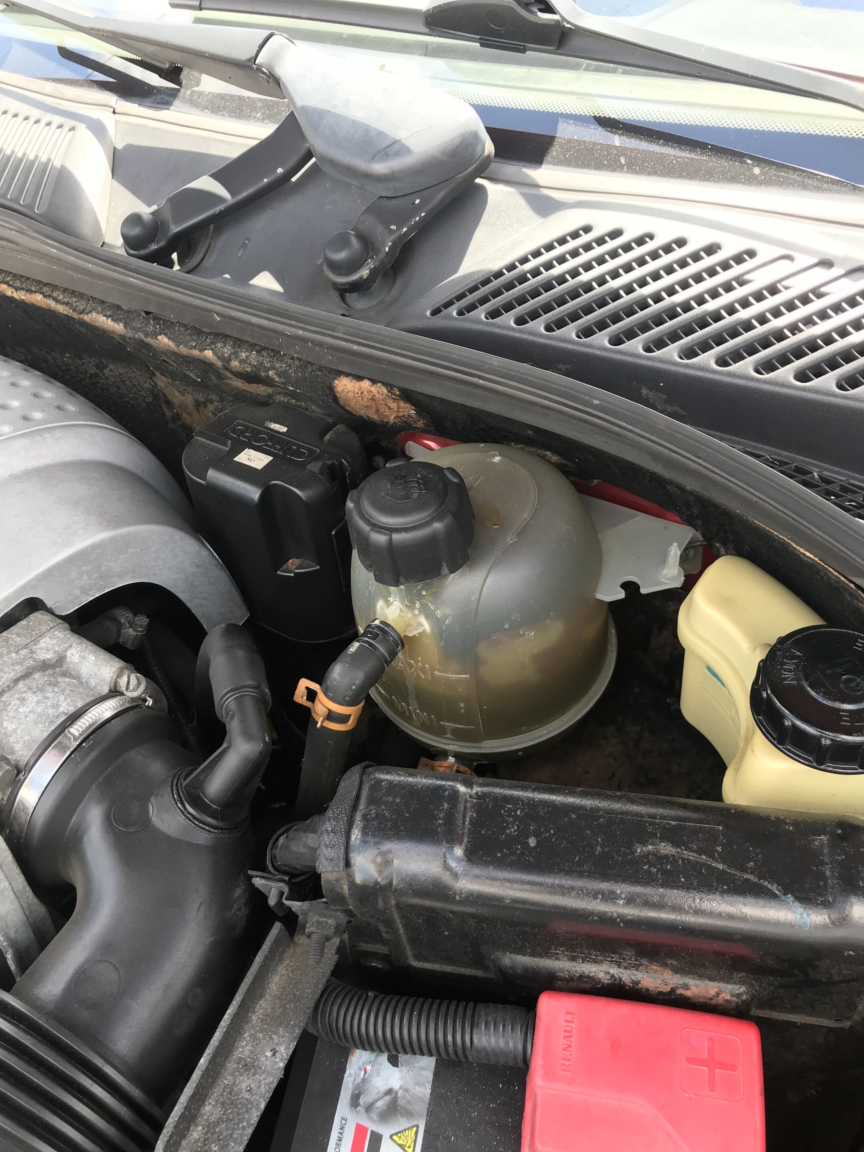

Coolant bottle changed too, as you can see it was desperately needed.

That’s an interesting method of bolting your seatbelt receptacle in.. I wouldn’t trust that in a crash - especially with it also bolting in a corner of the seat too.
SSR wheels make this build though, awesome wheels.
Horatio McAllister
Bon Jovi Officianado
That’s how they are mounted as standard isn’t it? Buckle to the seat frame and webbed end to the seat belt mount??
  Ph2 172, R34 Skyline
Thats essentially how they’re attached from factory so I’m sure I’ll live.
If I die you have permission to say I told you so.
The fixing is holding the seat in so if it fails the seatbelt is the last of my worries, given that the seat will be going through the windscreen with me.
Interested to know why? If hes crashing and the seat becomes disconnected there hes probably already deaded.
