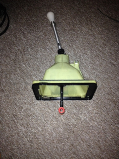

This is the scenic and I believe the standard shifter together. Which model scenic do you get the shifter from? Mk1 any engine size?

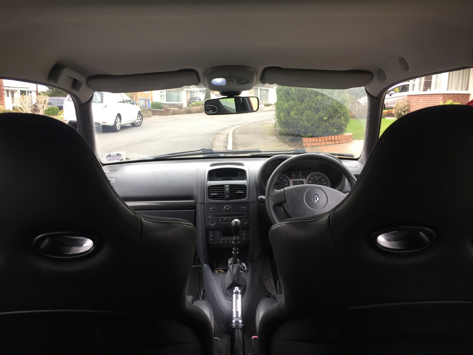

That looks like one of the bms shifters mate, I'm led to believe it is the longer arm and as such easier reach of the scenic shifter that people go for (I've got a PMS one personally) but I believe they need bending slightly to get the position right.
The bms ones were made by one of the members on here, although his username escapes me right now, if you're after a scenic shifter then you're looking for the face lifted mk2 I think it was from approx 98-01, basically the last ones made before renault went to a digital dash in them
any mk1 any engine (1996-2003) scenic will fit,
scenics have a taller turret/tower
if you just extend a mk2 clio lever you will also end up with a longer lever movement to change gear
fitting a scenic one changes the fulcrum point to higher in the tower so you end up with the same standard shift distance to change gear

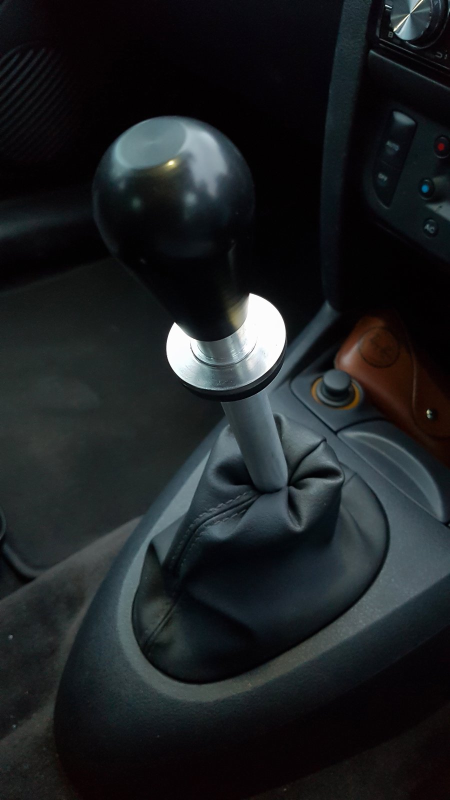

Is there any modification required when fitting the scenic shifter or does it all bolt up the same? I prefer the look of the BMS one in the picture above so would look at doing something along those lines with a steel shaft.

one of the 4 base mounting holes need a little elongating but other than that they're plug and play
