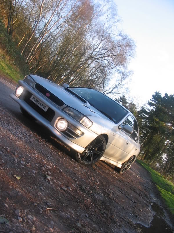

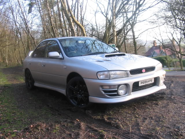

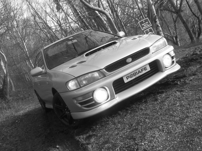

Scooby wheels refurbed
Car  No more clio's for me!
By me :cool: :approve:
Piccies here:
http://www.wjpc.nemesisuk.com/forums/index.php?showforum=17
Yeah i know its not foggy :rasp:
Comments welcome :o
I'll do a set for £75 (paint costs £50-60 for a set so not making much) or £25 a wheel all in - as long as the tyres etc have been removed. I'll even repair minor kurbing - major kurbing subject to review ;) Takes a week to do - allowing to harden between stages ;)
Done with metallic rover grey - spray cans and lacquer :D
