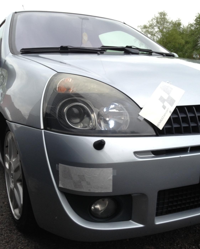

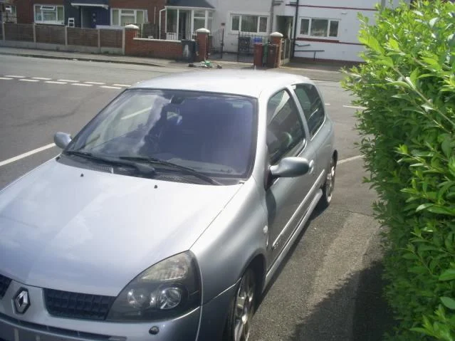

Here is the car:
You may look at the pics and think... arr it looks like a sound car. Pump the tyre up and bobs your uncle.
Oh... so wrong!

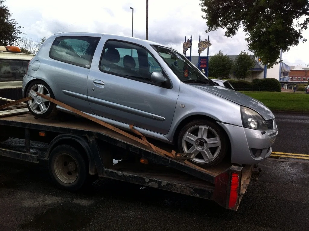

The car has no Tax or MOT and has been left since 2009. On first inspection the Tyres were all completely slick... They have been driven well beyond their legal limit & the disks were completely shot. I decided to get it moved using a transporter.
Whilst getting it onto the transporter the guy ripped the front bumper off and smashed the front fog lamp. I was pretty annoyed at this and swiftly got a discount off the car.

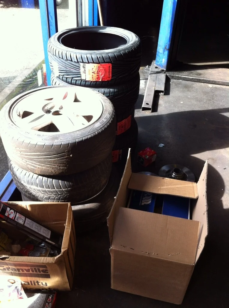

You may ask what it failed on... a few things I shall list.
Front Discs - £80
Front Pads - £18
Rear Discs with bearing and abs sensors - £300
Rear Pads - £26
4 Tyres (Went for Uniroyal Rainsport 2) - £420 with tracking and alignment
16 Wheel nuts as only 2 on each wheel - £28
CV joint boot kit - £14
Antirollbar bush kit - £5
All round Springs - £170 (Went for H&R 30mil drop)
Xenon Bulb - £80ish
Window Wipers - £30 (Went for Champion Contact Blades)
2 Tie Rod ends Outer - £30
2 Tie Rod ends Inner - £30
2 New reg plates - £25
+ more like seat belts, horn doesn't work, fluids, other bulbs etc

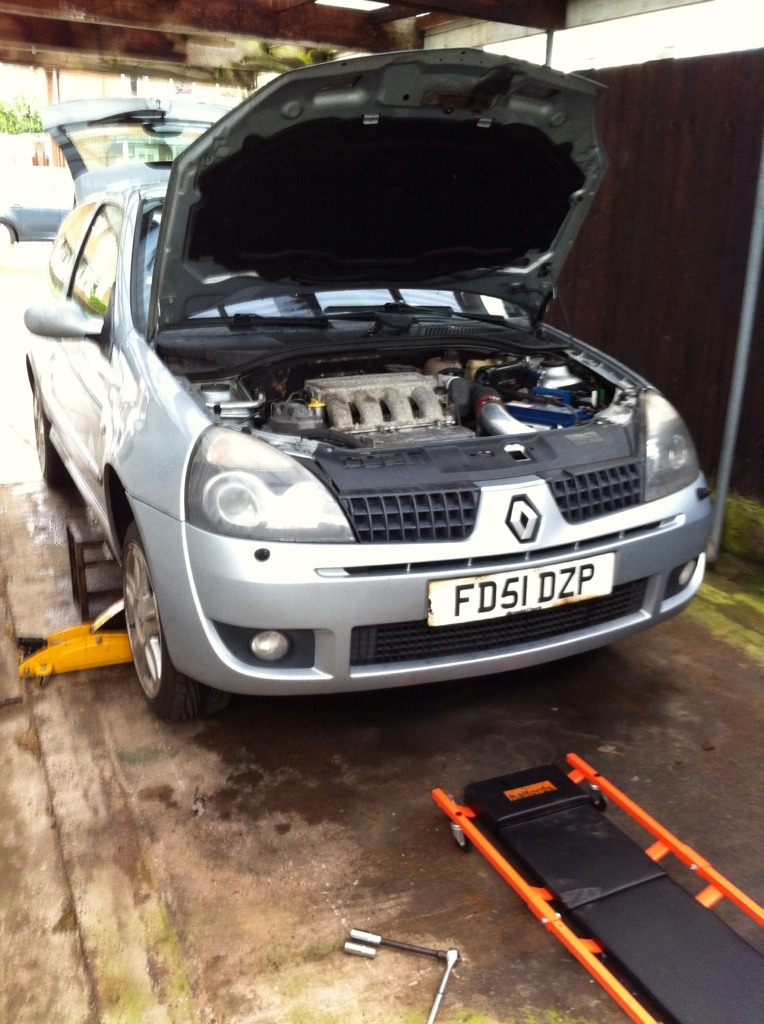

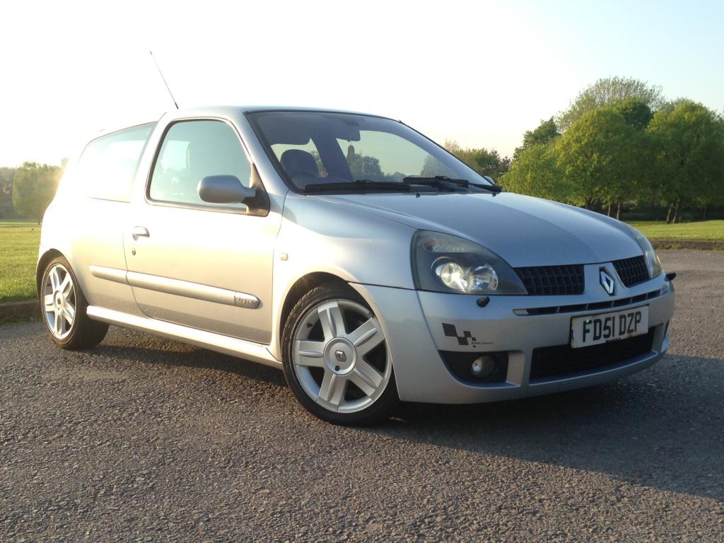

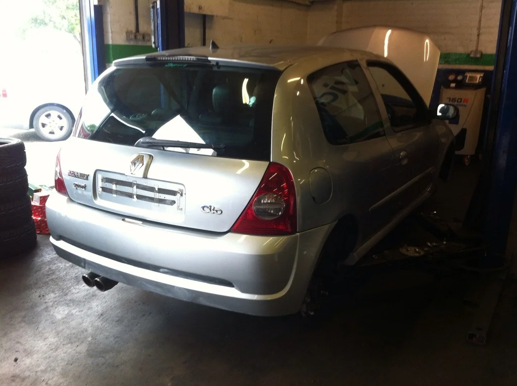

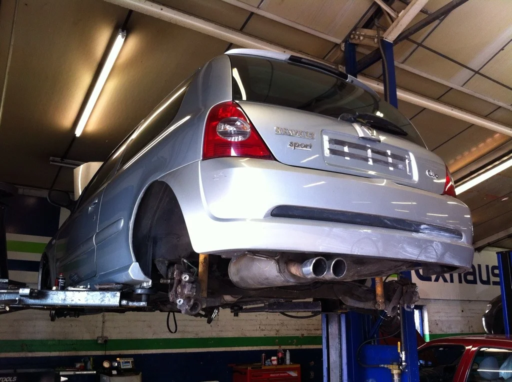

The photo is of the car as it looks today when I visited the garage. I really hope to have it all sorted and back in the next few weeks.

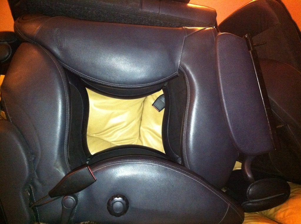

Just a quick update. Full replacement interior has been sourced and currently resides in my living room. I don't want it getting damaged in the shed or by the wolves so leaving it on the spare sofa until i get the car back from the garage.

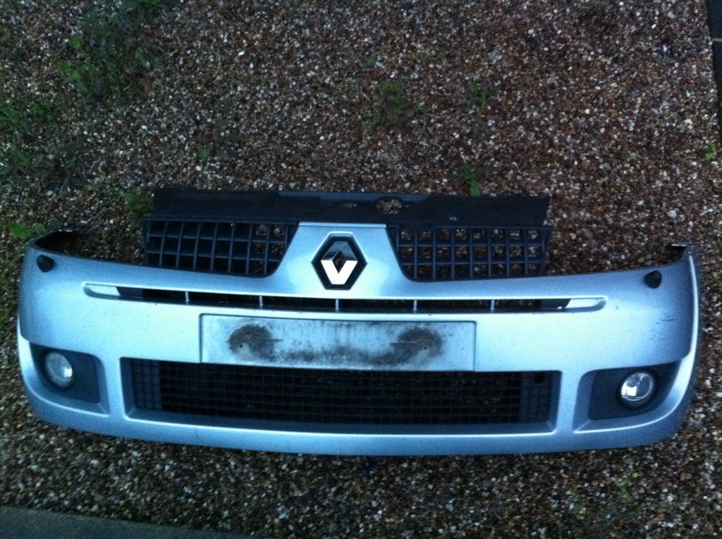

Replacement bumper now purchased. The paintwork isn't perfect but it is complete and pretty good. The other bumper got ripped off when getting it on the truck and is literally only just hanging on. This is the last item before i get the car back from the garage later in the month. I shall re-visit this project after the new year. It will be stored until then.
Another update. The car now has the following done:
All the following are brand new parts.
2x Inner toe rod ends
2x Rack ends
1x Cv joint boot
1x Hella Ballast
Lucas Xenon Bulbs
2x Antirollbar bushes
Front & rear H&R Lowing Springs
Front & rear Discs and Pads
4x Uniroyal Rainsport 2 tyres
Bosch Battery
16x Wheel nuts
Blade Window wipers
Rear bulbs all replaced
A few other jobs have also been done including sorting the horn, tracking, alignment
This is phase 1 of the work now complete.

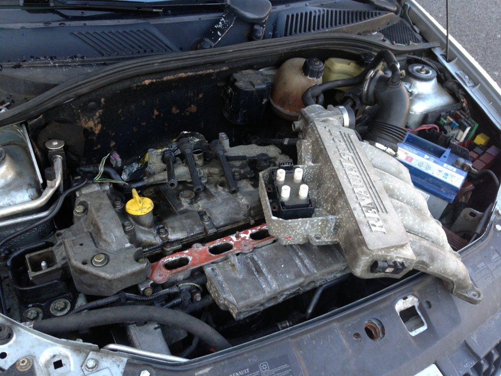

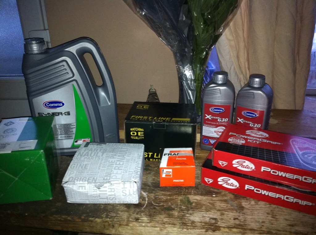

The following picture shows what parts are being fitted on phase 2. (note: I got 2 cambelt kits a didn't know which one it was until the current was removed)
Something a little more interesting and an update on phase 2:

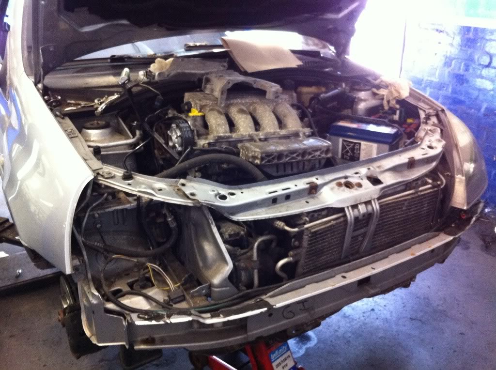

The engine was dropped out to change the cambelt.
The cambelt kit, dephaser pulley, water pump, tension pulley, aux belt, oil, filter, coolant have all been changed.
I'm just waiting for a new alternator to arrive and then can fit the bits back on including replacement bumper and xenon ballast on the headlight unit.

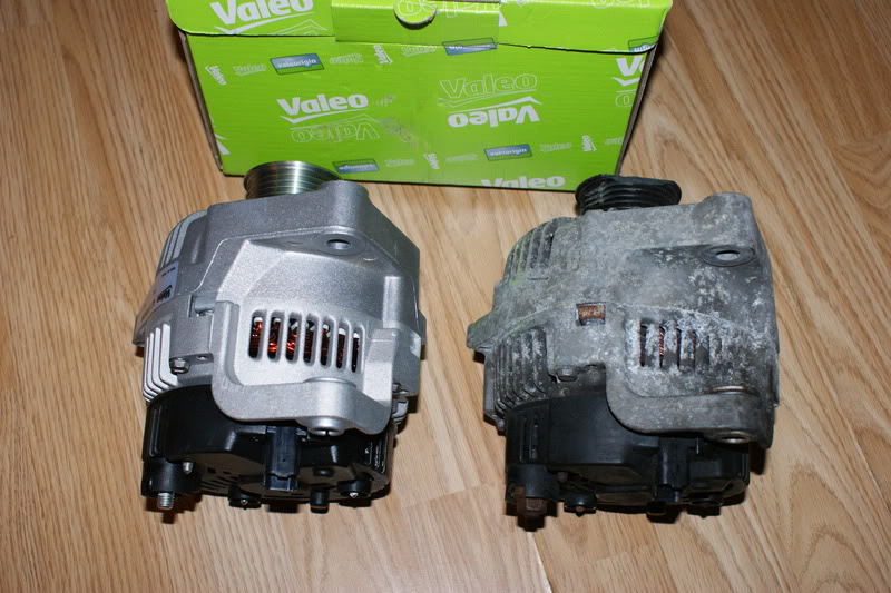

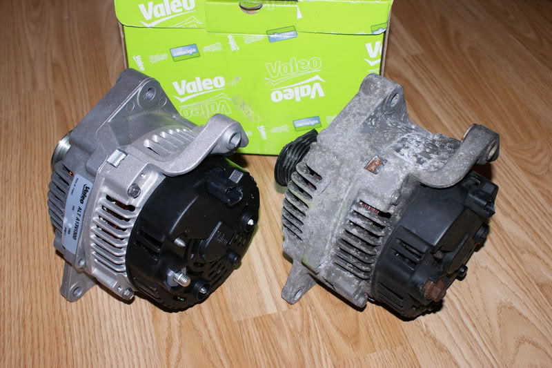

Another update. After nearly a month of waiting for the alternator to be shipped from Valeo's factory in Italy it finally arrived.
It is an updated version of the original Renault one. Pretty much identical as you can see. The damage on the old one is evident. The metal casing is also cracked and completely seized inside.
Next job... fit it and put the car back together ready to get out on the road and test drive. Then interior changing time :)

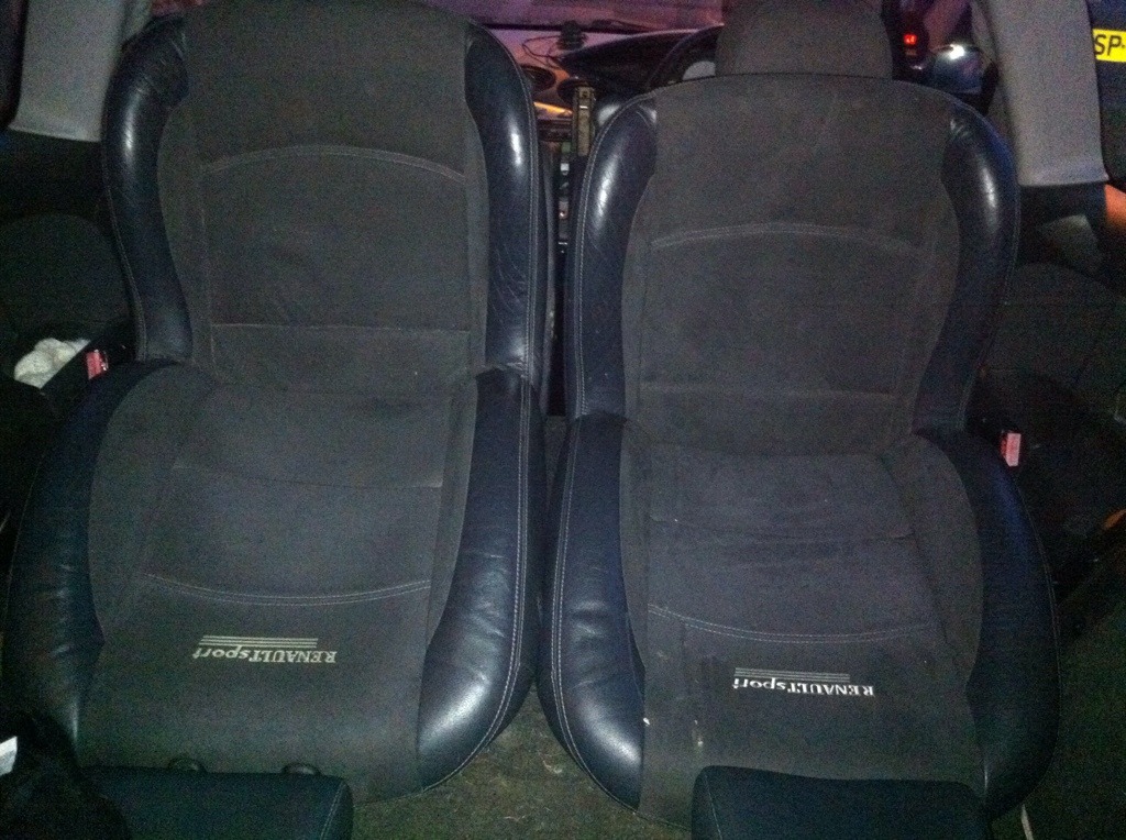

I had the interior seats replaced with my replacement ones (they are only short term until i can source some bucket replacement seats). I also had a front wheel bearing replaced due to it being noisy.

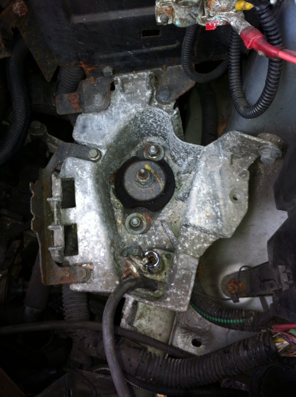

We decided to tackle the upper gearbox mount next. This is located under the battery.
We got down to the mount which holds the gearbox to the frame. We jacked the gearbox up with wood on top to stop any damage. We couldn't get the center nut out of the rubber mount. After trying a few methods and bashing heads together I finally tried a brute force technique and "BANG". the nut freed off. I thought I had snapped the bolt in half (which can only be purchased from Renault) but luckily i hadn't.
Here is Kev very happy with the extraction

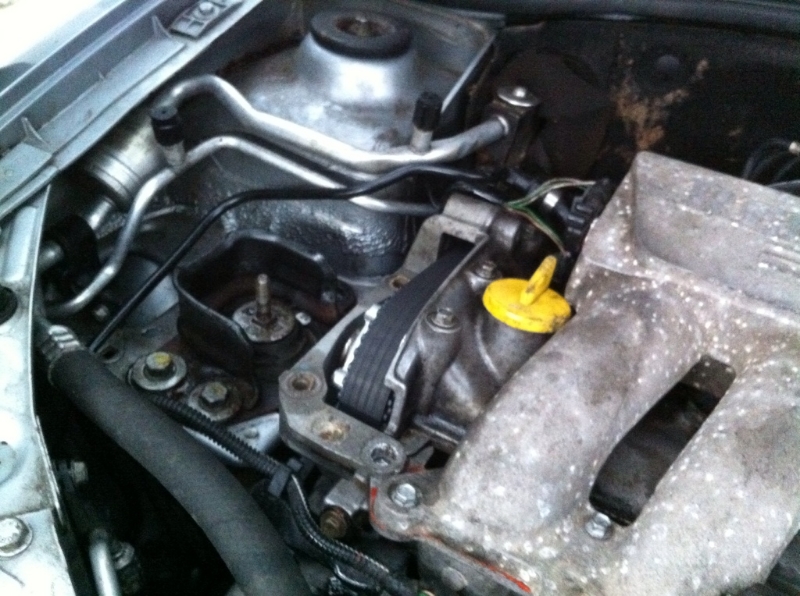

Next we tackled the Upper Engine Mount which holds the engine to the frame.
Amazingly enough Kev advised me that when Jacking the car up to meet the new mount the engine was actually raised about an inch and a 1/2. This is how much the engine had dropped on the faulty mount.
After about 4 hours work we had managed to successfully change 2 out of 3 mounts. We pulled the engine forwards before doing all the mounts up to pull the manifold away from the subframe. It has very little clearance.

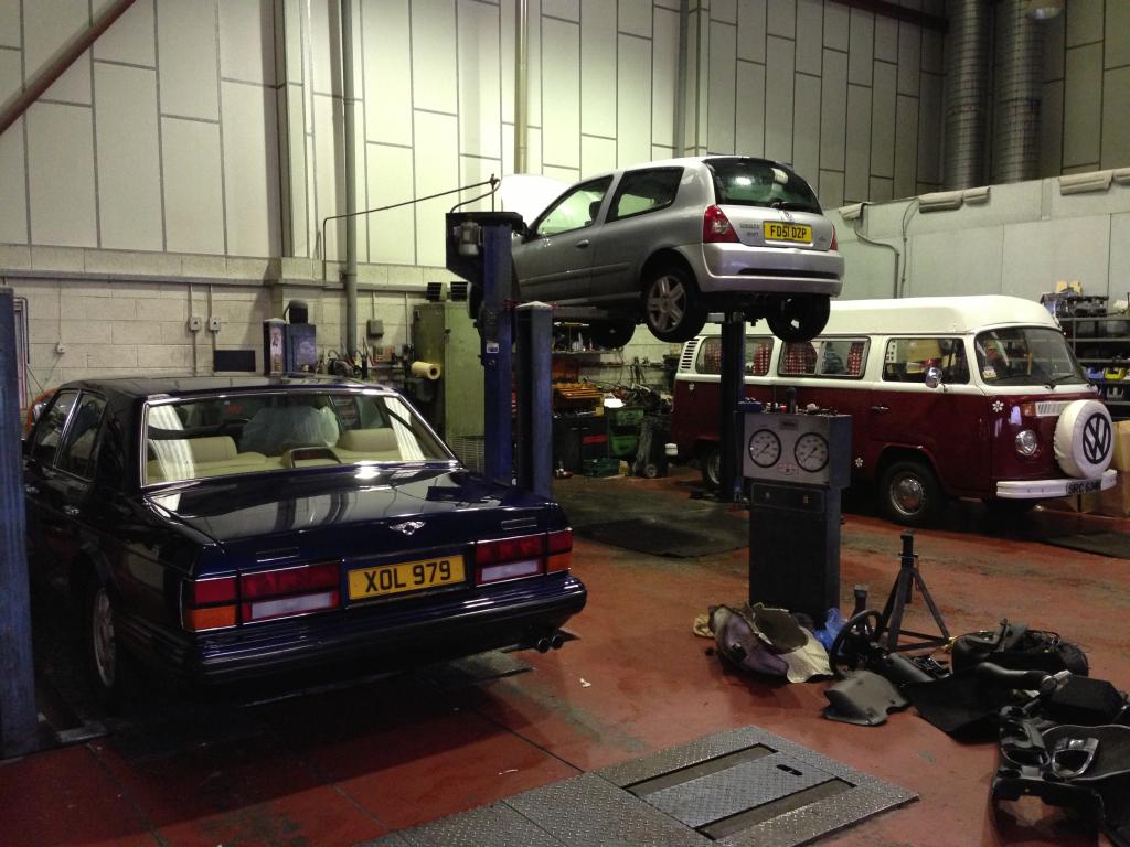

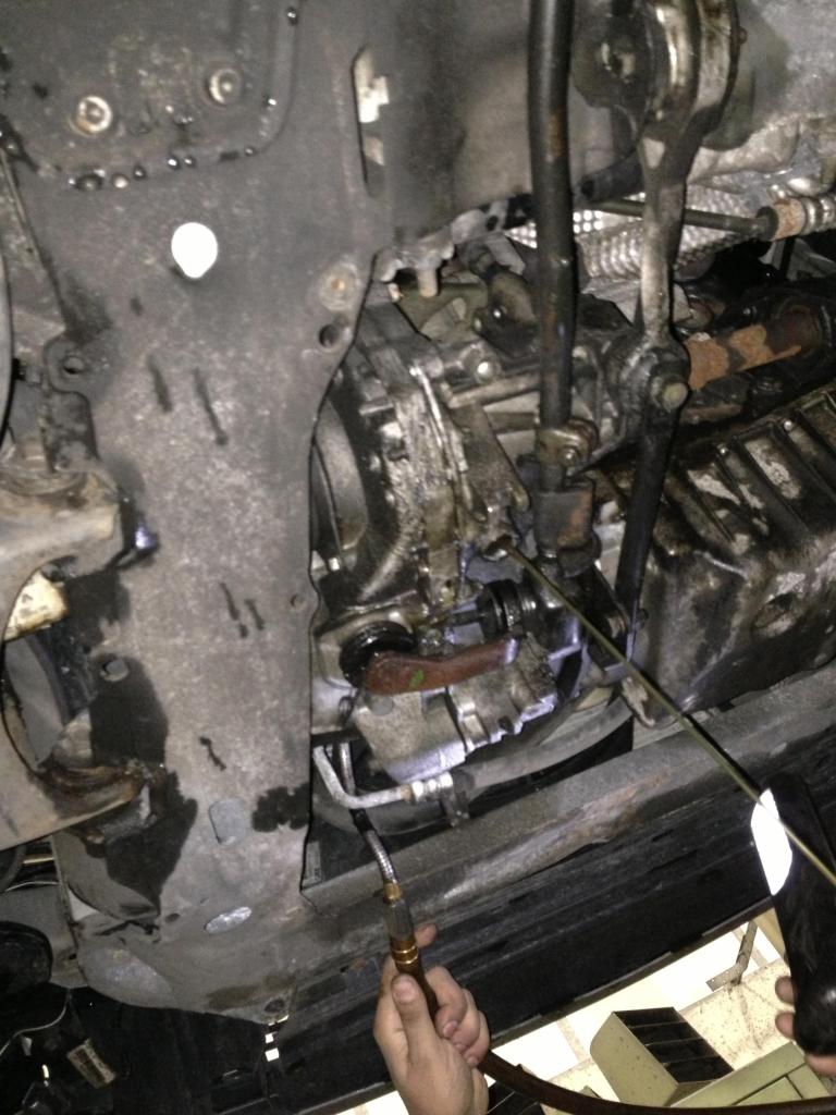

I've not done an update for a while now so wanted to fill the gap.
About a month ago I took the car to my normal garage to have the gearbox oil changed. It was a bit of a faff but I'm glad I had it done.
There was a couple of nice cars there too:
It was nice to see there was oil still in there. Not much mind.

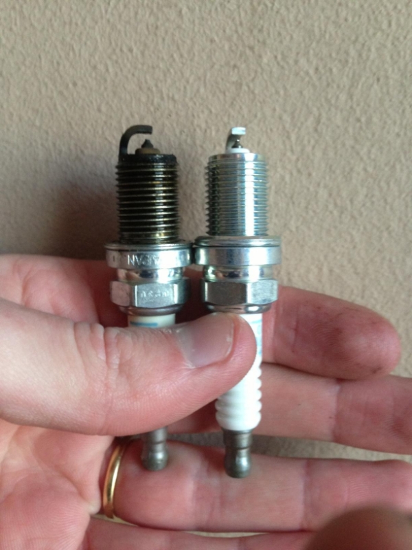

I also decided to give the car a bit of a spruce up with the ignition system as I've not really touched this apart from a new battery and spark plugs.
I set about getting things changed:
The spark plugs have only been in there for about 2000 miles and look like that.
I replaced the Spark Plugs, Coil pack and Ignition Leads. All precautionary but well worth doing in my opinion.

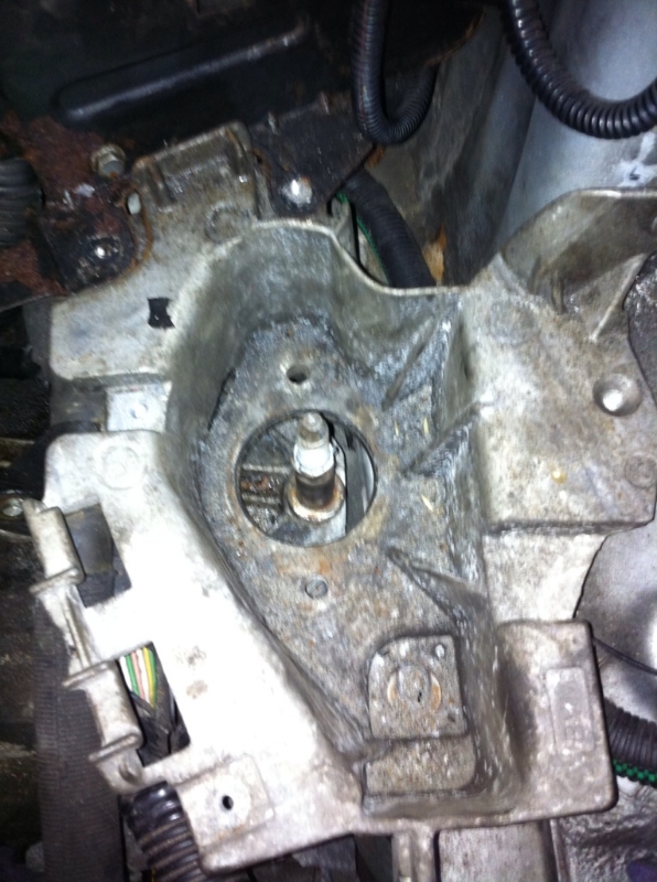

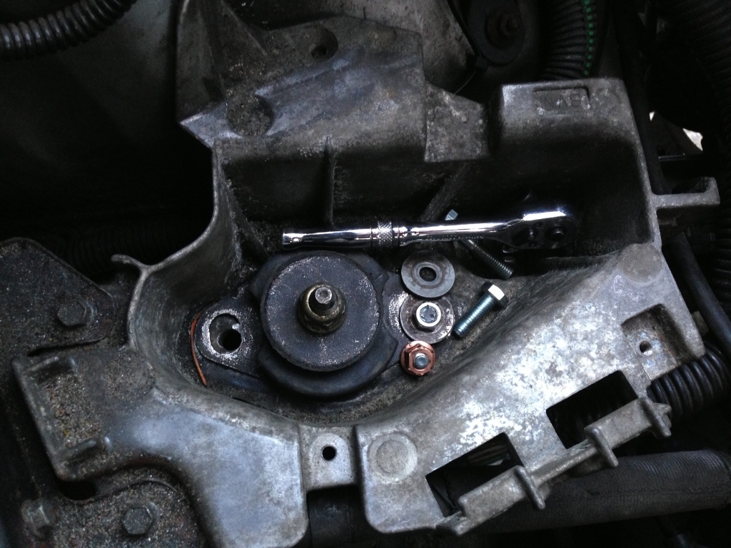

After having a Clunking/Vibrating Steering problem for the past month I finally found the problem.
After securing the top engine mount again I decided to re-assess the top gearbox mount. Out come the necessaries and immediately the problem was apparent.

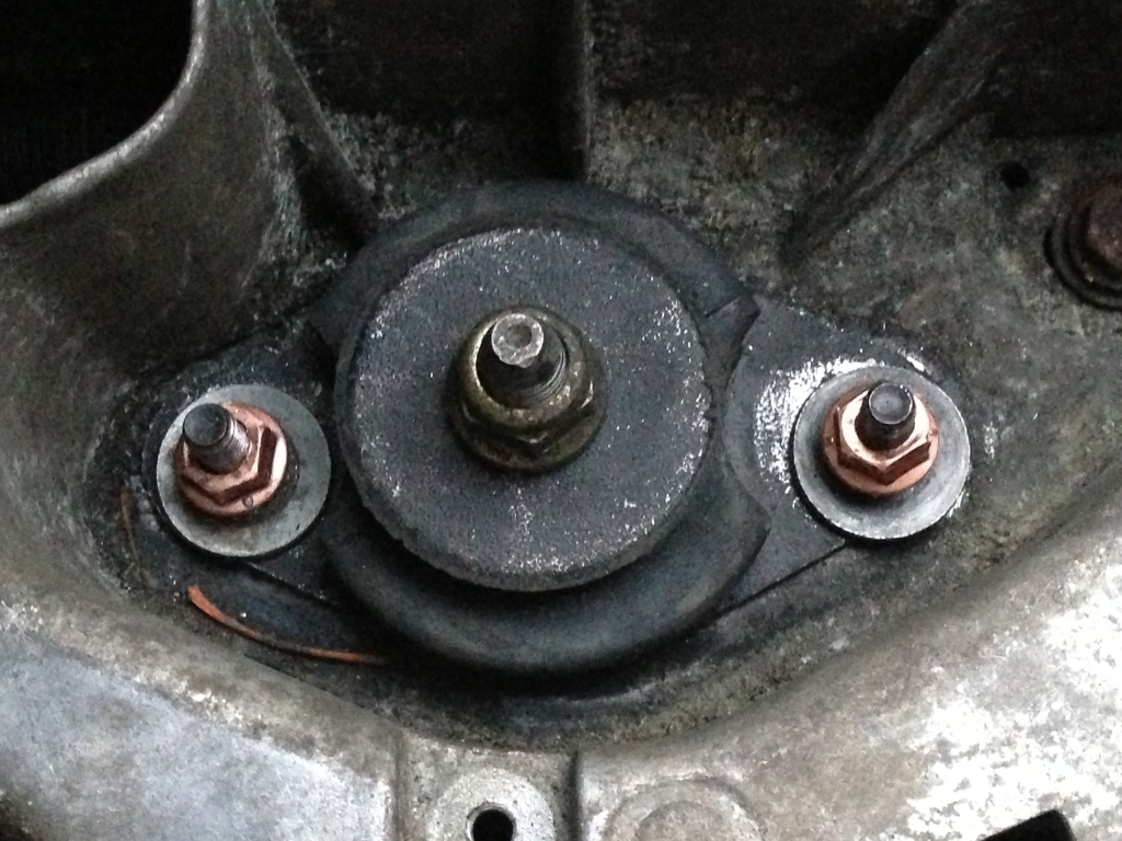

The two bolts had sheered their nuts and had dropped completely out. There was nothing holding the mount to the body.
After a visit to B&Q. I purchased the correct nuts & bolts M8's and proceeded to secure the bracket again.
As you can see... this didn't entirely go to plan. After torquing the nut up the bolt sheered in half... this was only about 20nm aswell. Complete garbage from B&Q.
I then proceeded to option 2 and got myself some high strength bolts with copper coated anti-rust locking nuts.
After some seriously fiddly work getting the bolts in the bottom of the fixing tray I torqued it all up nice and tight!
Now the car steers exactly how it was built to... no noises or vibration... Nurburgring... very very nearly ready!!!

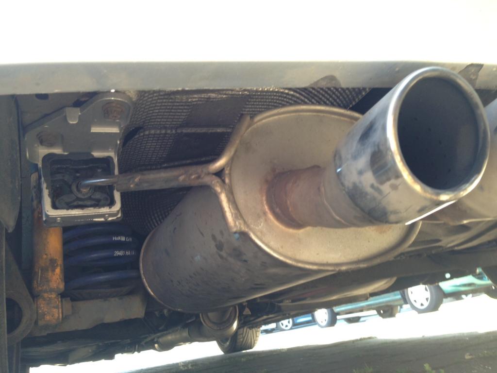

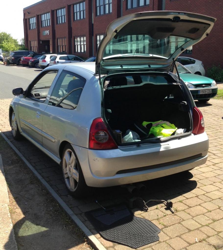

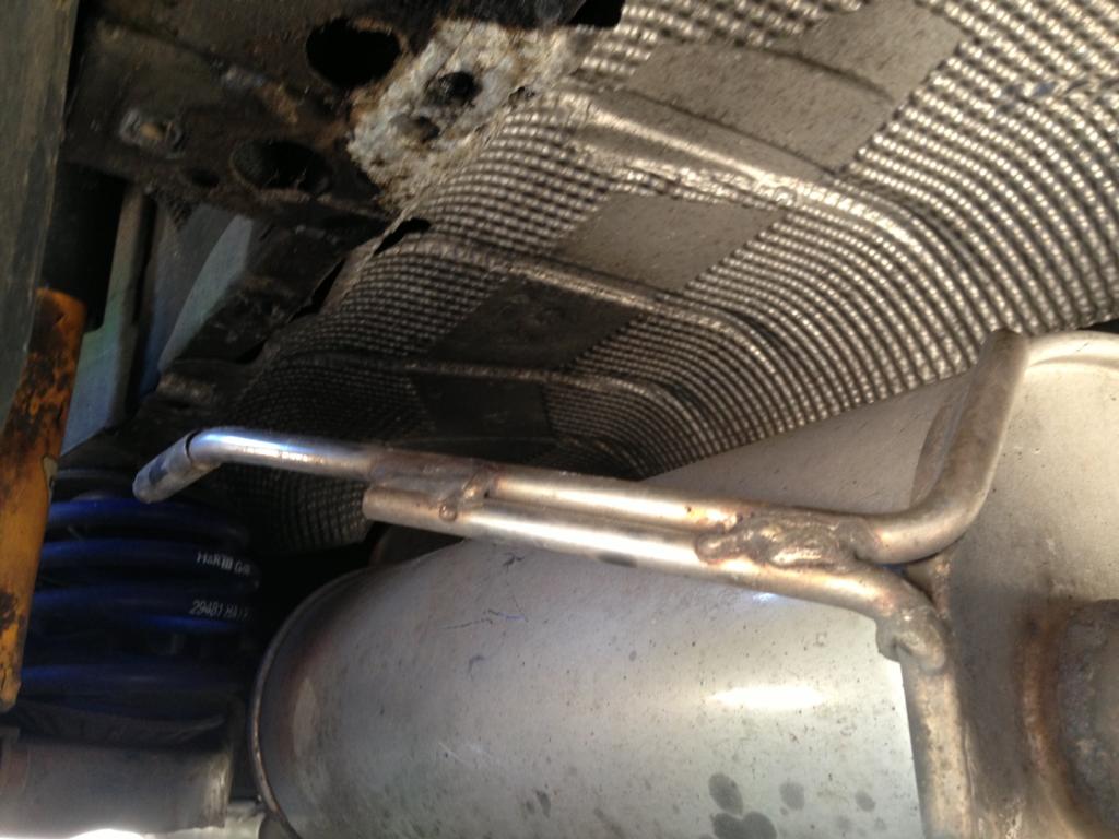

After the rear exhaust mount rubber mount completely splitting and the back box resting on the metal at the bottom of the mount it was time to get it changed.
At work today on lunch I changed the mount. Pretty easy to do, just a little difficult as the car is lowered so visibility wasn't exactly excellent.
Bracket and Mount completely removed:
New Mount added and original bracket removed (isn't required with current exhaust)
