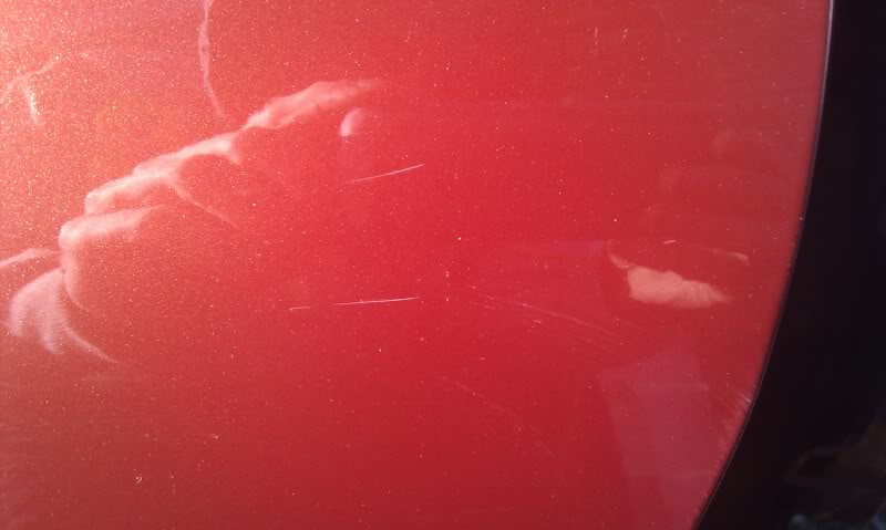

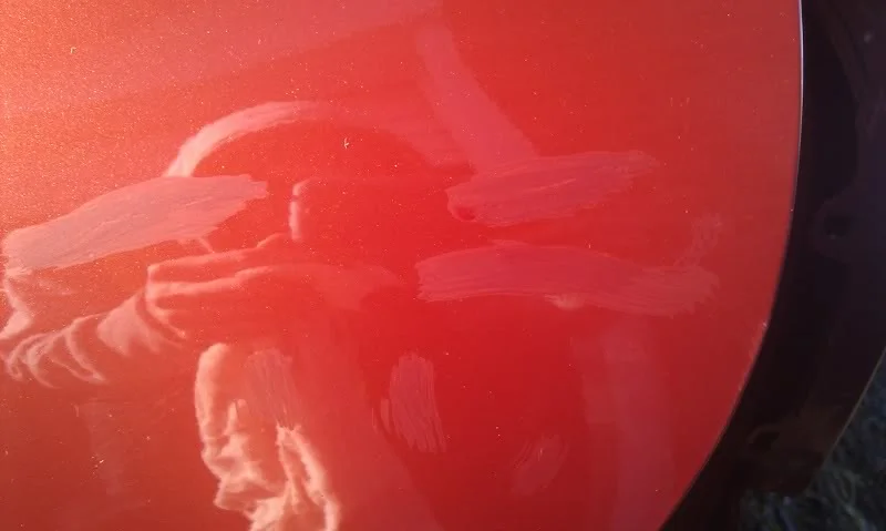

ill be honest pics dont realy give the true quality of this repair, but basically its s method i use to remove swirls, chips, deep scratches thorugh to basecoat and light 'matted' scratces where the paint has not fully cut through to basecoat but become matt and scored.

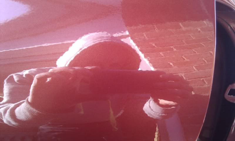

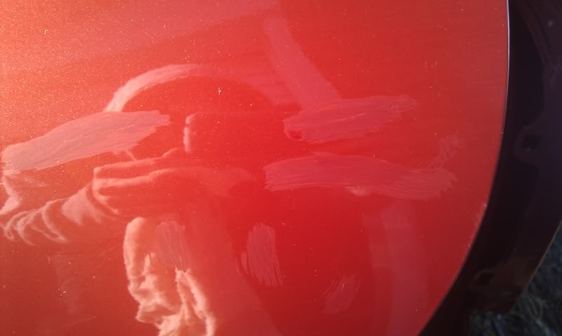

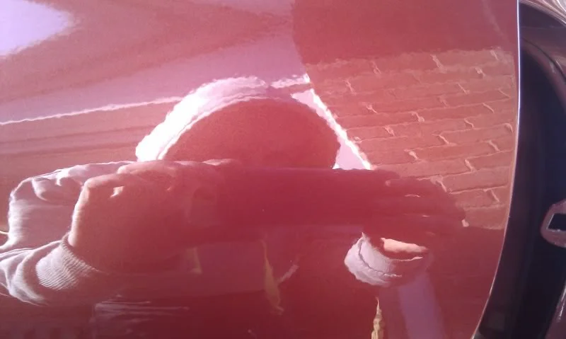

ok.. the scrtches.. this cae its the bootlid, 2 deep scraches through to basecoat, and 2 paint 'matte' scratches
polish the area first, witha cutting polish, i.e autoG super res, then wipe panel wipe, or alcohol wipe over the area to remove any films/grease

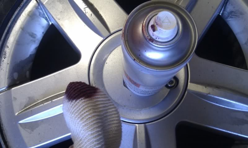

the paint.... and lint free cloth, soak the cloth so its driping wet....

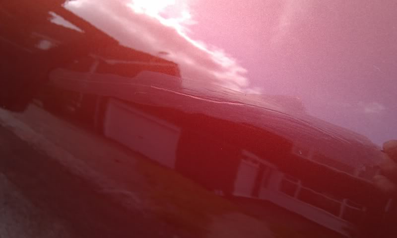

wipe the paint over the scratch.... leave plenty of excess paint but not too much ( deeper scratches allow to dry and re-apply paitn till the depth has been filled)

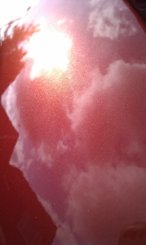

polish the dried paint, in this case the scratches were horizontal so the polishing and cutting has to be done vertical! again with a soft cutting compound
re-do the process as many times as you want, til the paintwork is belmish ree... seal with a wax or a anatural polish! zymol works great in this case!

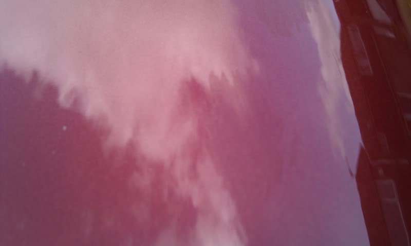

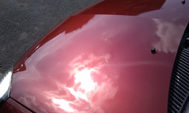

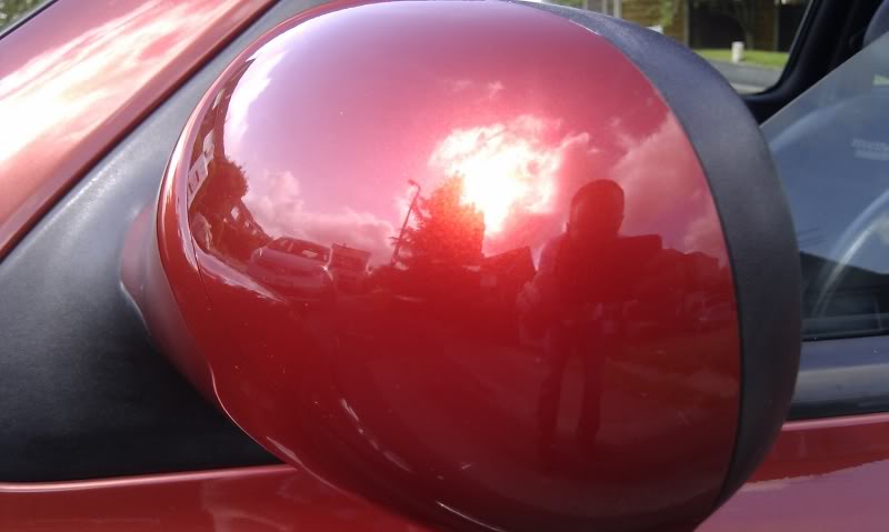

these are other parts of my car which i have done, and to be fair some scratches were deeper than the example iv done for you!
on this last picture ( bare metal key'd scratch) put masking tape around scratch, build paint up 10-15 times till depth is made, remove tape, cut/polish till smooth, and re-start the process without tape liek fistly descibed, it will not remove it completly... you will eb able to spot it, only cos you know where it is, but no one else wil!!!! :) real deep scratches liek this can be 99 % hiden but takes many stages to build the depth of paint back up
also forgot to mention, if you use the same cloth for polishing the paint off the cloth will turn to the colour of the paint. i.e my cloths end up very red, this is good as as your constantly polishing the colour back in

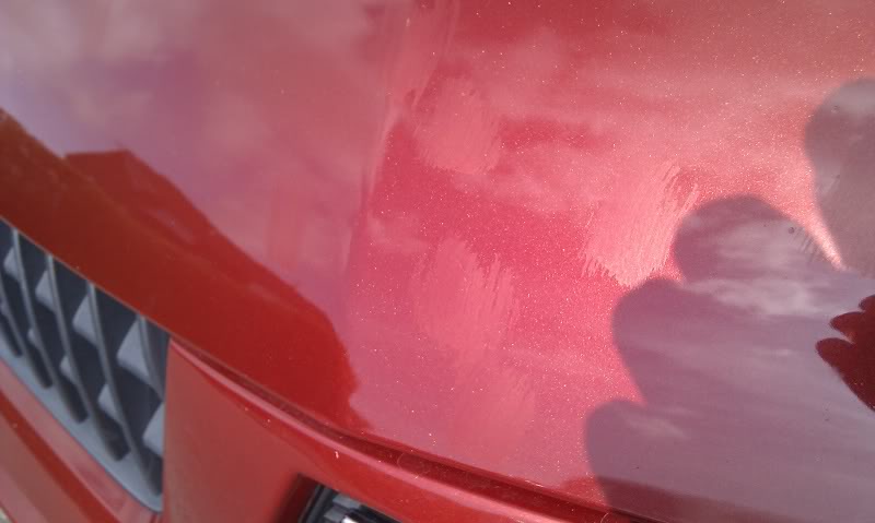

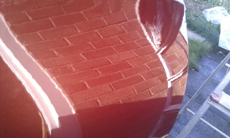

The pic of the lip of the bonnet (pic 2 in post#2)
Is that finished result, or just a building up stage?
just build up stage that pic fella... thats on stonechips just blobs dotted over them a few times to thicken i up ready for polishing
2 pics below this was finished item... but taken from oppsosite side of car to catch the sunlight to show how much its blended in, on my next car i wil do a full amount of pics taken froms tart to finish
