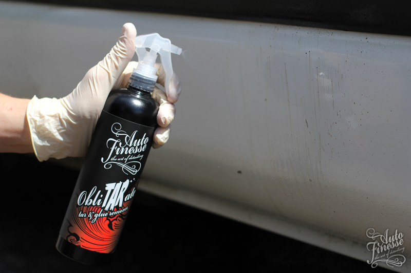

Application of ObliTARate:
As with any decontamination stage, ensure that your vehicle is fully washed down to remove any light surface contaminants before you start with ObliTARate.
Here we’re using ObliTARate with one of our clear mini triggers to apply ObliTARate to the surface, however you can also apply ObliTARate via a microfibre cloth. This method is perfect for when you need to perform spot decontamination in specific areas.

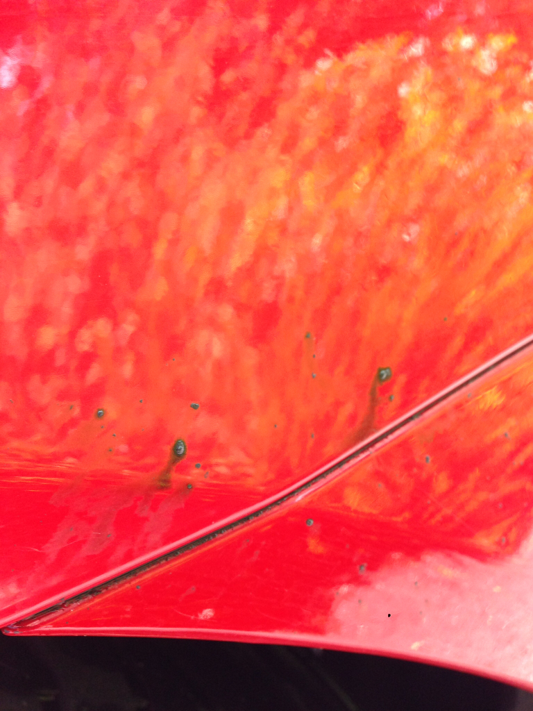

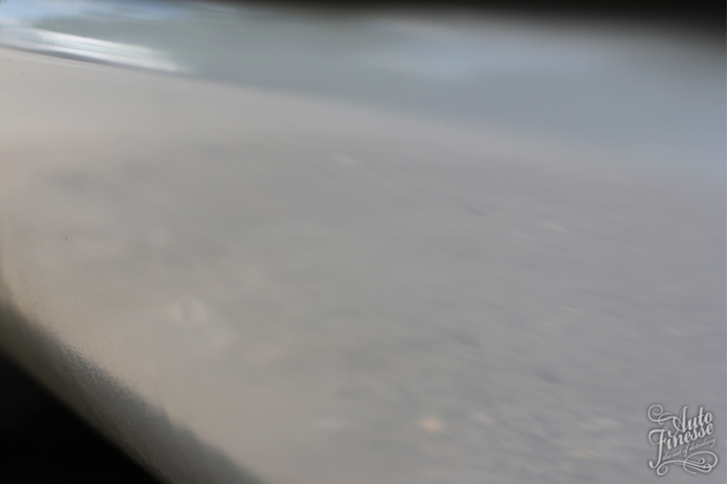

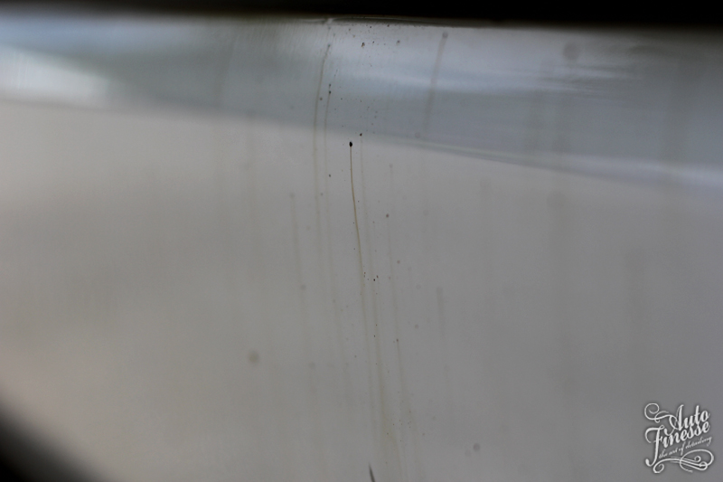

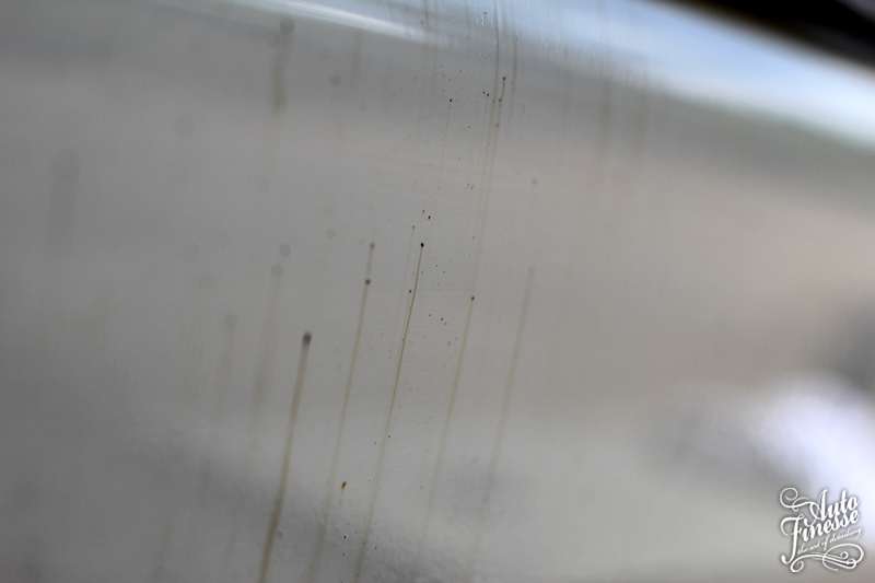

ObliTARate at work:
Immediately you will see ObliTARate start to brake down the bond between the road tar and your paintwork. As the excess product runs down the surface it safely carries away the detached residue from the tar spots. This bleeding process is what makes ObliTARate a visually great product to use.

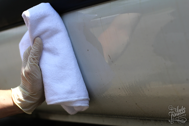

The wipe down:
Finally its time to remove the last bits of tar and rubber left on your paintwork with a microfibre cloth. Simply wipe across the surface in one motion to remove the last tar and rubber. Be sure to put this microfibre aside so you don’t use it later on in the detail, as once the tar has dried out it can add serious defects to your paint finish.

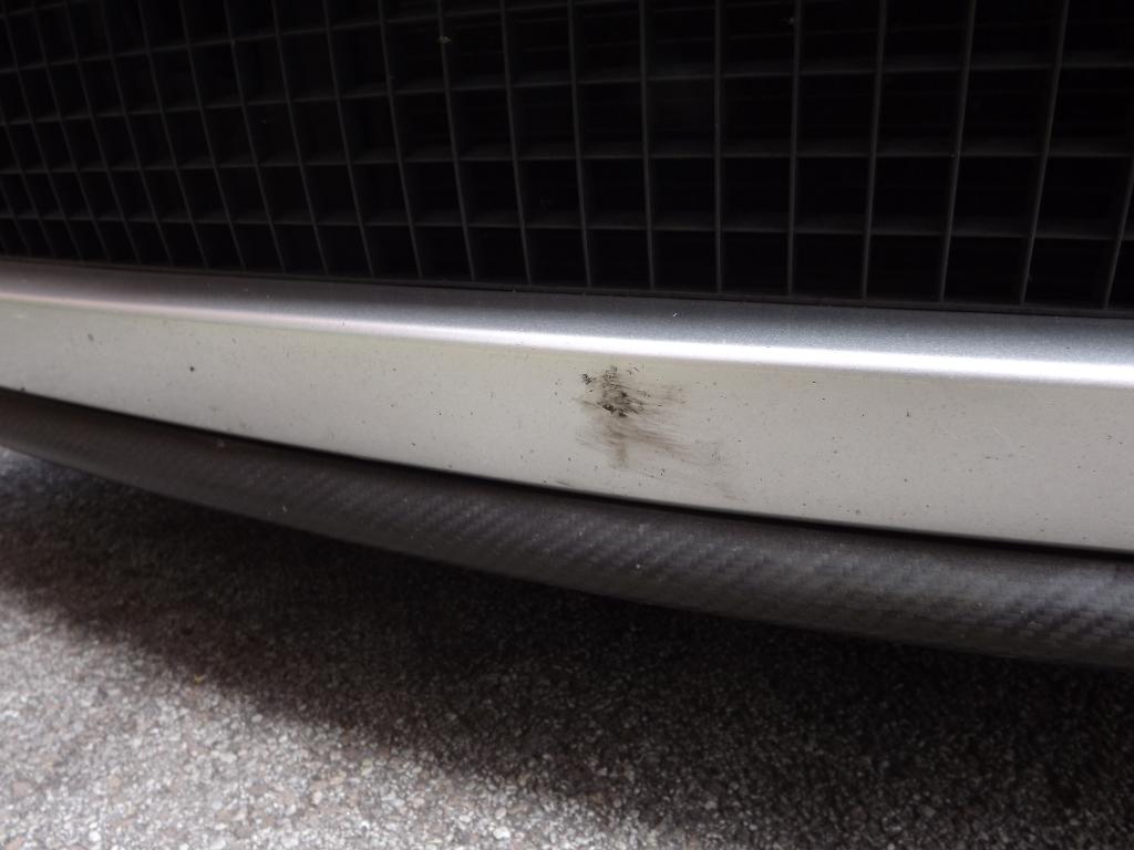

I have used ObliTARate to remove glue left behind when I Debadged a few cars and it's great! I also reversed into a bin and it left black plastic marks all down my paint that obliterate literally wiped straight off after it wouldn't come off with anything. I like it!

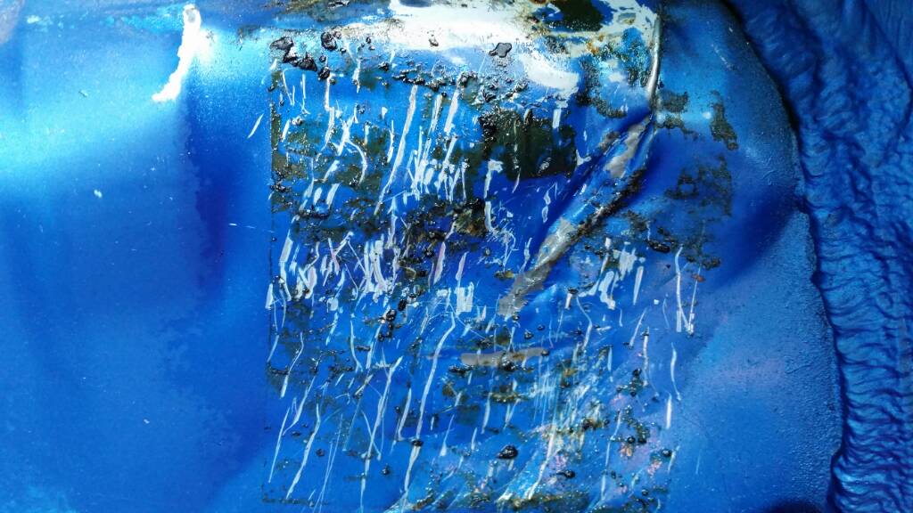

this stuff is great, the tar just melts and a simple wipe off to remove. unfortunately i crushed my bottle by accident.

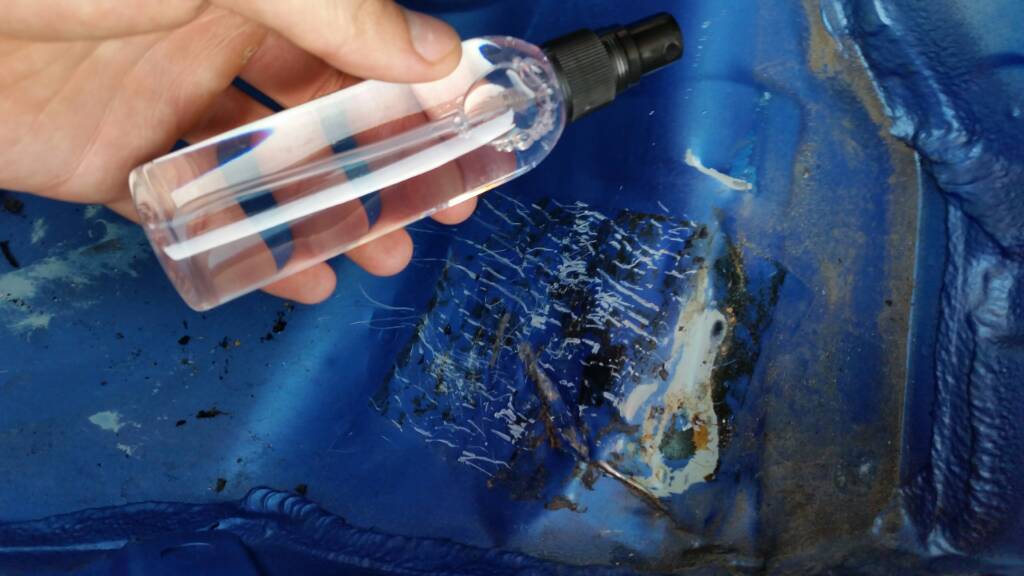

Well I used this today. And I can safely say this is the best I've used for tar/glue removal. Works really quickly and it doesn't leave residue after removal.
I had some left over tar in the boot on my damaged area so I tackled that, I gave it a spray over and left to soak for a minute or 2 then simply wiped it off, so the tar was so soft it just wiped straight off no problem!
Video of tar spot on wheel. It was quite a big/thick spot and I was really surprised it worked so quickly. No residue left on the wheel once it was wiped either!
http://youtu.be/1xWU7vo_u1U
And another video of a thick tar spot in the boot.
http://youtu.be/hTVhMis_2L4
Videos show it off alot better than photos so I figured they would be appreciated a little more.
10/10 for me really. I'll need to buy a full sized bottle at some point!

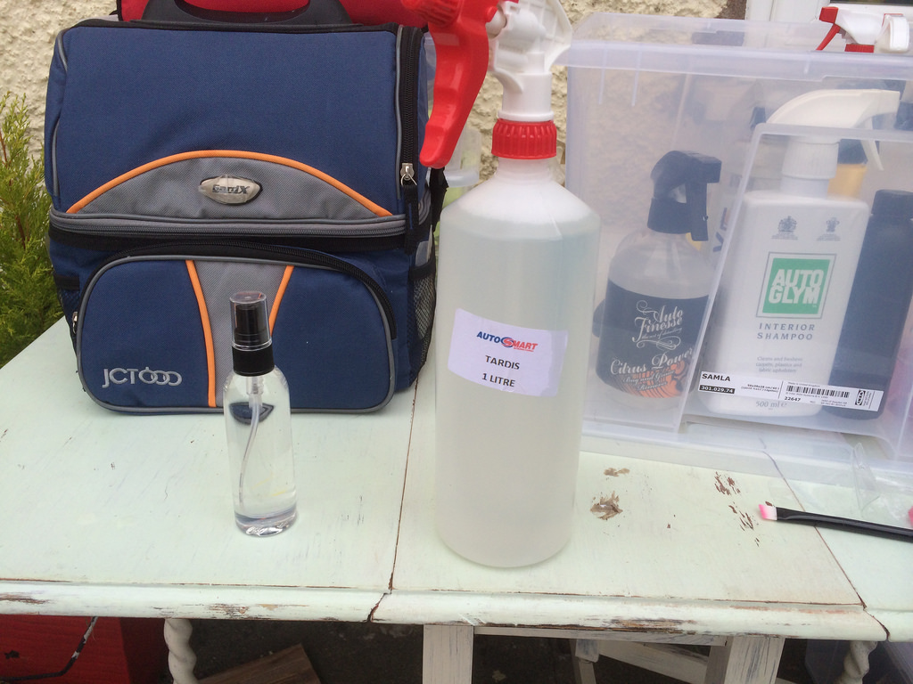

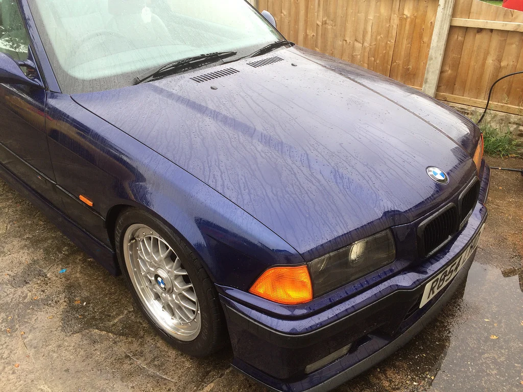

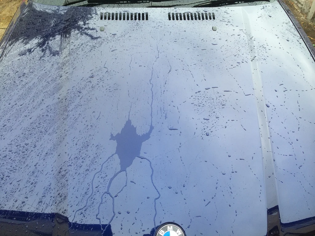

TARdis vs obliTARate

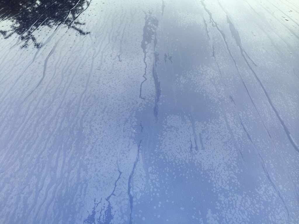

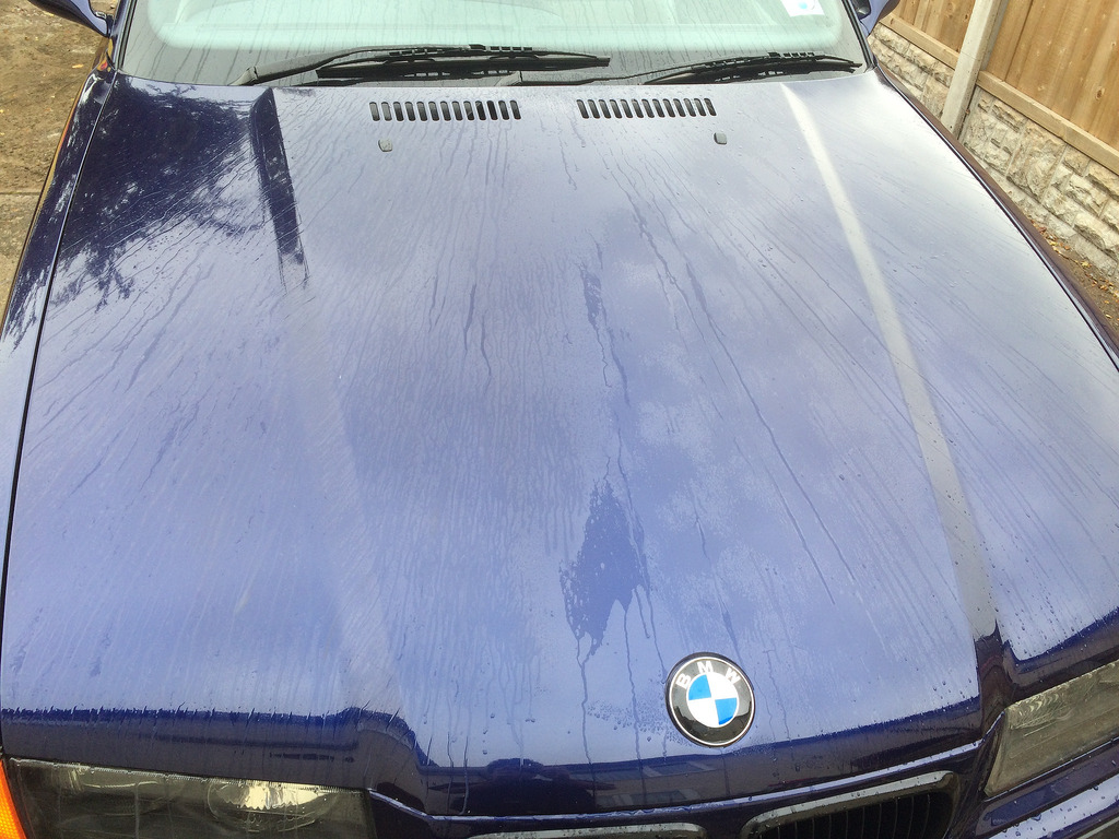

Not the best base to work with as the car was pretty clean but here's an application and dwelling review.
Tried and tested TARdis on the drivers side
ObliTARate on the passanger side
I'm not sure whether it was the different nozzle on the sample or what but obliTARate seemed to cling a lot more on initial application. It also smelled a lot more like turpentine than TARdis. Different base maybe?
It didn't want to run and cover the panel either
Rinsed off.
It seems TARdis did a better job at stripping the old protection as it ruined the finish whereas the oblitarated side seemed to bead and repel water better. Semi LSP safe tar remover?

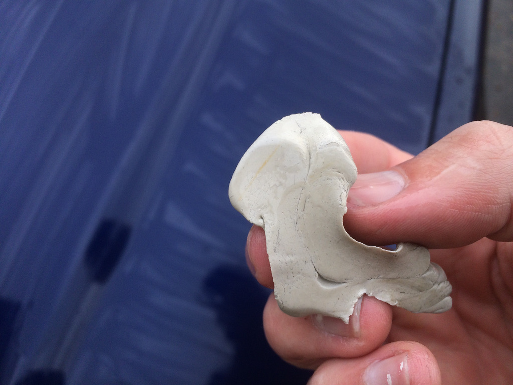

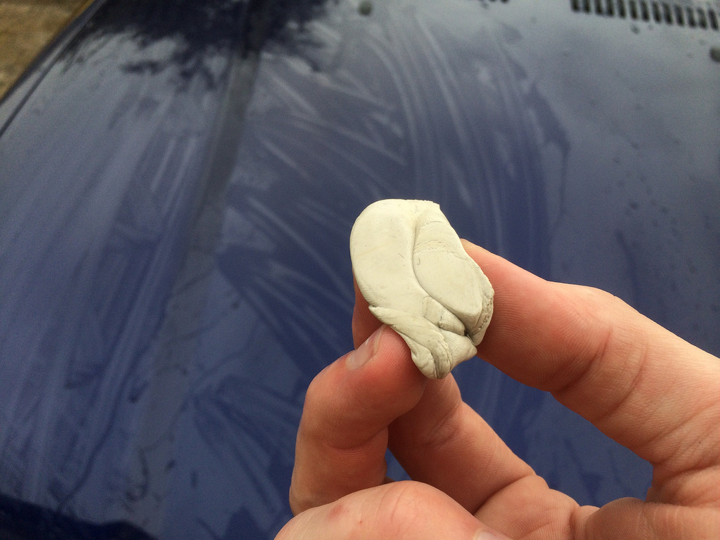

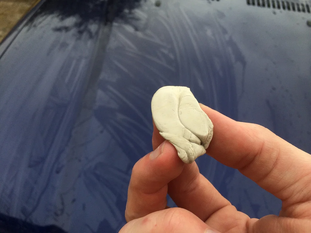

The car was then iron x'd and washed to remove any excess product to see if the clay picked up anything the tar removers missed.
Nothing from the tardis'd side.
One yellow streak from the oblitarated side.
I don't think this is conclusive though as the TARdis could've easily missed one particle.
My thoughts based on this are; obliTARate is less willing to run, requiring more sprays to cover the panel. It dwells as long as TARdis. It doesn't seem to remove LSP as well as TARdis.
I'll do another review when I get a chance to give my car a once over as I'm sure it'll be easier to catch the tar dissolving than on the above dark Beamer.
And a pre polish pic of the decontaminated front end.
cheers :)

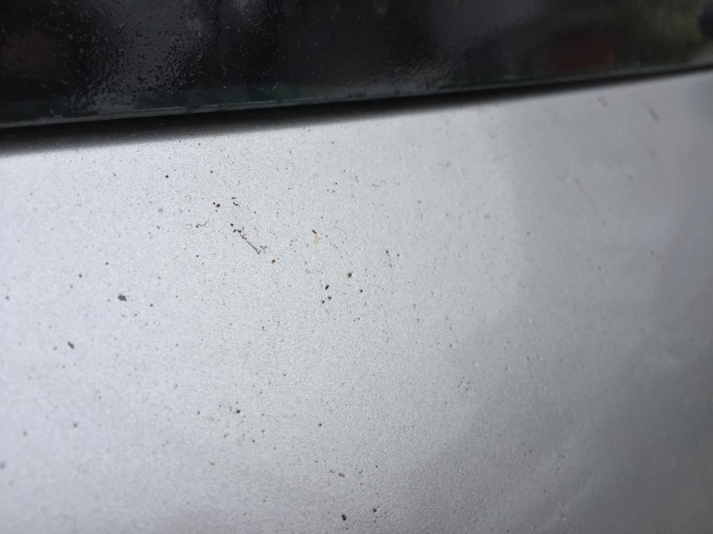

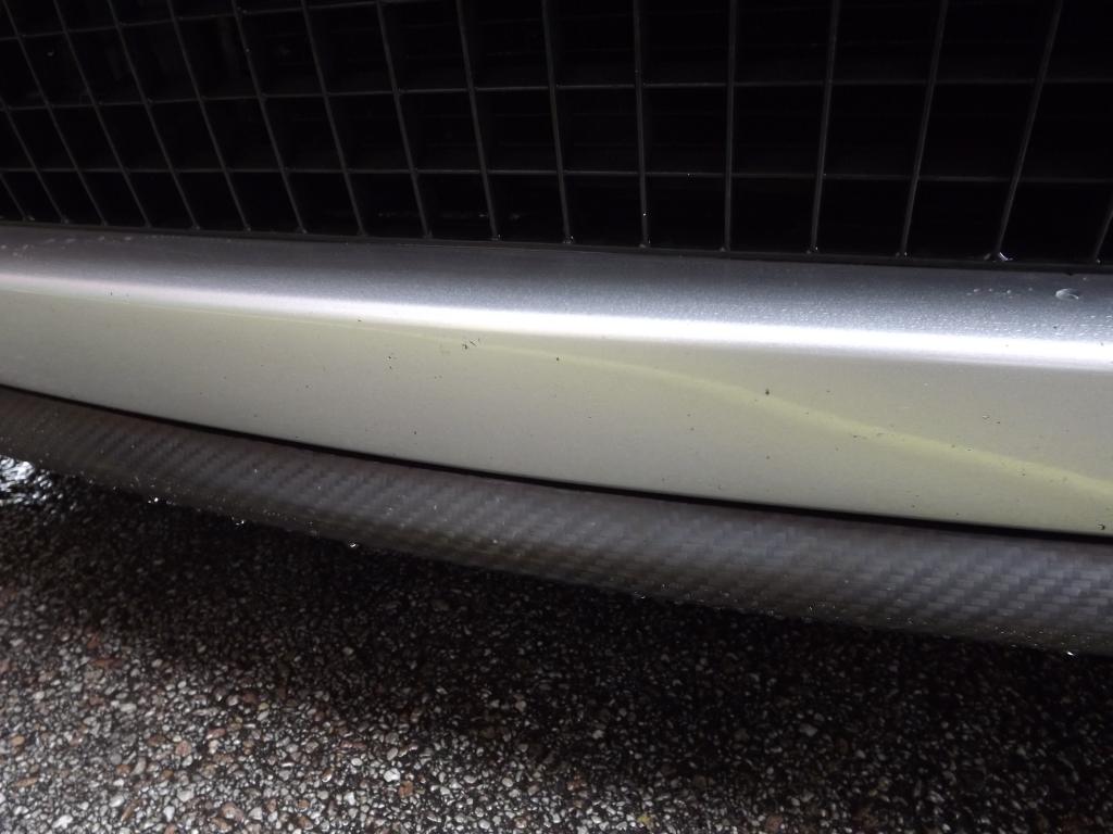

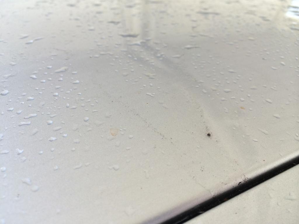

Hi guys, hope I'm not late on this one, I've just been busy recently! In all honesty I feel like a let down this time around. I have some before pictures here...
http://i18.photobucket.com/albums/b133/kzkz/182/ObliTARate/IMG_1637_zps11edf3c0.jpg
http://s18.photobucket.com/user/kzkz/media/182/ObliTARate/IMG_1634_zps7298189c.jpg
http://s18.photobucket.com/user/kzkz/media/182/ObliTARate/IMG_1631_zps9bf5680a.jpg
http://s18.photobucket.com/user/kzkz/media/182/ObliTARate/IMG_1635_zps6bbf924d.jpg
http://s18.photobucket.com/user/kzkz/media/182/ObliTARate/IMG_1633_zps840bf6b6.jpg
After that, I tried to capture some pictures of ObliTARate in action, but tbh this is all I could get...
All I can say is that I have a big old drive coming up this weekend so after that, and before my next wash, I'll give it another good soaking as I have around 50% of the bottle left and hopefully I can come up with some better pictures and a more detailed review! Sorry again, and I'm sure you know by my reviews in other threads I usually come up with better results than this lol.

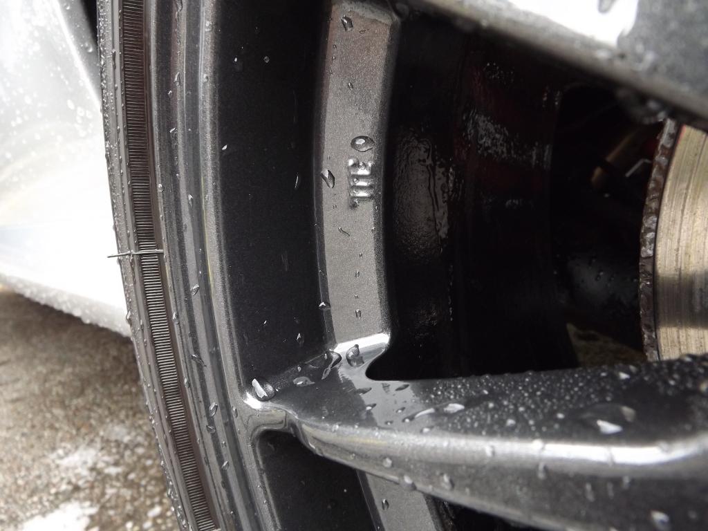

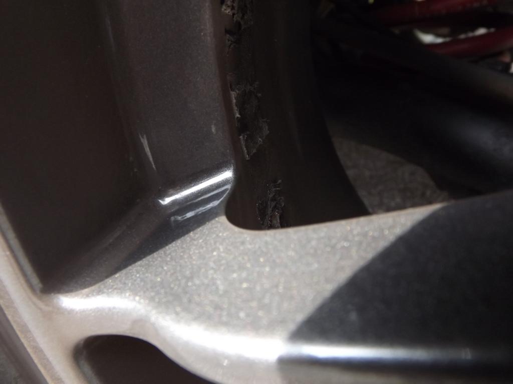

Had some old wheel weight sticky pads left behind from re balancing so Oblitarate was an ideal candidate for this.
washed the wheels thoroughly first
Sprayed oblitarate genorously onto the offending area and left to dwell on a wet wheel for 10mins
used a deep pile damp microfibre and a little bit of pressure and the sticky pads came away very easy (impressive)

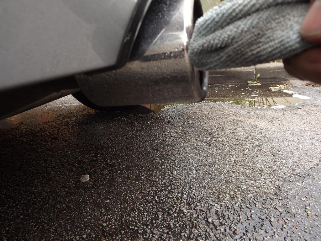

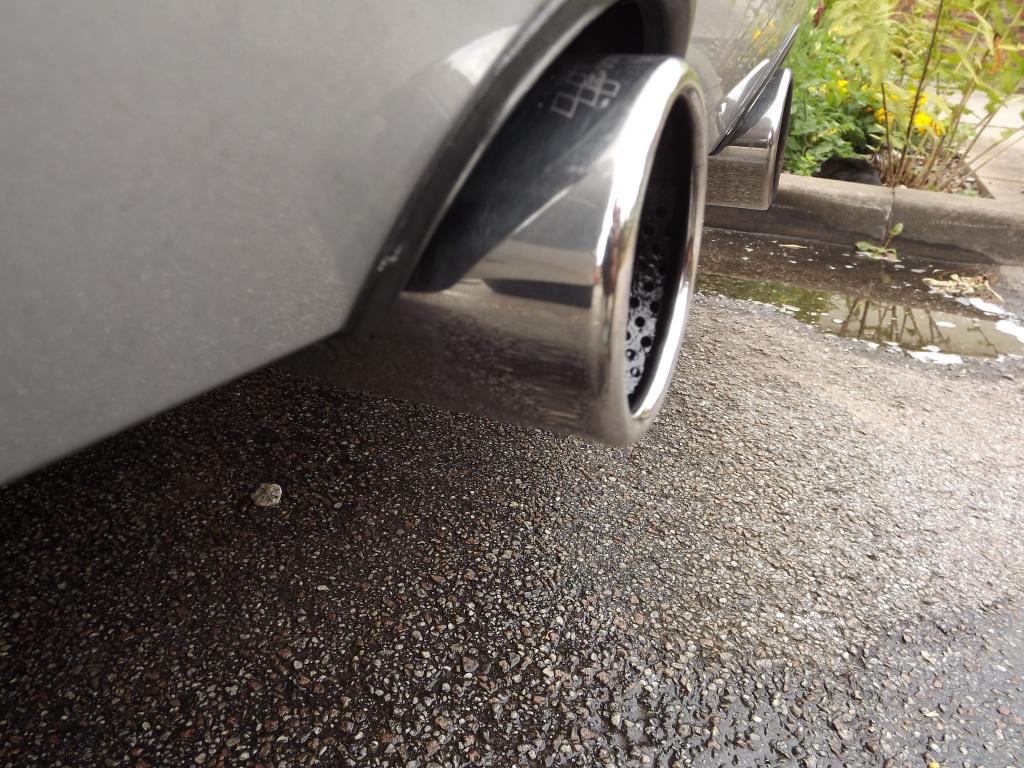

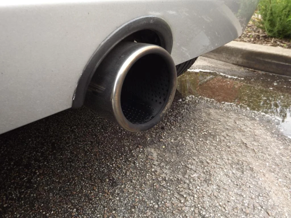

Second test
Had a tar spot on the exhaust so put 2 pumps onto a damp microfibre and rubbed it of very easily.
Also had the stubborn black sticky stuff on the exhaust tip which i sprayed some obliterate on left a few mins then wiped off good as new.
Smuged bit of tar on bumper one pump on damp cloth again and agitate slightly then wipe away.
Oblitarate is a must have product and works really well. thanks again Auto finesse ;)

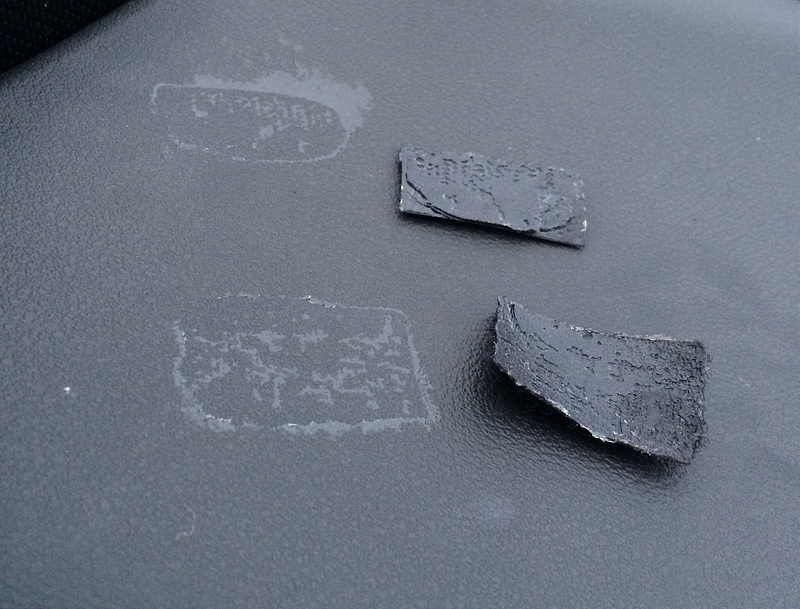

Not sure what happened there but anyway..

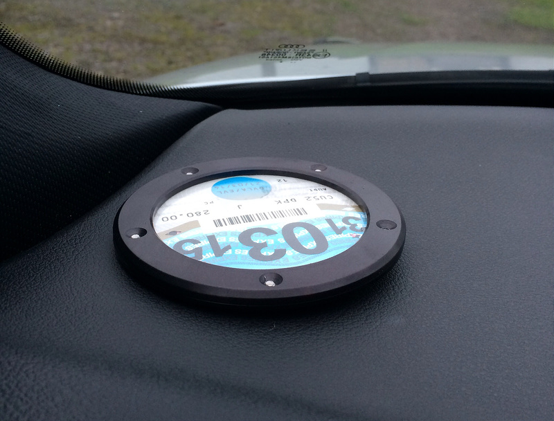

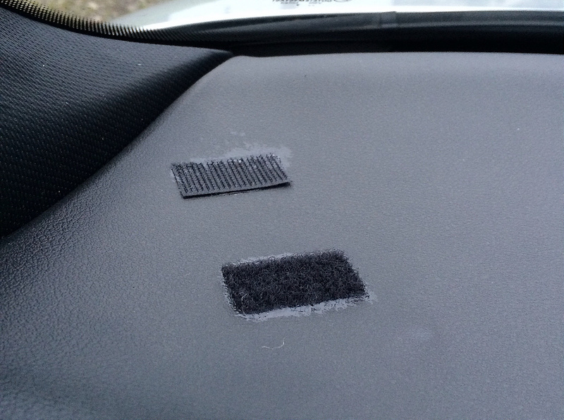

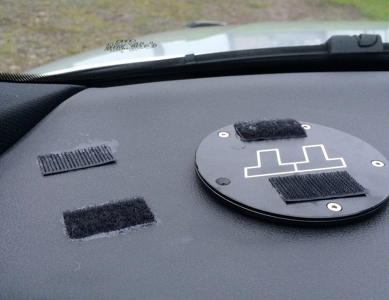

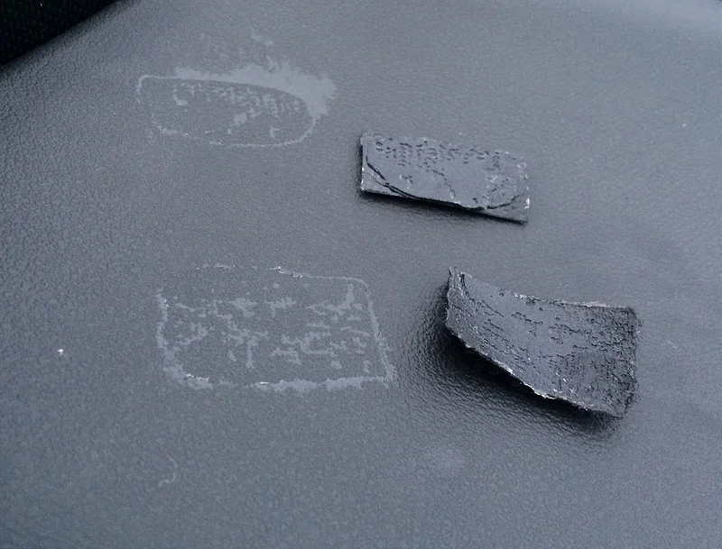

In-fitting with the new DVLA legislation I thought I would base this months review on the removal of my tax disc.
For some reason, the previous owner decided to bond the tax disc holder to the dashboard using sticky Velcro pads. Knowing these would leave a lovely sticky residue I set ObliTARate to work.
The tax disc holder is question..
AutoFinesse ObliTARate Review
by Lawro1988, on Flickr
Removing the holder from Velcro displayed this..
After picking at the Velcro for a while I finally managed to remove it leaving this sticky mess..

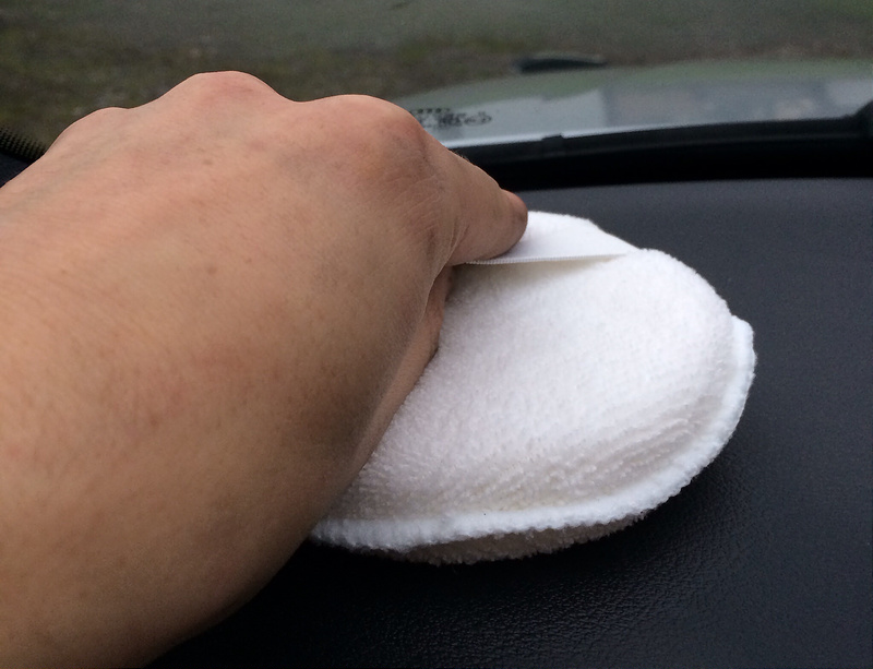

Out came the ObliTARate at this stage.
Rather than spraying it directly to the dash, I decided to spray the chemical onto a AF soft cotton applicator and applied it to the area in question.

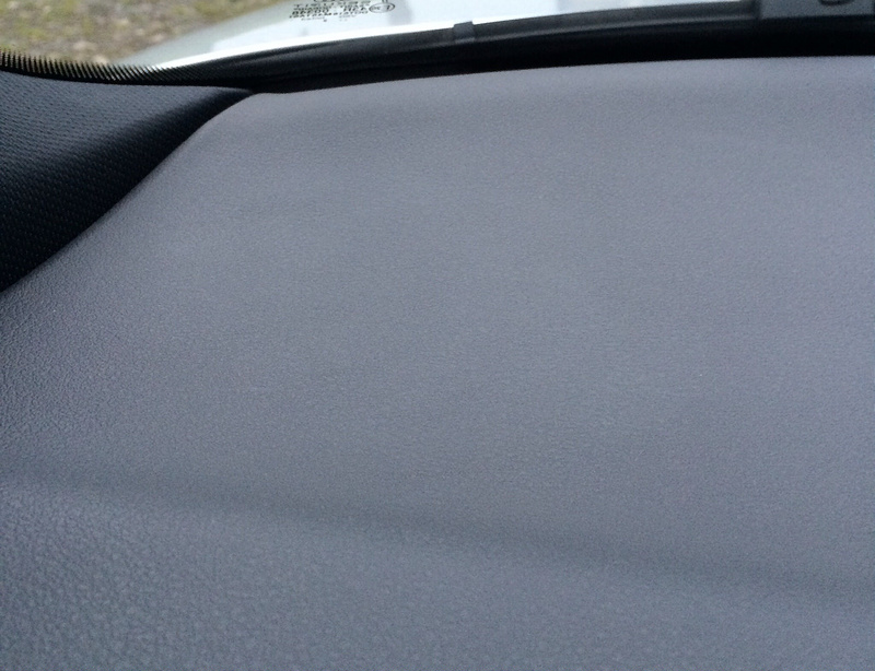

After letting it work it's magic for a few minutes, I wiped the area over with a clean MF cloth.
Finally, I gave the dash a quick wipe over with AF Spritz which left me with this..
All residue removed leaving a perfect finish.
Overall, ObliTARate is an excellent product! Very easy use and works quickly & effectively leaving a perfect finish every time, which is why it's my preferred tar and glue remover on the market.

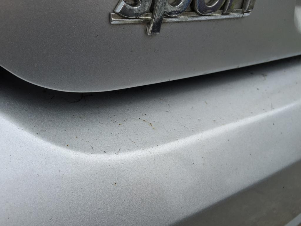

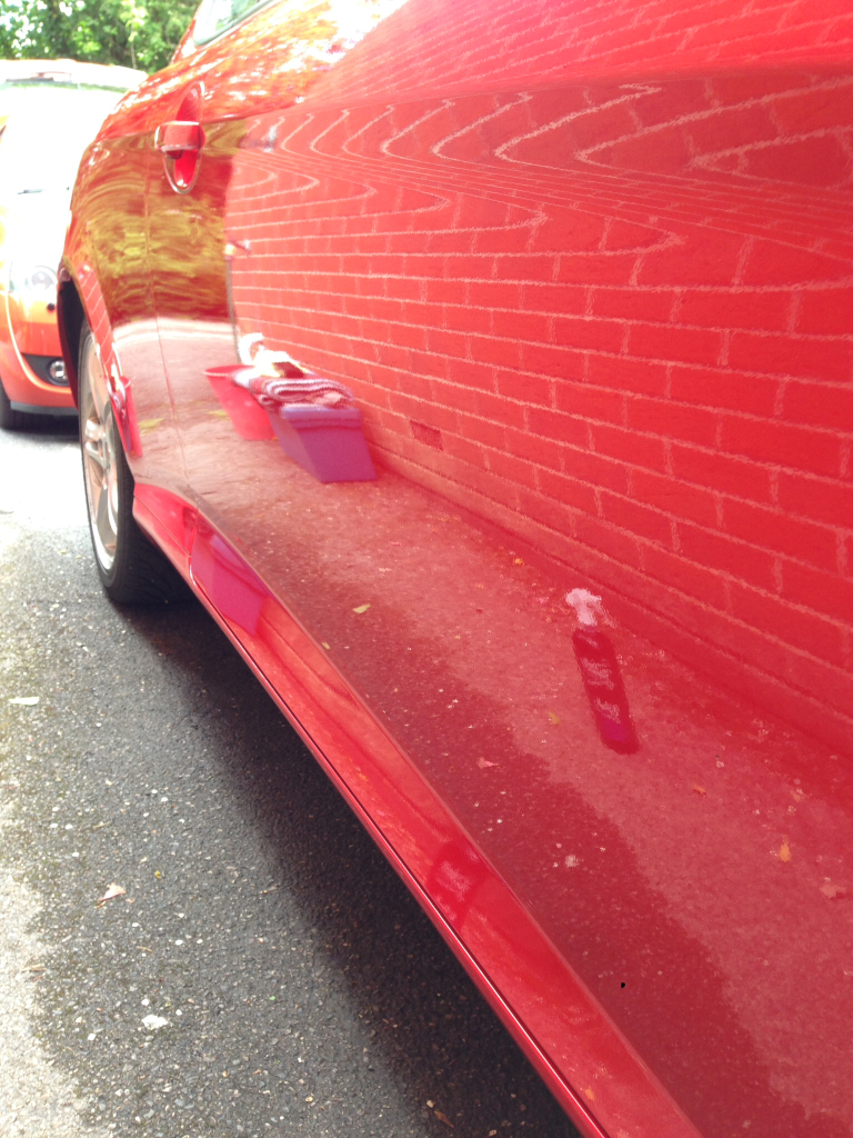

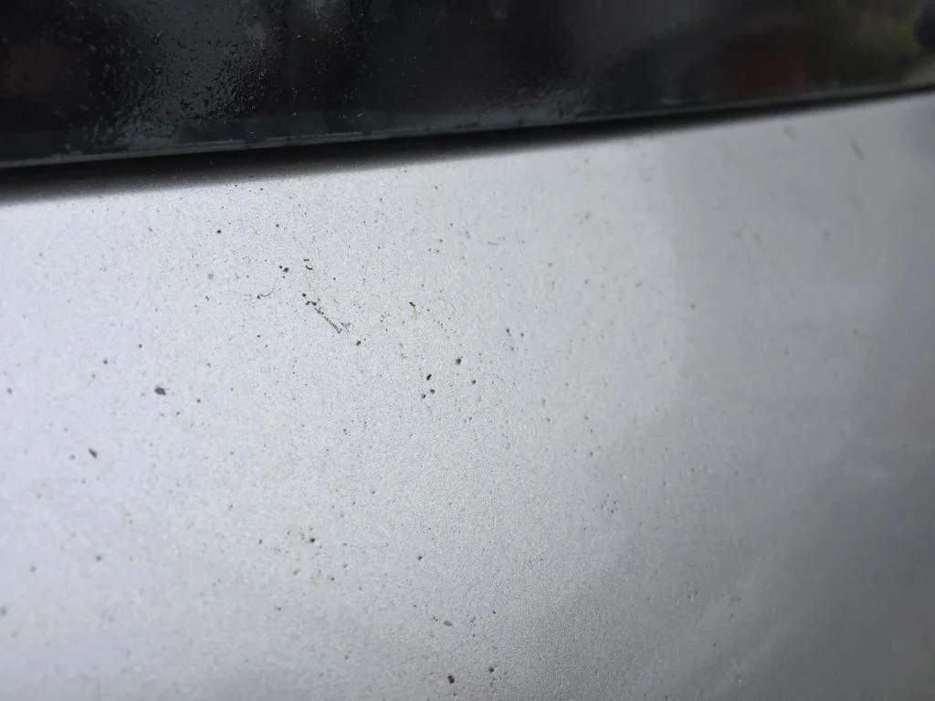

Right so carrying on from my earlier post, I tried to have another whack at this seeing as though it was the final day to get our reviews in. I've got to say, this product just hasn't worked that well for me... I hope you don't mind me being honest! I think though, it's probably due to my lack of miles I'm putting on the car, I just don't have anything that tough that really requires the kind of power behind ObliTARate. I still have 1/3 of the bottle left so will keep it for another time when I (hopefully) will get a chance to get it put to the test more throughly.
Anyway, here's a few more images I managed to get of it working away on the limited dirt I aquired since last time lol...

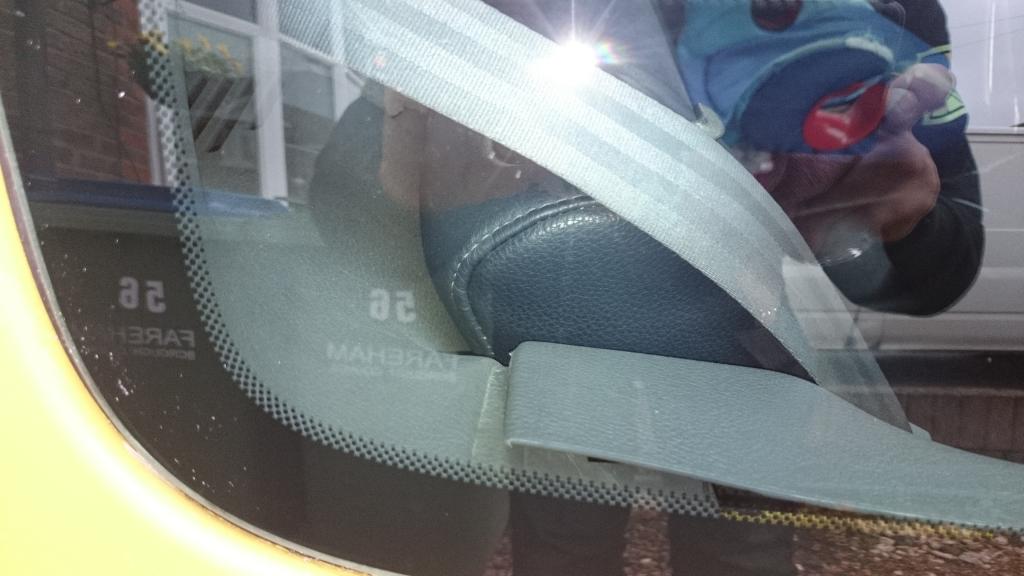

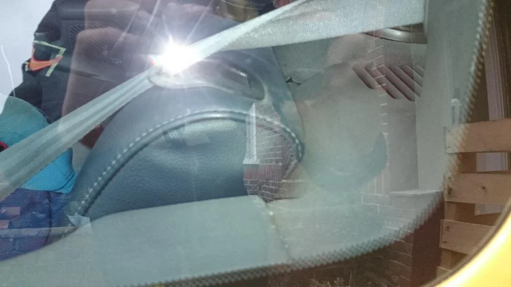

Firstly thank yo for another product to test and secondly appologises for the late submission @Auto Finesse
Bit of a short reviewfrustratinly i only decontaminated the car a few weeks prior to this arriving, even after a drive to Snowdon and back there was no visable tar on the paint availble to test,

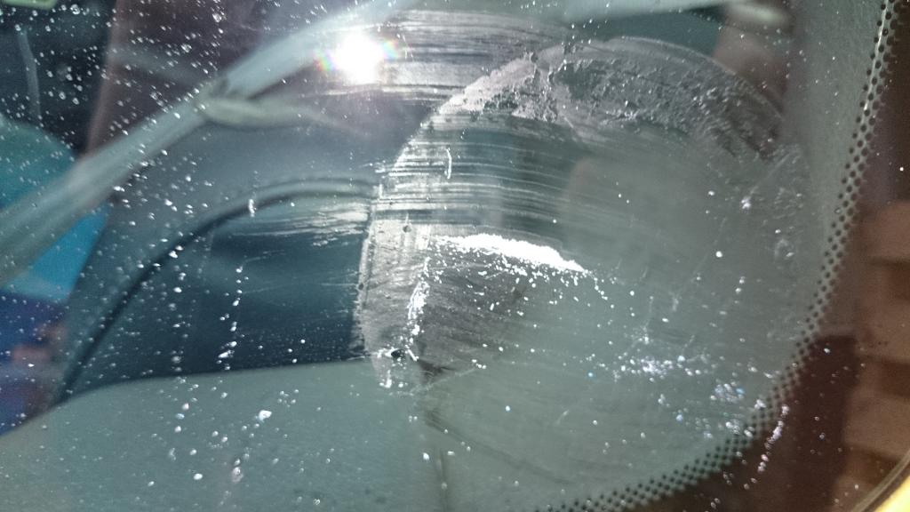

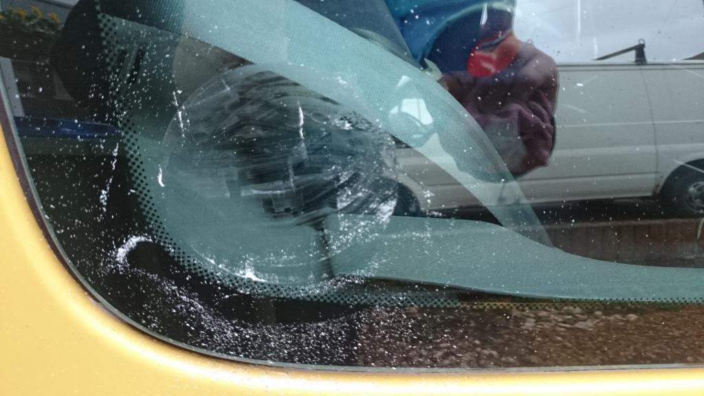

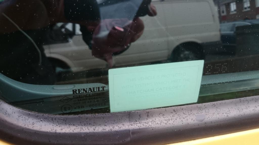

so another of obliTARate's party trick is a sticky stuff remover, ive had a couple of stickers on the car that i had been putting off removing, despite the great season Valentino Rossi is having its time to take off the tributes to him as are past their best, likewise i still had the original alarm/immobilsor sticker on the drivers window that too was past its best,
we went from this,

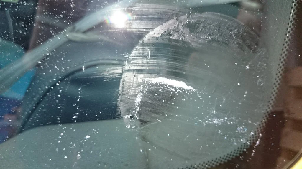

to this with the help of a small blade, as you can see leaving alot of residue behind.
a quick squirt onto a microfibre and literally 2 wipes and crystal clear again.
Drivers window
