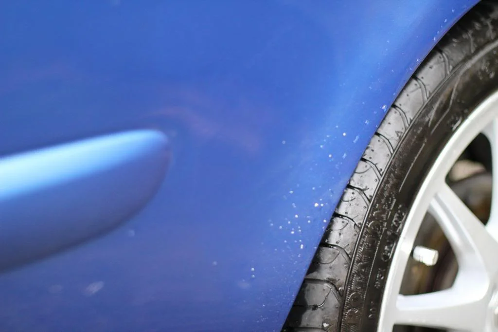

Hi guys, got myself a Cup recently and on both sides at the back arches there are lots, and I mean lots, of stone chips. Anyone got an idea on the best way to sort them out? got a feeling this is beyond T-cut and elbow grease :/
sorry the image is a little over exposed.
Go onto detailingworld and find the stone chip repair guide! ;) saves allot of money if your willing to put some effort into do this
Buy a tin of Solvent paint from a local paint store.
Use an MF app or cloth wipe the paint over the area, nice and thin build up the layers using a hair dryer or heat gun between coats.
Shouldn't need more than 2 or 3. Polish the paint back. Et voila perfection. I did it on the Frp. Looked night and day believe me.
You'll find a better description on DW.
