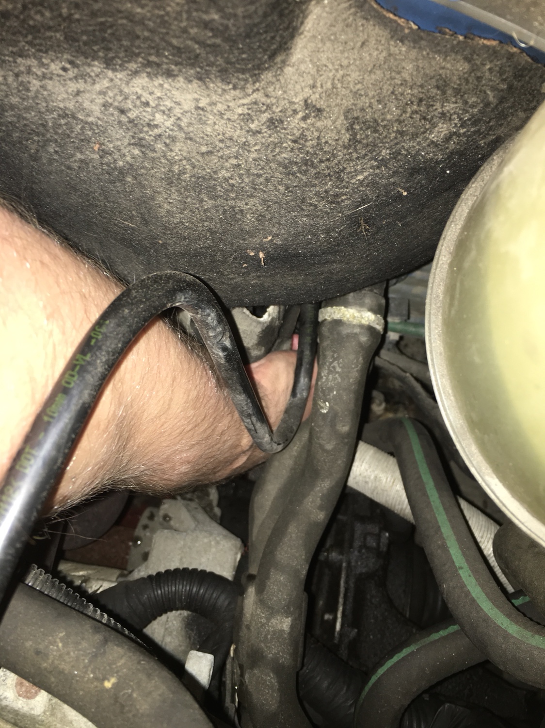

Hi,
My middle scuttle drain is blocked and flooding the drivers carpet and below the drivers seat. Water is not draining from the middle scuttle drain ( the hole below wipers is clear) so I assume the outlet for this is blocked. For the life of me I cannot find it...
Can anyone describe where it is?

There is a black snorkle drain next to the brake bottle (to right look at it)...however this is about an inch high inside, there is another drain hole to the left that outlets into wing.

Found it. It’s at the bottom of the insulation. See photo below.
