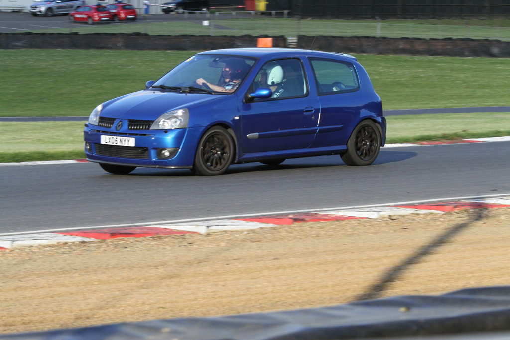

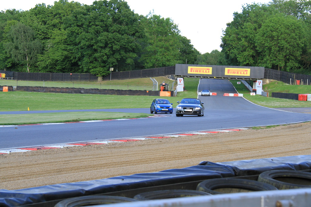

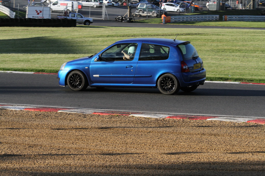

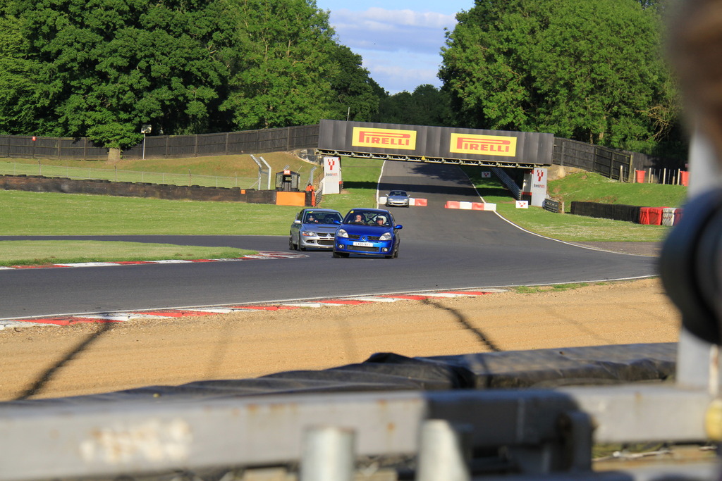

Here's some snaps of me tearing shi* up on track (I wish).
Look at the concentration on my face and the subtle hint of pain because of the Elise about to abuse me
Me pretending to know what iIm doing. Didn't realise he had his grubby arm on my car. Bit of crack on show for ya aswell :tongueout:

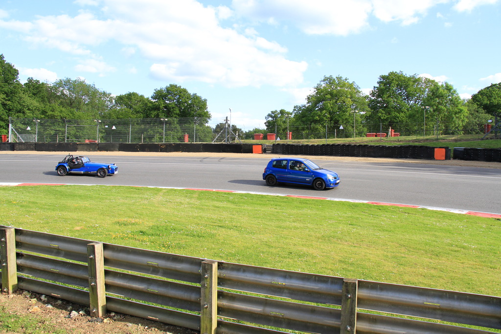

What was the clio like against the R3 on track? The Rx8?
On the straights the rx8 had the legs slightly, not by much but in the corners I was quicker. Not sure if that was down to the car or the fact that i had an instructor in the car and his lines were a bit off!
Held its own! Twas only a novice day so hard to tell if the difference was driver or car!

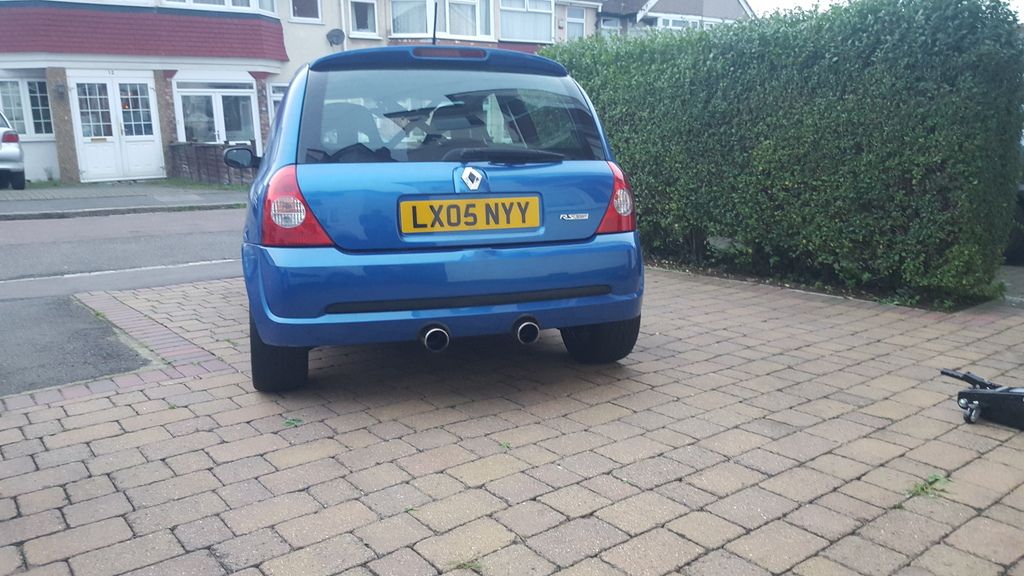

Here's an award winning photo showing her booty

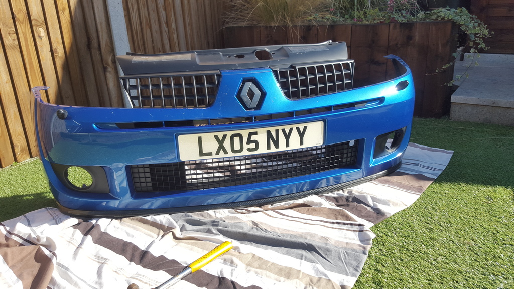

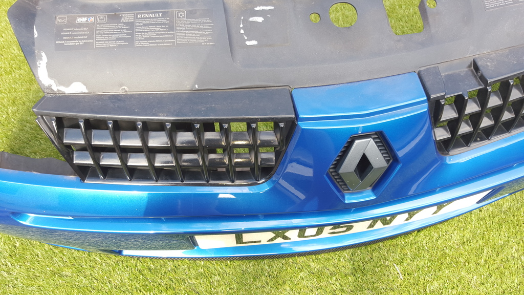

Resprayed grill after not liking the gloss black that was done previously. Went for Matt black, in hindsight Satin would have looked better
Before
After

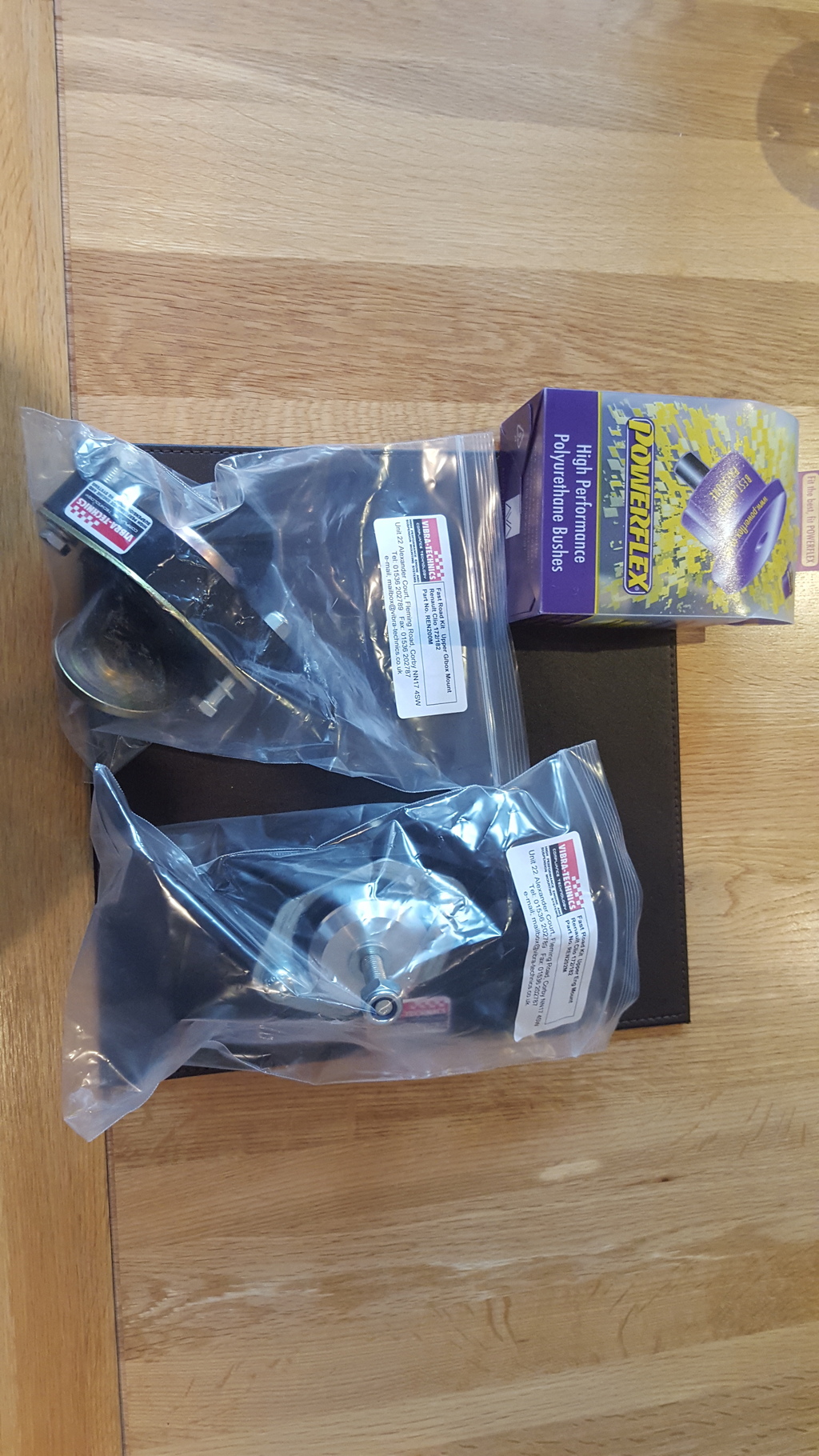

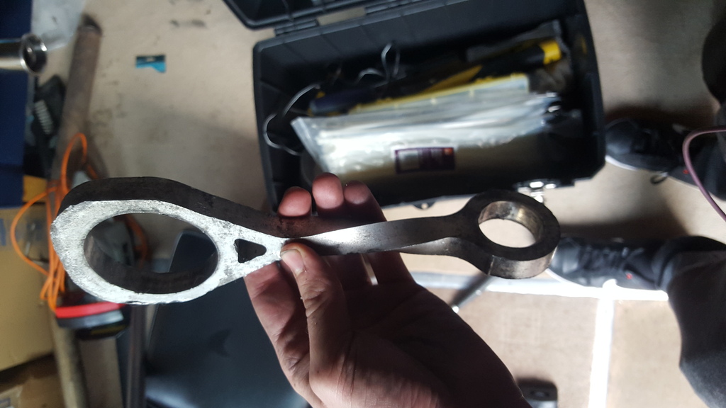

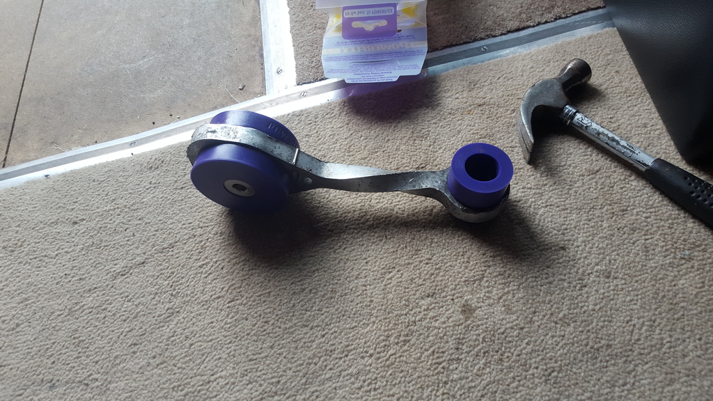

Bought some mounts, have only got round to fitting the dogbone, that was an absolute ball ache
Finally.........

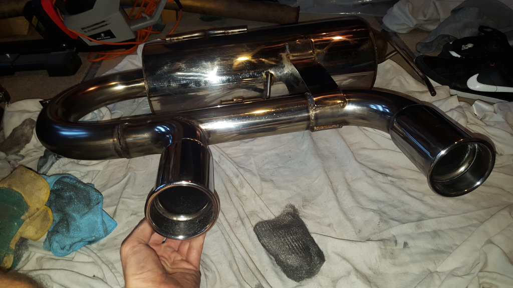

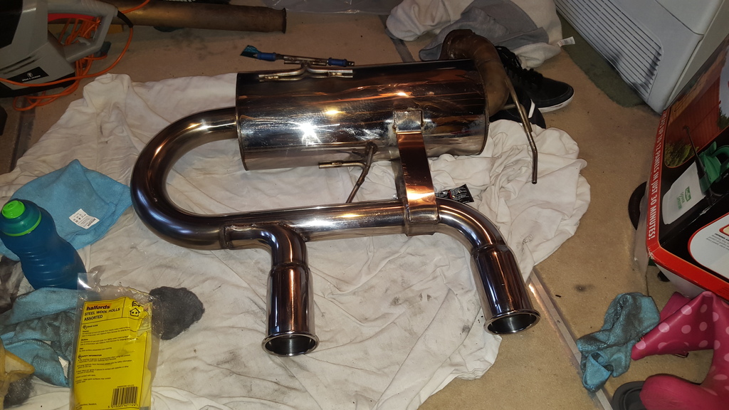

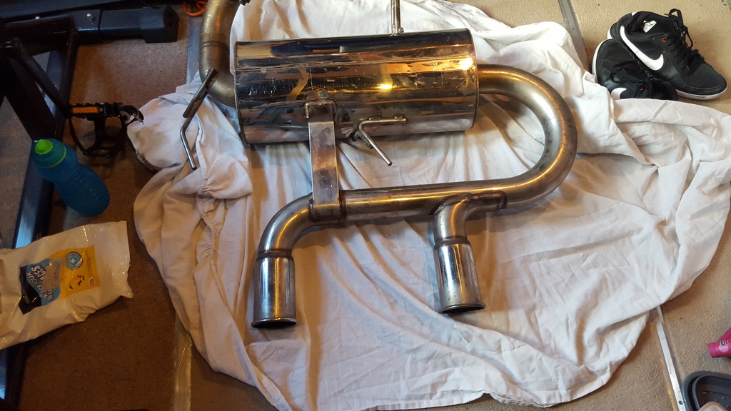

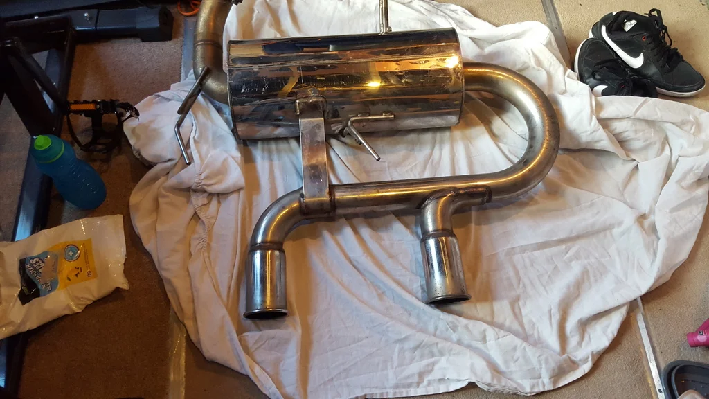

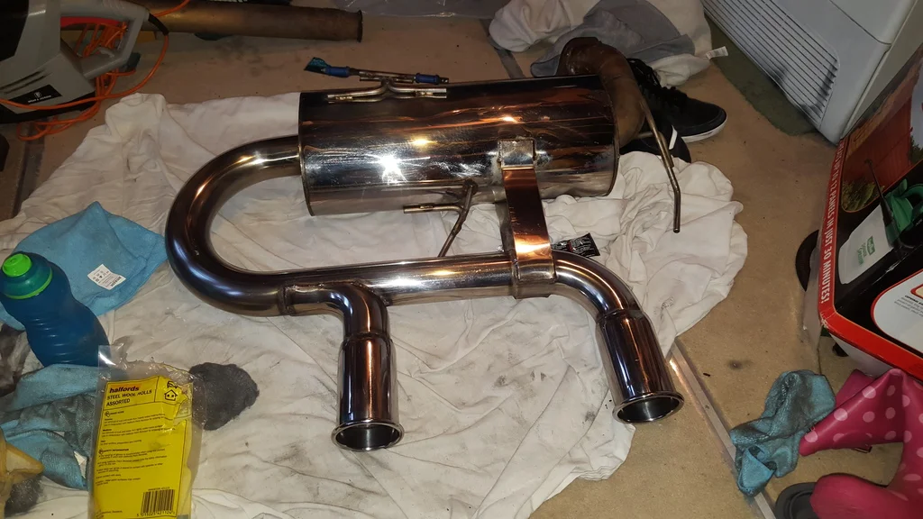

Thought 'sod it' and bought a Yozza that was going on here, gave her a polish up
Before
After
Tried to fit the other day but couldn't remove the old one as the the muffler and down pipe seem to be fused together and no amount of bench pressing could part them

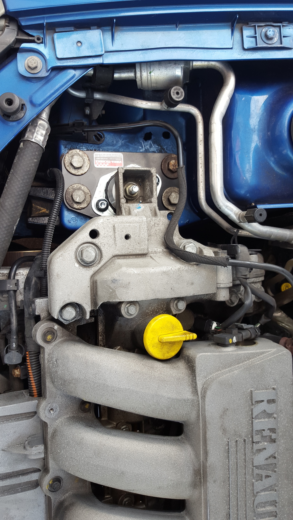

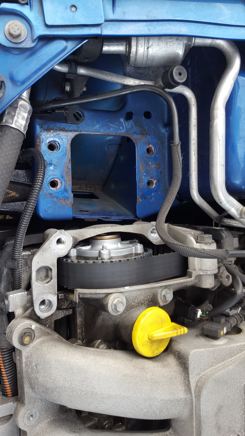

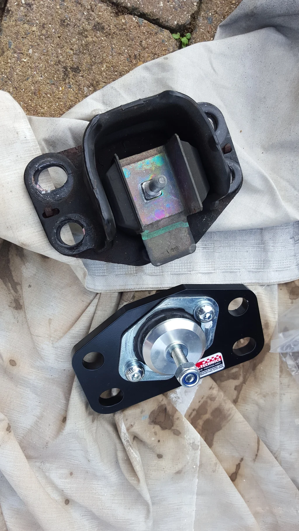

To continue slowly but surely upgrading the engine mounts around the car I fitted a Vibratechnics upper mount. I didn't notice any extra vibration in the cabin once fitted, throttle feels a little more responsive but i think it may be placebo!
Old mount off
Comparison
New mount on

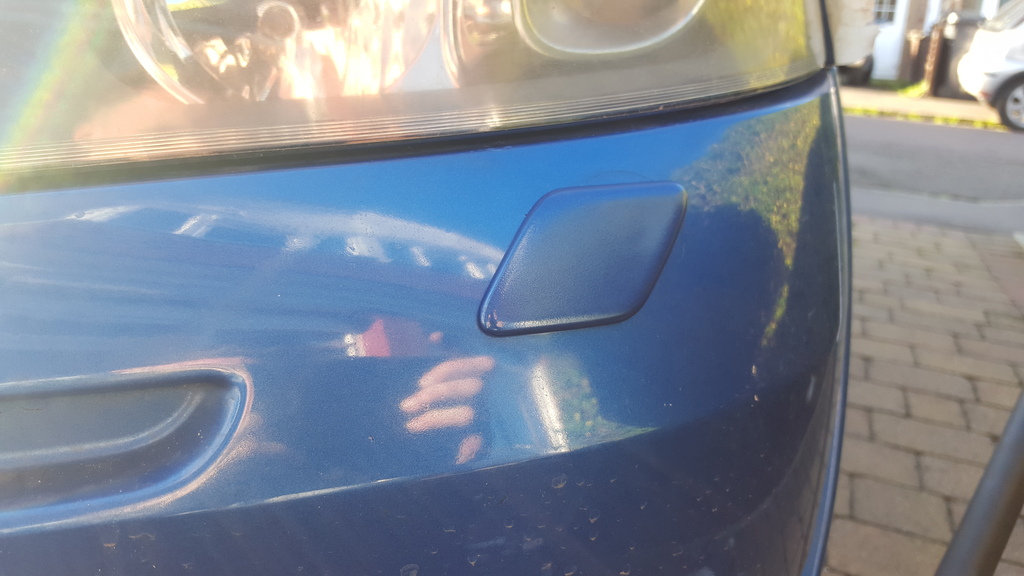

Also fitted some washer blanks I bought off here,sprayed them myself. As you can see I'm shi** at spray painting. Am not happy with how they look so may get them professionally sprayed. Any detailers who think a polish may help?? I'm a bit OCD so i cannot settle for meritocracy!

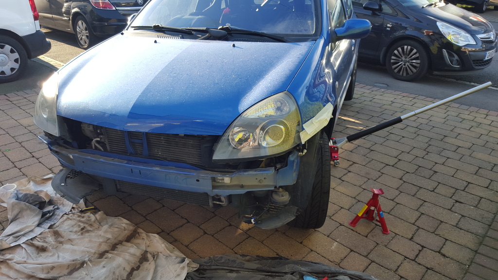

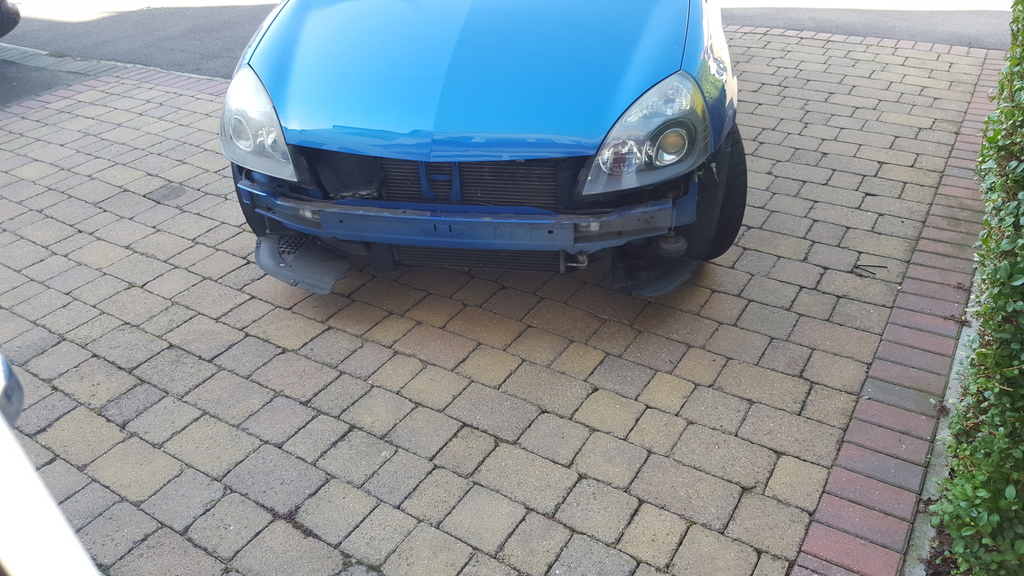

Bumper off,protect those wings people! Had a chance to use new Costco jack, decent bit of kit,actually felt like it could support the car, unlike the previos Screwfix one

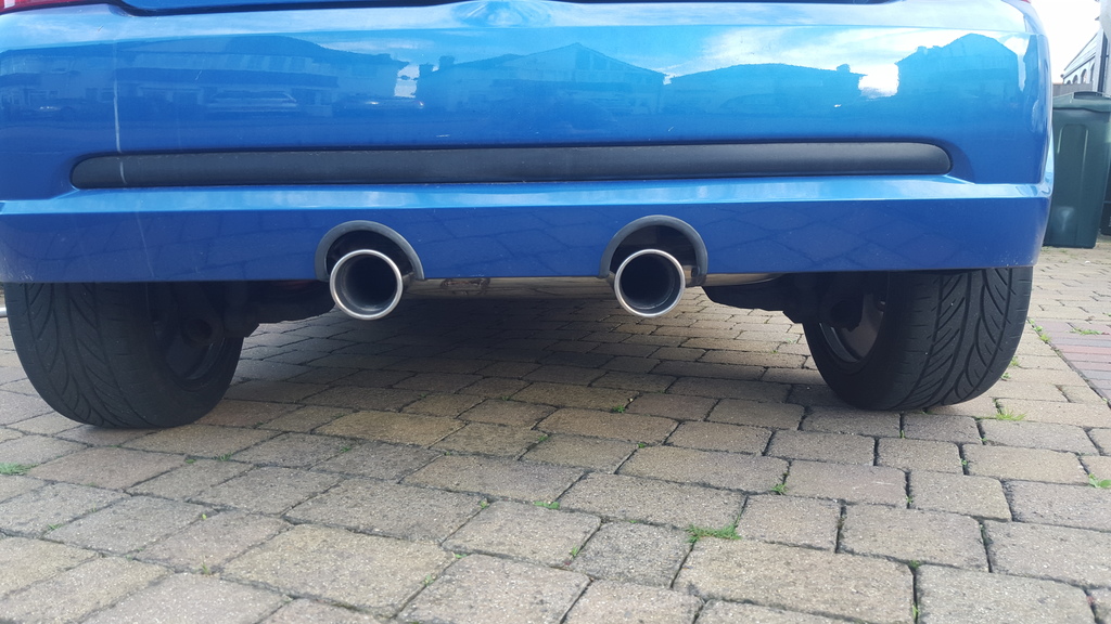

Fitted the Yozza as well, looks a bit pisse*

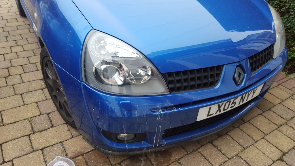

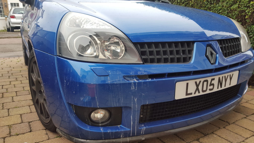

Managed to find 45 minutes where it werent pissing down and started polishing up the headlights.
Used grade 400>800>1500 followed by a coarse polish and then a fine polish using my DA. Came up pretty well but still some slight scratches so needs a few more goes over. Only managed one headlight as it started pissing down again!
Amazing what a slight refresh can do to tidy up the front end. Excuse the vomit down the front

Car looks great. I'd try your polisher on the washer blanks - even if it doesn't work I'm sure you could get them done professionally for pennies. How did you go about changing the engine mount out of interest? Support weight of engine under sump with trolley jack, old mount off, new mount on, release jack?
  Arctic 182
Looking at maybe replacing mine.
Jack and a piece of wood under the engine to support it. Remove and replace but don't tighten it completely until the jack has been removed.
What he said. My engine had sagged a bit so i couldnt get the new mount on without jacking the engine up a bit.
Piece of wood (larger surface area) between sump and jack, remove old mount, pit new one one. Dont tighten completely, remove jack, start engine and let it idle for few minutes. Tighten bolts. (Recommended on another thread to allow engine to find natural position.)

Do they replace the dogbone? As I only fitted my one about a month ago and it may break my heart to swap it out already
  dan's cast offs.
as dan said, it's everything from the box back so gets rid of the silly sloppy bushes and replaces with bearings. you can pretty much feel the ball click in to the detent on the selector shaft when you change gear!!

Is there seriously no extra vibrations??
  Clio 172 Cup
I'd also be interested to know how it affects daily driving vibrations wise. I've got a cup, and i'm hesitant to upgrade as im not sure how shaky it will get when on the road.
As for the PMS. I love mine. @bloke is correct, its so precise with the feel of the gear changes.
  Arctic 182
Mines not too bad atall mate. You notice it more on idle so if you're sitting around in traffic quite a bit then it might not be for you.
I only do about 2000 miles a year now so im probably not the best person to take advice from!
incy-spider
Ah cool, I only asked as I fitted a power flex insert on the top mount and it vibrates more on idle and slightly more cabin noise while driving... Sort of a compromise to get a nicer feel but worth it I think
