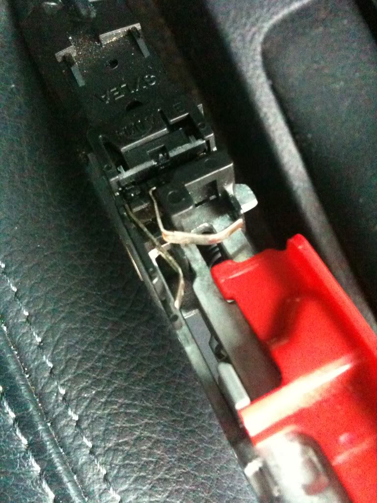

Open up the seatbelt socket thingy, just 1 or 2 torx screws iirc. Inside there is a pair of thin metal contacts, bend one away from the other and it will never beep/light up again.
When you put your seatbelt in it breaks these to stop the beep/light, so your just fooling it into thinking the belt is always in :)
You can see the contact bent back here:
cheers mate, will give that a go later
