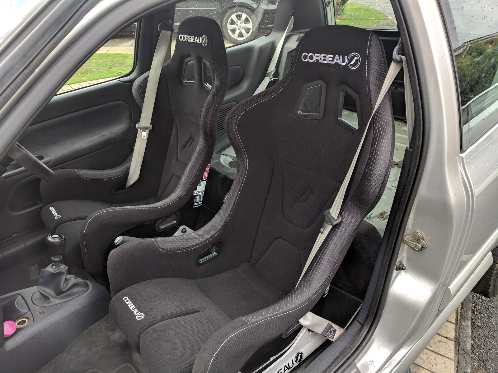

I use standard belts with mine and they feel safe enough, the belt still locks on the inertia wheel part of the belt.
Not been tested in a crash yet though :ROFLMAO:
Used Peugeot rear seatbelt buckles for the belts to clip into. All bolted down using high tensile gear.

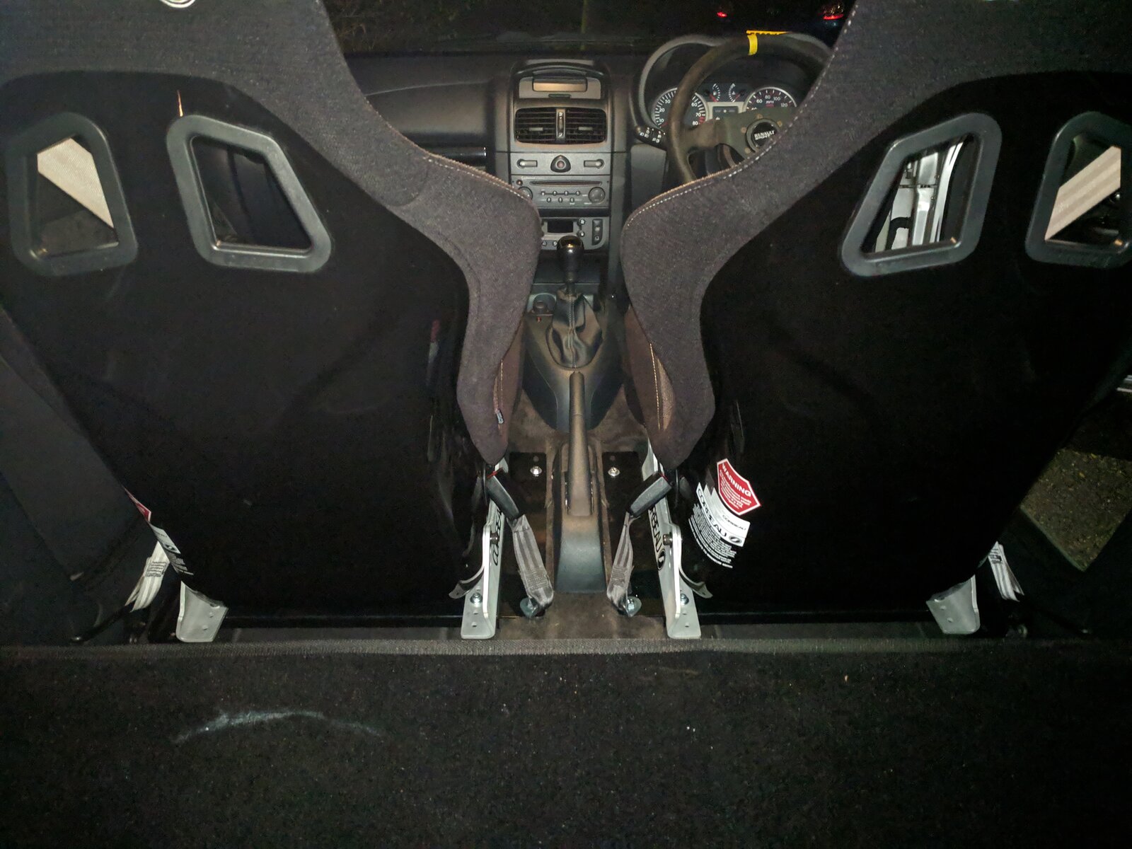

I have Recaro Pole Position ABEs to go in mine which are specifically designed to sit a 3 point inertia reel belt. I'll be making a fixing bracket to fit the pretensioners to so they slide with the seat runners.
