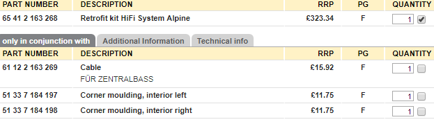

@Sir_Dave
Had a browse around, this is an option that can be fitted to your E92 as I believe you have the business system as standard.
@Daz_RT_04 i've been looking at that as it happens, bit pricey now though mind, feel free to pm me nice prices though :kissingheart:

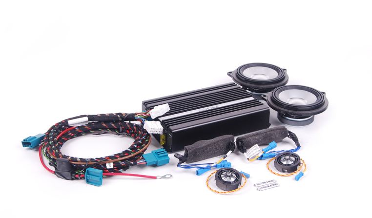

This is what the part numbers add up to (Picture doesn't show the speaker covers for the tweeters).
@Daz_RT_04 How much lol? Im either buying the Alpine retrofit, or Gladen/Audio System/MB Quart speakers plus suitable system soon.

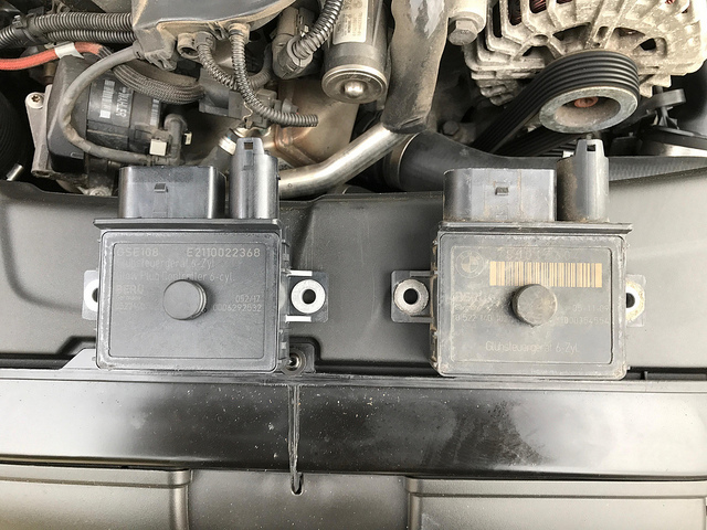

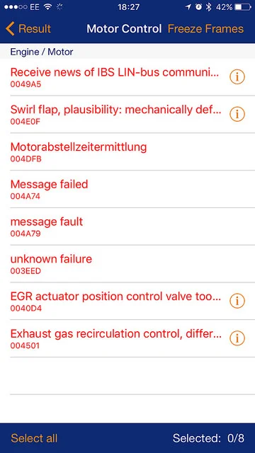

Also encountered my first issue, which i would imagine is exactly why the previous owner got rid of it, a rather rough idle on cold start, almost like a misfire on a petrol engine, a bit of a panic moment if you didnt have any form of diagnostics id imagine ... Not noticeable when i first drove the car as it was during the day i guess, or they'd made sure it was started & idled for a minute before i got there. Off i went to Amazon to purchase CarlyforBMW, partly so i could code in a few things (digital speedo for one) that would allow me to read the codes without having to drag my laptop out of the cupboard. In reality, i dont think its as good as INPA for fault funding, but it gets the job done:
Untitled
by Sir_Dave, on Flickr
With a cold start "misfire" an "IBS-LIN bus" error can usually be attributed to a fault Glow Plug Controller on the N57 engine, meaning that the glow plugs arent doing their thing, creating "a poor burn of derv" or whatever the f*ck these tractors do to create powerz. So i checked my warranty, reminded myself that for issues like this, it was utterly pointless & ordered one of ebay (Beru GSE108). A quick google showed that i didnt need to remove the inlet manifold (as per the M57): http://www.e90post.com/forums/showthread.php?t=1419504 so the part turned up a couple of days later & i fitted it over the weekend
Untitled
In effect, you need tiny hands (which i have), but very strong fingers (which i dont have), so i had to break one of the tabs on the loom plug to get it off the socket on the controller. Its still held on with one tab however, so all is good. Problem is solved, no errors & no idle problems :up:

What's the swirl flap & EGR error? Has it had them blanked?
No idea currently, EGR is still on there. Apparently its less prone to gunking up on the later cars, but i still need to work out whats what.

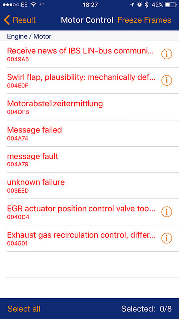

Is running fine, DPF is able to regen, temps are fine etc etc, but its also giving me the following:
  • Egr actuator position control valve too far open / negative deviation
  • Exhaust gas recirculation rate control, deviation exhaust gas recirculation rate control error while Kat heating
  • Swirl flap, plausibility: mechanically defective
I'll have a look at the EGR/clean it at some point, the swirl flap error will be manifold related, but i think the N57 is all in one piece if you want to fix it. De-flap is an option, but from my understanding, they cant fall into the engine/break off like the older ones anyway.

Sounds like either they are both faulty or blanked. My EGR reads similar due to being blanked on the Mondeo and has a constant EML light on.
I reckon faulty, the car is 100% standard elsewhere, so cant imagine that its been buggered about with EGR wise.
No EML lights, just background fault codes.

Ge the flaps whipped out. Takes about an hour and costs about £40 for the parts. i6Automotive do a kit. Being the 330d, its probably the 33mm ones you need.
Just leave the actuator plugged in so the bar still does it's job and you don't get any codes.
Get rid of the EGR and thermostat (if it as one). Useless sacks of s**t they are. Have it mapped out when you get it mapped, which you will want to do!!! 300bhp and about 500lb/ft
