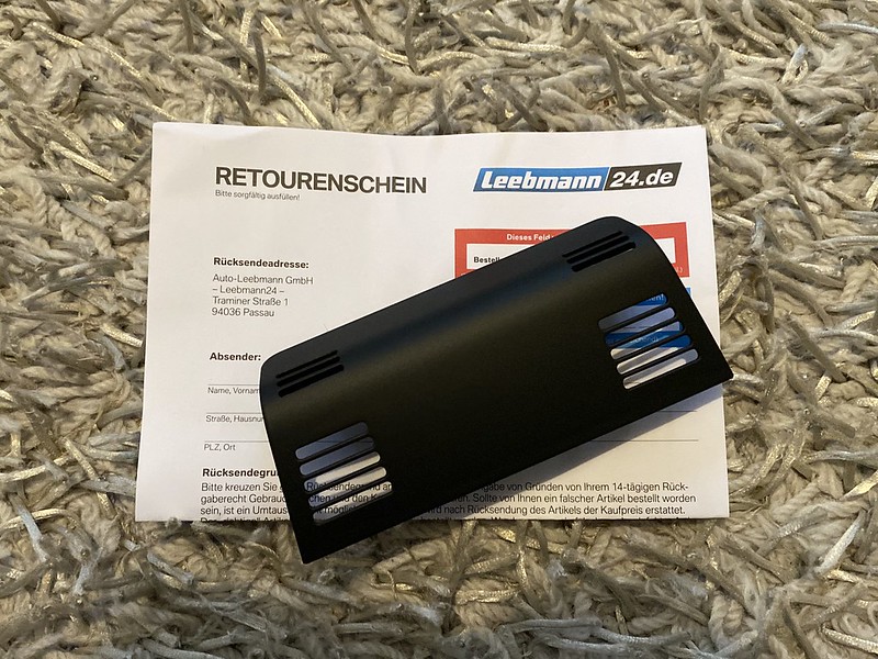

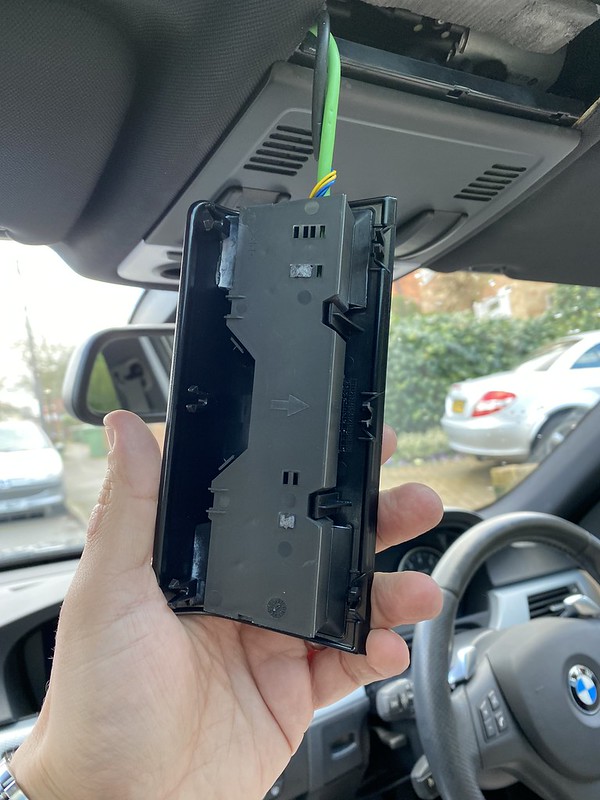

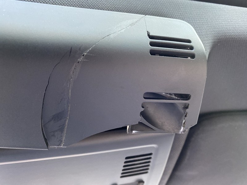

After the ABS sensor, here we have some excellent bodging ...
Most impressive given this car has only ever been worked on by those lovely people at Cooper BMW as it was under warranty 🤣

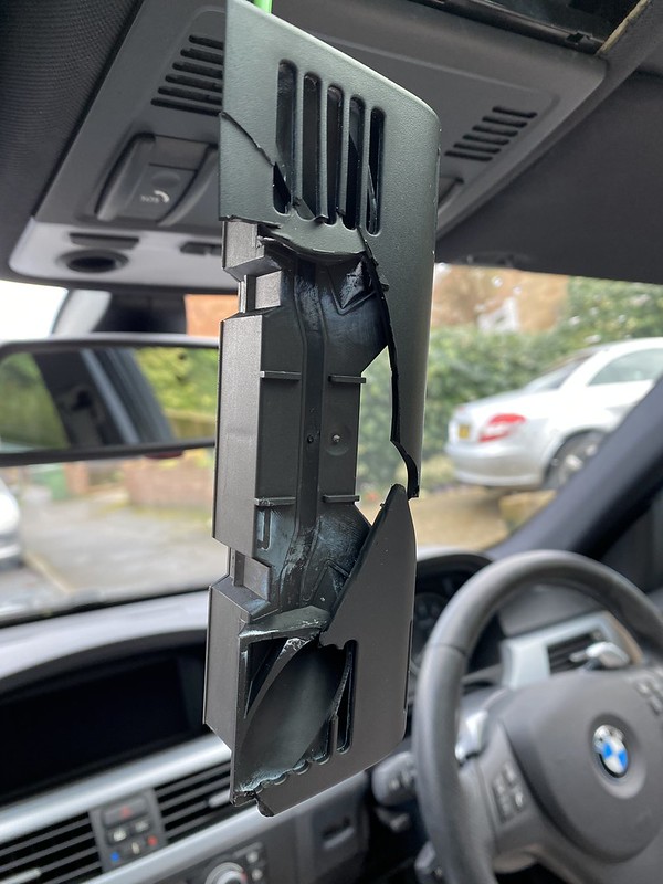

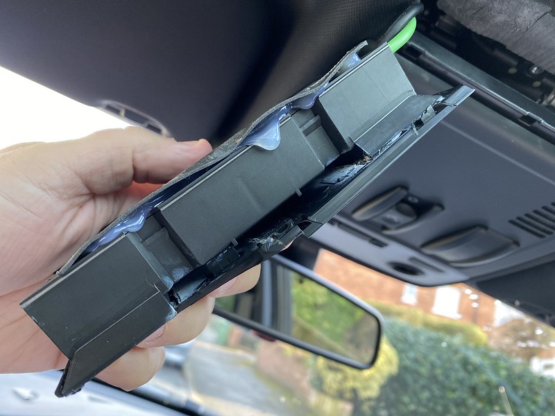

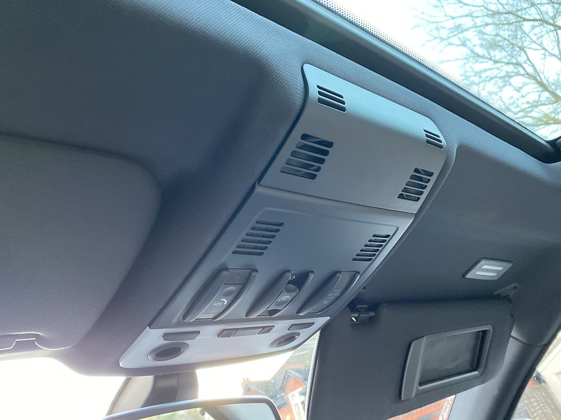

This is the panel next to the sunroof buttons, hidden behind it is the bluetooth microphone.
The unit has been off in the past for some reason. When it was removed it was broken somehow, as you can see below:
Untitled
by Sir_Dave, on Flickr
This annoyed me greatly, so some overnight parts from Germany were bought:
Untitled

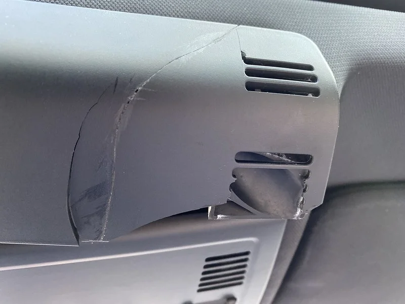

Upon removing the panel, it became apparent that when it was removed previously before and cracked, the numbskull that removed it also broke all the clips that hold it into the roof, so they glued the panel to the microphone module, then glued that to the roof :unsure:
Untitled
This made seperating it rather difficult:
Untitled
But we got there in the end.
Untitled
Et voila. All fixed.
Untitled
Whilst i realise that this is rather a lot of photos for a simple task, the absolute retardedness of the initial repair amused me somewhat.

Yup. Its fairly poor isnt it, i mean the part wasnt exactly expensive (£35 posted from Germany), so they should have just replaced it really. I think the thing that really annoys me with the main dealer is that they just dont care, i mean, the saloon 335i has full BMW history as well and the first thing i had to do with that was fix the coolant leak from the poorly replaced (under warranty) water pump, then they buggered up the power cable recall so it cut out on the motorway!!

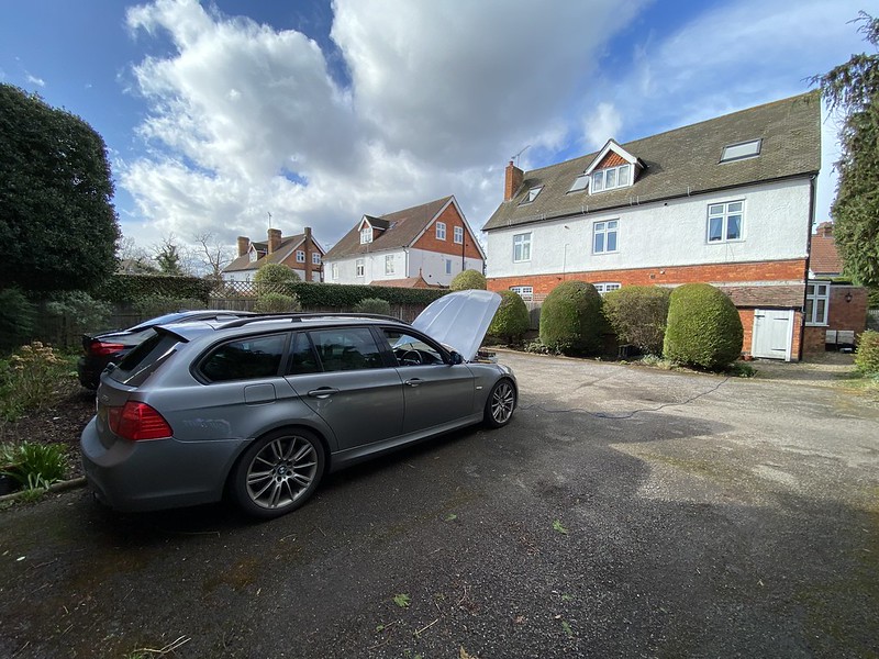

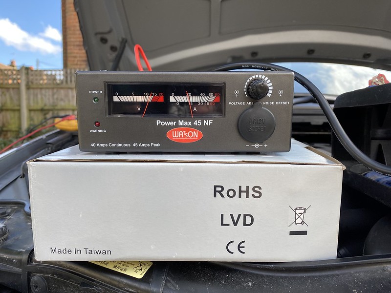

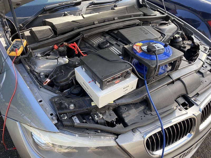

After the ZF8 in the M135i, i just couldnt cope with the sh1tty gearbox anymore. Standard 335i still has 300bhp, so shouldnt feel like a milk float at low speed.
So i bought a new toy, specifically a Watson Power Max 45NF power supply. Now, over the years, ive done shed loads of coding/updating/mapping using a CTEK MXS 5.0 battery charger, and/or just on the cars power, but well, it always felt like i was sailing a little too close to the wind, especially when flashing software updates for 30+ minutes. This "cb radio" power suppoy can provide 40 amps continuous at 13.8 volts so the car battery stays nice & stable for as long as i need :cool:
Untitled
1st floor flat problems (extension lead out of living room window):
Untitled

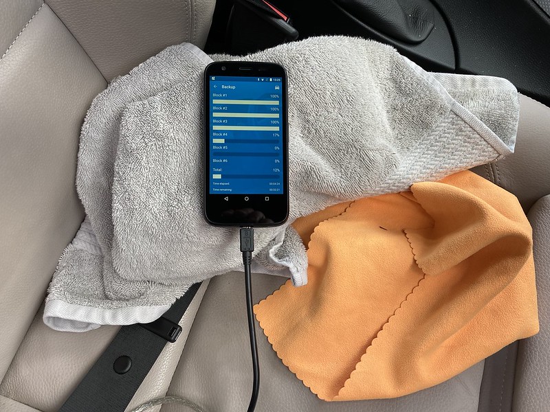

Plan for the day? An MHD flash for the gearbox. Initial backup (circa 30 mins), software flash (20 mins), then map flash (2-3 mins). I had stage 2 last time on the 330d, but was really undecided whether to go stage 2 or stage 3 on the 335i, so bought a "Super Licence" which is maps 1/2/3 for £219.
Backing up:
Untitled
Ampage draw was between 15-20A throughout:
Untitled

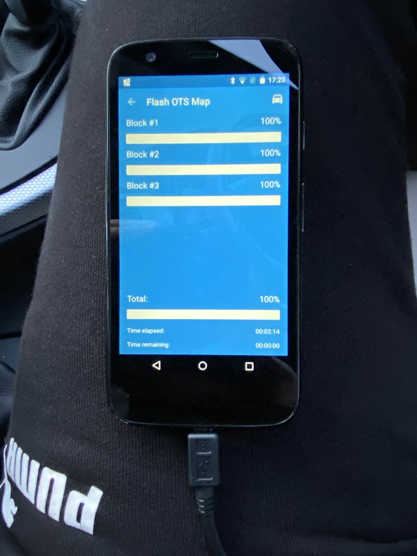

Decided to go with Stage 2 initially:
Untitled
Quick spin around the block and it worked well, much improved torque convertor lock up, quicker changes etc, but still no ZF8. Back home and loaded Stage 3. Now have 50% faster shifts in S/M modes, proper throttle blip on downshifts and instant paddle reaction (also took 5 mins to rewire the shifters so they are left/down and right/up). Gearbox is now drastically improved, so would suggest whilst stage 2 is ideal for diesels, stage 3 is better for a petrol.
