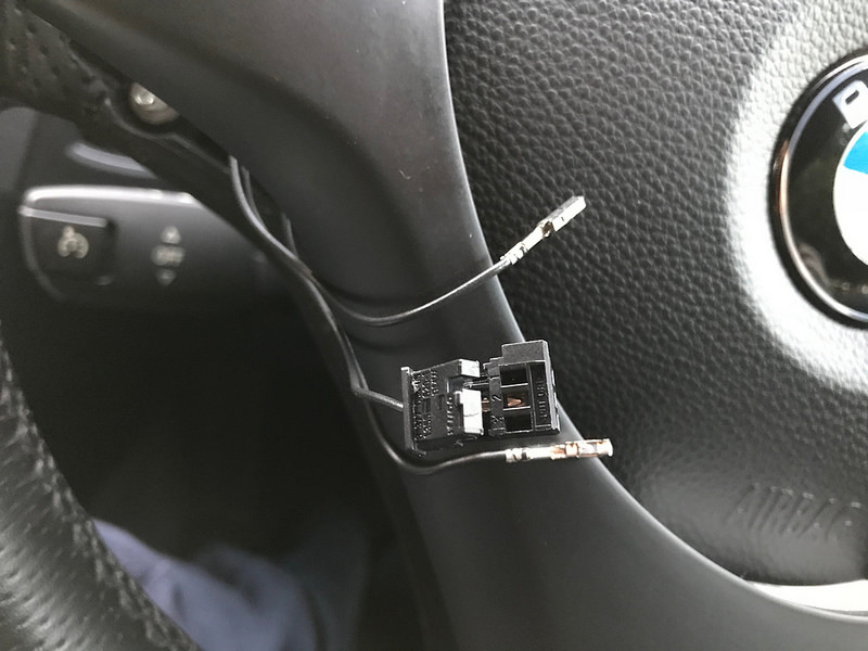

Wires switched in the steering wheel so that the paddles work correctly now - way way better!!

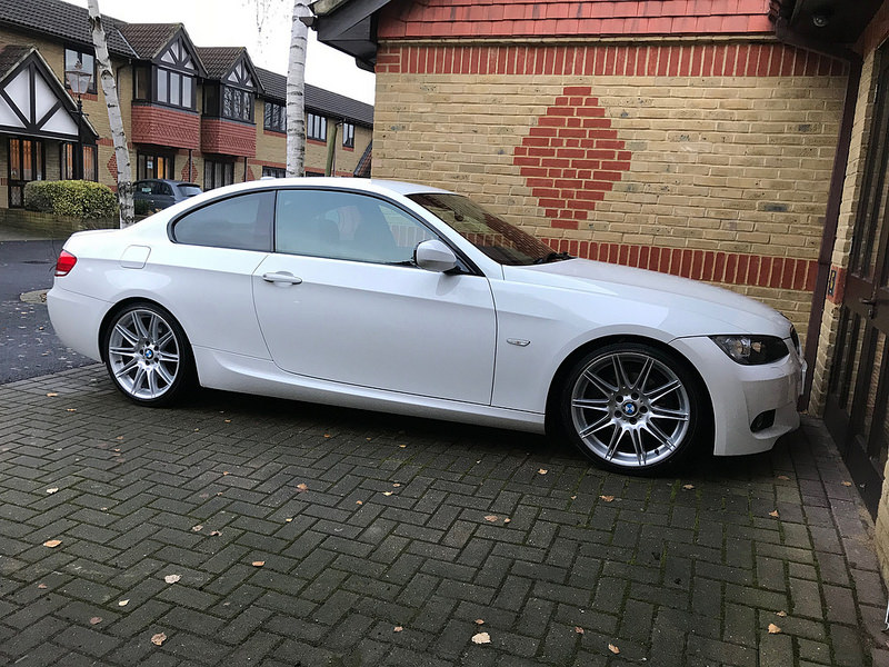

Have also been pondering wheels, i like OEM, so the M269 specifically:
attachment.php
But then, with a little bit of lowering (ill fit the Bilstein B12 at some point, springs/dampers have almost 100k miles on them), the MV4's still look lovely ...

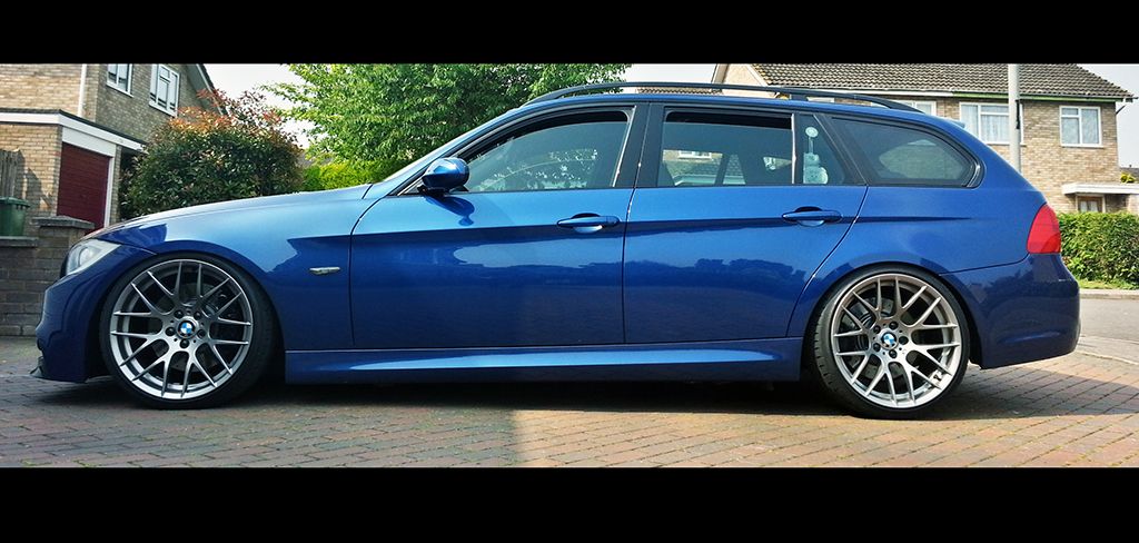

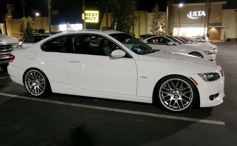

FAT FAT rears
I always have issues with his rims tbh, the front offsets are always slightly wrong, i.e. wider to give the look of spacerz, which annoy me.
That & fitting M359/CSL wheels to a 330d just makes me shudder lol.

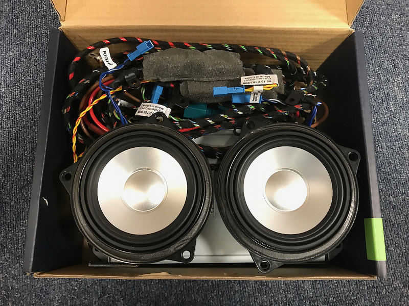

Then onto the main event, the speaker/amp upgrade. Parts purchased:
e92 HiFi Alpine retrofit kit, part no: 65412163268, £245
Corner Moulding Right O/S Side E92 E93 3 Series, 51337184198, £12.68
Corner Moulding Left N/S Side E92 E93 3 Series, 51337184197, £12.68 (all bought at the same time as the above for double discounts yo)
Seal, inner left mirror triangle, 51337119173 & Seal, inner right mirror triangle, 51337119174 at £22.27 (needed or you get wind noise)
Before:
Untitled
by Sir_Dave, on Flickr
After:
Untitled
Note the TT trying to get in on the action, think it was feeling a little left out on all the love 😂
Installation took 2-3 hours, wiring is super super easy as BMW redid it for the LCI model & made all the connectors plug & play instead of splicing. Instructions not required. Havent re-coded it yet as it sounds perfectly good as it is (& i havent got my coding laptop finished yet). MASSIVE improvement over the standard garbage already though. Its not exactly BOSE as per the TT/Boxster, but it actually have some bass now, can turn it up without distortion at last! Will probably upgrade the underseat subs to the L7 ones at some point, but finally, i have some decent tunes in me car :up:
