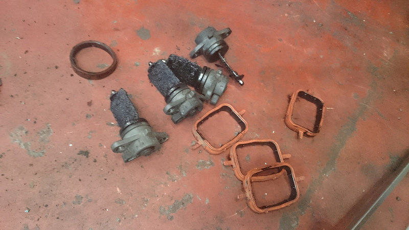

Ge the flaps whipped out. Takes about an hour and costs about £40 for the parts. i6Automotive do a kit. Being the 330d, its probably the 33mm ones you need.
Just leave the actuator plugged in so the bar still does it's job and you don't get any codes.

Are the flaps easy? My 320d has the M47 and still has them in. :anguished:

Didnt take me long and I'm a complete f**king r****d
Worst part was getting the rear engine cover lined back up. f**king allen bolt b*****d

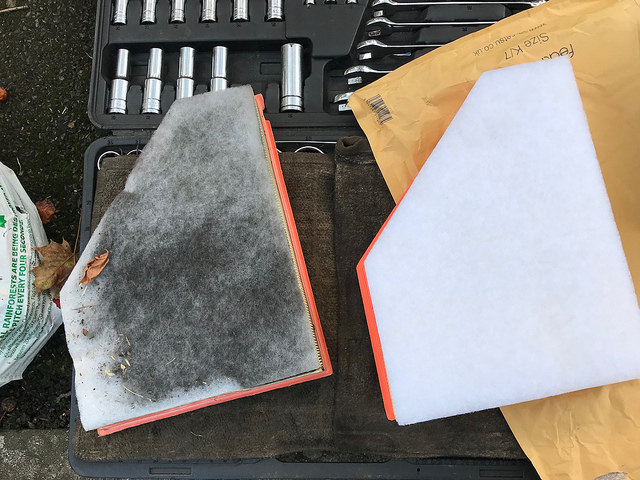

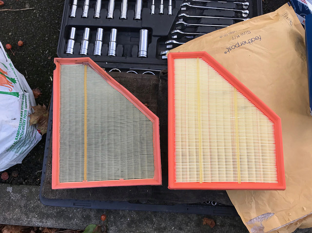

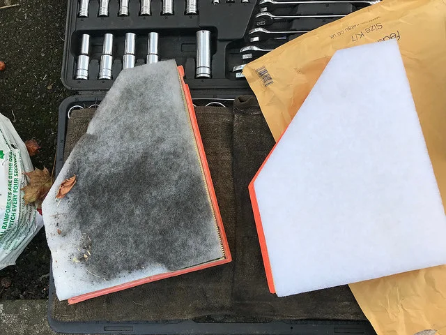

Also did some more minor service works over the weekend, mainly as i dont trust other people to have actually done it ... and bearing in mind this had a full service at BMW inc. all filters 1k miles ago ... lolz 😂
Air filter, old (left) vs. new (right) - airbox was also full of leaves & grit:
Untitled
by Sir_Dave, on Flickr

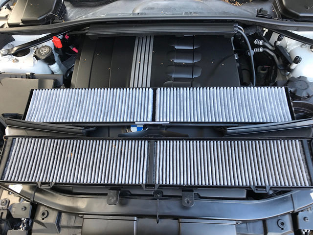

Micro filter (pollen) - air in the car was very stuffy, actually making Sarah feel a bit ill:

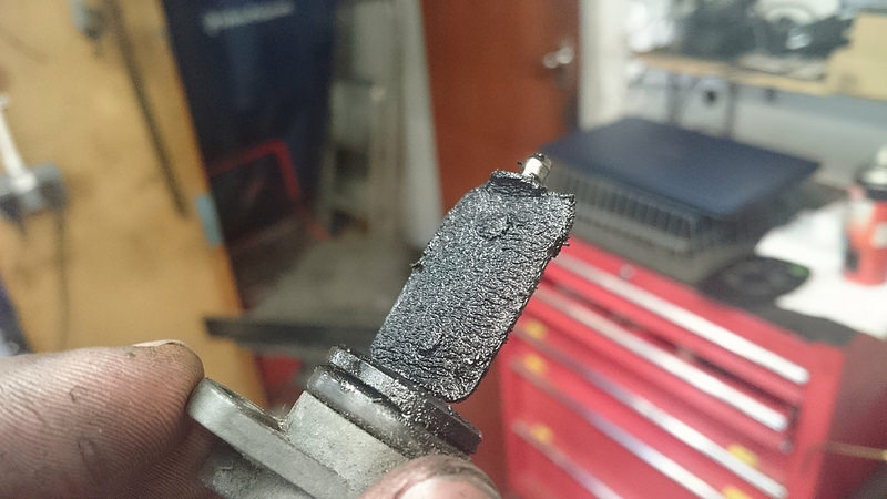

The EGR chucks exhaust gas through the inlet at low revs to bring the emissions down, but also clogs up with carbon etc. The cooler is only there to cool down the gas. So if you EGR, you might as well delete the cooling side of it too. Less s**t to go wrong then.

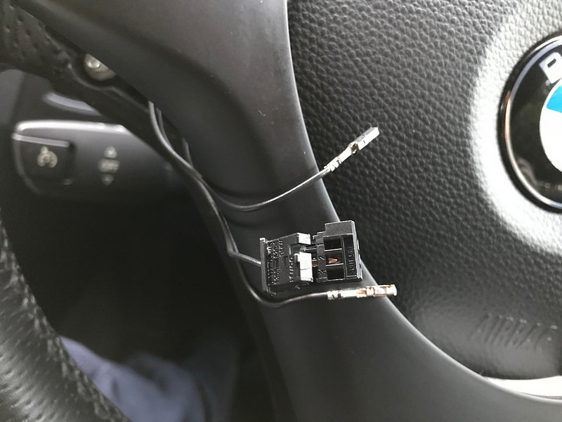

This weekend i intend to swop the wiring on on the left paddle so that i can pull it to change down (like the DCT box):
(FACTORY DEFAULT)
LEFT PADDLE - Thumb press - downshifts. / Fingers squeeze - upshifts.
RIGHT PADDLE - Thumb press - downshifts. / Fingers squeeze - upshifts.
(MOD 3) Simpler mod, since you only need to modify the left paddle wiring.
LEFT PADDLE - Thumb press - upshifts. / Fingers squeeze - downshifts.
Described fully here: http://www.e90post.com/forums/showthread.php?t=121524

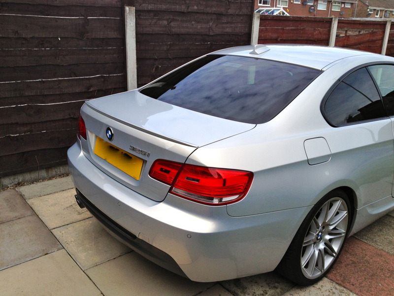

Also purchased a rear lip spoiler, for the sake of £50 from a chap recommended on e90post, i think itll make a nice difference :up:
https://www.ebay.co.uk/itm/PAINTED-...RUNK-REAR-SPOILER-300-WHITE-335i/371859375724

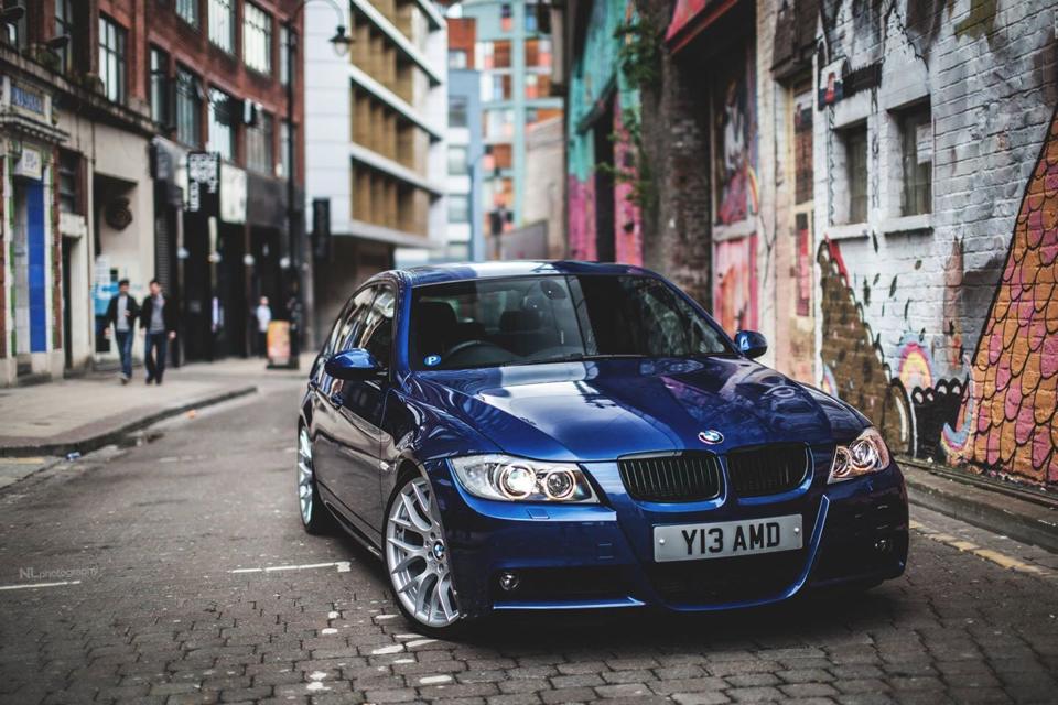

I love my 325d, it did look like this but Im back on standard wheels now.
You can't beat the 3.0l 6 cylinder, mines 256hp and 383lbft. Biggest issue I've had was clutch E on the auto box and its a £1500 job, that stung after being made redundant.

Lip spoiler really improves the rear end looks wise

Couple of little updates on this now.
Wires switched in the steering wheel so that the paddles work correctly now - way way better!!
Untitled

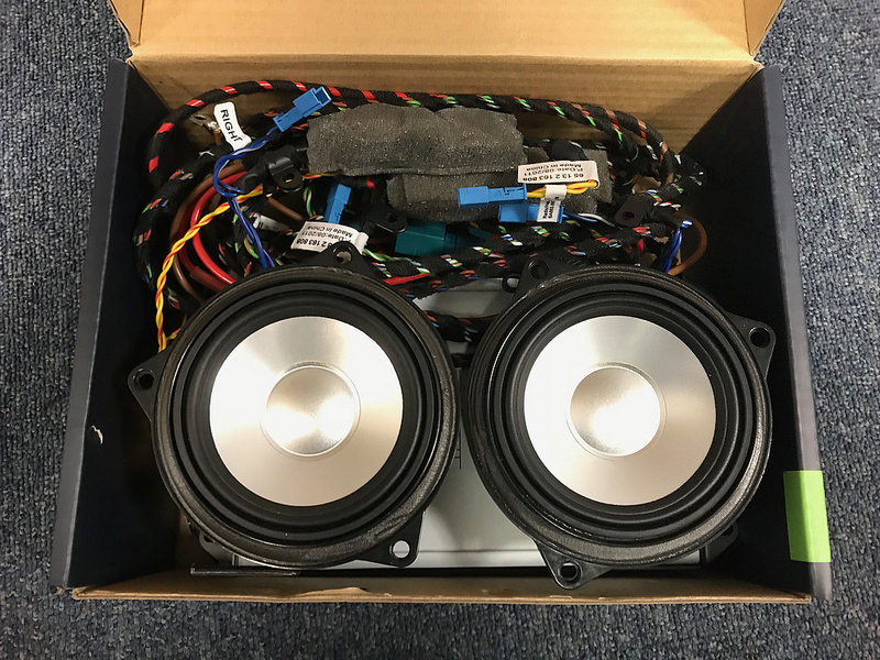

Also bought the Alpine retrofit kit in the Ebay December sale, 20% off meant it was only £240, whoop whoop:
Untitled
Picked up the necessary a-pillar trims for £10 each as well, happy days!

The paddle switch thing, is that to stop both paddles doing the same thing?
Really annoys me when driving my old man's that one isnt change up, and the other change down
