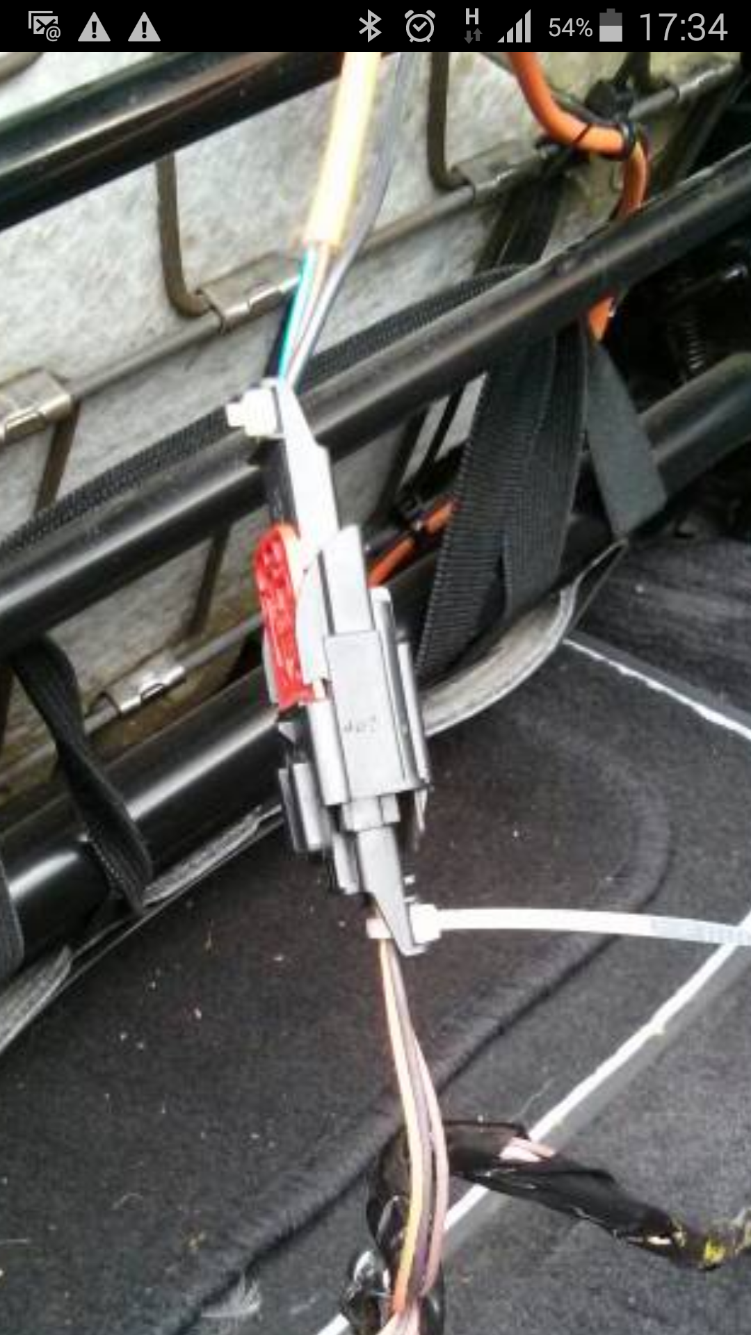

Is there a way to get the red connectors apart? spent ages swearing at them but got me no where haha
This one I assume?
Just below the red tag there's a little black lug that needs to be lifted up to allow the two halves to seperate
Cheers for that man, just got them both disconnected, checked and reconnected but the light is still on. Think I'll just have to go to an auto electrics place and get a proper tester on it.
