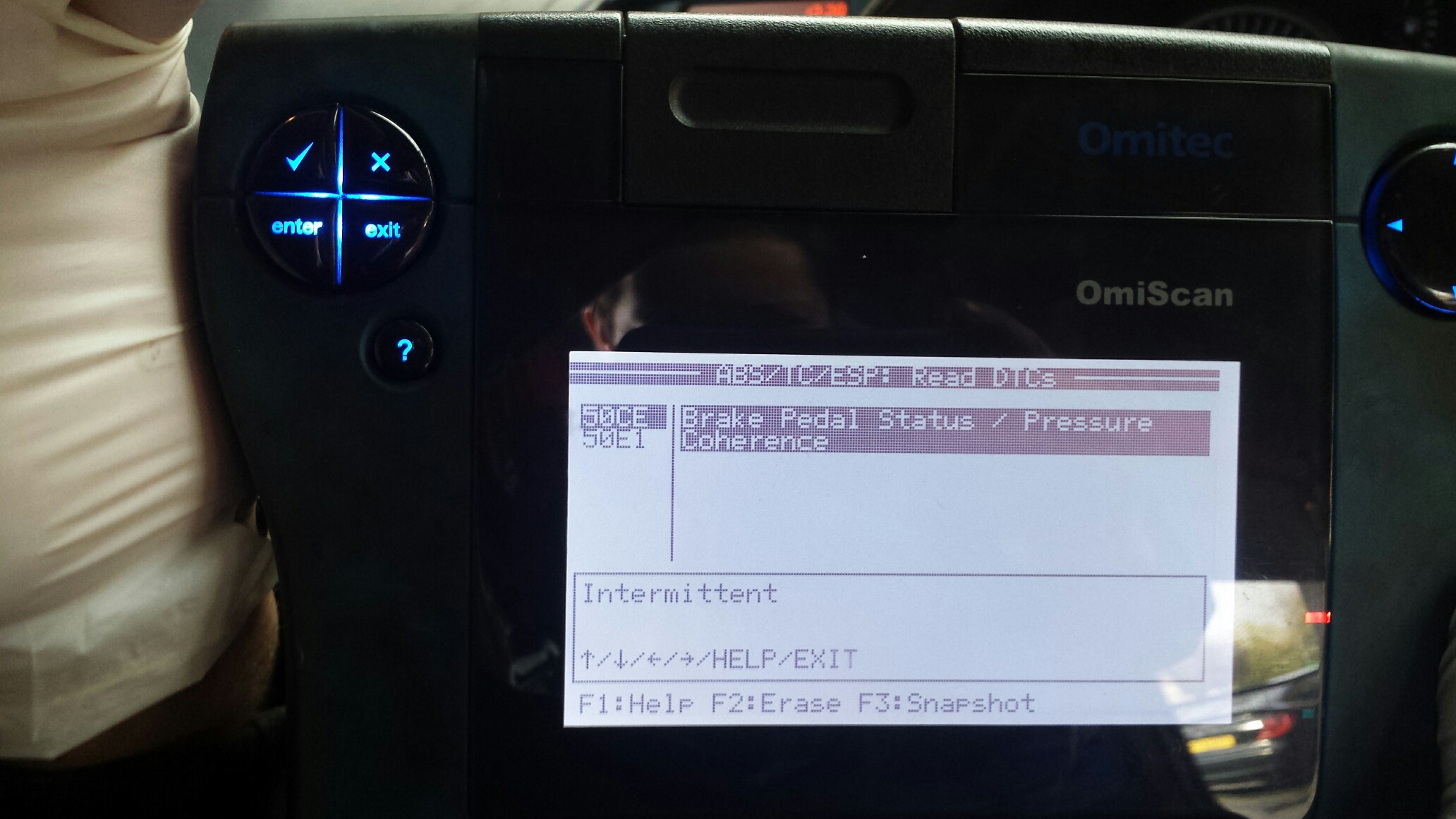

Hi,
I had the common issue of the ABS, SERV and traction light coming on. I put it on a friends diagnostic and it came back with this
I adjusted the brake pedal switch last night and this definitely needed doing because my brake lights weren't coming on until I pressed the pedal firmly. (thanks for your advice @MicKPM )
I thought this had sorted the issue, but this morning I had JUST the traction and SERV light appear on the dash whilst travelling down a dual carriageway.
Anybody have any ideas? I cant find anything on the search function apart from steering angle sensor but this didn’t show on the diagnostic.

It might not be throwing a fault code as such but the angle sensor could be returning a bad value for the position. Can that code reader report the sensor value? If not you might need to get it onto a CLiP to see what the sensor is reporting.

Well first test run was ok then 10 mins in had the esp and serv light. So i stopped and though that maybe the brake light switch was too sensitive now and coming on too early. So i pulled the brake switch adjuster out one more click. The brake lights come on lower down the pedal now so not as sensitive and then took for another drive and all seemed ok! Also noticed my cruise was working again now and wasnt on the first test drive i did.
Does this sound correct or is could it be coincidence?!i guess only time or pluggin into CLIP will tell.

Id try a new brake switch sensor, and cleaning the contacts of the YAW sensor with a dab of oil on the metal contacts afterwards.

Just thought id update this thread in case anybody else has the same issue.
Mine was down to the brake switch. It took a fair bit of trial and error to get it in the right place on mine for some reason.
It ran spot on all day at Cadwell park yesterday, so really pleased.
Thanks for your help everyone
