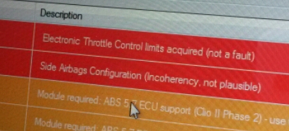

Yeh ive got it on mine ash came down so I put it on but would not allow me to move that not plausable one all the underseat ones went straight away but dont understand that fault

If they've been done on Clip Ash then you either have the overall configuration wrong OR there has been a knock which has triggered one of the many lines to fire.
