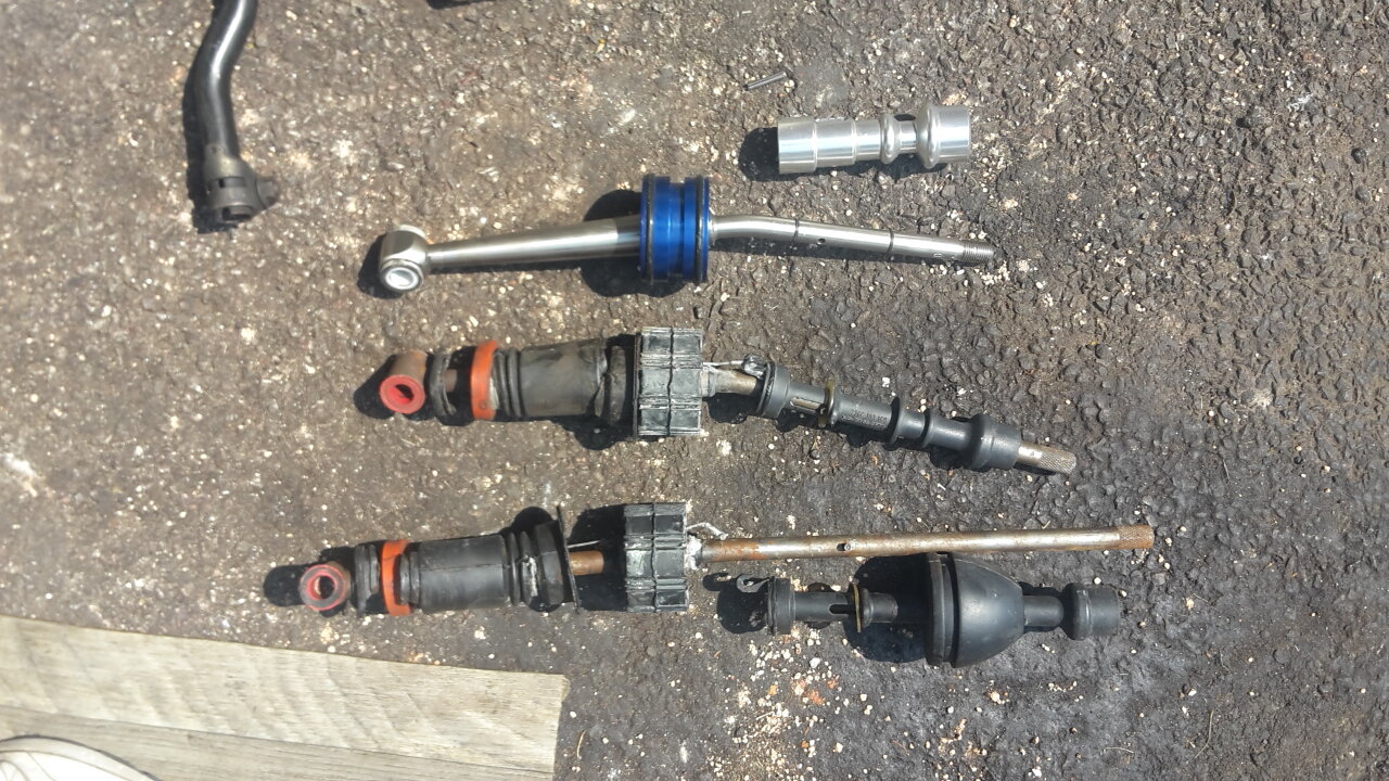

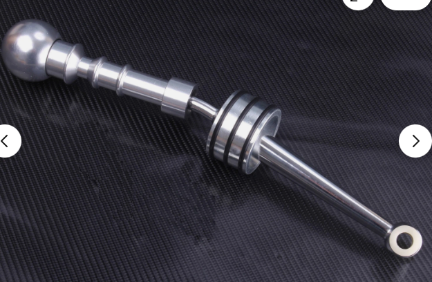

They arent great, They just lower the gearstick to create the 'short' part of it. They do have a decent metal pivot but these wont do the same as a PMS or modified scenic shifter will.
Heres some photos I took of the B&M style alloy shifter (similar to your picture) against the standard clio (middle) and the scenic (Bottom)
