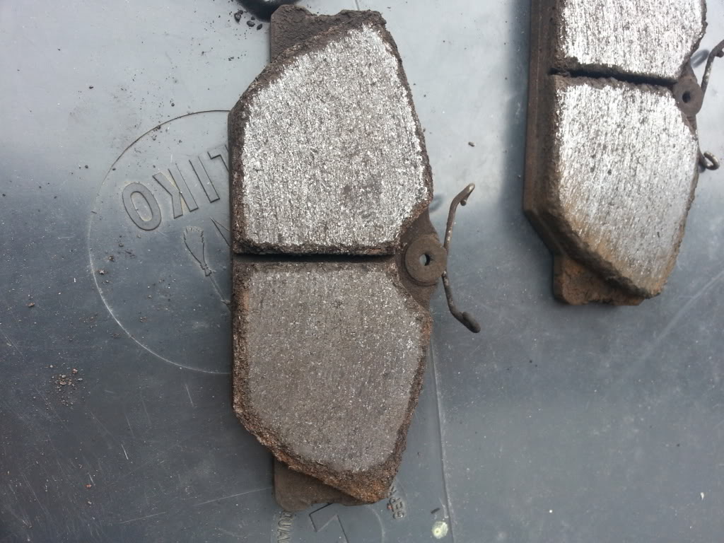

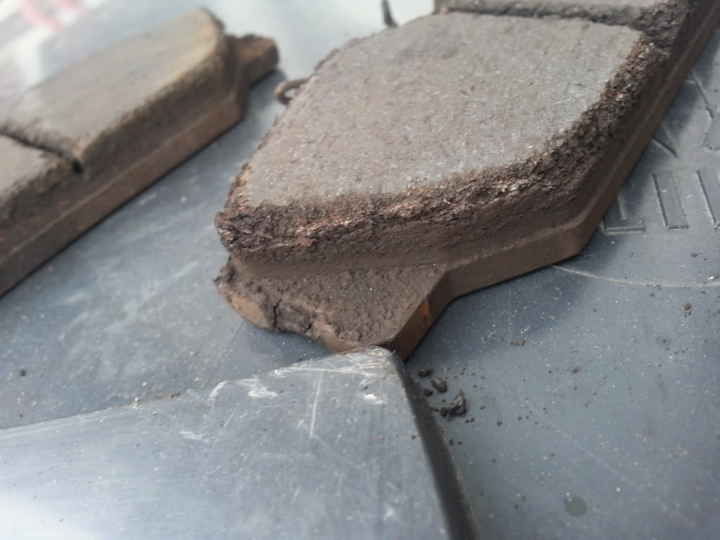

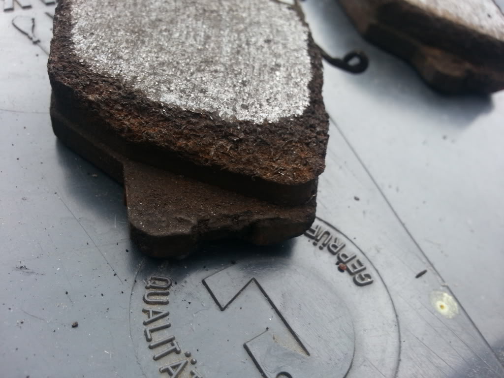

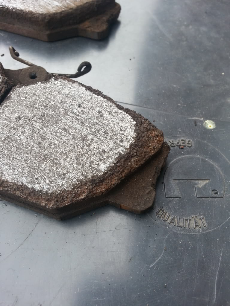

should I be worried about the state of my pads?
Car  Ph2 172 Track Toy
Because I am worried. They are ds2500 and are around 3000 miles old with 1 trackday.
They don't look great for that mileage tbh.
Did you file them before fitting? Look to have got pretty hot.
Sorry for my ignorance but filing them??
But yes I did get them very hot at Donny. They were bellowing smoke after my runs.
DS2500 pads, although good do seen to crumble as disappear quite quickly once you start using them pretty hard.
i did 2 trackdays at Bedford, started with a brand new set of pads, and towards the end of the second day they were shot, and by 'shot' I do mean down to metal grinding against the discs.
​luckily I had a spare set in the kit :)

I binned the shims but they weren't filed down. To be honest I know nothing about filing them.
I found out my neighbour knows the owner of carbotech so he's gonna sort me some.
