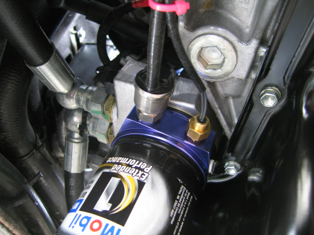

Where would you plug in to read the oil pressure and oil temp? Can you get something to adapt and fit it by the filter area? Or is it a drill job?
  e34, 172, Radical
Normal way is to use an oil filter sandwich plate, basically the plate screws into where the oil filter goes and the oil filter screws into the plate. Or it can be a filter relocation one, using lines so you can put the filter where ever you want (for space).
