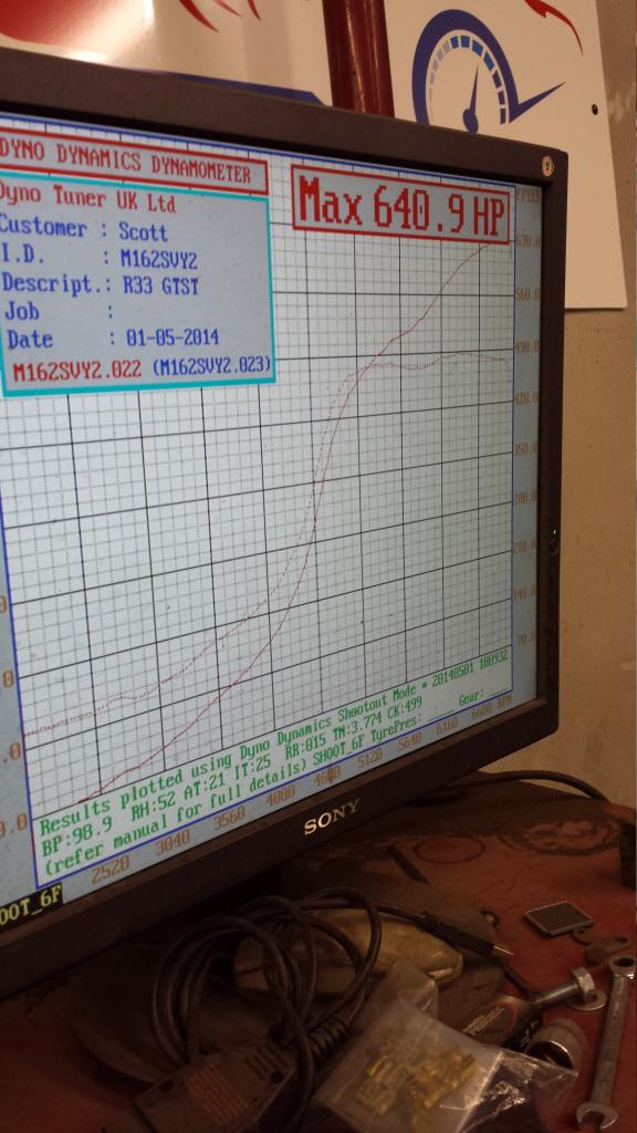

Show me your graph!
This is for my 1.8L engine (F4P-like):
Ktec bodies with around 100mm trumpets, engine dynamics cams, gen90 ecu and Ktec decat exhaust
214bhp and 174lb/ft going in to adjust the map abit more since adding the extra inlet length.

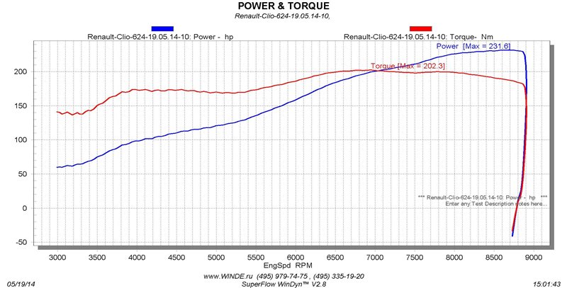

Its an F4R but destroked with an F7P crank to get the engine size down IIRC. (so he can be competitive in a 1.8 class rather than uncompetitive in a 2.0 class)
No, it is competitive in 2.0 too, but in this season the rules changed so I need to add 100kg as soon as my car is too light (all three doors are now plastic with polycarbonate windows and so on). I didn't want to do this and prefer to decrease the engine volume :)
It is F4P crank (not F7P), 150mm ConRods and 84mm Clio Maxi Pistons (very light, with 2 rings).
