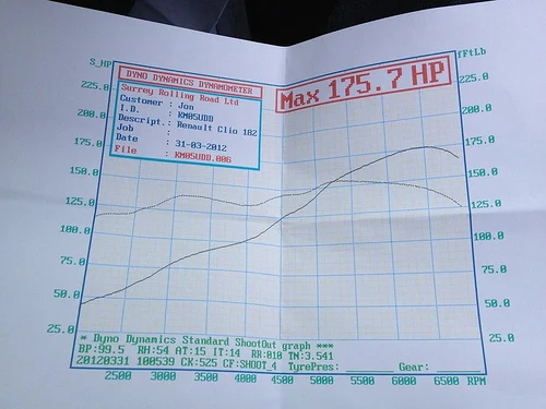

Show me your graph!

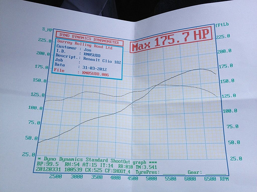

Surrey RR Jan. '12 by Jon_KTM, on Flickr
Milltek cat back
ITG panel filter with home made CAF
And 1 year later...

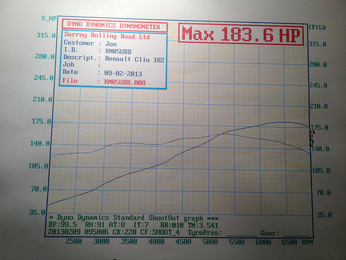

Surrey RR 02.13 by Jon_KTM, on Flickr
Milltek decat back
RSTuner 98RON map
KTEC billet lightened flywheel
Magnecor KV85 ignition leads
It is indeed.
Probs should mention that is with 438 cams and there induction kit and matched inlets.
U got the same package as me I was dyno'd exactly the same and took it to a reliable RR and it was 181. Get it checked out bud as mine is now running like s**t & is currently at another tuner trying to be corrected
You're probably right. I was just being generous and didn't want to burst any bubbles. Seems Kyle has already done that now though FLOL
I will do next year :) tbh I'm not bothered if that bit of paper said 160, the car drives really well :)
Mate trust me get it checked when u can. I thought mine was fine and they put the worst map on it ever. Get yourself down to MWM. I say this cos I dont want u to fook ya engine because of them Cnuts

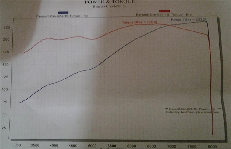

CatCams 553+vernier pulleys, JMS RS2 manifold etc ... Project thread http://www.cliosport.net/forum/show...lio-172-ph2-from-Russia&p=9875092#post9875092
Wow, that really is awesome.
Ive been saying for a while that I would really like to have a go at doing a high comp and big cams build on an RS2 inlet, but not seen anyone actually do it before.
Are you still on the standard ECU with just a remap, or have you gone onto aftermarket?
Ive always made the (untested as of yet hence my question) it would need to move from Speed/Density based mapping to throttle position based instead because of the inlet manifold pulses that you get on hotter cams effecting the readings for low load sites.
Inspiring stuff :)

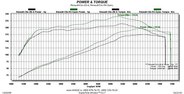

Out of interest, do you have a graph from the same dyno for a standard car, not in anyway questioning the fact im sure you have seen HUGE gains on that spec, just wondering how much as obviously if a standard car makes 185 on the same dyno it would imply on the dyno im used to yours might "only" make 220 or so for example.
This is with programmable aftermarket ECU. An I have 5 or 6 same dyno graphs ... Please look at:
I cant quite read that properly, what are the figures please?
And what is the spec of the other engine its being compared to on that graph?
Really good to see someone using an RS2 like this :)
Black is almost standard - with custom 4-2-1 exhaust and decat, Samco Induction kit, matched inlet, Hank's RS Tuner remap. Green - with aftermarket ECU, CNC-mashined cylinder head, and some other tips - but with OEM cams and inlet.
Black - 175 bhp
Green - 197bhp
The scans are low-res, and I do not have all files with me (I just arrive from Moscow to London and are still in Costa cafe in Heathrow airport now :) ). I think there are more info in my project thread here http://www.cliosport.net/forum/showthread.php?424690-Black-Clio-172-ph2-from-Russia
Those figures dont sound too far away from what I would expect on similar spec engines on the dyno I use, so that makes the 230+ figure seem even more "valid" in terms of what I would see :)

They are good figures, I fear they may be slightly lower if tested on a different dyno but still good work!
