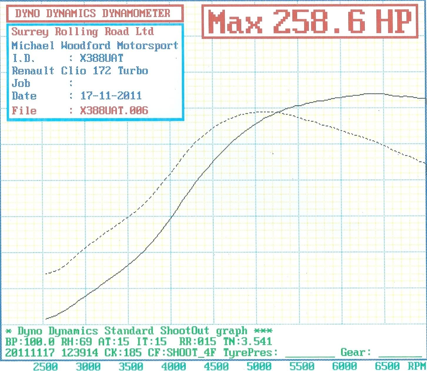

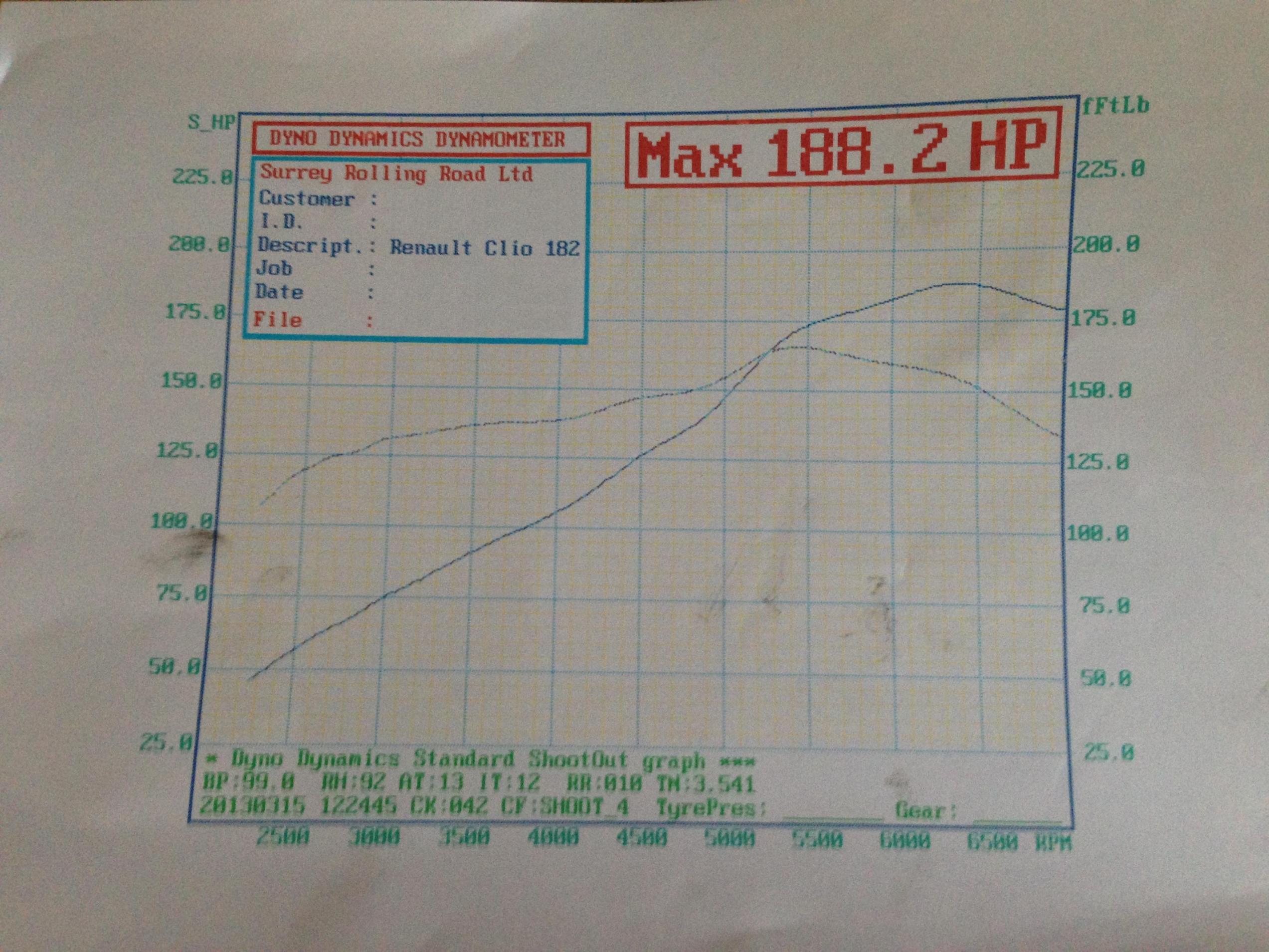

182 Trophy
RS2
ProSpeed stainless exhaust with decat
Mapped by MWM
I really should bother to get a decent printout at some point, lol.
Torque reading very low on that one (its actually well over 300) as the run was done at 3/4 throttle to avoid wheelspin.
Mods : turbo, 197 cams, forged internals, mtec v4 ecu

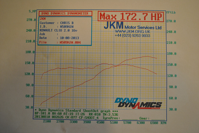

The RS2 is showing some decent torque there.
That graph and the one posted by dr jekyl above it show why people should take to little notice of a peak torque figure, LOL
J's is 151, dr Jekyls is 155
But J's holds peak torque for the entire rev range, dr jekyls just spikes to it briefly. so dr jekyls has a few lbft more for just a few hundred rpm but at other places like at 3K, J's absolutely trounces it.

After having an RS2 fitted I think it just detracts from the way the car should be which is 'peaky'
I felt it just stole peak torque to give it to lower in the rev range, I couldn't see it's uses as these things are in the power band when in use, for e.g I would rather have dr jekyl's graph than tim's as I find it a more useable power for my uses.

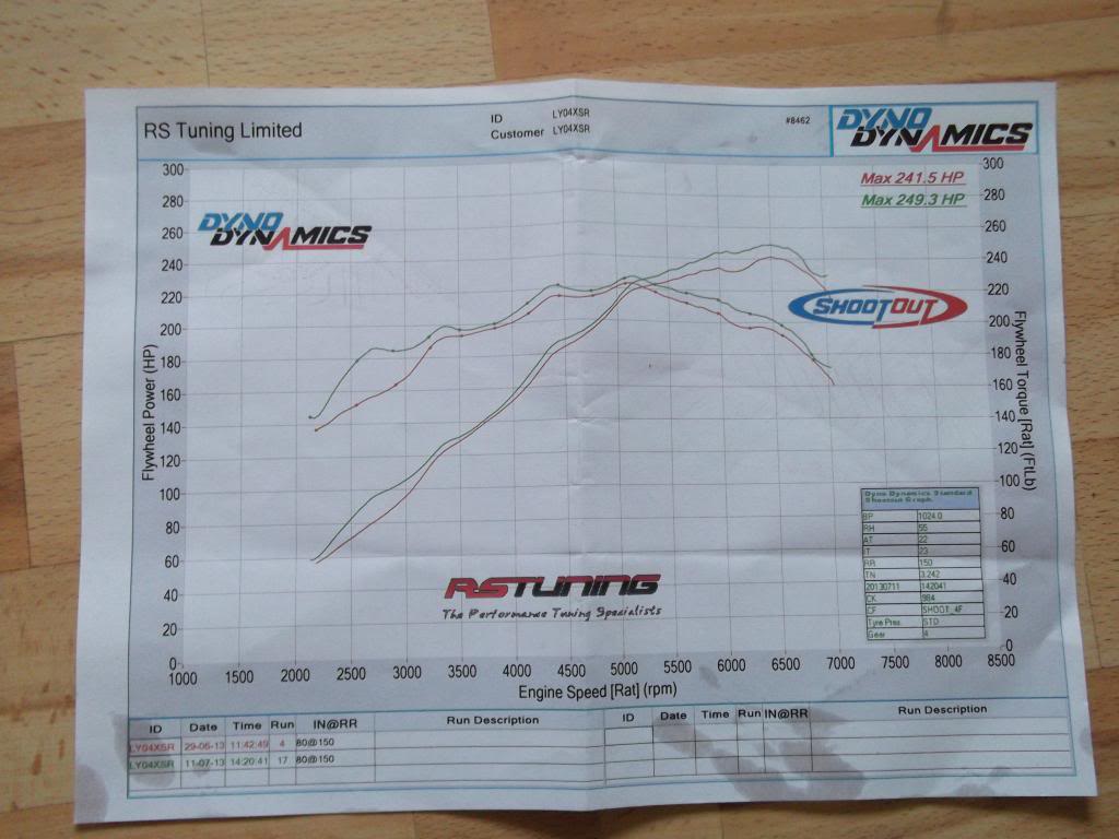

Look at J's graph mate,
Power is still climbing after 6500, and torque at 7000rpm although dropped slightly is still 145, versus more like 125 on the standard inlet (as you can see from his before and from the graph above from dr jekyl) and if both graphs went further up the rev range you would find it even more noticeable at 7500 than it is at 7000, by then the standard inlet is down to about 100lbft and the rs2 still over 130.
Its for track use that I like the big difference at the top end of the RS2, on the road i dont tend to rev it over 7K anyway, but on track I do. And on these engines an extra 20lbft at the top of the rev range is not to be sniffed at IME.
With the 197 cams as well it shifts it even further, they make peak power right up at about 7800 by then, which really allows you to exploit the mechanical advantage of being in a gear lower for a lot longer.

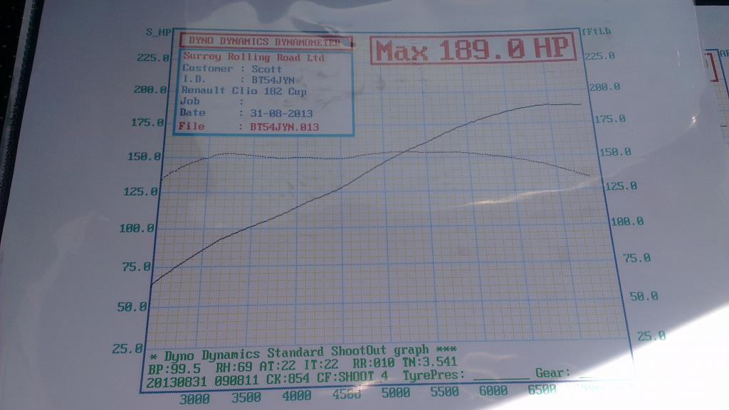

172 cup
Ktec recessed exhaust & Rs induction kit
Decat
Matched inlets
438 cams
Mapped by ktec at the time
Car is currently with MWM to be live mapped properly

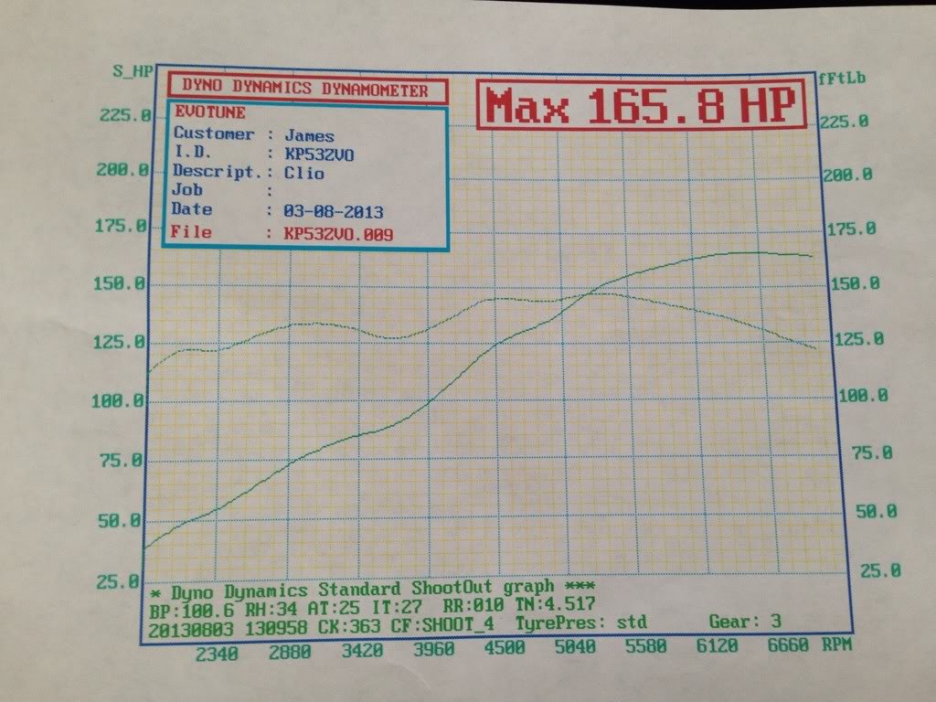

RS2
Yozza manifold back exhaust
Charlie seemed a little disappointed when I took it down to SRR for a rolling road day as it was running a touch rich, he thinks it should be low to mid 190's, Something for Mike to take a look at when I get my suspension refresh sorted.
