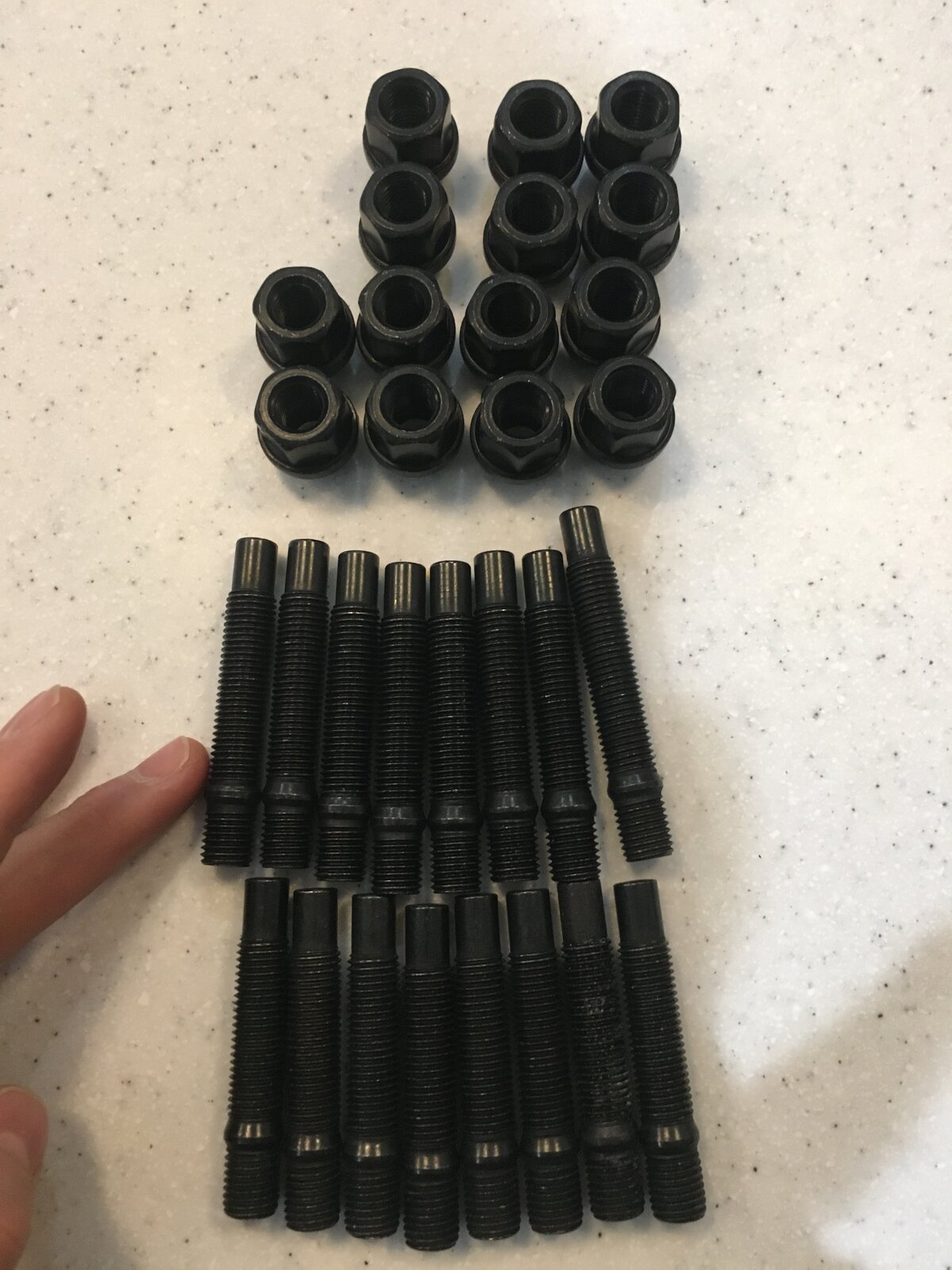

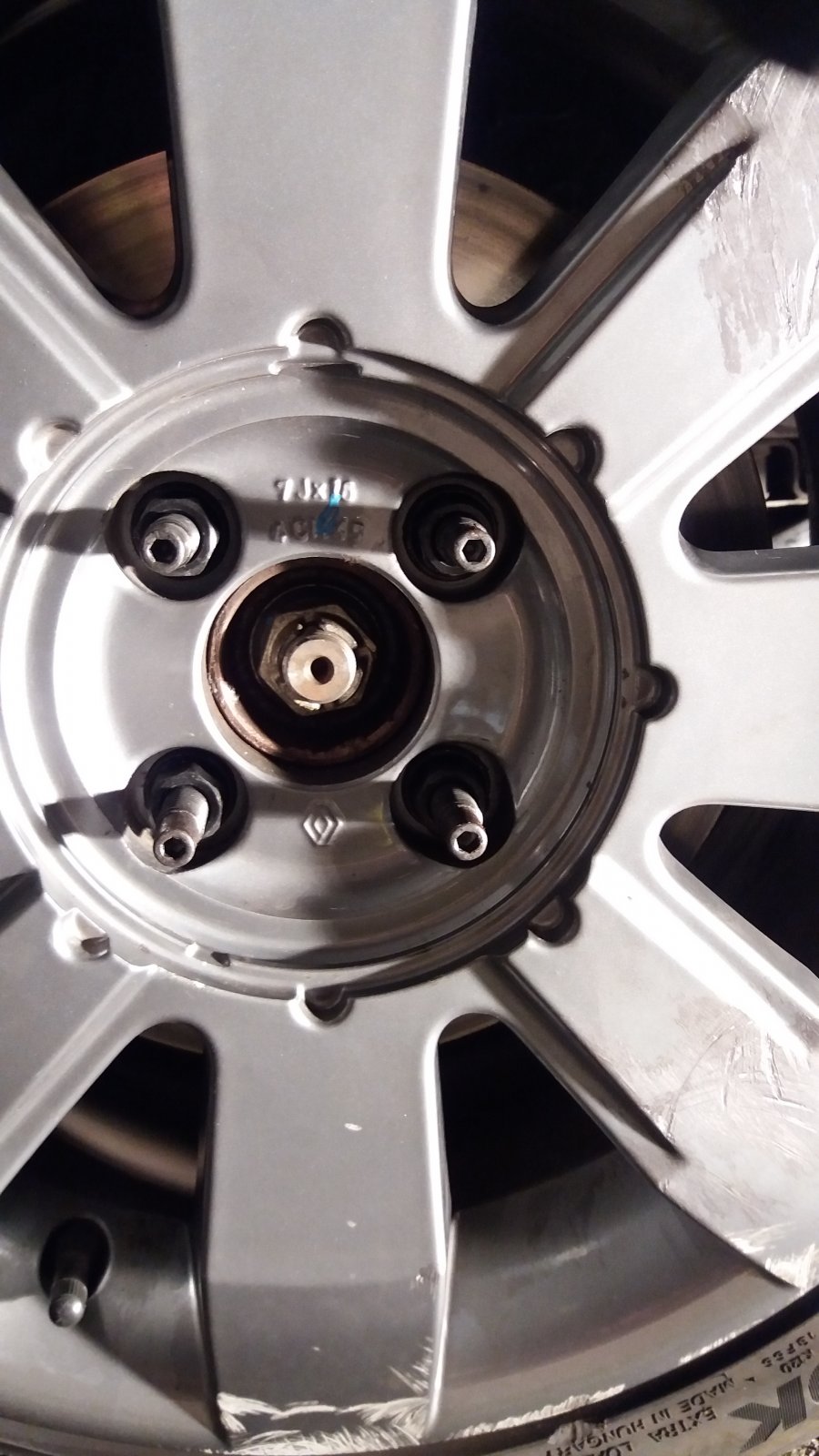

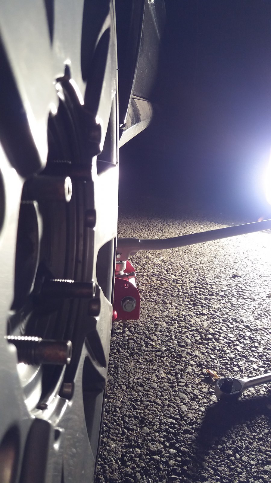

Show me your stud and nut kits.

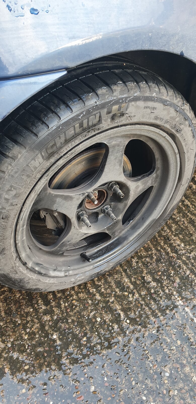

Just fitted 82mm on fronts and heads sticking out about 20mm so centre caps wont fit.
cs_dave
West Midlands
Im running oz f1s bolt to hub spacers so these would bolt into the hub and nothing on rear tho i would like 10mm hub spacers what size would i need for a nice look.
Jekyll
Hub spacers won't make a difference as it goes into the disc, therefore 68mm would be perfect.
Measure one of your wheel bolts. It should be around 60mm iirc.
Is your spacers, bolt to hub and using existing bolts using longer bolt type?
If your your using existing wheel bolts measure around 60mm I'd get 68mm. If you have longer bolts then I would add the difference from 68mm plus your spacer size = stud length.
I run 82mm on the fronts with a 16mm spacers. Pics on the previous page.

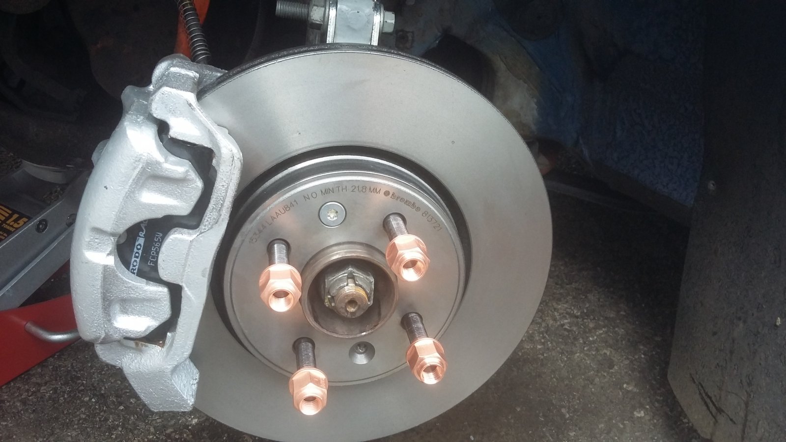

I've got the A I Tech competition studs and the copper coated wheel nuts.
Not cheap either, but didn't want to break any more after I had a couple fail.

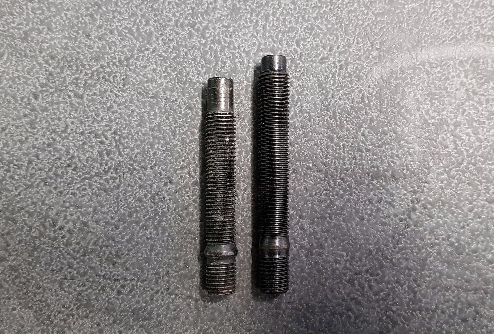

After my current nuts being seized on (I think the tyre place did them up super tight as I cant remove the nut off the stud, but the whole stud comes loose out of the hub) I've decided to buy new studs and nuts.
I've gone for the same AI Tech ones as you as I already have some 90mm ones here. I've just purchased 70mm ones for the rears and am swapping my 16mm front spacer to a 18mm one.
These look great quality. Will fit them all once the rears arrive. I've gone for "normal" m12 x 1.5 short black wheel nuts. I do fancy something better but these was readily available to be sent out for the weekend.
Bimmec ones on left, AI Tech on right.

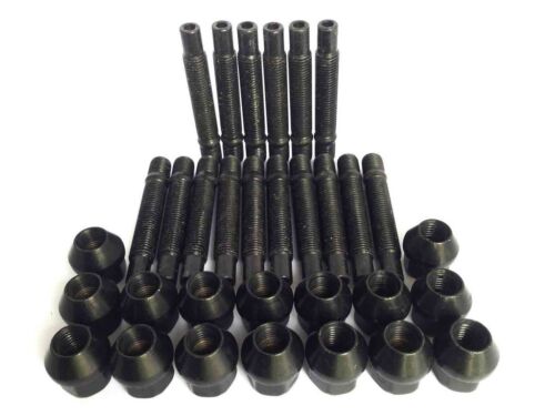

New ones for mine arrived yesterday, if i didn't have bad luck, id have no luck at all.
One random long stud and 2 nuts short. 😅
(Picking error, they’re sending me replacements)

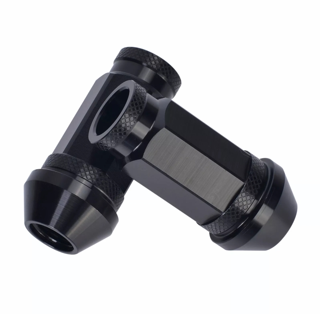

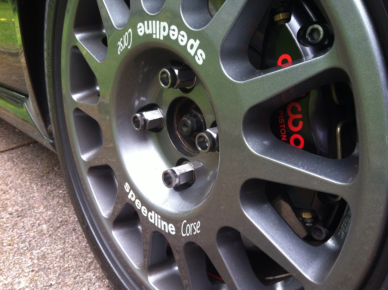

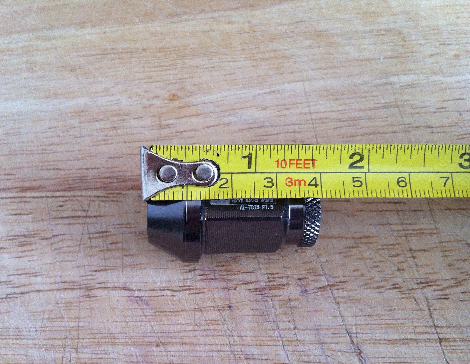

Anybody use different wheel nuts other than the ones of Bimmec, PMS, etc?
I'd quite like some that are like these.
I had some D1 ones years ago on my old 182. These was 40mm and perfect size, but aluminium. Not sure if that's recommended though? Worried the material will be weaker than steel?
frayz
View attachment 1452987View attachment 1452988

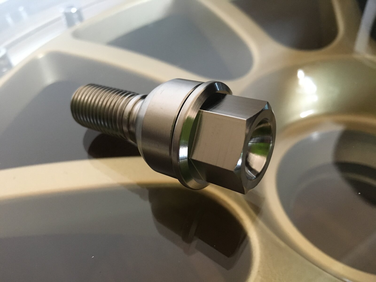

I used to run some alloy Volk Racing ones on the Impreza, they were very high quality alloy but i think anything less and i wouldn't trust them. There's a reason you're not allowed to use alloy/aluminium nuts in any motorsport.
I use Acer Titanium on the Cayman of which are also very nice. Personally id stick with what you have or the copper coated A1T items available from Tweeks.
Jekyll
@frayz that's what i thought. Titanium ones are lovely, but big bucks though.
I'd like the lotus ones but not at that price. Sure I've seen open ended steel ones before in similar style to those, but cant find them now.
