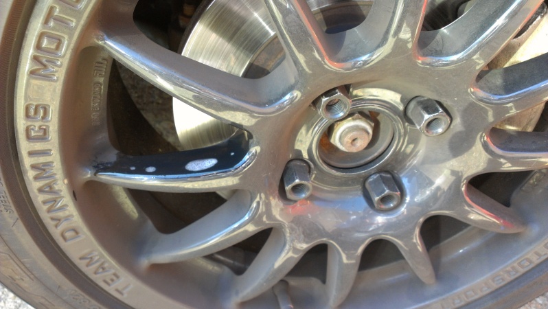

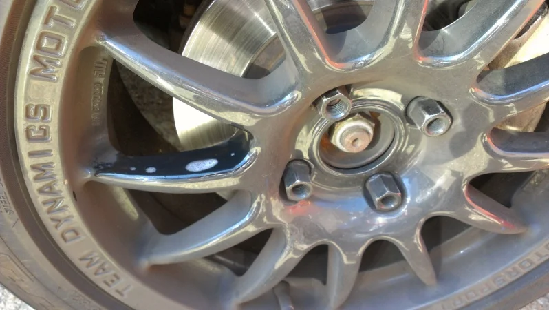

I'm looking at getting a stud and nut kit due to my polarised TPI bolts going rusty and the ease of removing my wheels ect and was just wandering what other people have got.
Post away :)
  Evo 5 RS
TPI bolts
Jekyll
Same fletch. Really disappointed with the TPI bolts tbh mate. It's a nice looking bolt and really let's the rest of the wheels, brakes etc down.
Been looking at lug nuts, just seeing what other people have got.

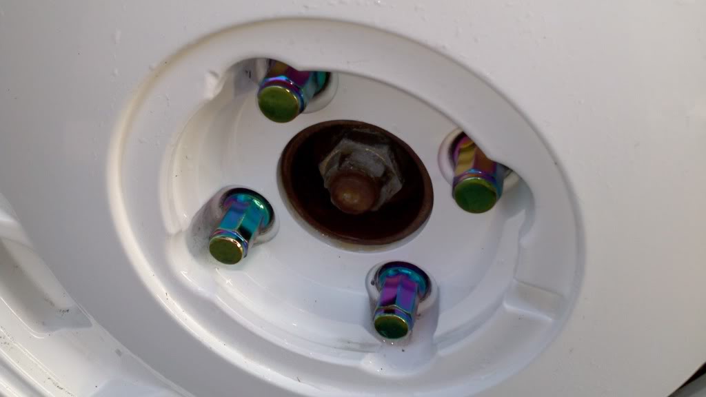

Mike I like what you've done on your calipers.
  TT QS
Thats the kinda thing I'm looking at. Fancy yet subtle. Is there any downfalls with having the nuts open ended?
I'm really not sure yet. They went on late Thursday and its snowed since then and the car hasn't moved. Sorry pal. I am pleased with them and they weren't mega money's either

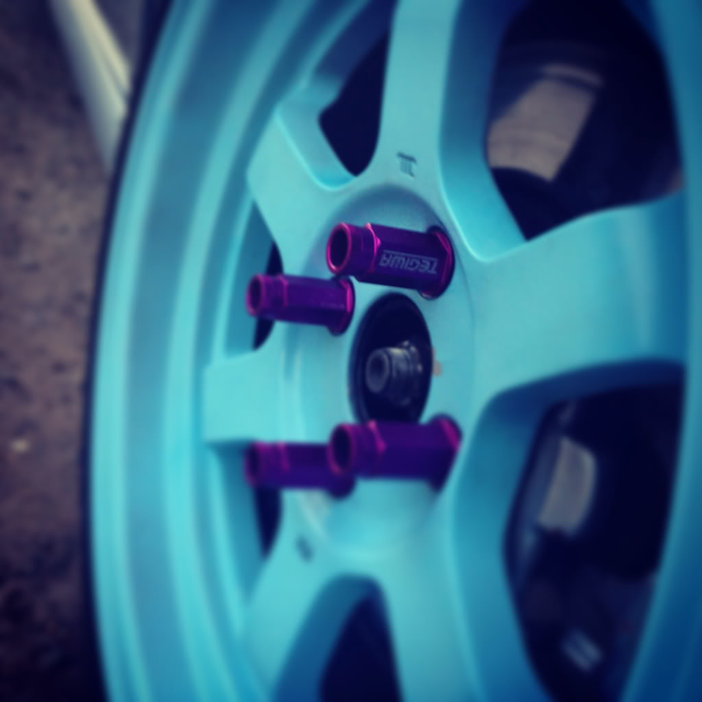

and the tegiwa ones
http://www.tegiwaimports.com/tegiwa-aluminium-alloy-wheel-lug-nuts-locking-959/
tbh id just use the rarerims chat if you want the same nuts as me as i had it ordered in 10 mins and came like 2 days later.

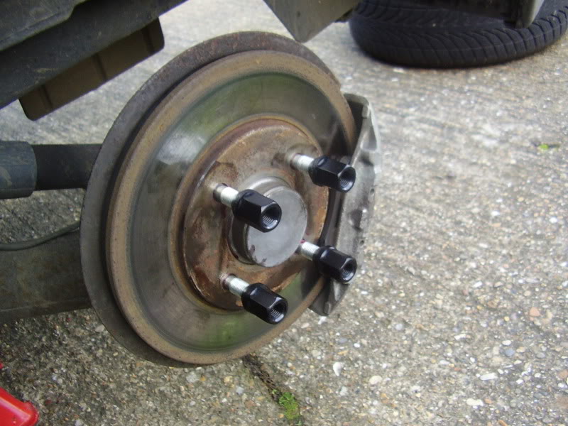

and billy theres a guide on here by Bonxy (i think...) abit of locktite and it was done in about and hour and a bit.
bit of an essay but i think its all covered lol

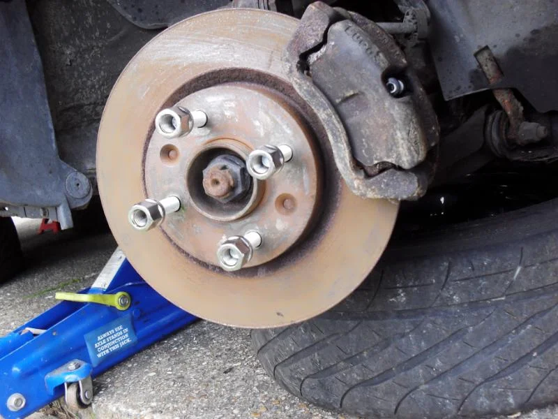

So stupid question time.
I have a Mk3 with 20mm spacers (FK B Centric from Venom), and will probably end up taking wheels on and off from time to time.
What sort of thing would I need to convert to studs and nuts?
Jekyll
You would need the studs (measure your bolt thread size and add the spacer size on top to get the stud size. I think it's m12 x 15 x your length) some wheel nuts (again m12x1.5 thread) and locktight. Add some locktight to the nd of the stud and screw in, then leave to dry. Once dry add your spacers and replace the wheels and clamp up with your nuts.
