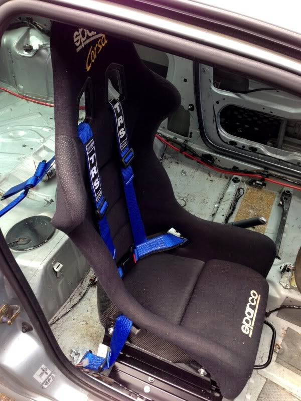

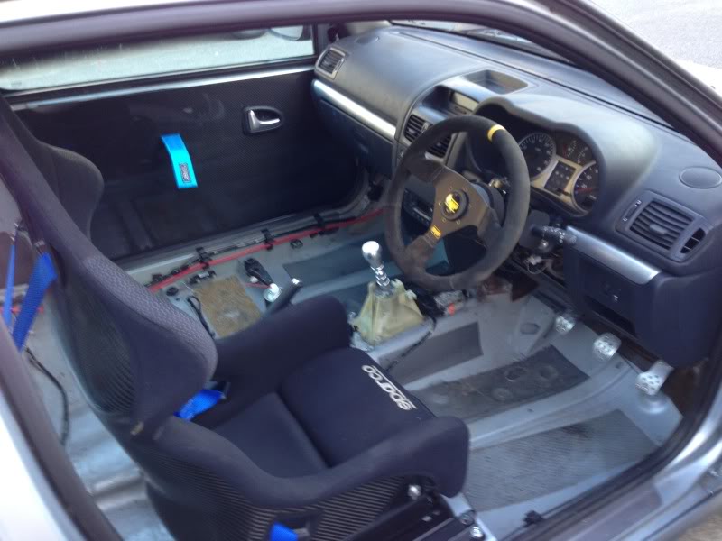

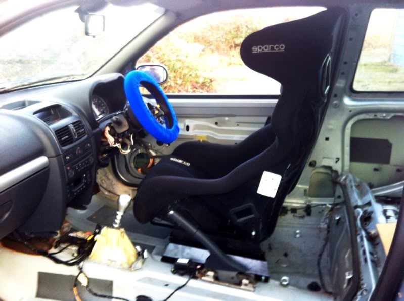

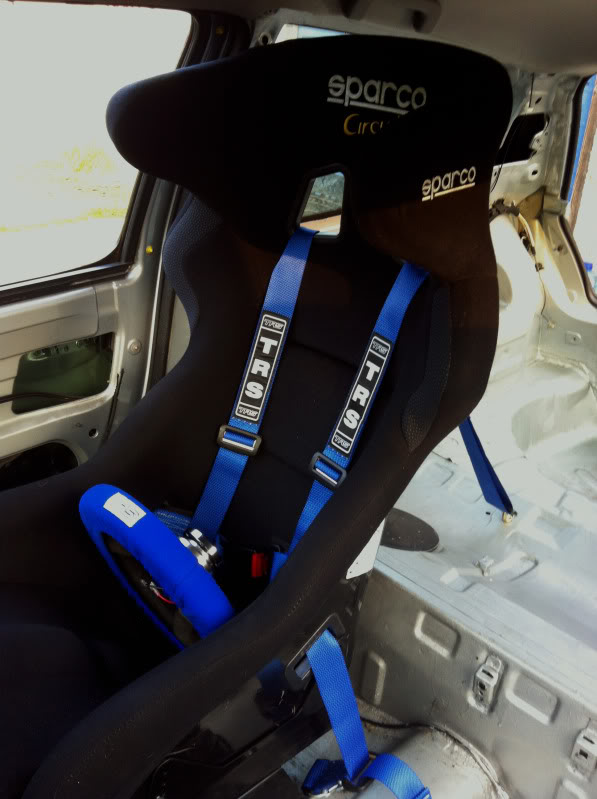

Not made alot of progress, but this weekend i fitted the new alternator and driver's seat
Next job is to fit the carbon door cards and harnesses

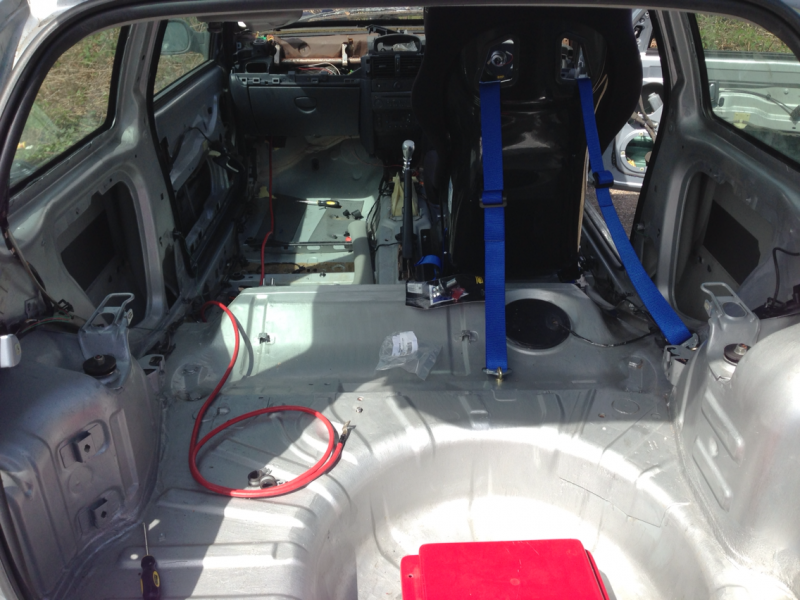

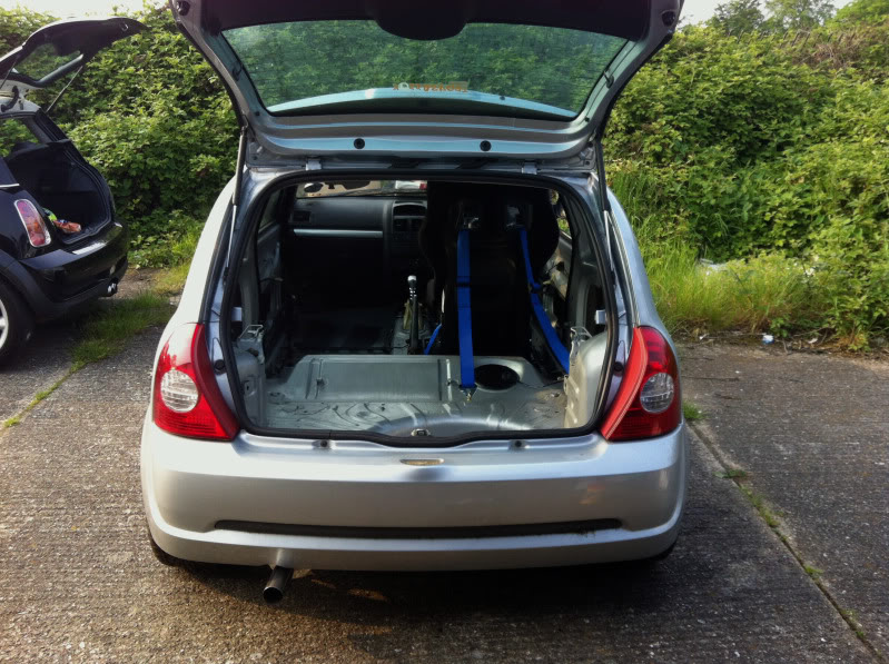

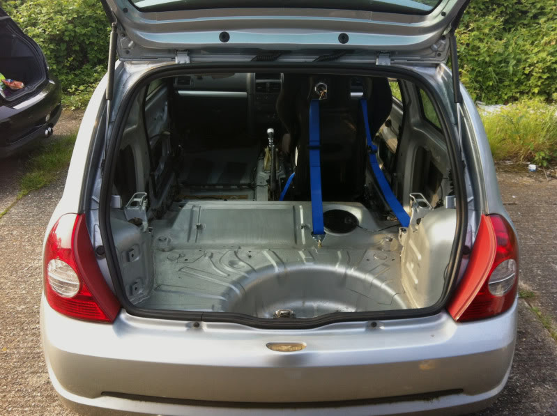

Been back up working on the car today, decided to give the back a clean up.

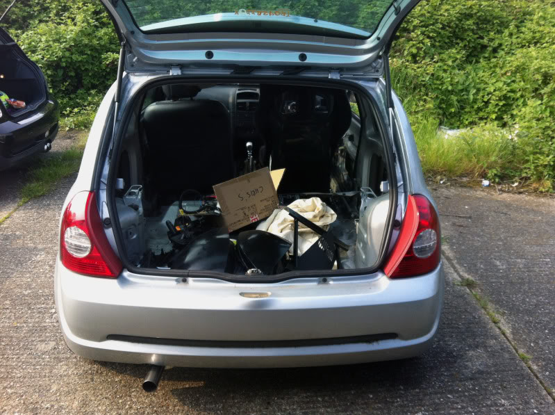

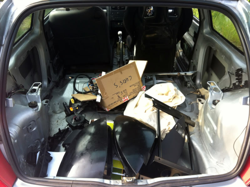

Started out with a boot full of bits and pieces

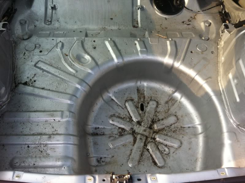

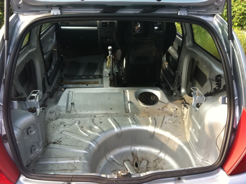

Cleared out, could now see how dirty it was
Gave it a quick clean up (forgot to take after pics though).

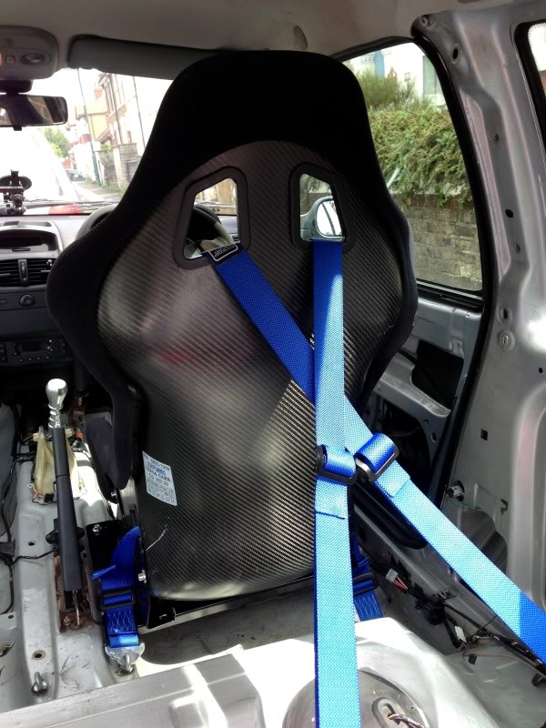

Then I decided to put the driver's harness in, I used the original seat belt mounting points. I understand from reading on here that this will be fine as a short term solution until the cage is fitted ?

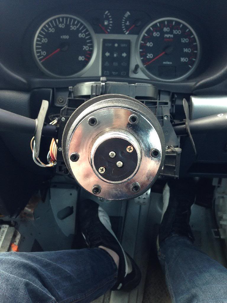

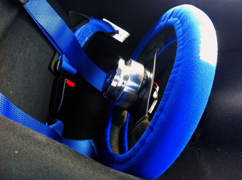

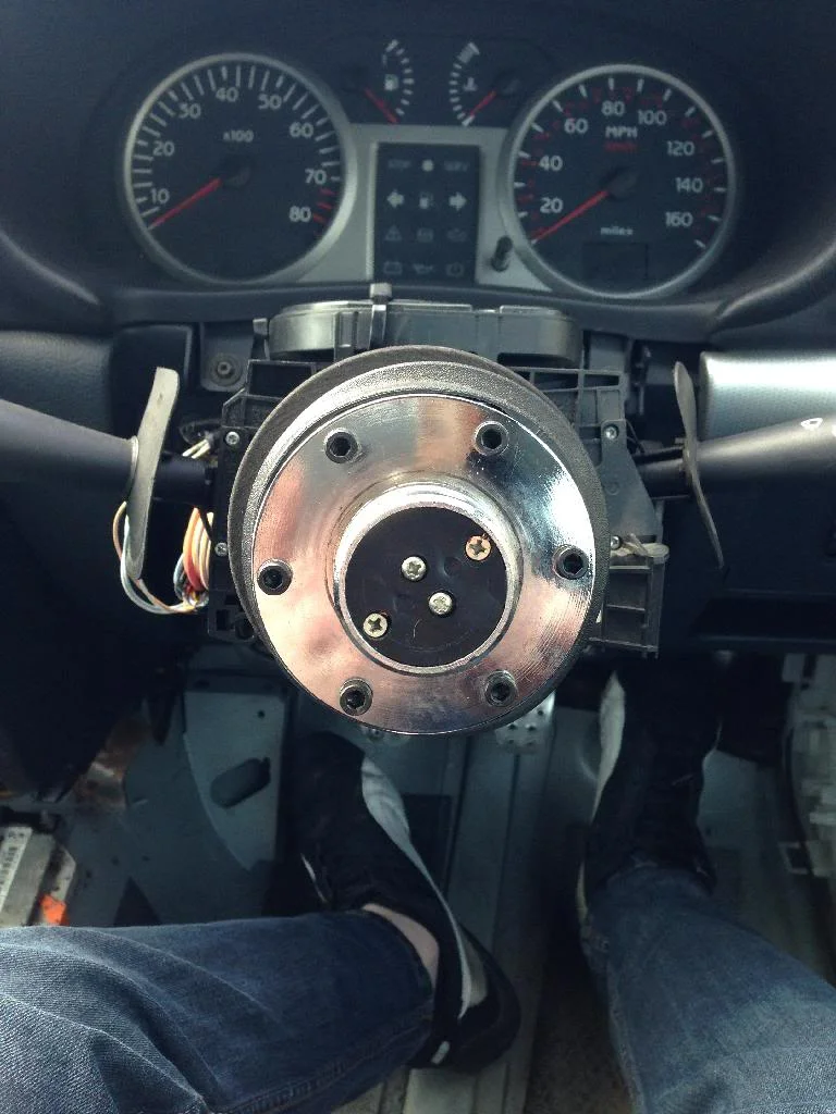

After that I decided to get my removable steering boss fitted, did most of it but i need some ends for the horn connections

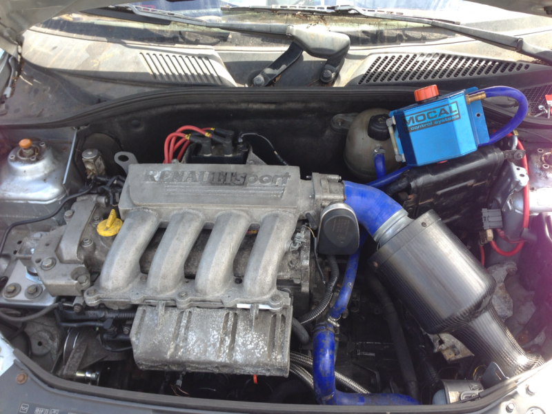

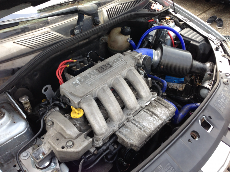

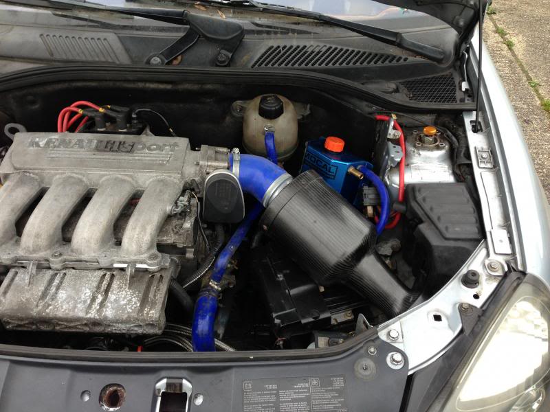

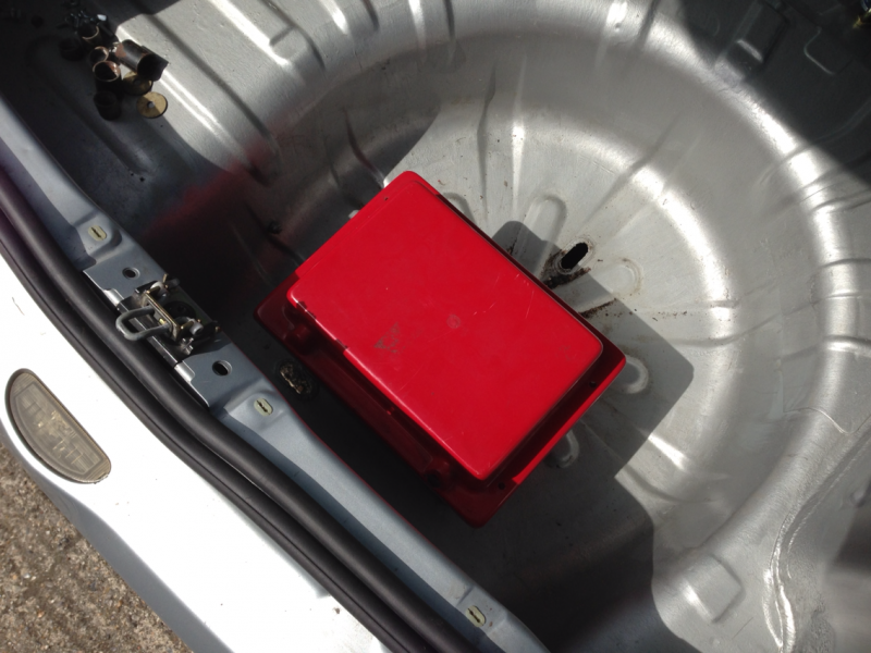

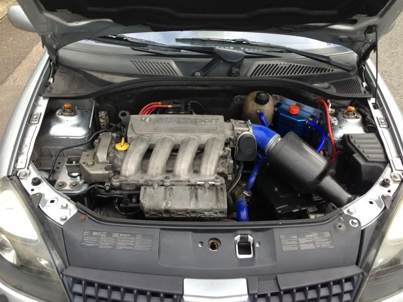

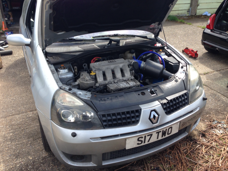

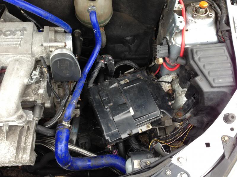

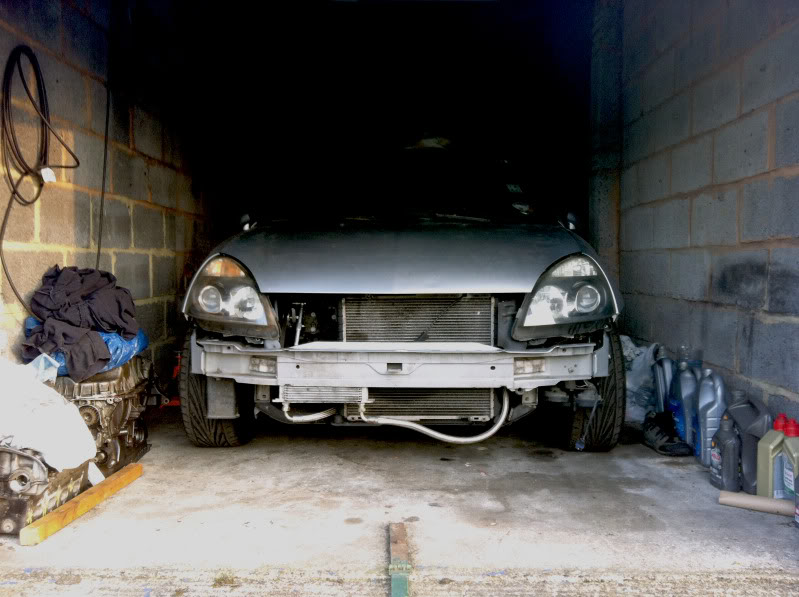

This week my KTR induction kit arrived, i had decided to leave the battery in the front for the time being.

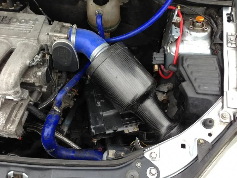

Anyway, after doing some more reading on here, i went up to the car today and ended up moving the battery by routing the cable through the bonnet catch cable hole.
Which left me plenty of room for my ITG airbox, i just need to work out where the catch tank is going to go now
And thats it for now, i'll probably be putting the KTR induction kit back up for sale on here this week

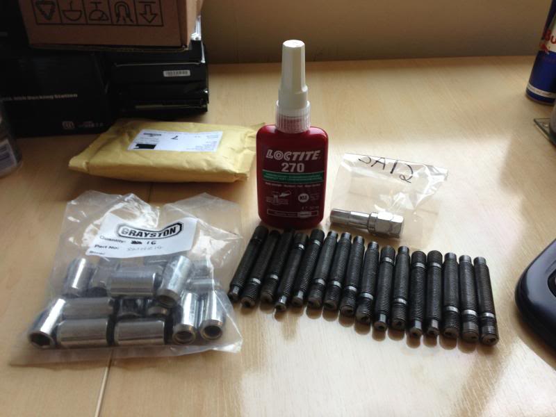

​In the next week or so i'll get a stud conversion kit ordered.

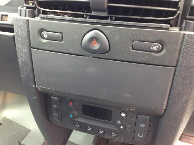

First couple of jobs i did was to finish wiring up the horn (just need find the horn button now) and fit the stereo blank

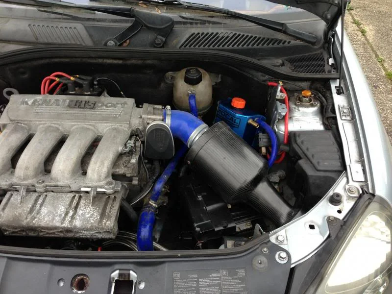

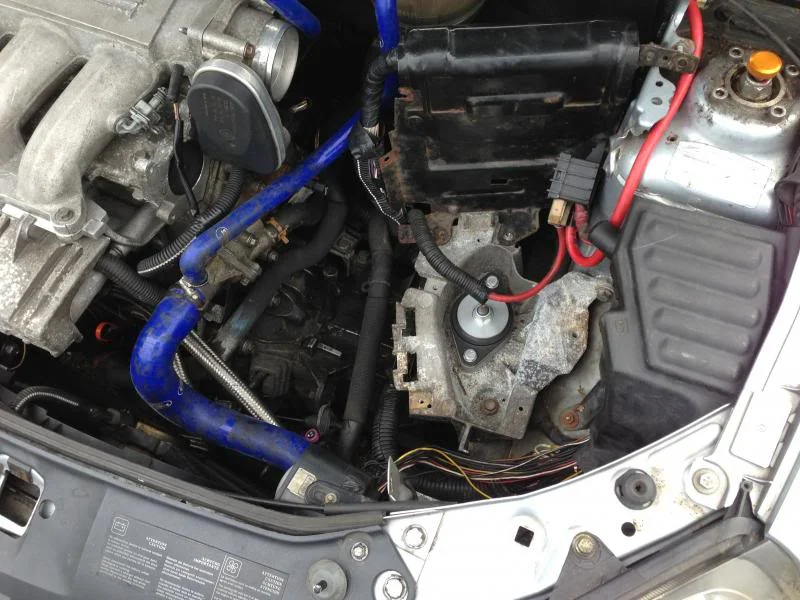

Finding somewhere to mount the Mocal catch tank was something i'd been putting off, after doing some reading on here i decided the solution might be to move the ECU.
So basically i laid it on top of the gearbox mount
Before
After
Airbox in place
Catch tank roughly where it'll be (i ran out of time to actually mount it)
Overall i'm happy as the essential to do list is quickly shortening
I'm putting off fitting the stud conversion for the time being because of the time required for the loctite to set before refitting the wheels. This might have to be a job for when the car's back on the road and i can do it at home.

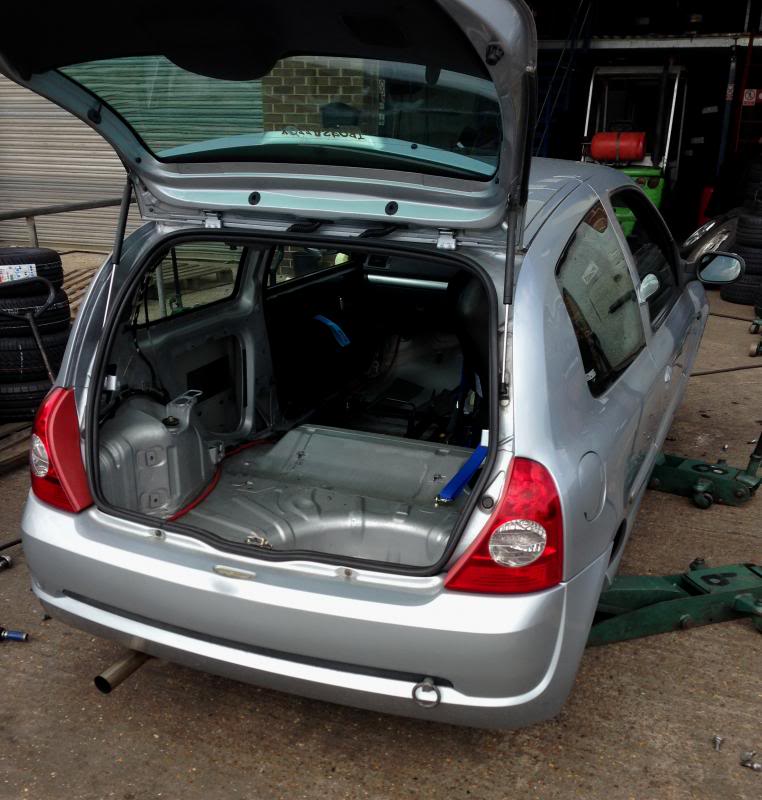

After being messed about by the garage i took the car to, Matt@codered collected it for me a few weeks back and set about trying to get it sorted out. After a new driveshaft, new cambelt, correcting the timing, sorting out the interior wiring and clearing numerous faults it's now passed it's MOT.
There's still a few jobs that need doing but it's finally getting close to being back on the road.

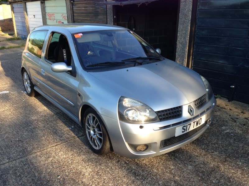

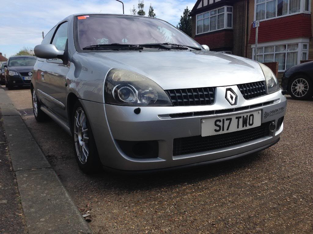

Good news at last, I'm collecting the car from Matt tommorow.
So after 4 years its back together and on the road, really can't wait to collect it now.
It'll be interesting to see how it compares to the 182, with the extra work it should be even quicker i hope.
Just got back from collecting the car.
it feels like a harder ride than the 182 with the AST's on their current setting, it goes well but i didn't really get chance to have a good play with it. Also it's the first time I've driven a car without power steering since I tried my brothers old mini, it wasn't as bad as I'd expected tbh. The good thing was I had no running issues and even got 29mpg out of it.

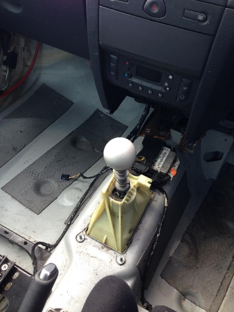

Only issue I did have was the B&M short shift got extremely stiff once hot. Think it's a common issue with these but I'm not sure if there's any solution other than putting more grease in it ?
Can't wait to go for a good long drive in it tomorrow now.
Thanks to Matt@codered for the work he's done on it, I think I'll be taking it to him from now on.

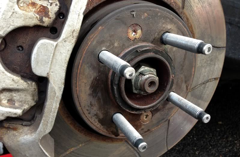

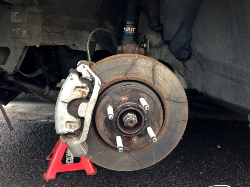

Well the rain yesterday ruined my plans for working on the car, but today I got going on it.
Fitted the first 8 wheel studs, got another hour or so before I can do the others

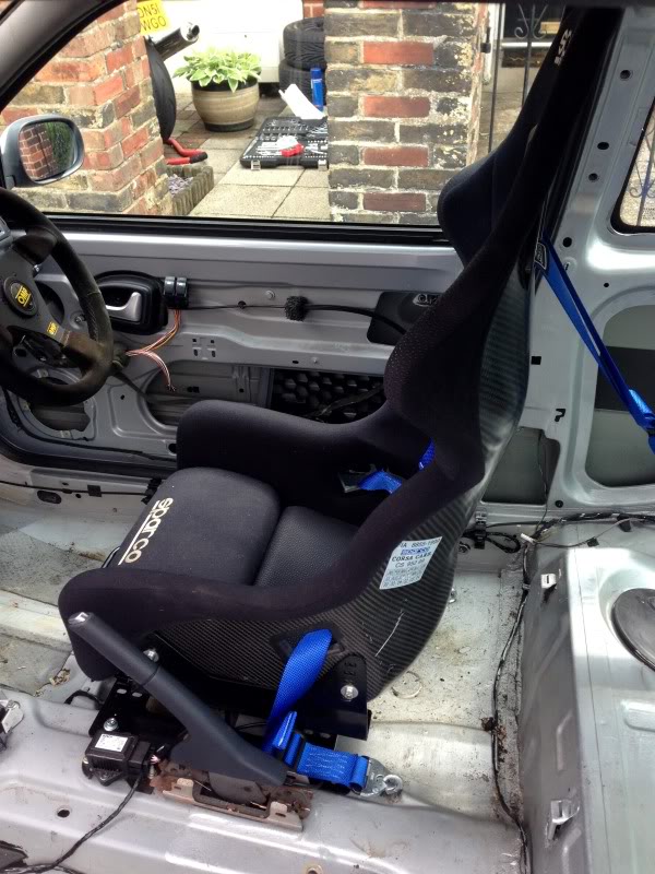

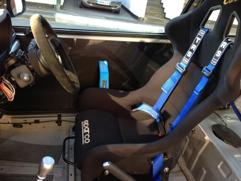

Meanwhile I swapped the drivers seat over with what was going to be the passenger seat.
The Circuit seat is nice but it's a bit tight for me and I just didn't feel comfortable enough in it, so it'll be for sale later.
I've put some more grease in the short shift so I'll have to take it for a spin once the stud conversion is done. Hopefully it's loosened up as I'd like to take it to Brands on Thursday if I can get the time off work.

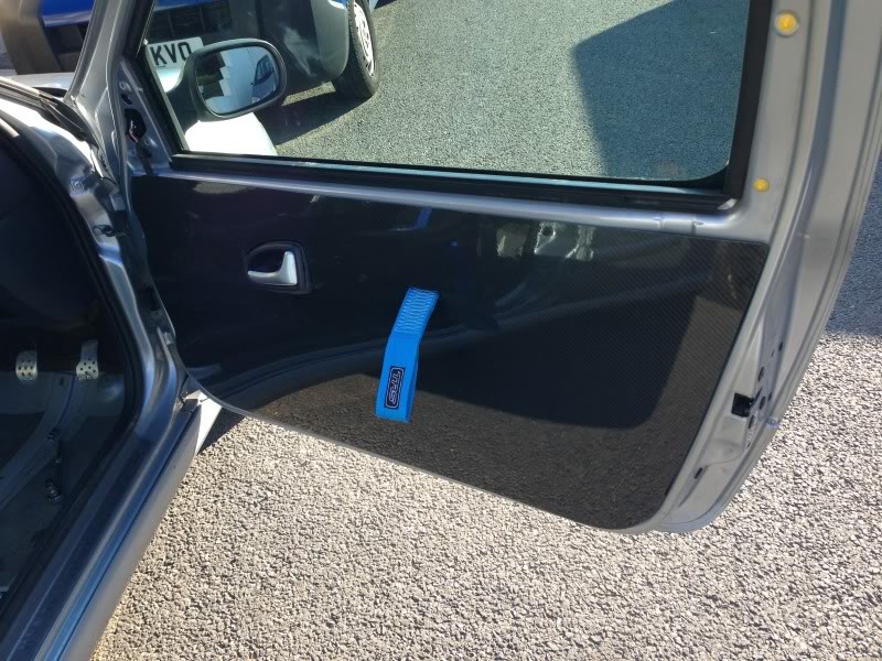

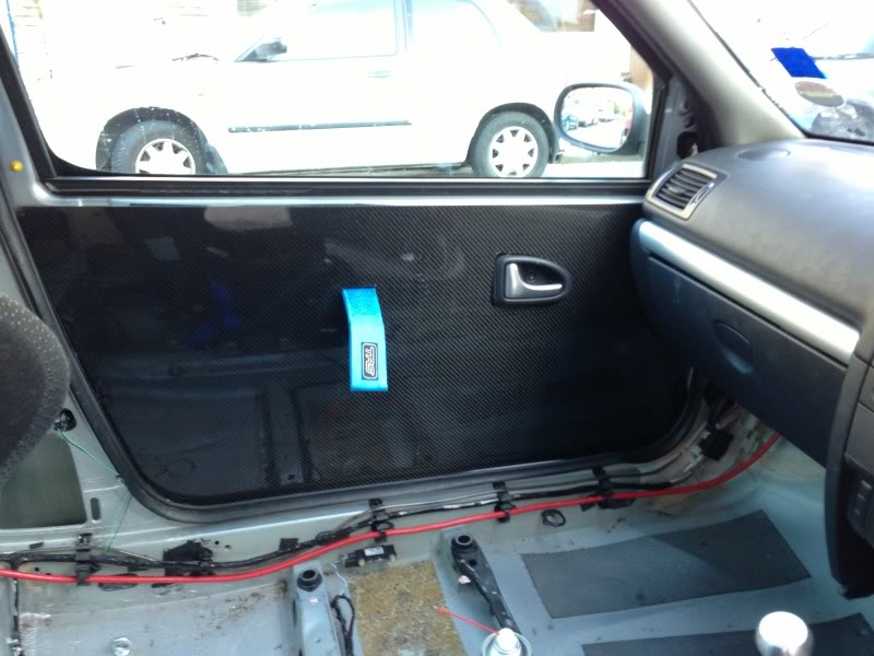

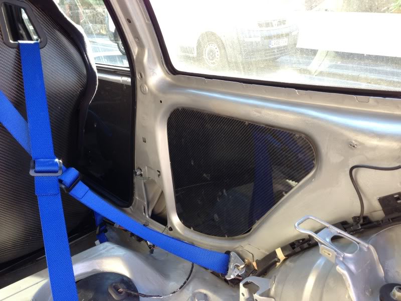

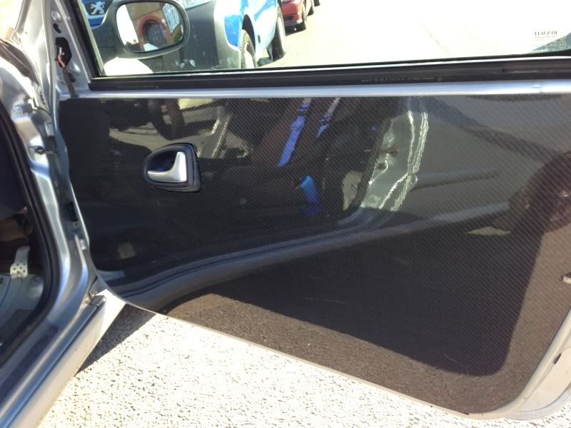

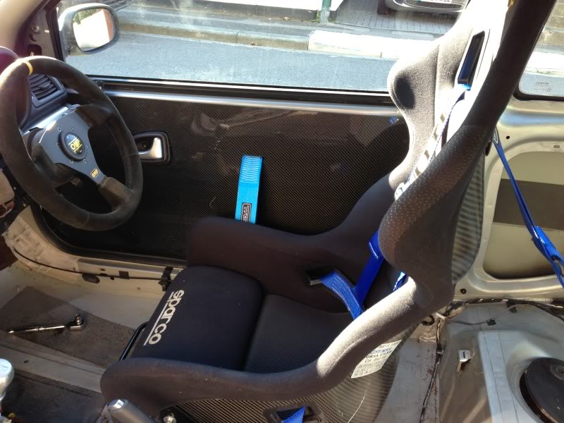

Had a go at fitting the carbon door cards and grab handles today. I wasn't very precise with my measuring or cutting and it was a bit of a disaster. Finally got them done though and they don't look as bad as I was expecting (it is only a track car after all).
Door handles on
Grab handles on
Rears in, although I didn't realise how marked they were
And finally a quick engine bay pic

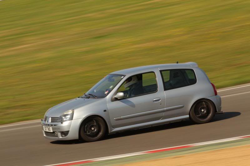

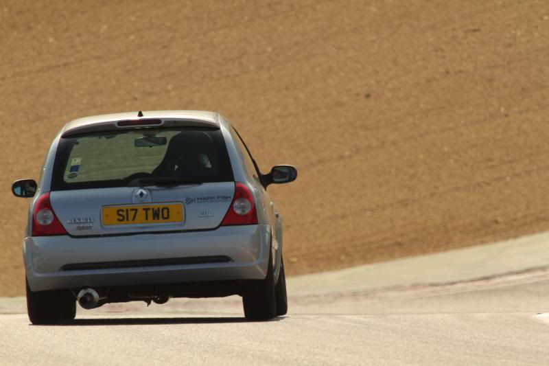

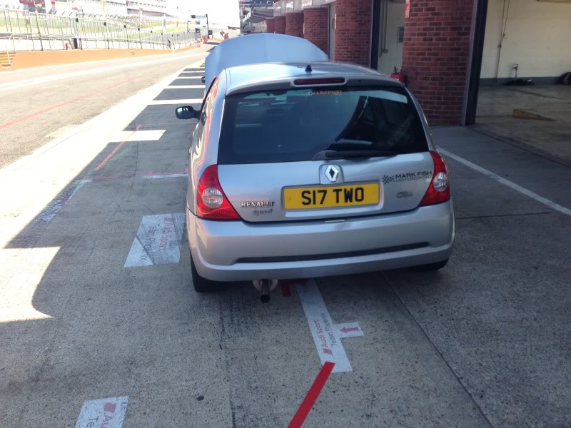

So i did Brands this morning, i was a bit nervous and hoped the car would perform well and not let me down.
I only remembered to take one pic but i tried out Harry's Lap Timer app on my iPhone so i'll have to go through the videos when i get in from work.

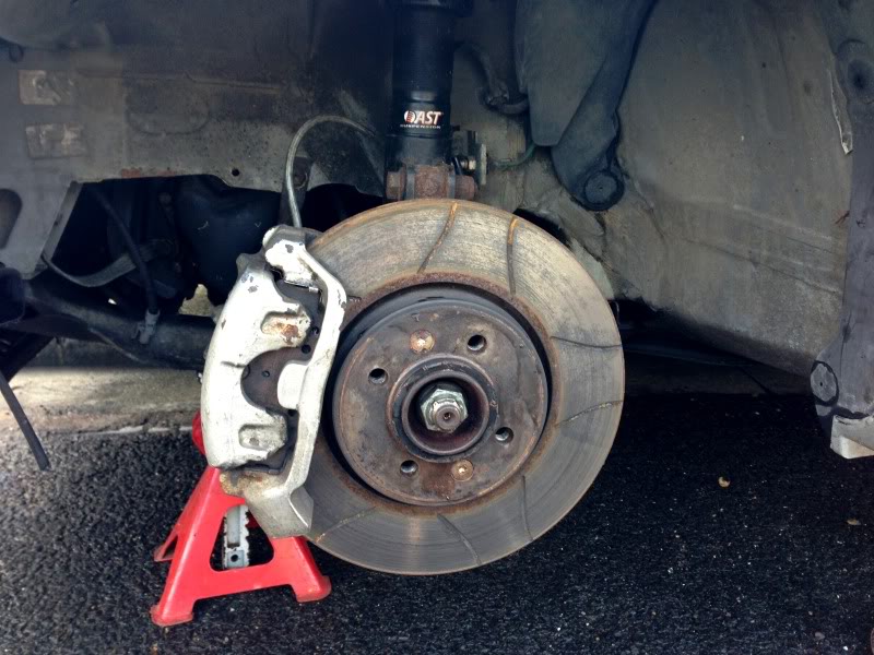

Only issues are i appear to have broken or bent something on the front suspension as the steering wheel is no longer in the correct position when the wheels are straight so i'll to get the wheels off and have a good look at it. Also about 15 mins from the end of the session i started getting a rattle from the exhaust, i'll have to get under it and have a look at that aswell.
It took me a while to get used to the track but overall i really enjoyed it and can't wait to go back out again asap (although i think it'd be a good idea to get it mapped first)
Most importantly though is it got me home with no serious problems :D
Here's some pics from the MSV website
And a quick iPhone video from mid way through the morning, think i need to find an external mic next time and also adjust the positioning a bit
I was getting quicker as the morning went on but there's obviously plenty of room for improvement (like braking alot later and carrying more speed through Paddock Hill bend for example)

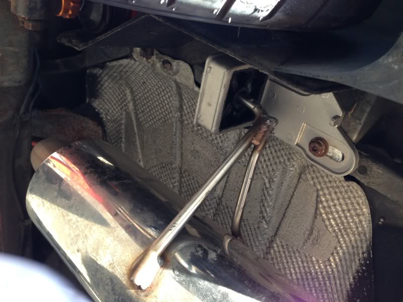

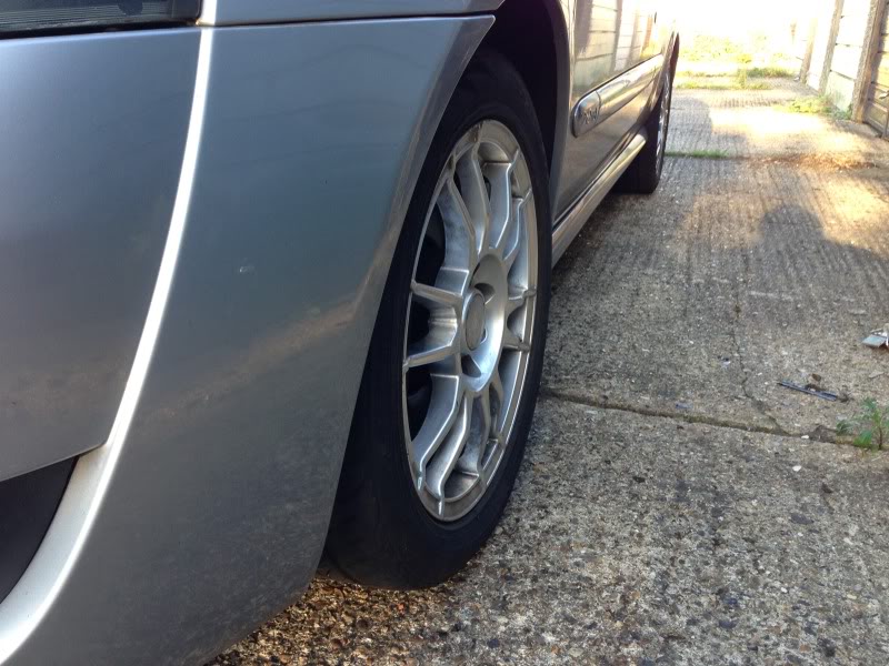

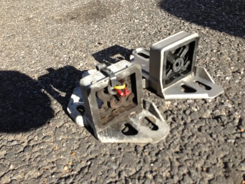

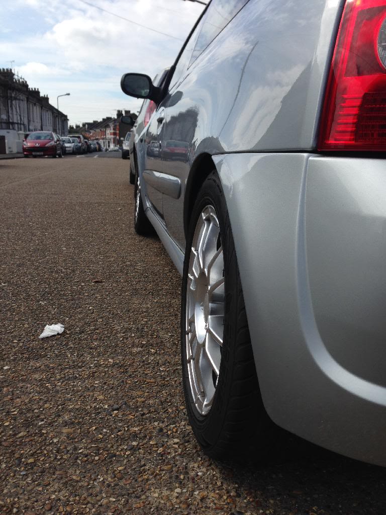

Swapped the exhaust mount over this evening.
I did contemplate get a Prima Racing one but I figure the Oreca is pretty light so it's not worth the extra cost.

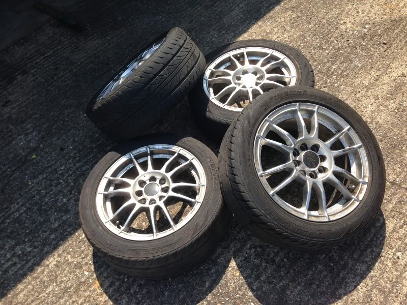

Also took the 16's off and put the 15's on

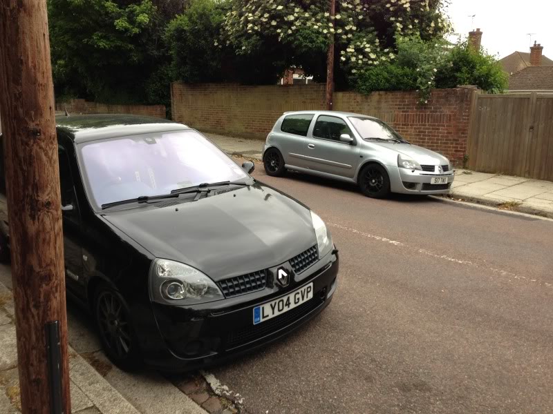

I'm not liking the silver on silver, I think they need to go black or red

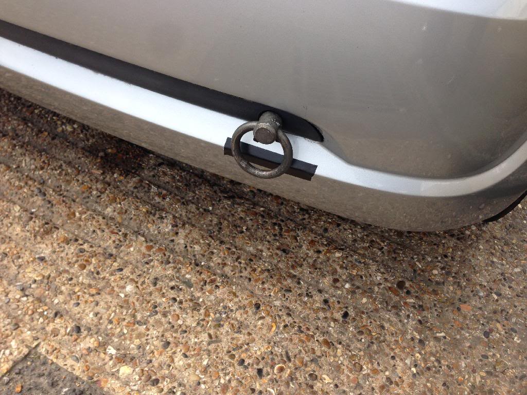

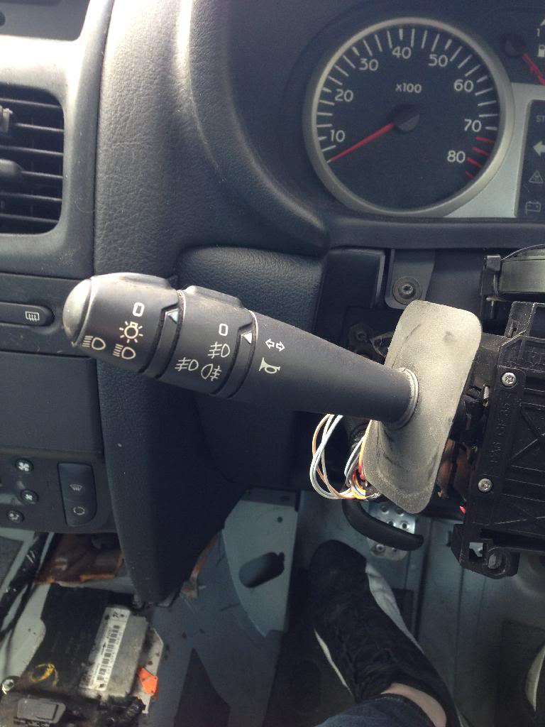

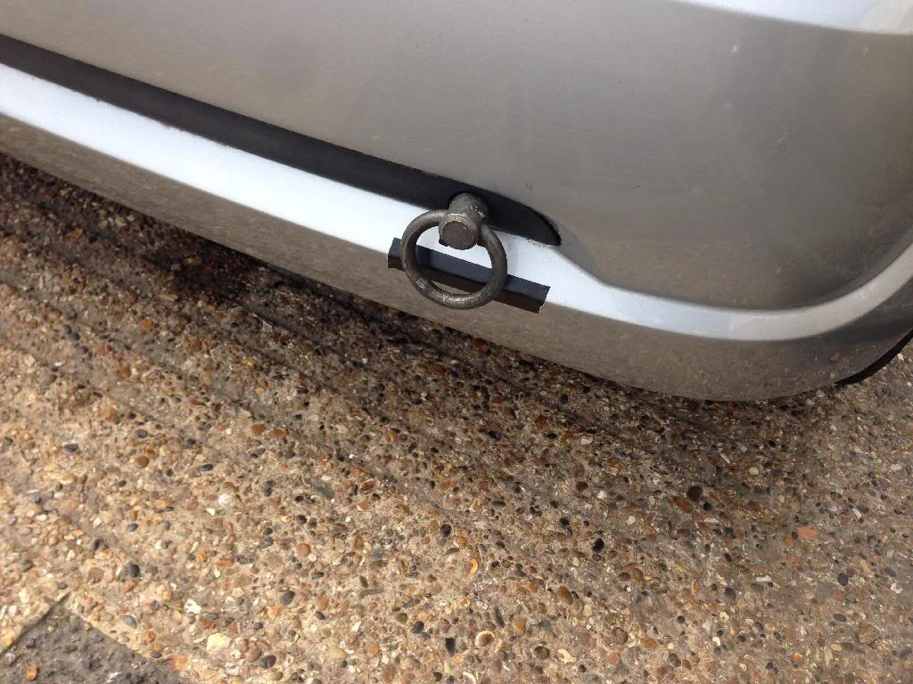

Been and collected the car from Matt at Code Red today, he's done the following :
Fitted the front splitter I've had in the garage for over a year
Fitted my rear cup racer towing eye
Fitted a PH1 stalk and Sparco removable steering wheel boss
Replaced the B+M shifter which was sticking when hot with a Ph1 one

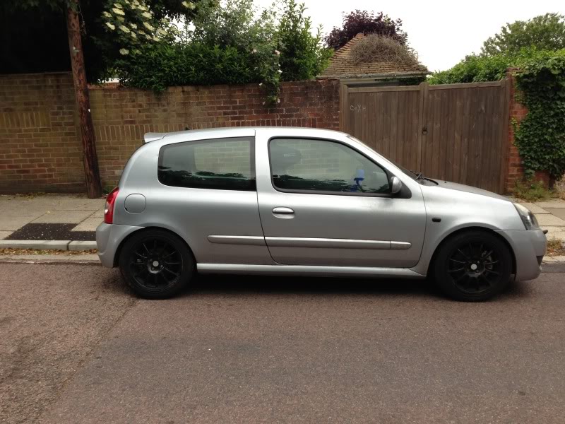

The next job for me this week is to paint the wheels black (not keen on silver on silver) then fit the R888's I have in the garage.
After that I'll sort out getting it mapped once I've decided whether or not to fit an extra centre silencer.

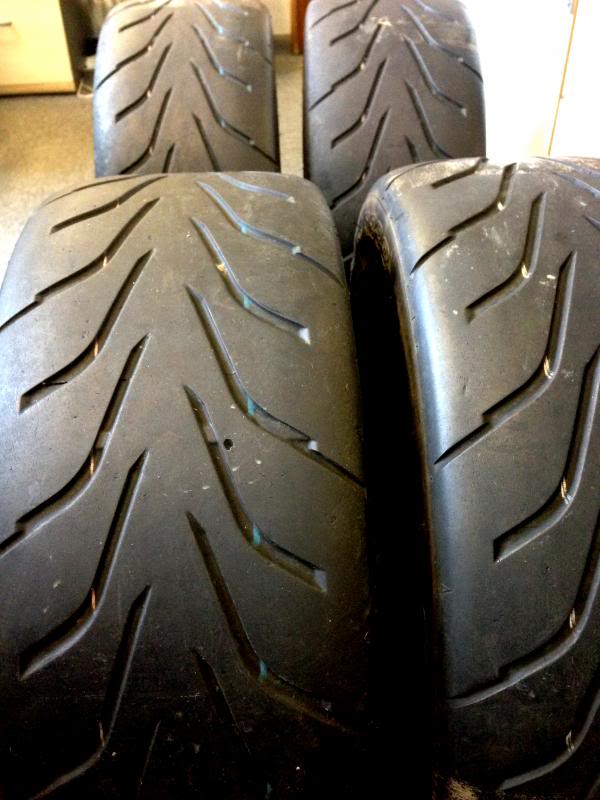

Unpacked the R888's today and checked them over, they were as described with a decent amount of tread on them (even ended up with a nearly new spare aswell).
Then at lunchtime i took them down to be fitted

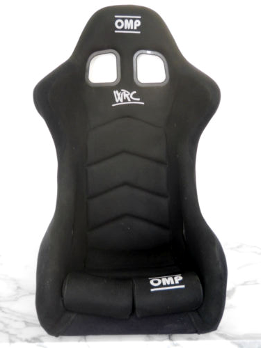

Also won an OMP WRC seat on eBay to use for the passenger side, it's a shame i couldn't hold out for another Sparco one but it's virtually brand new.
I'll get some pics up of the actual seat when it arrives next week and i've bolted it in.
