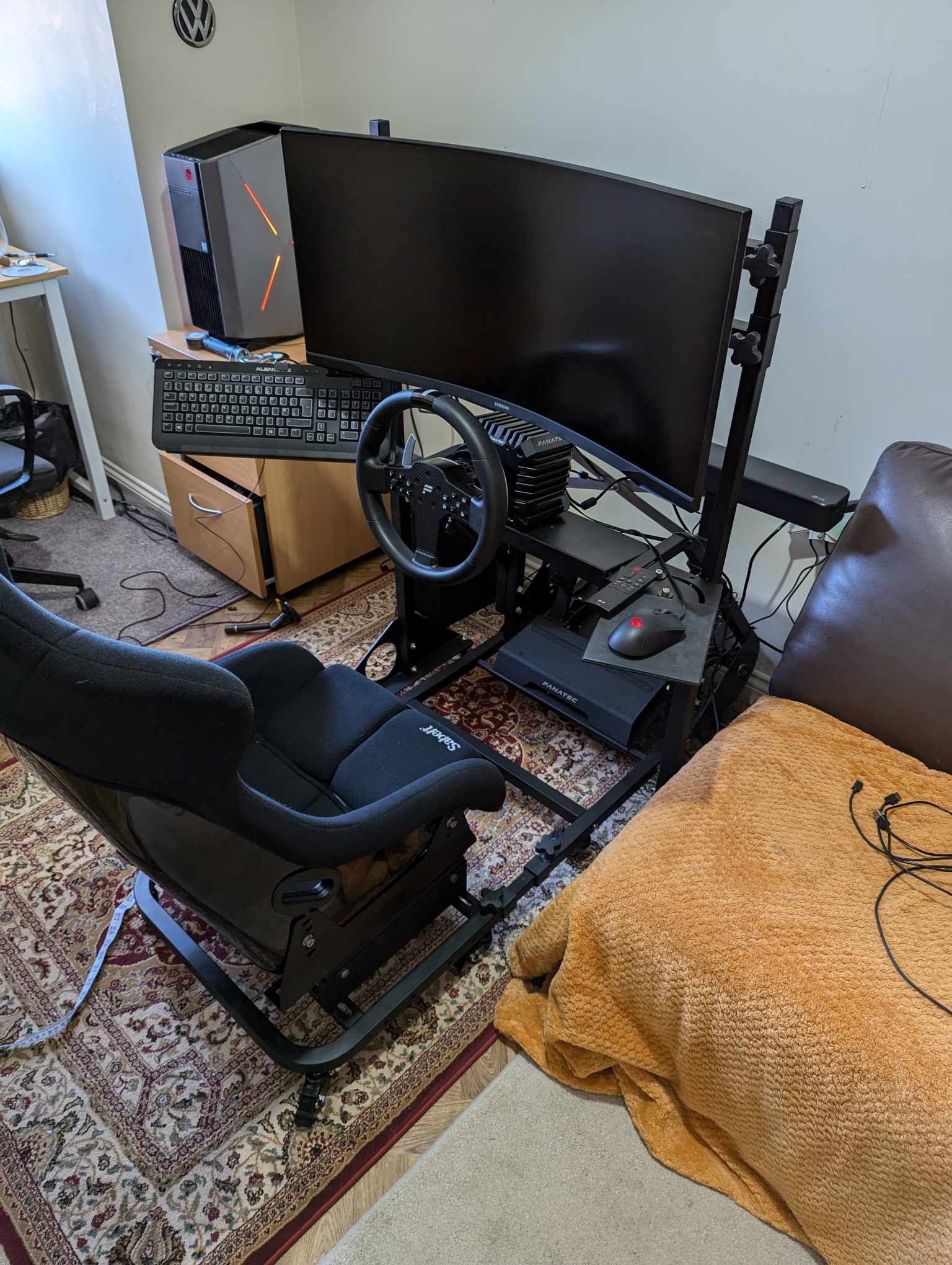

Don't know if the true size of this new monitor comes across on an image.
We are getting there though, chased Fanatec again so will hopefully get at least a decent discount so I can upgrade to the V2 or V3 pedals, shifter and handbrake.
Once I've done that I can finally tidy all the cables and we are done.

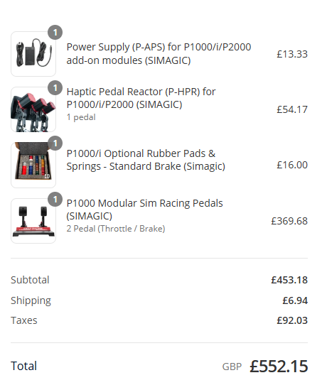

Torn between two now. Been doing a bit of research and the haptic reactors are a must have.
It is either the SimLab pedals because they look cool as and get a bracket 3D printed somewhere t mount the haptics
or just go full SimMagic P1000 + haptics.
N0ddie
  Tesla Model 3
Well that escalated from £150 lol
@N0ddie thank you for opening my eyes I think lol. Buy cheap buy twice.
Good effort bud. I've not read a bad review of those pedals (kinda why I recommend them). The Asetek Invicta pedals I use are awesome. However, I can also see why people wouldn't get on with them (brake pedal that literally doesn't move etc).

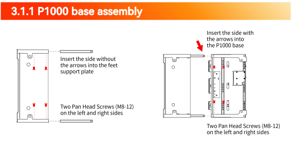

i may have a bit of a solution for the heel plate as well, it fixes on two bars either side then mounts into the pedal base with two screws. I will try sliding it back and just fixing with one screw leaving a gap between the pedals and plate

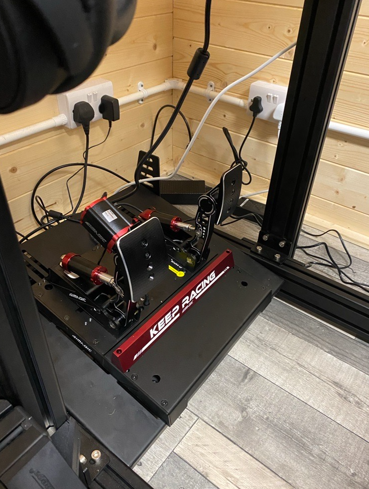

Not sure how well it shows but they are angled forward and the rig base plate is on the first level of incline. With my foor then on the pedal my foot hangs off the back of the heel plate.
So I'm wondering if the angle of the pedal won't make a difference and it is just the lack of length on the heel plate.
Also I've only adjusted the brake so far moving it as low as it goes and angled the pedal down more.
Matt Cup
  Leon Cupra

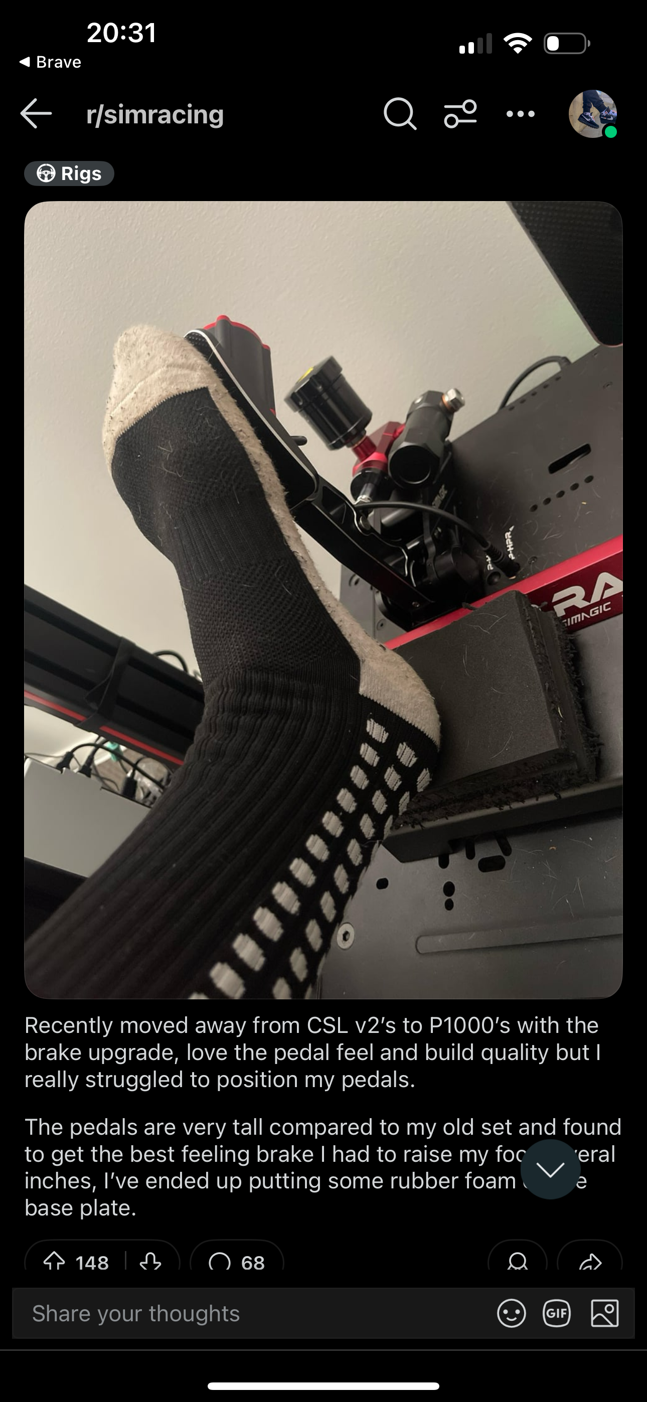

Someone on reddit added foam to raise his foot.
Yours seem to lean forward quite a bit too is that normal?
mace¬
  Clio
Can you not bin those rear angle brackets off and mount the base plate directly to the channels in the aluminium side bars?
Yes I could, but looking at it I've got the front of plate mounted in the lower holes of the alu profile. If I put it in the top and drop it down to the lowest level that will help massively.
As above, I think my leaning to far forward is the way I have the rig setup so will need to modify that, Looking at that image the pedals don't seem to be moved down to their lowest setting which would help massively.

Can you slide the pedal faceplate down a hole or 2? Also, remove the angle on yer pedalplate. This'll get you your angle sitting nicely. Braking force can take a chunk of time to get right for you.

I can't get the pedal plate undone now lol. I'll get the thing in the air on the weekend and do some alterations. I'll report back my next failure then.
mace¬
  Clio
Spent yesterday evening playing with the rig, plan was to go completely flat with the pedal plate and use the aluminium profile to fix it into, that hit a snag when I realised I'd need to take the whole front off to slide the nut things in. Ended up just going to the lowest level on the mounting points and moved the pedals further back, it is night and day now better. So it was my setup and not the pedals on the angle they sit.
Still think the heel plate could be longer but with the pedals flatter it is just about enough.
