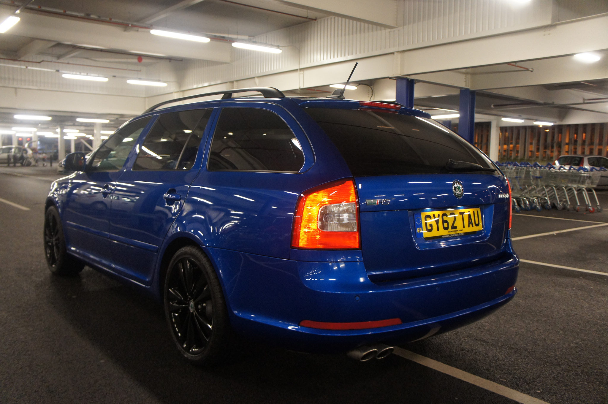

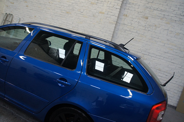

We don't have any before pics unfortunately but the car was naturally quite dirty after the 100 mile+ drive to us. Given that the window tint install process can involve some 'overspray' from the slip solution which is unsightly if left on the paintwork - we provided a 'safe wash' on the Octavia as part of the process, before beginning the install and then wipe the Slip Solution excess away with a Quick Detailer like Zaino Z6.

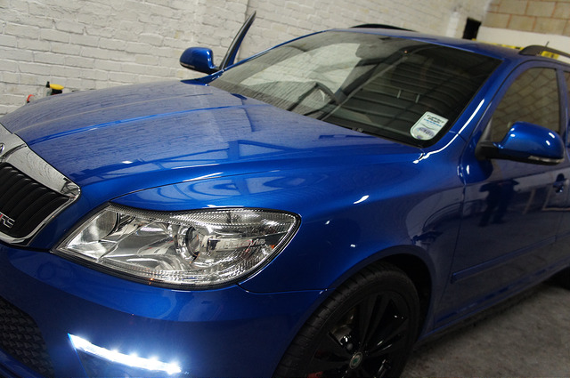

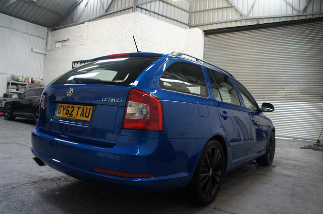

Some pics after the wash and drying phase, before we began the film install:
DSC04256 by RussZS, on Flickr
DSC04259 by RussZS, on Flickr

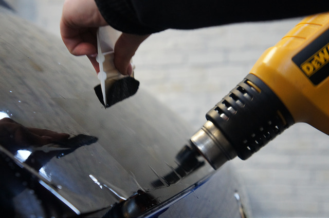

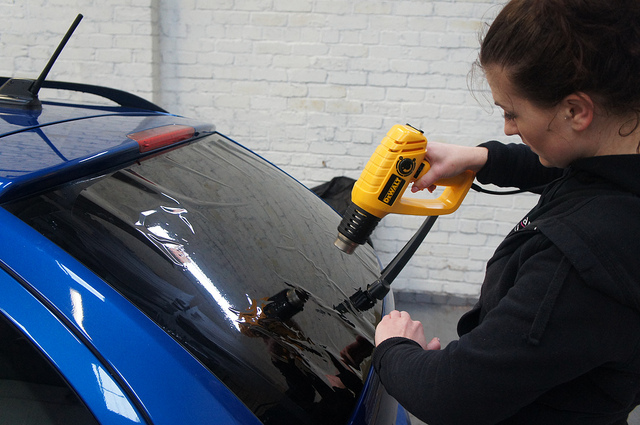

Next we do a 'rough cut' around the window shape and then begin shrinking the film using a heat gun to shrink the film to the contours of the glass:
DSC04262 by RussZS, on Flickr

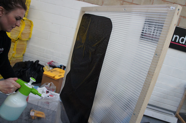

Next the film is subjected to a wet test:
DSC04263 by RussZS, on Flickr
The excess 'fingers' still present are then shrunk using the heat gun:
DSC04266 by RussZS, on Flickr

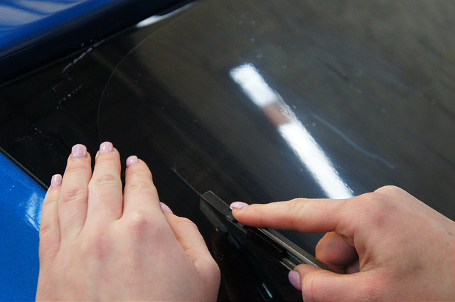

Next is the 'final cut' which is a neater final cut in line with the matrix on the rear window:
DSC04268 by RussZS, on Flickr

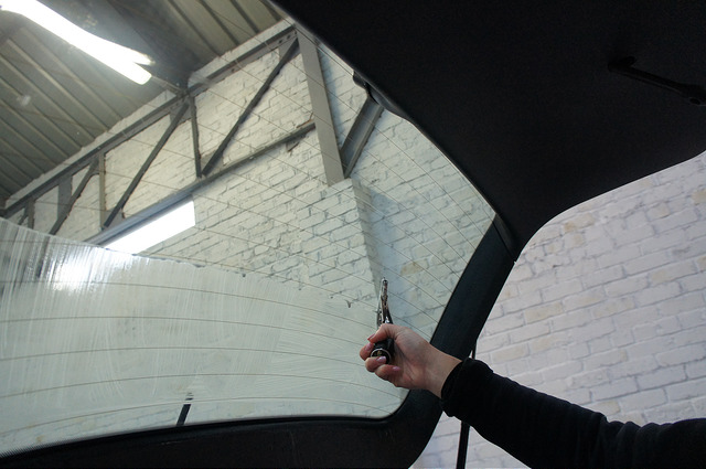

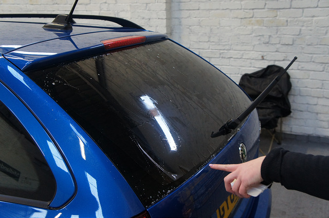

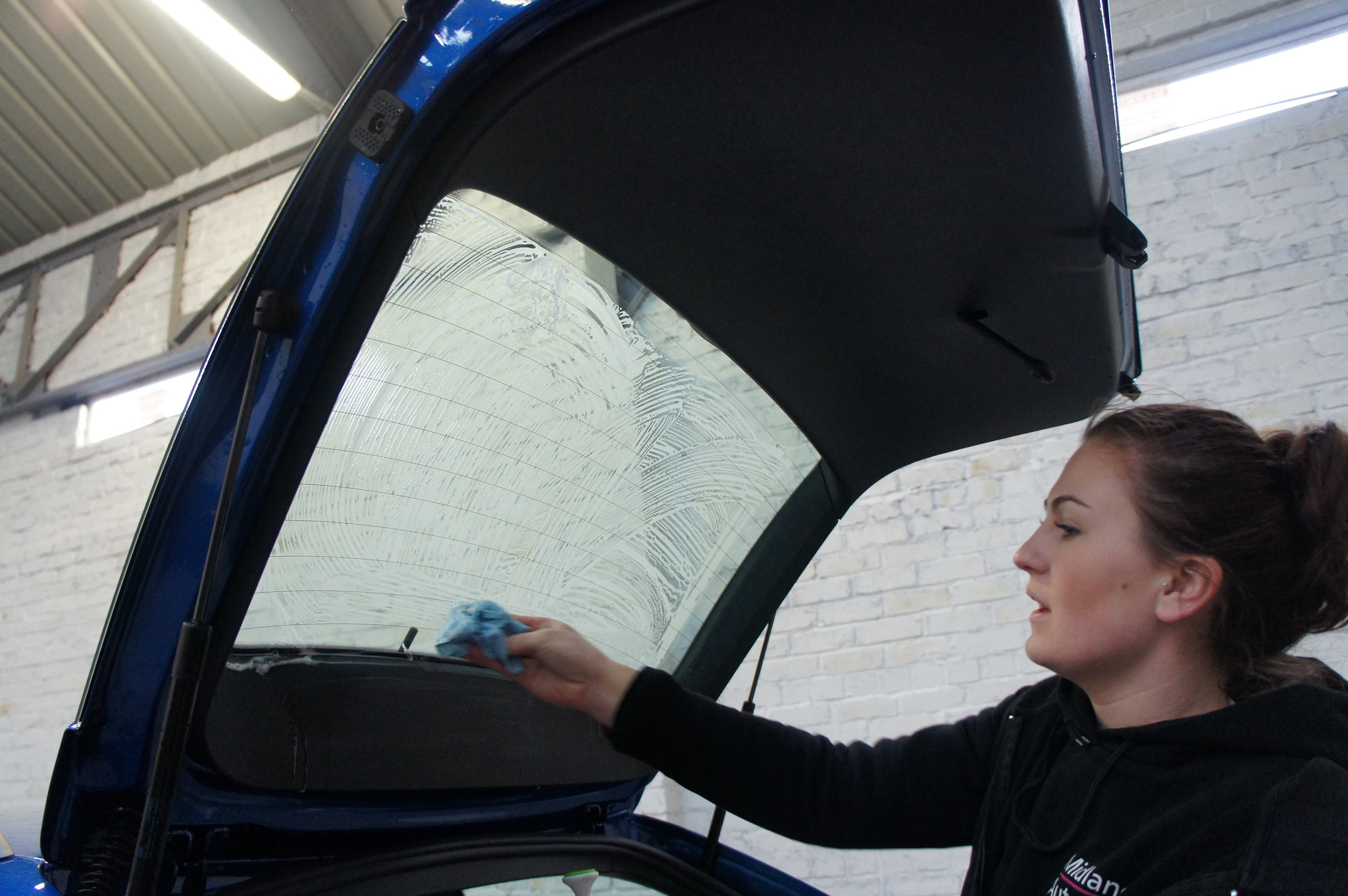

Window is cleaned and prepared for film install using wire wool and slip solution (a mixture of Baby Bath and Water):
DSC04269 by RussZS, on Flickr

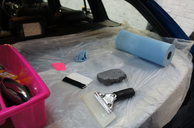

Plastic sheeting is used to ensure no excess slip solution drips on any of the interior or trim:
DSC04270 by RussZS, on Flickr
DSC04274 by RussZS, on Flickr
The cleaning process is completed twice on the rear window to ensure its as clean as possible to ensure proper adhesion from the film.

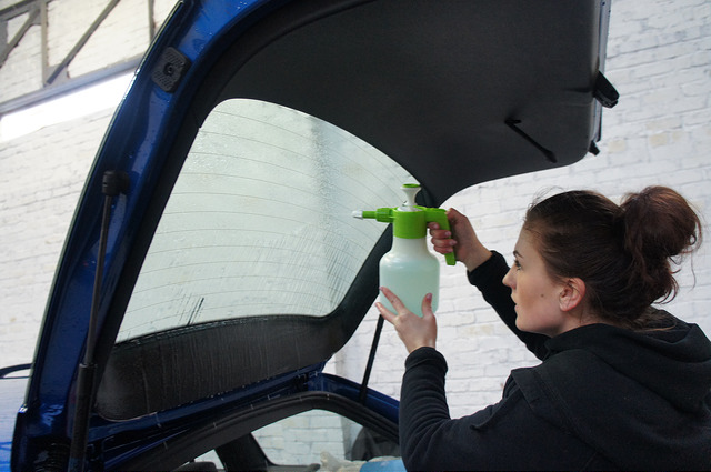

After the cleaning stage we are ready to install the film. 'Flushing' is used to aid the installation:
DSC04278 by RussZS, on Flickr
The film is also covered in slip solution when the backing film is removed:
DSC04279 by RussZS, on Flickr
Next the film is placed onto the interior and any excess air and water is pushed out.

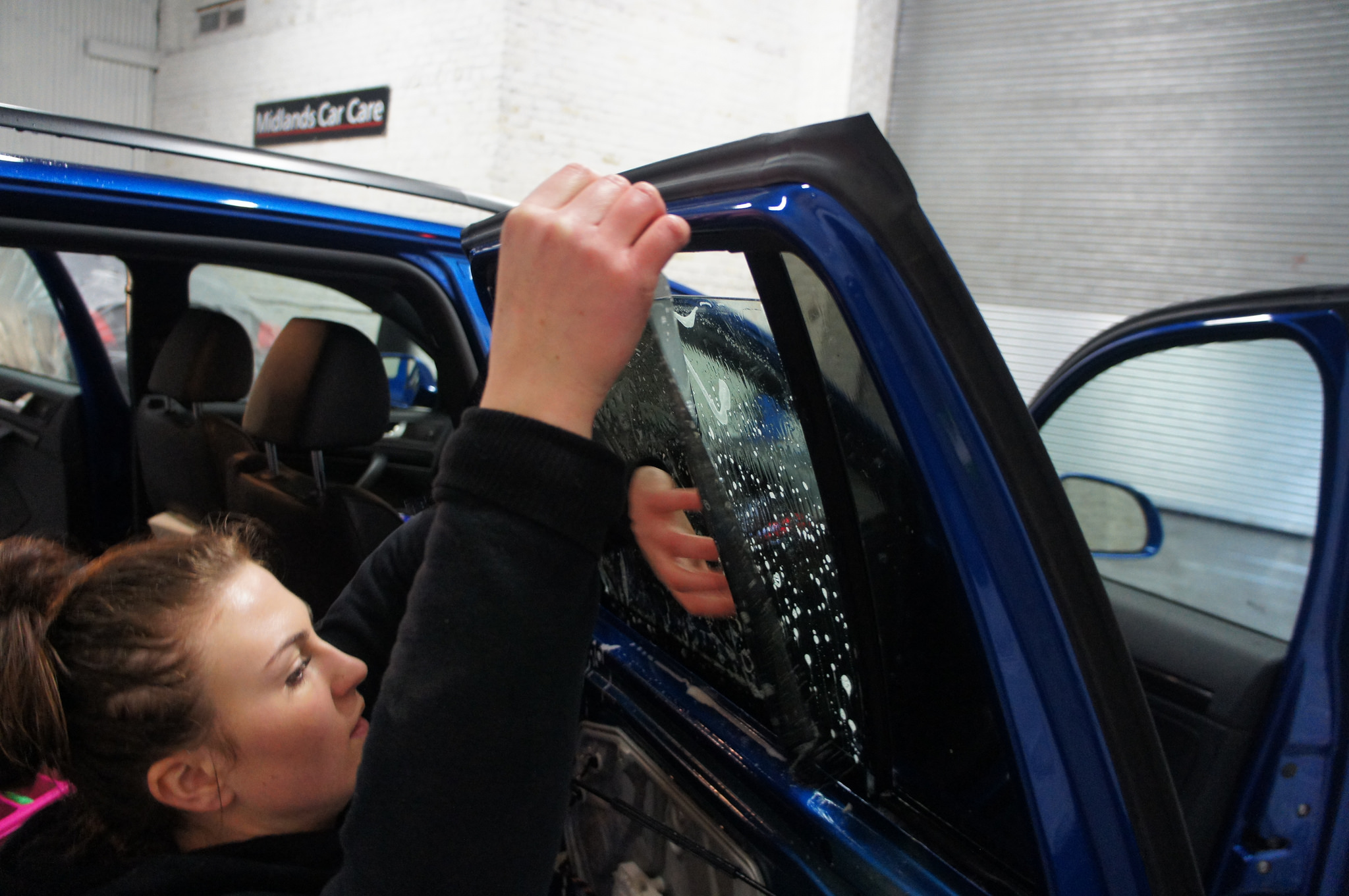

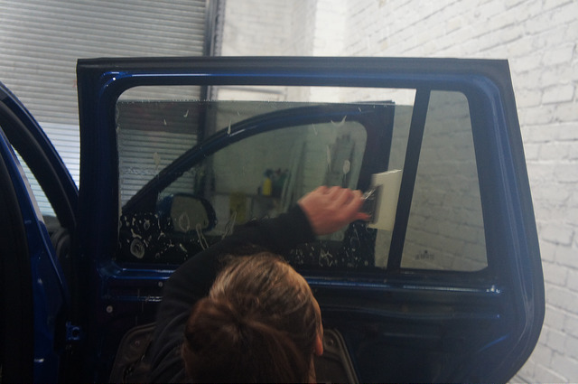

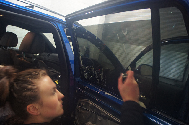

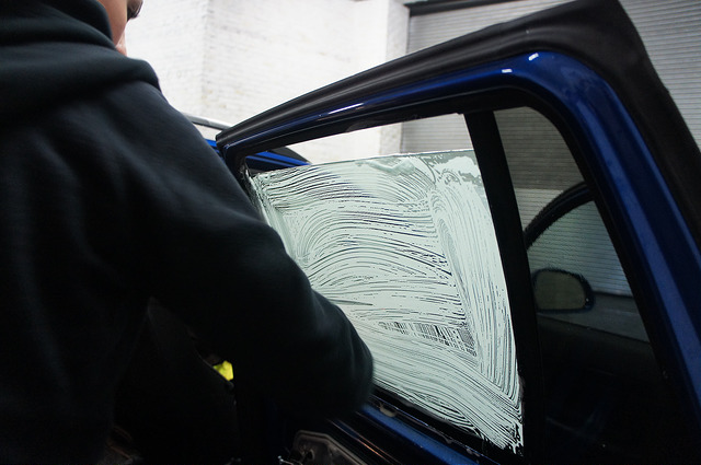

For the rear doors, the door cards were fully removed so that the film could be installed correctly. Again the glass is cleansed twice thoroughly:
DSC04304 by RussZS, on Flickr
DSC04307 by RussZS, on Flickr
DSC04309 by RussZS, on Flickr
DSC04310 by RussZS, on Flickr
Finally the door card is reinstalled.

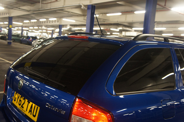

After the installation is completed, any excess slip solution present on the paintwork and exterior glass was removed with 3M Glass Cleaner and Zaino Z6 to ensure the car is looking its best.
DSC04314 by RussZS, on Flickr

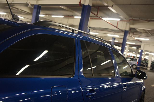

Here are the afters...
DSC04319 by RussZS, on Flickr
DSC04320 by RussZS, on Flickr
DSC04325 by RussZS, on Flickr
DSC04326 by RussZS, on Flickr
DSC04327 by RussZS, on Flickr
DSC04328 by RussZS, on Flickr
DSC04329 by RussZS, on Flickr

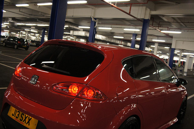

5% and a Sun Strip on this lovely Seat Leon Cupra for Jon from Dudley!
