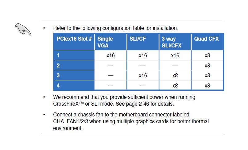

On the Asus Rampage III Extreme mobo, it appears that slots 1 and 3 are required for the full 16x throughput (just like I had in Crossfire)....
Without a longer SLi bridge connector, there's no way the cards can connect in slots 1 & 3 :S
