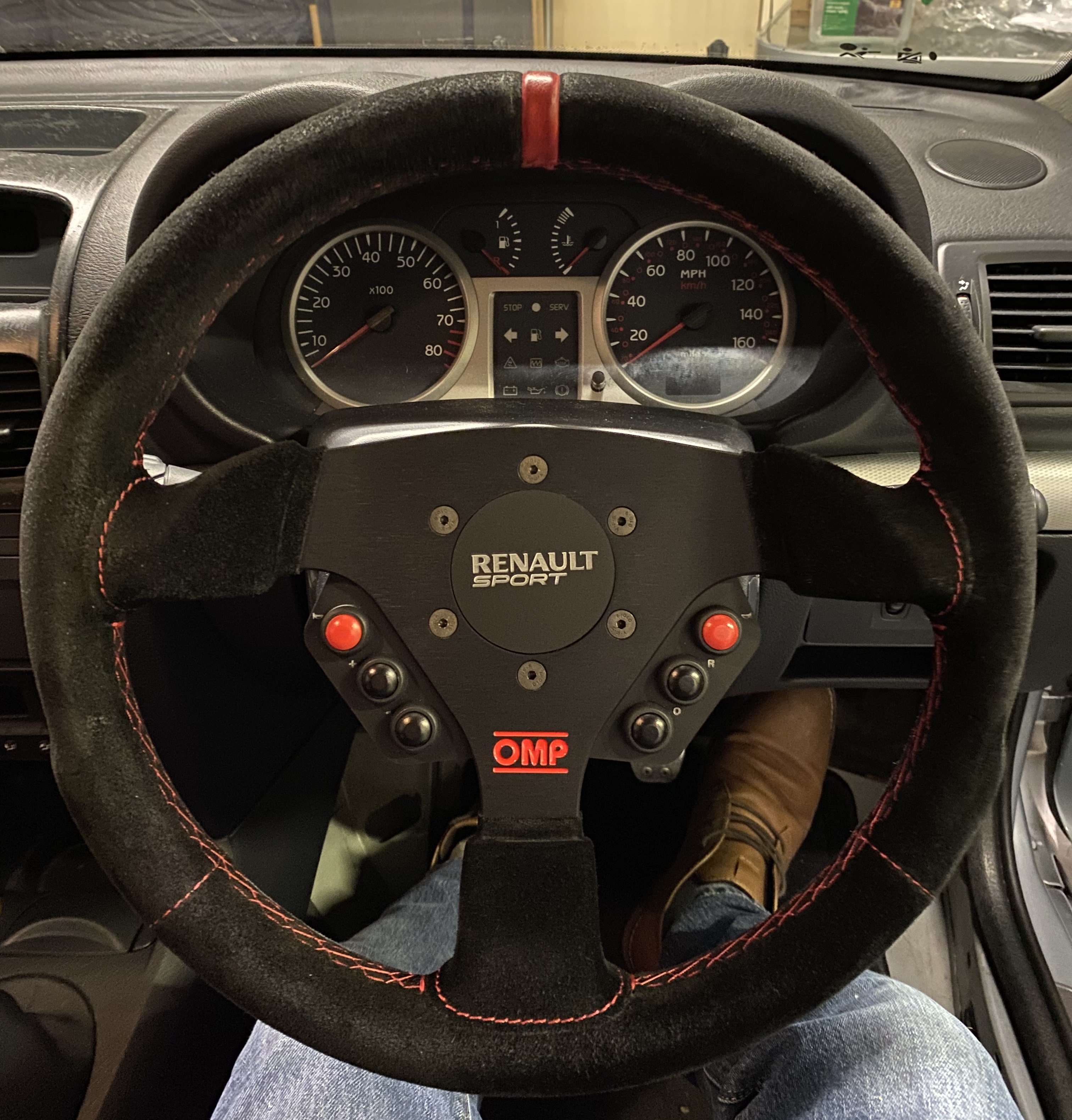

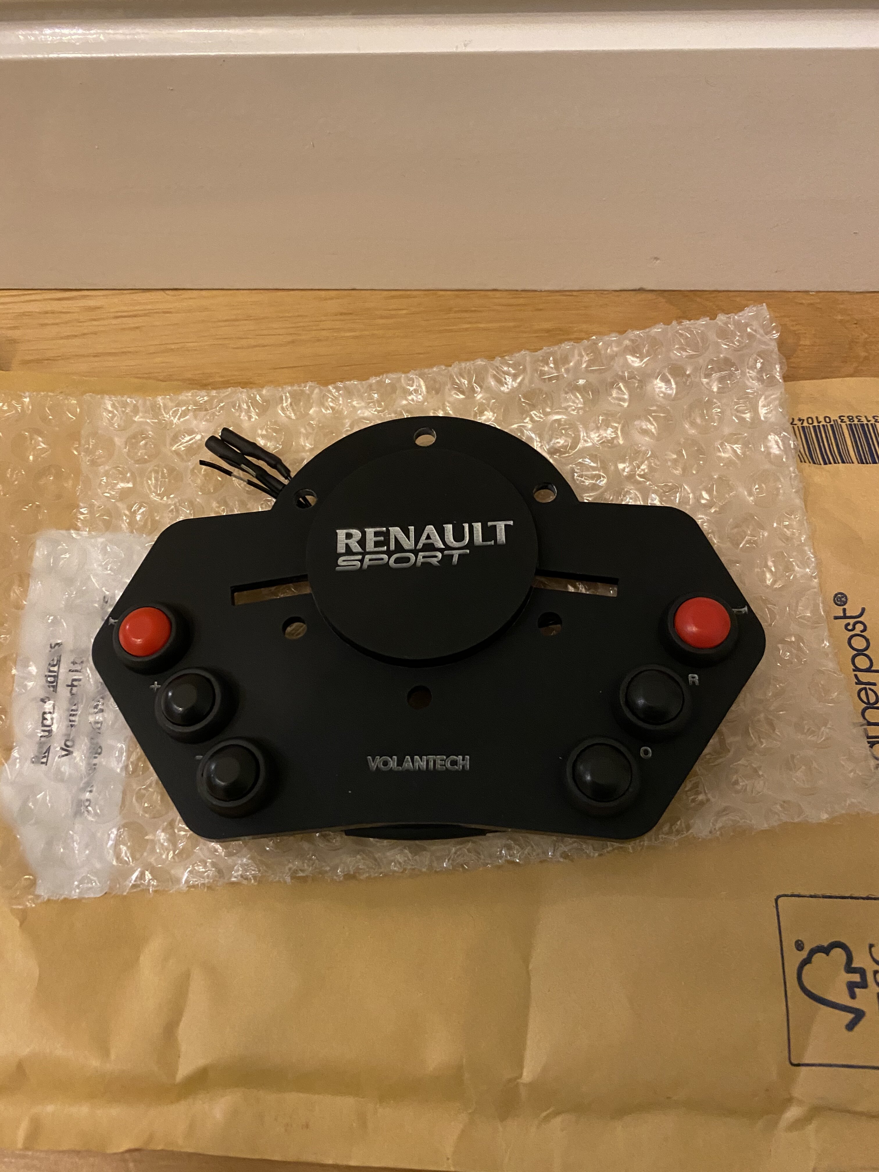

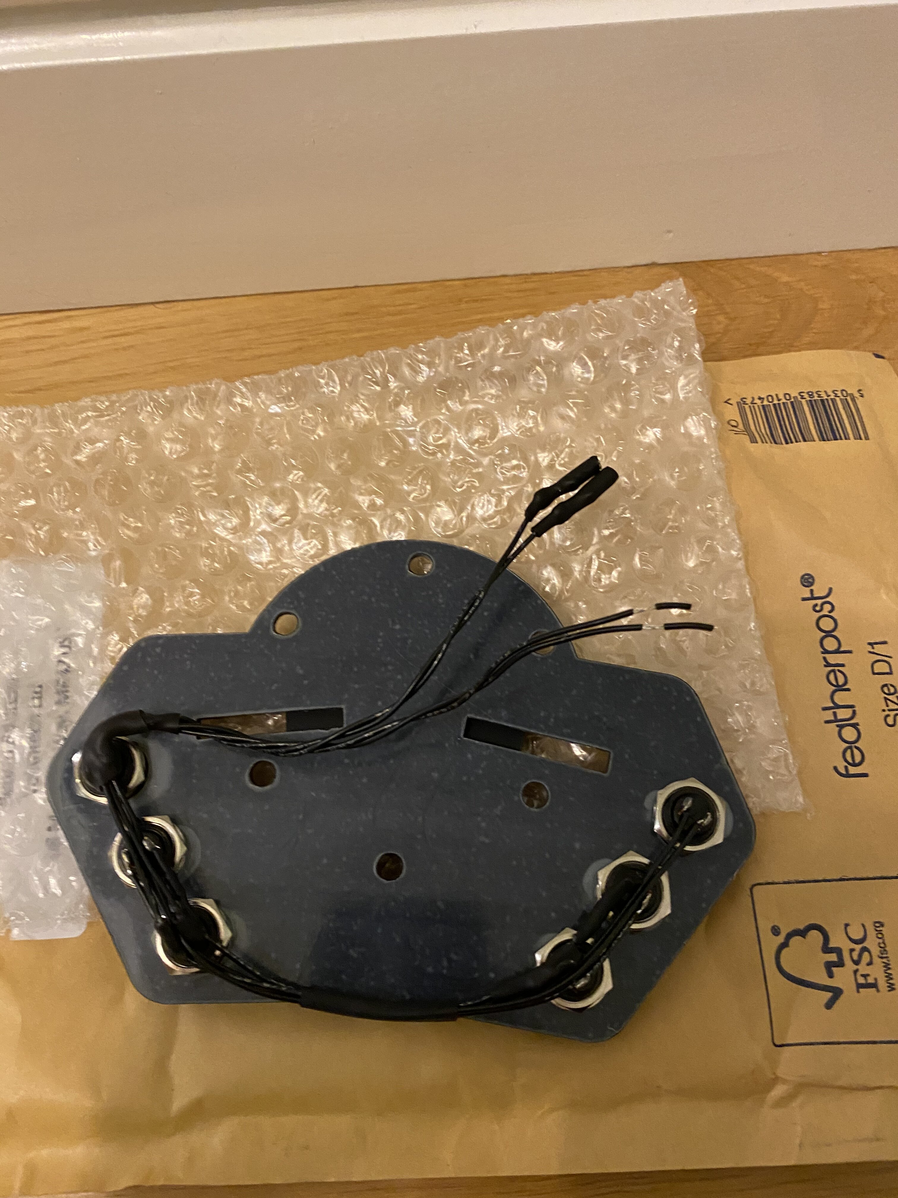

I've thought of using those spare buttons on the Nardi Personal to run cruise control, but my 182RS didn't come with cruise(?) from what I can see.
Would fitting cruise control to my non-cruise RS be a thing, and would I be able to wire up some of the buttons on my wheel to operate it?
Just asking before I pursue it and accidentally turn it into a forever project :ROFLMAO:
Afaik unless yours is a Cup which I’m fairly sure it isn’t then it should have CC as standard, so the wiring should be there somewhere 🤷‍♂️
Mine's got the rain sensing wipers and xenons, so I think it's just a regular ol 182.
Lovely stuff that the wiring's in there. So basically just a case of getting the squib/controls etc, and then making that work with the buttons on the Nardi?
I presume so mate.

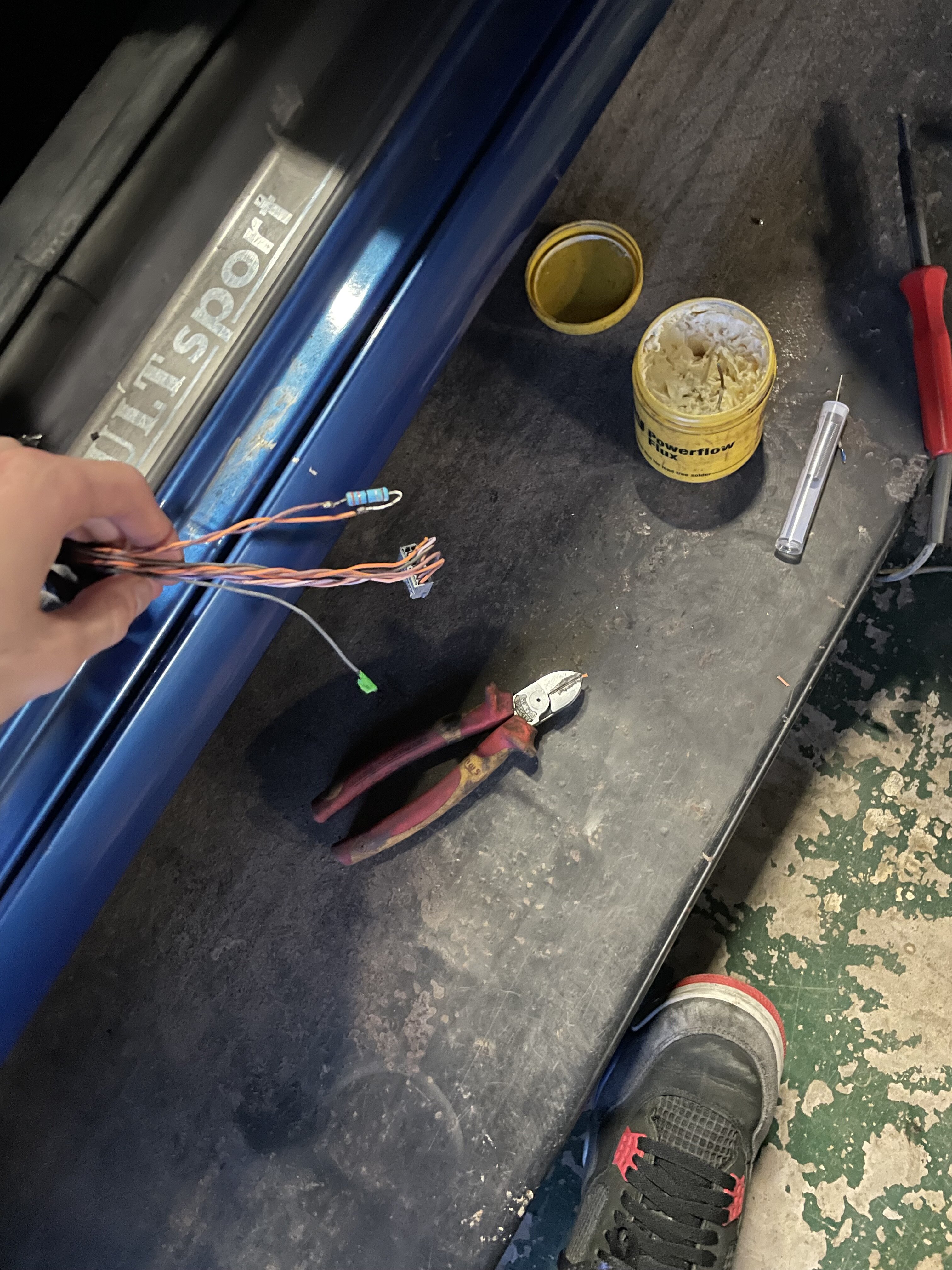

The cruise buttons work by resistance so you would need to add required resistors if not present already. On 182 id imagine the rest of the wiring will already be fitted, add cruise squib, cruise and clutch switch and your away.

Think that's a job for this weekend since the seller was kind enough to ship the wheel on over with a boss & wiring too. 😁

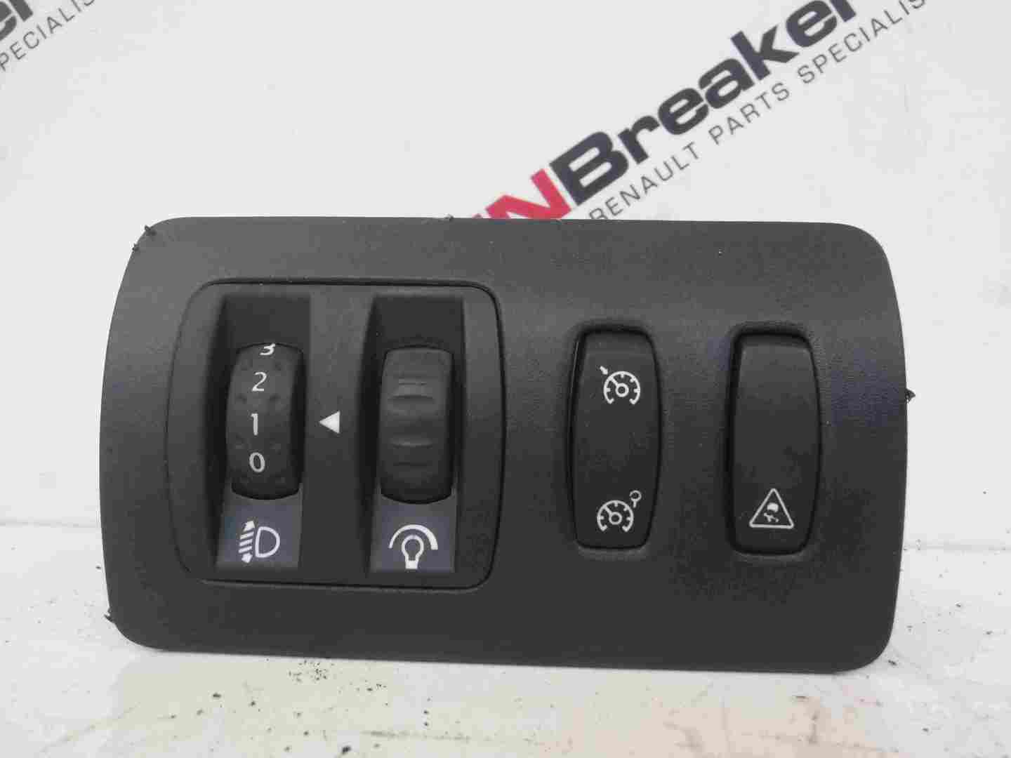

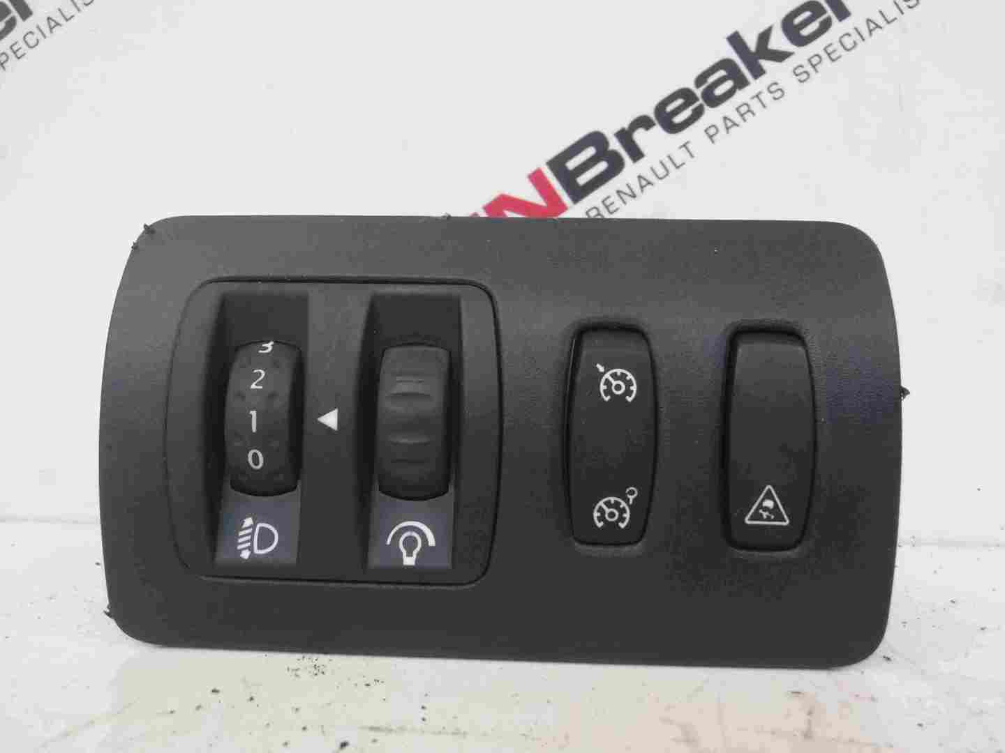

Do you have this panel by chance, this should determine if the CC is present or not?
Ha Yep! I’m still learning too but with the help of this forum I’m sure you’ll get to grips with these baguettes. There’s tones of info you just need to search about.
That I do good sir, which I can assume is an indicator I've got the right wiring and spec somewhere in the car?
(I know this as I've hit that button instead of the ESP on several occasions I've tried to depart in a blaze of glory/tyre smoke)
And this forum's taught me more about cars in the couple of months I've owned the Clio than *years* of Honda tinkering. You people are lovely. 😁
If you press the cruise switch, do you get Set come up on the dash?

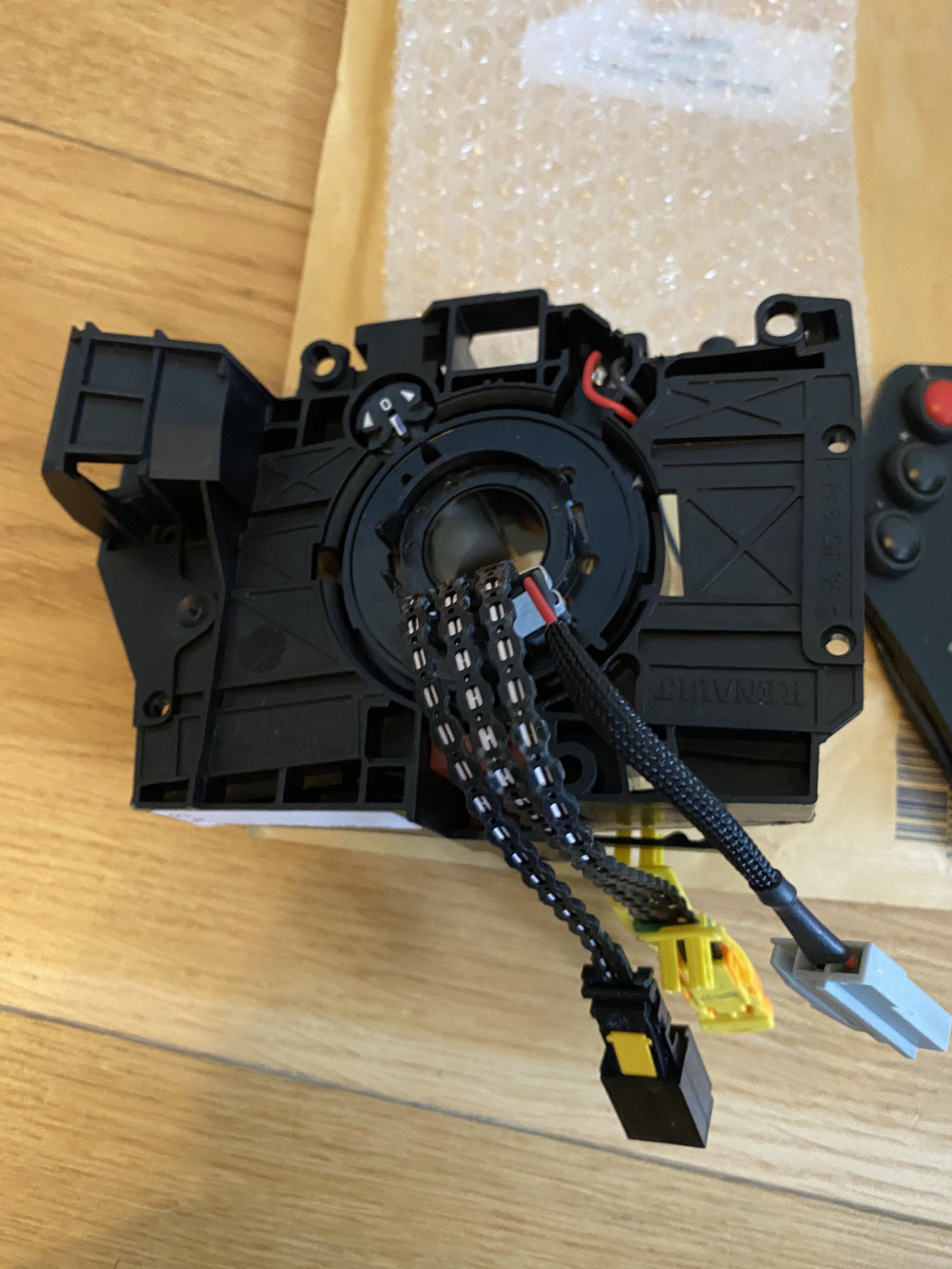

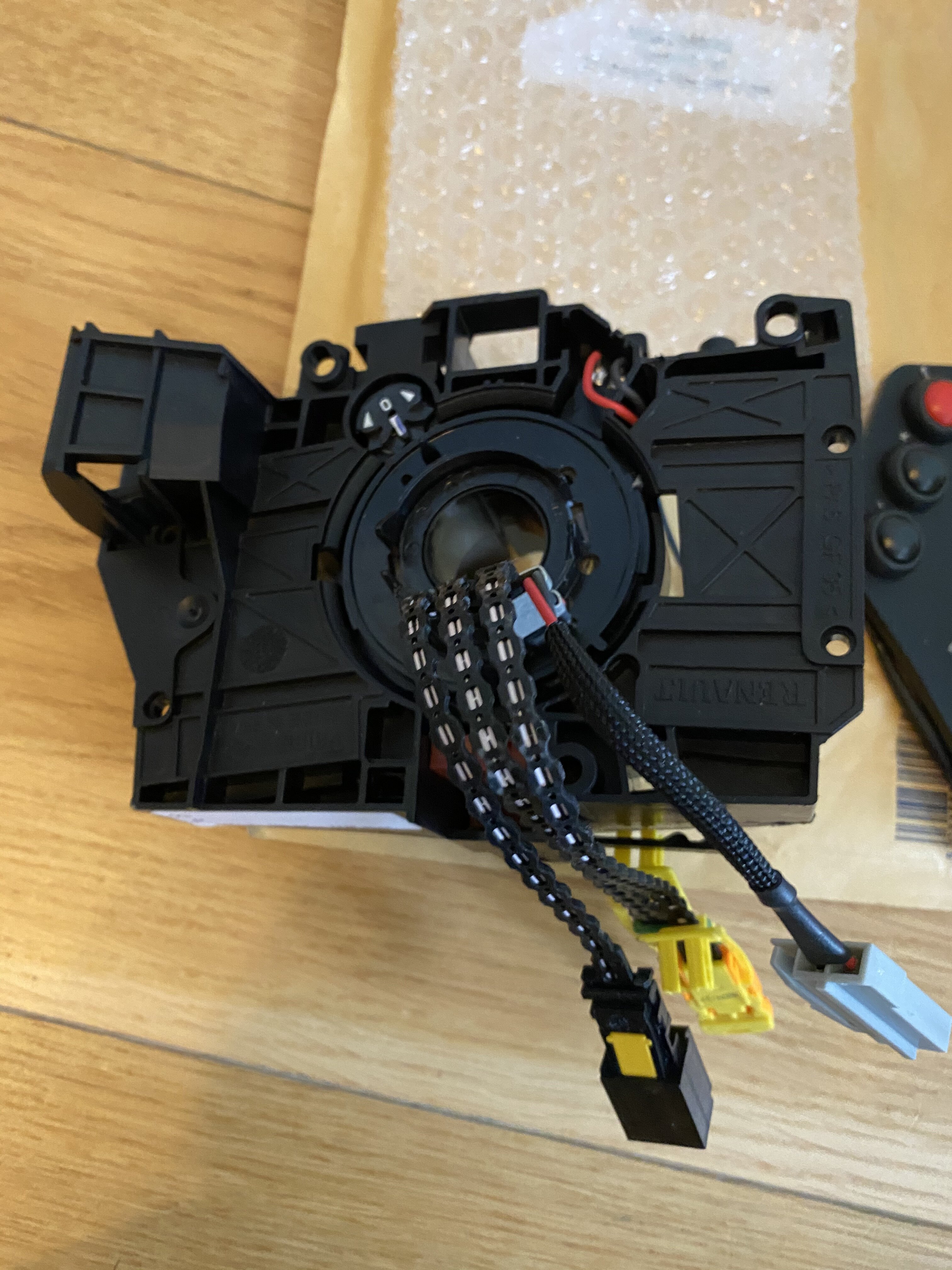

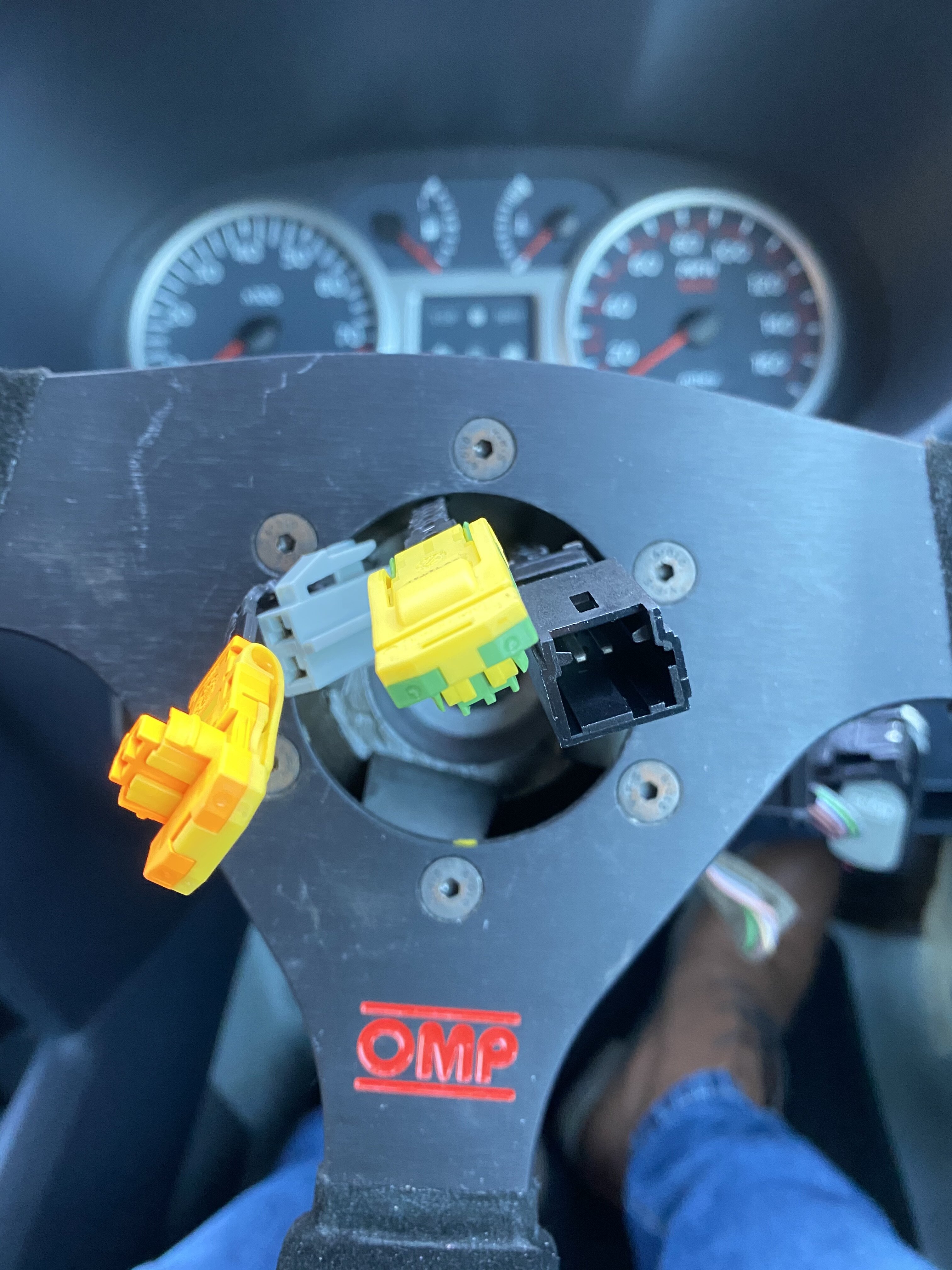

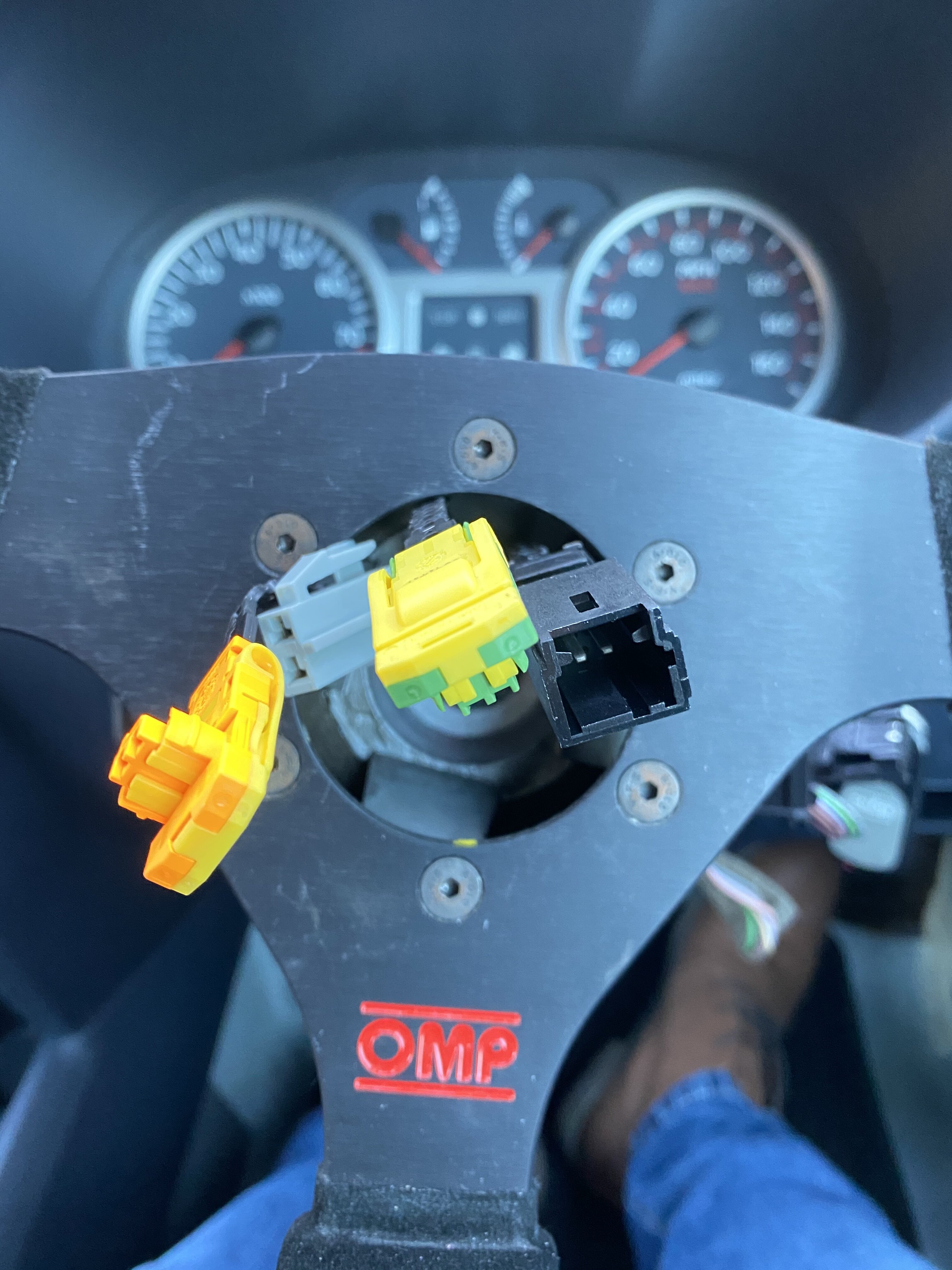

Just looked through my photos of when I retrofitted my cruise.
Have Attached photos of the squib, cruise panel & the wiring.
From Memory the black plug is for cruise & the grey plug is horn. The two yellows are for the airbag.
So check your car & if you have the black plug I believe you will already have the correct squib.

Yes thats correct. Black plug for cruise.

You are a truly incredible individual good sir, words can't describe how helpful having a visual reference is.
That's made this weekend's excursion on the tools infinitely more well-informed. :)

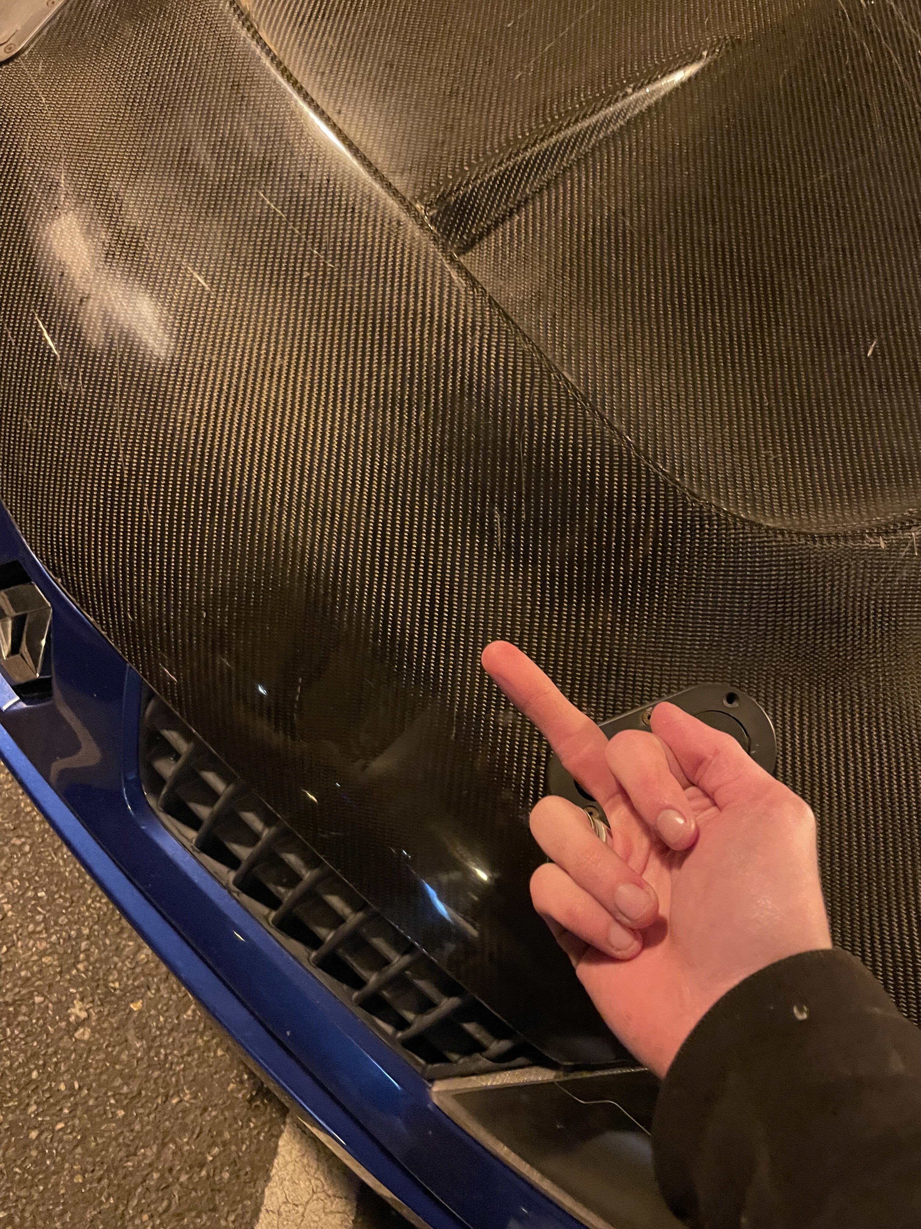

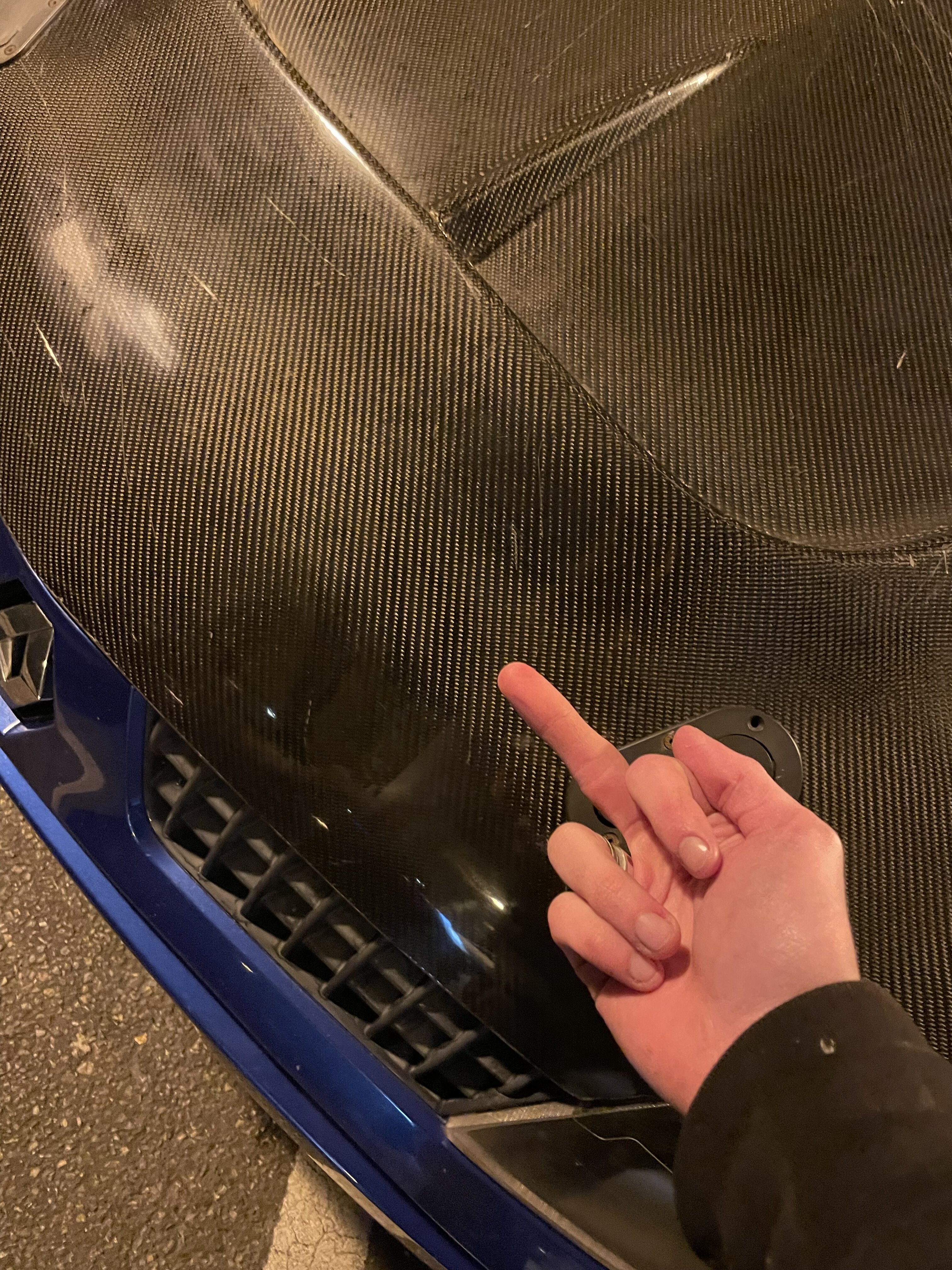

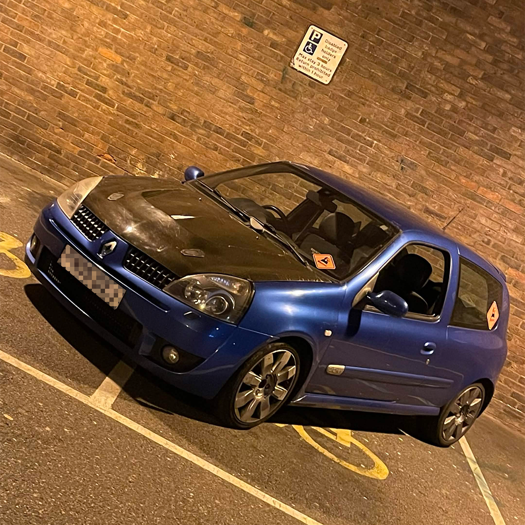

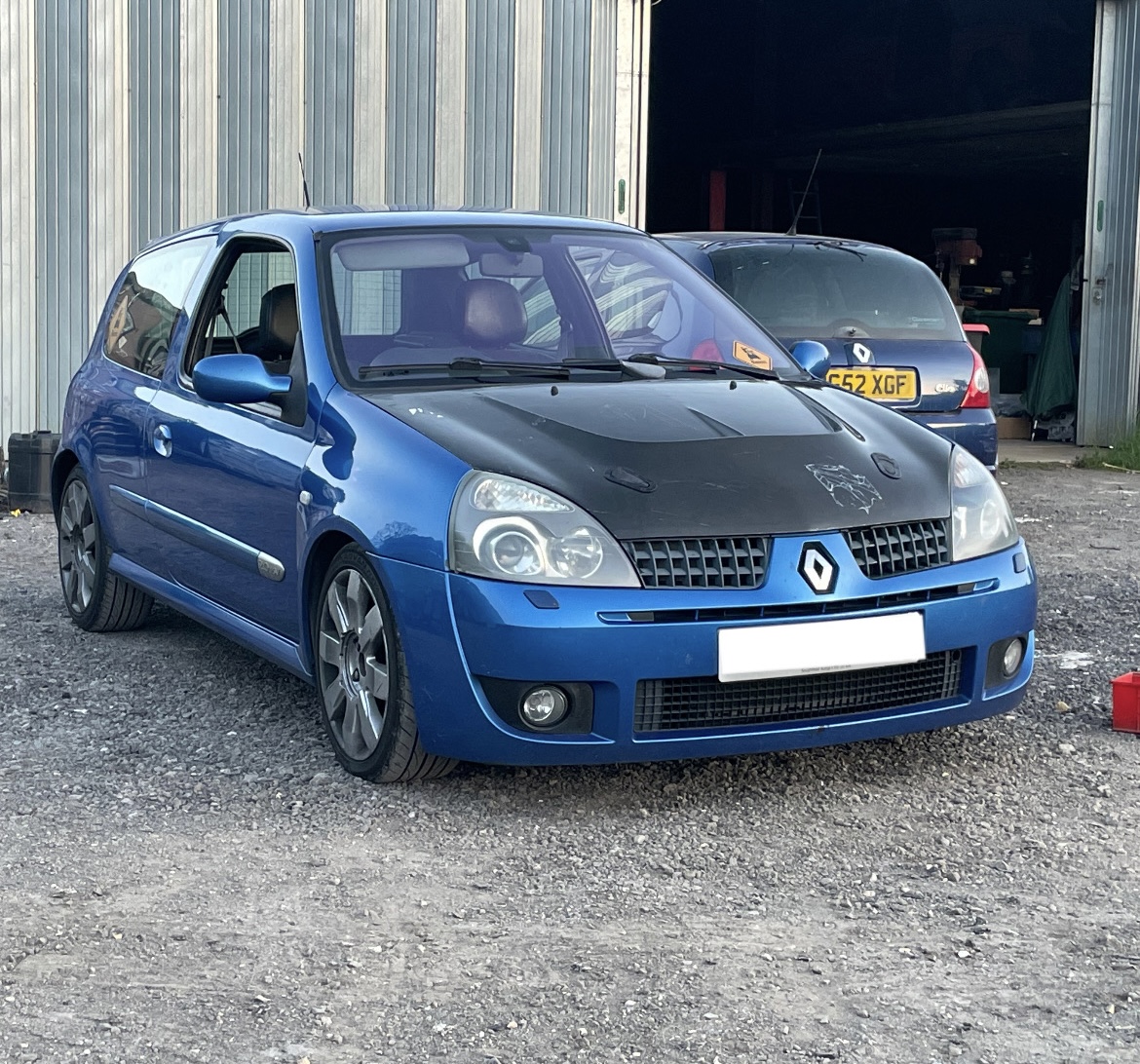

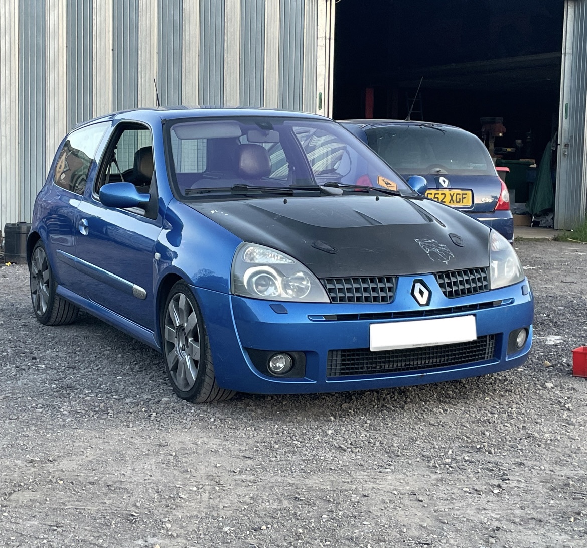

Carbon bonnet and Nardi Personal fitted. Pleased to report that the Clio looks a little bit meaner* and is now rightly equipped with cruise control.
The induction note gets blasted directly into your face now thanks to the bonnet vents, which is an added bonus. It sounds biblical.
*Ignore the postage label that absolutely will not go away. It survived brake cleaner, so I’ll be dealing with that in the daytime pre C&M.

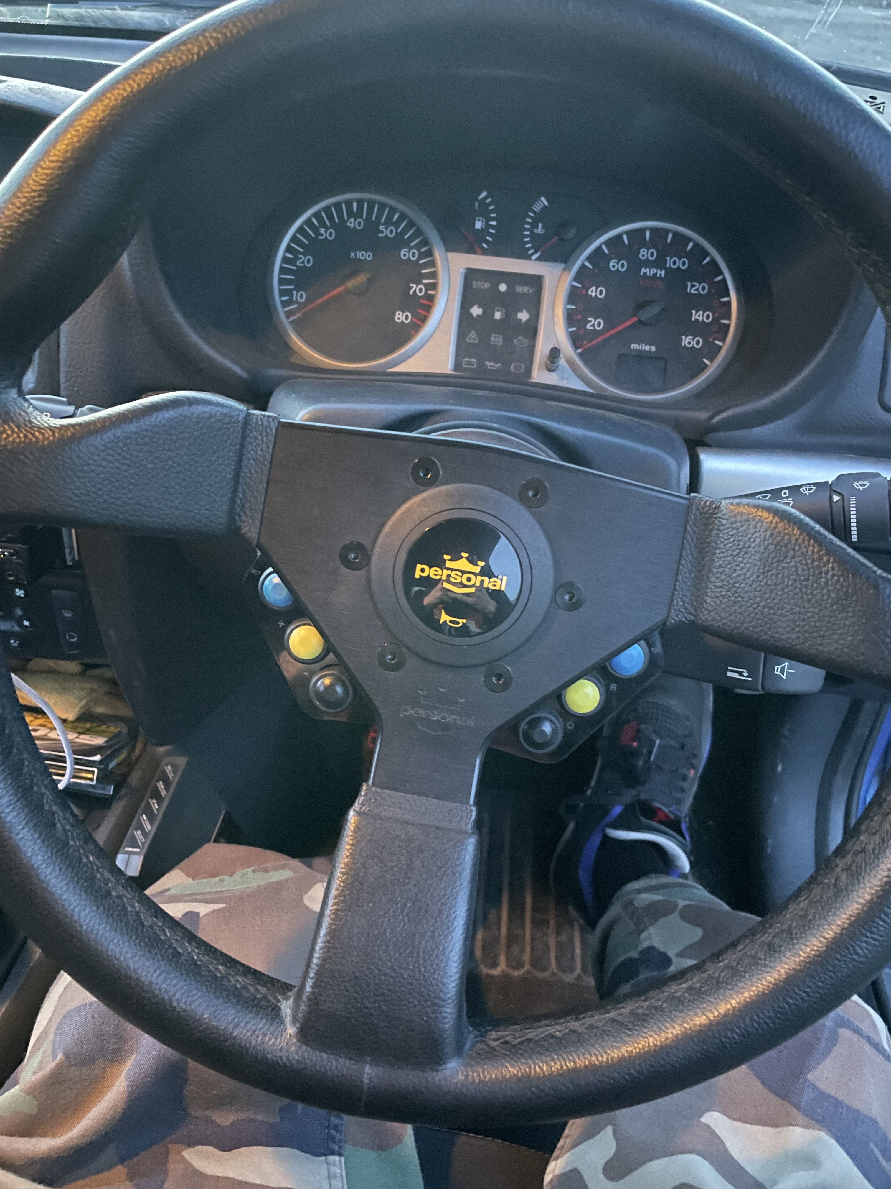

Rather substantial Nardi-related happenings inside the gaff.

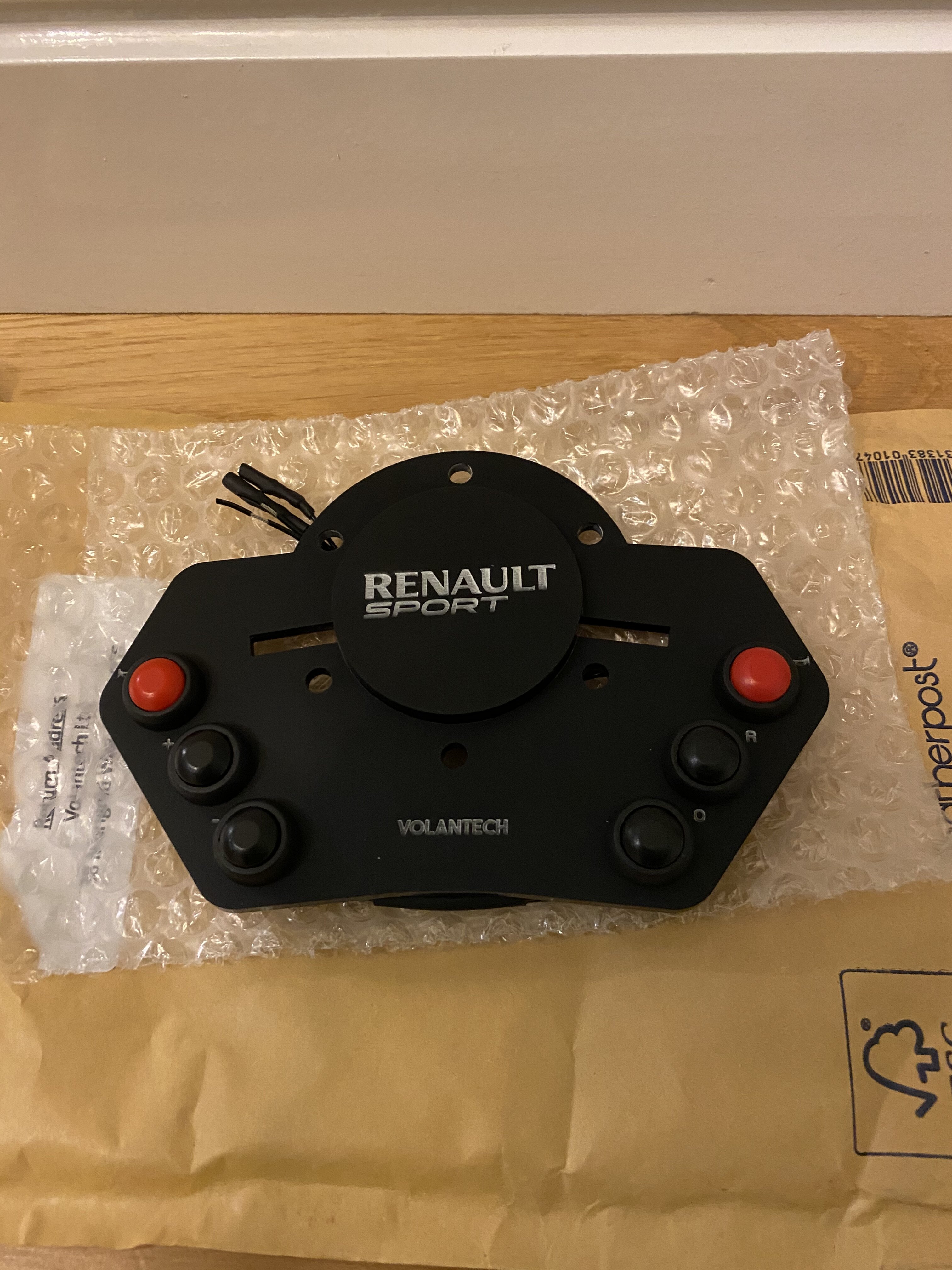

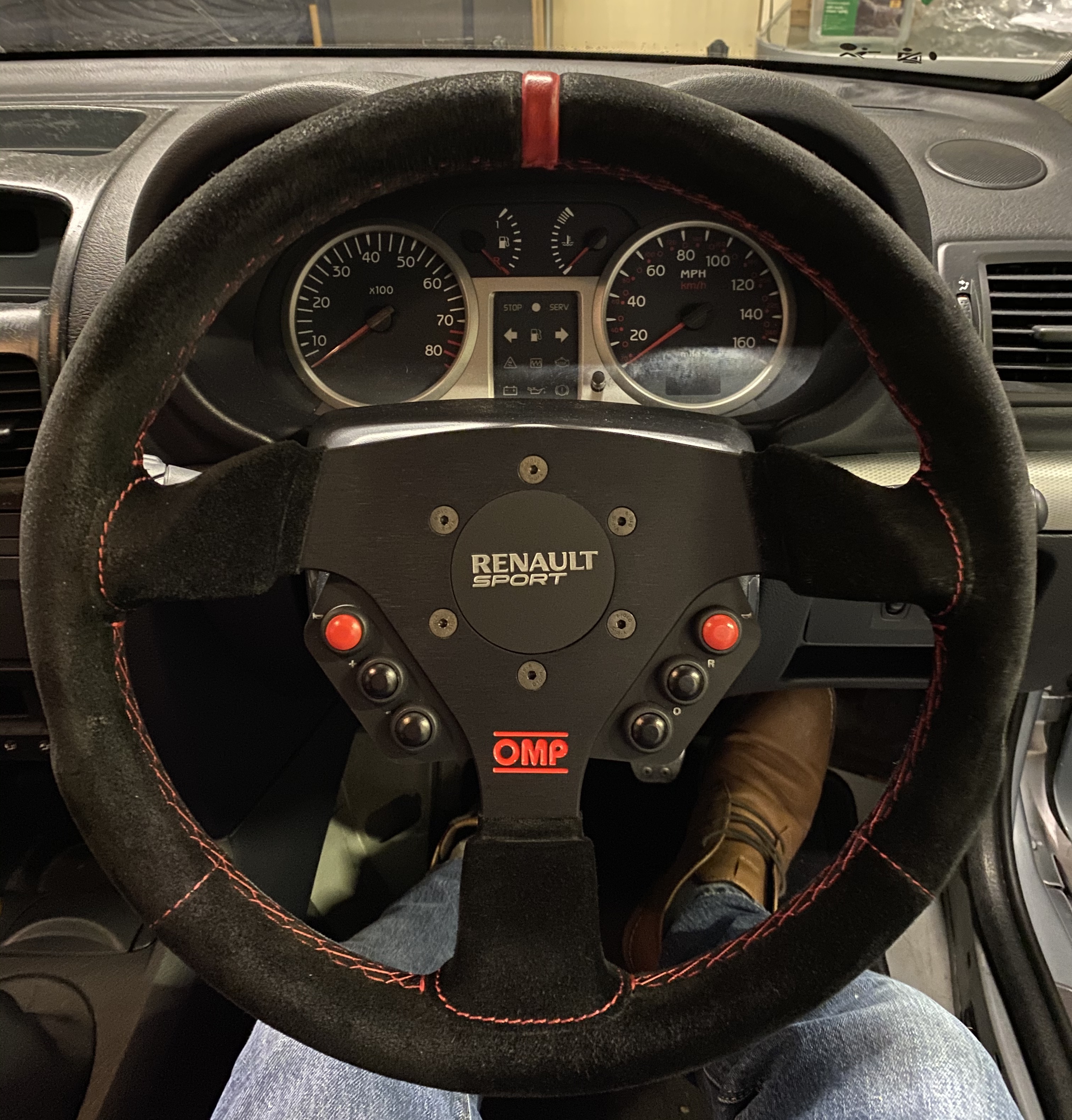

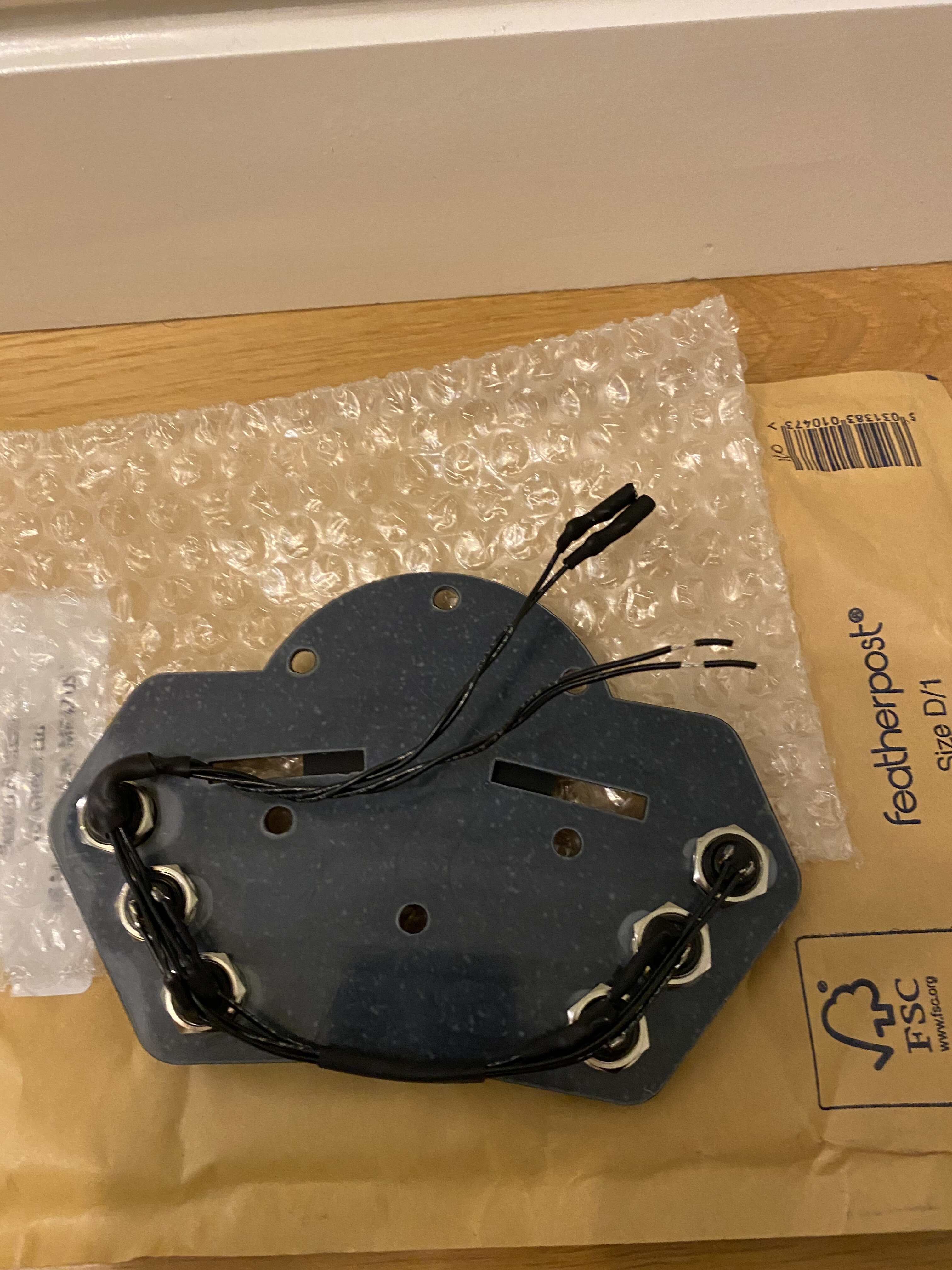

Fitting this wasn’t tooooo bad, just a case of sacrificing some cruise control buttons for their wiring and extending the horn wire a bit to account for the boss. I’ve driven the car 40 miles home and haven’t caught fire yet, so I think the install has gone well.
The cockpit’s now a nice place to exist and accounts a bit better for my proportions. Final step is to get the GReddy gauges installed.

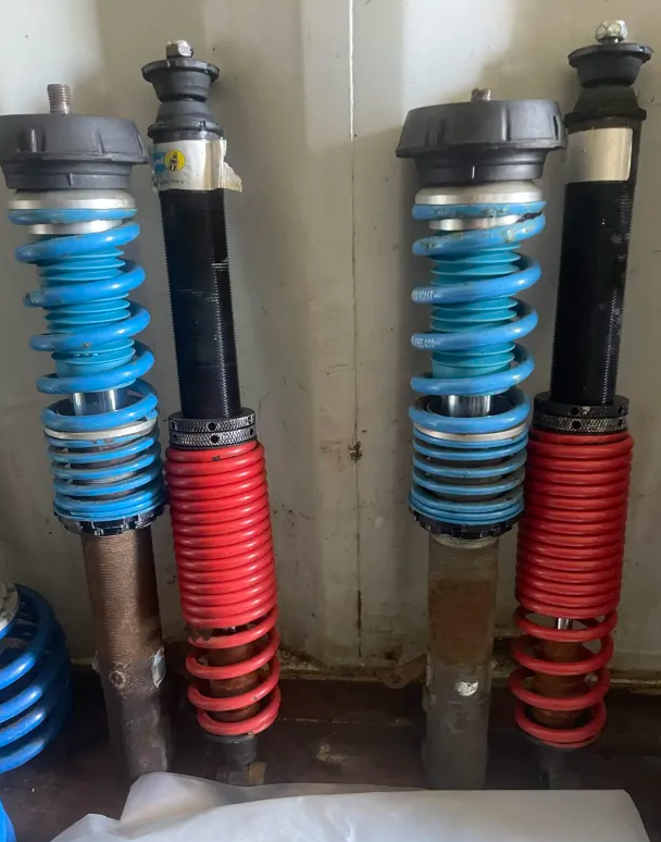

Question for the suspension gurus. I've been offered a set of Bilstein x Pure Motorsport coilovers for an exceedingly good price by my friend, should I go for them?
I've read great things about them and they seem to suit my use case of taking the car out on the twisties after dark, but it'd be nice to get a second opinion.
If these are solid and will last, I can trig up on them pretty damn fast.

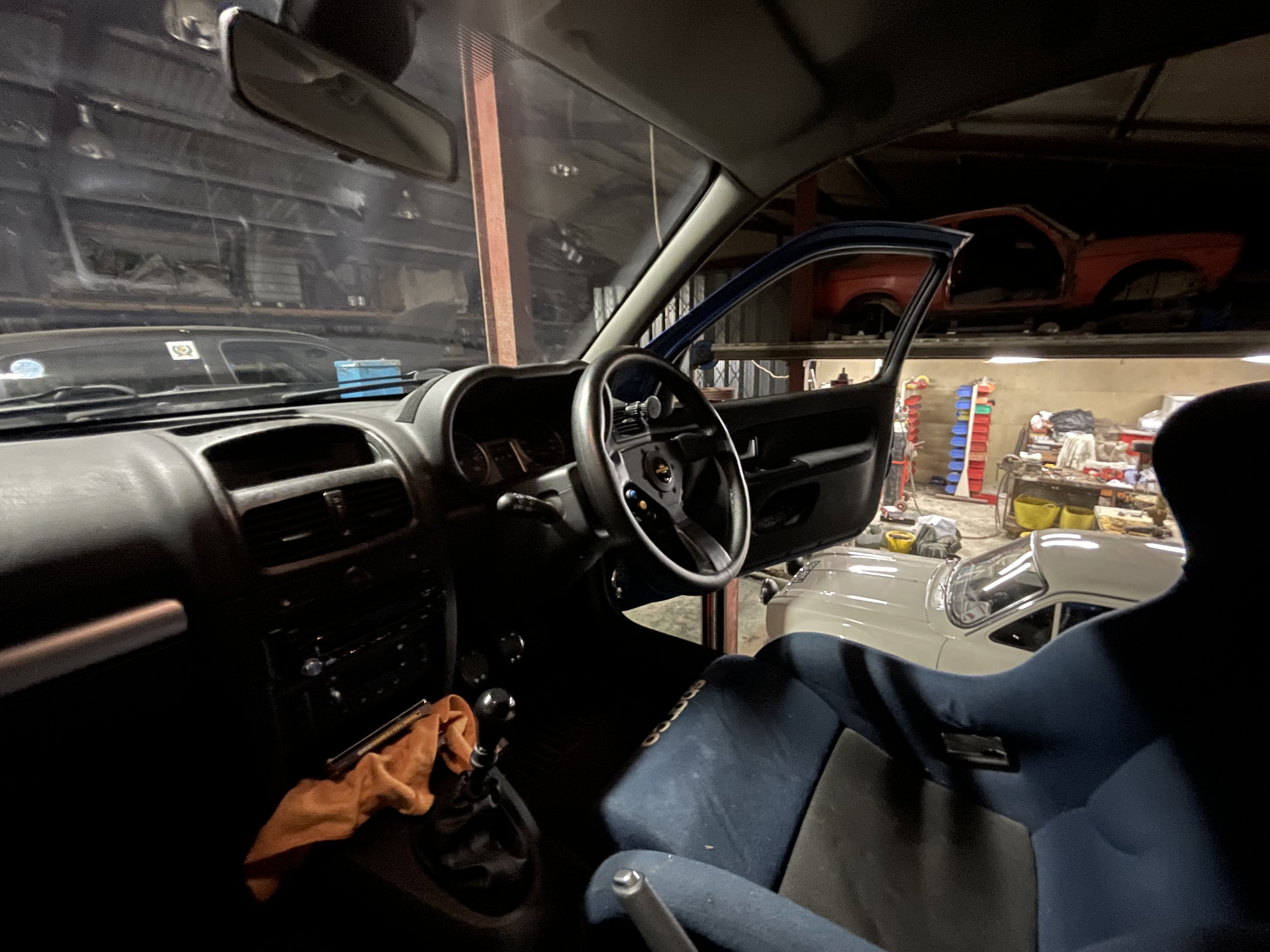

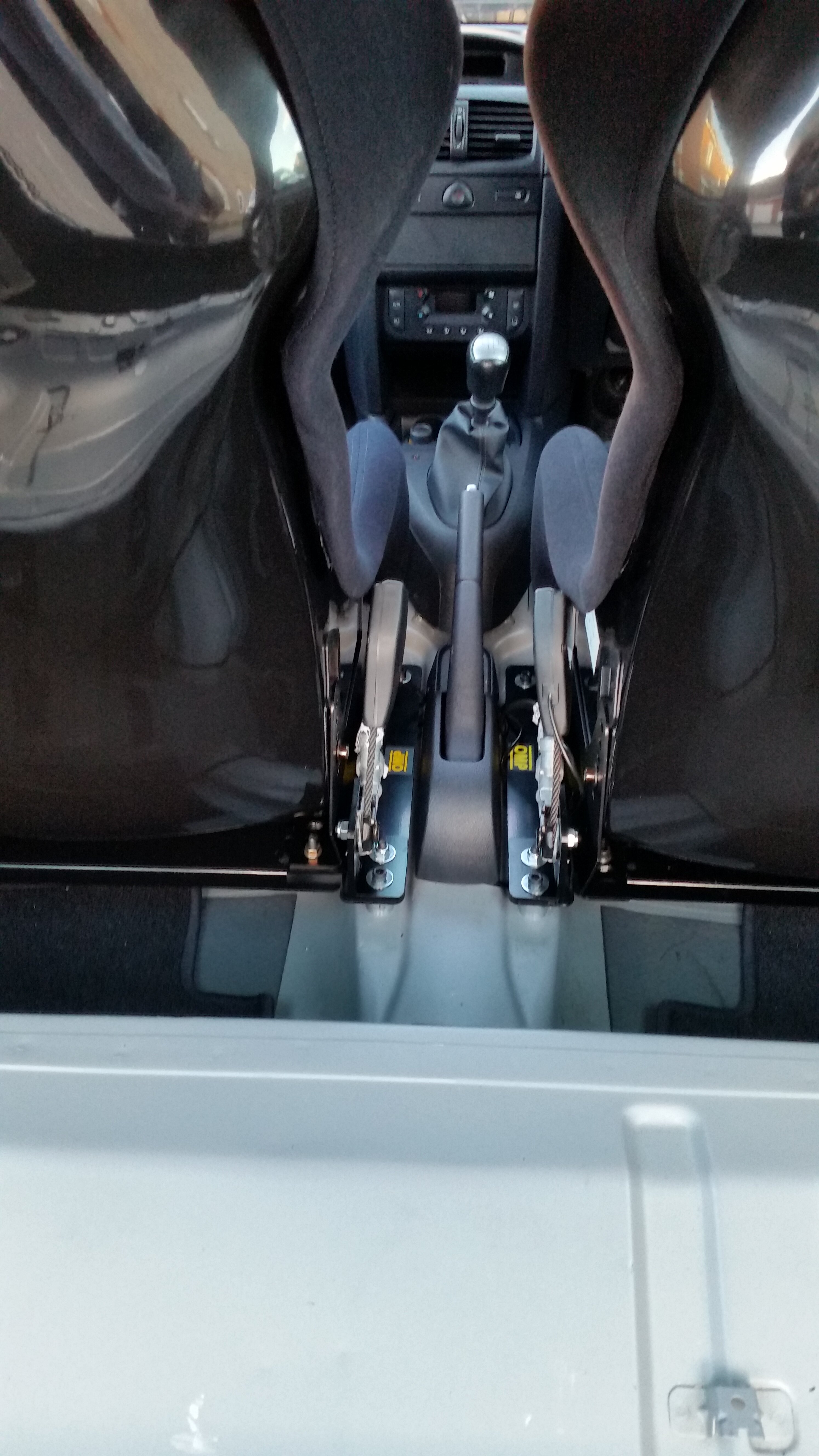

Pleased to report that I’m now running the old Sparco buckets I’ve been waiting to fit in (something) for years.
Dealt with the airbag light from somebody’s previously booky handiwork (with some equally booky handiwork) so it now appears and then disappears as it should, got the old seats out, and the Sparcos in on some Sparco side rails and… OMP bases.
In the interim before I fit harnesses, a pair of seatbelt buckles/receptacles have been made from the rear seatbelt buckles. Got harnesses, got the hardware to mount them to, and if all goes well I’ll get some time to hit that in one foul swoop.
Really enjoying working on this thing as of late, it’s kinda reignited the joy of messing about with cars again. :)
Looks solid from the front. Still need to get on fitting the lip kit.

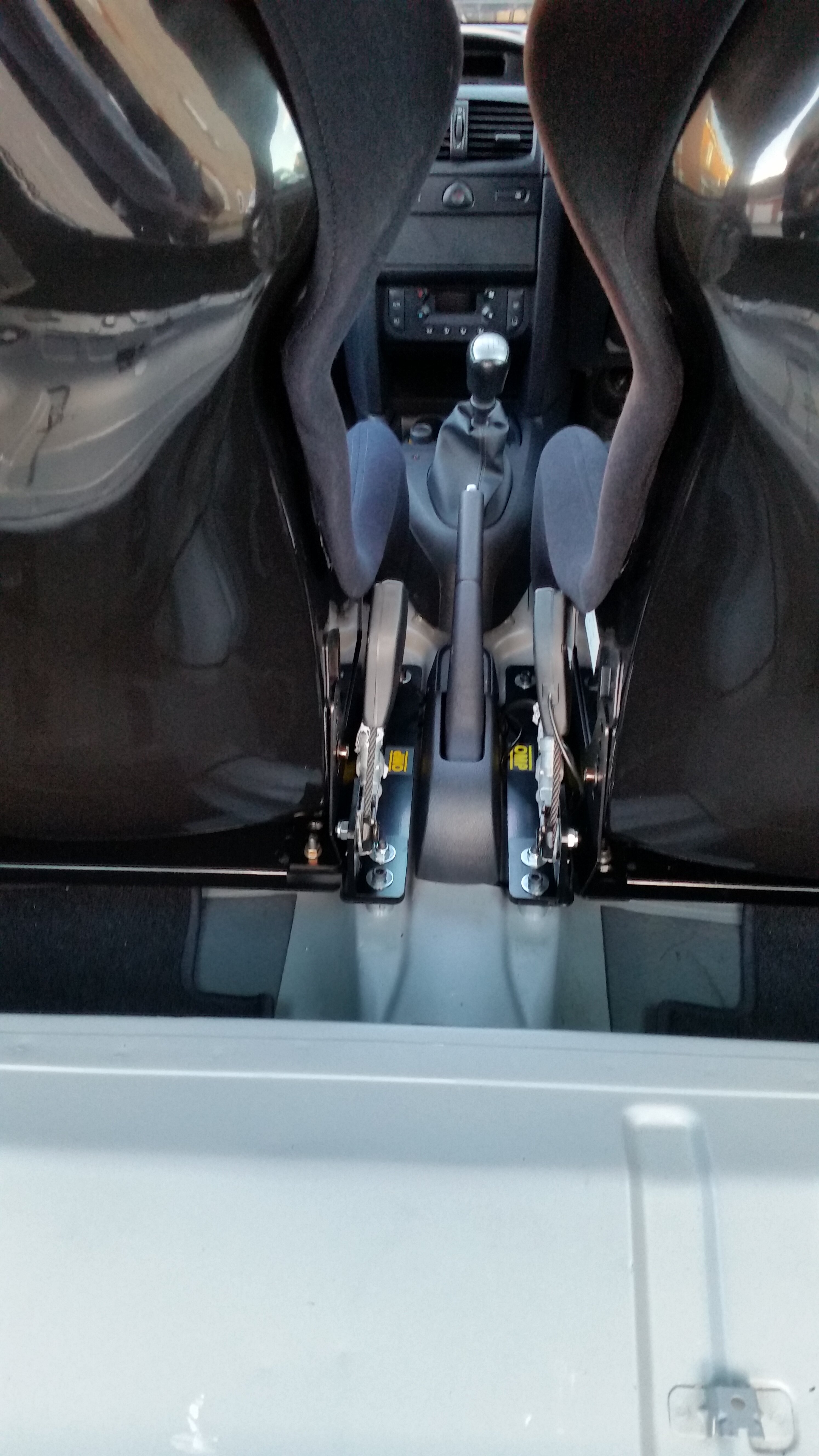

My stint in air jail, given the seats needed holding in place while being fastened.

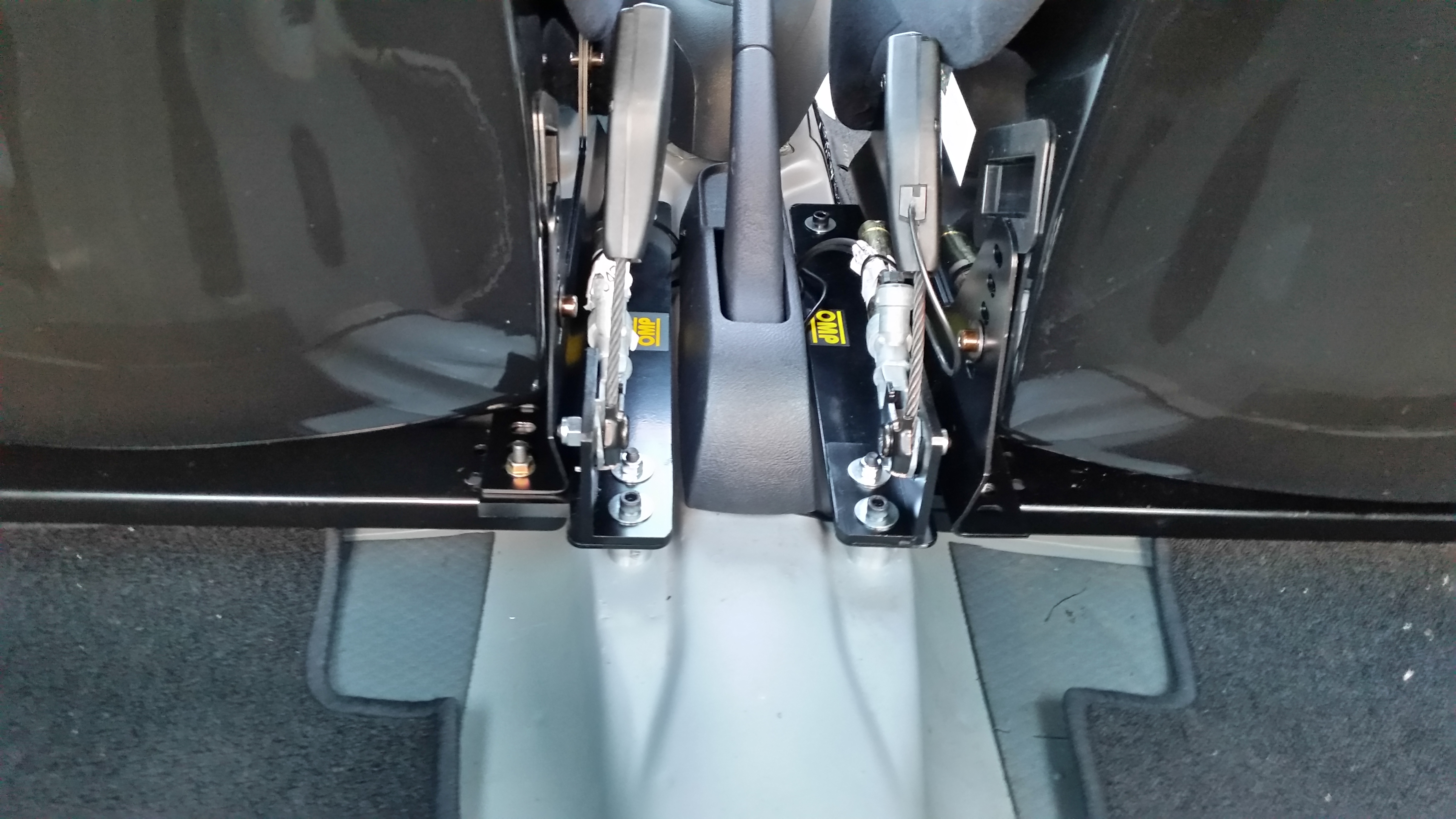

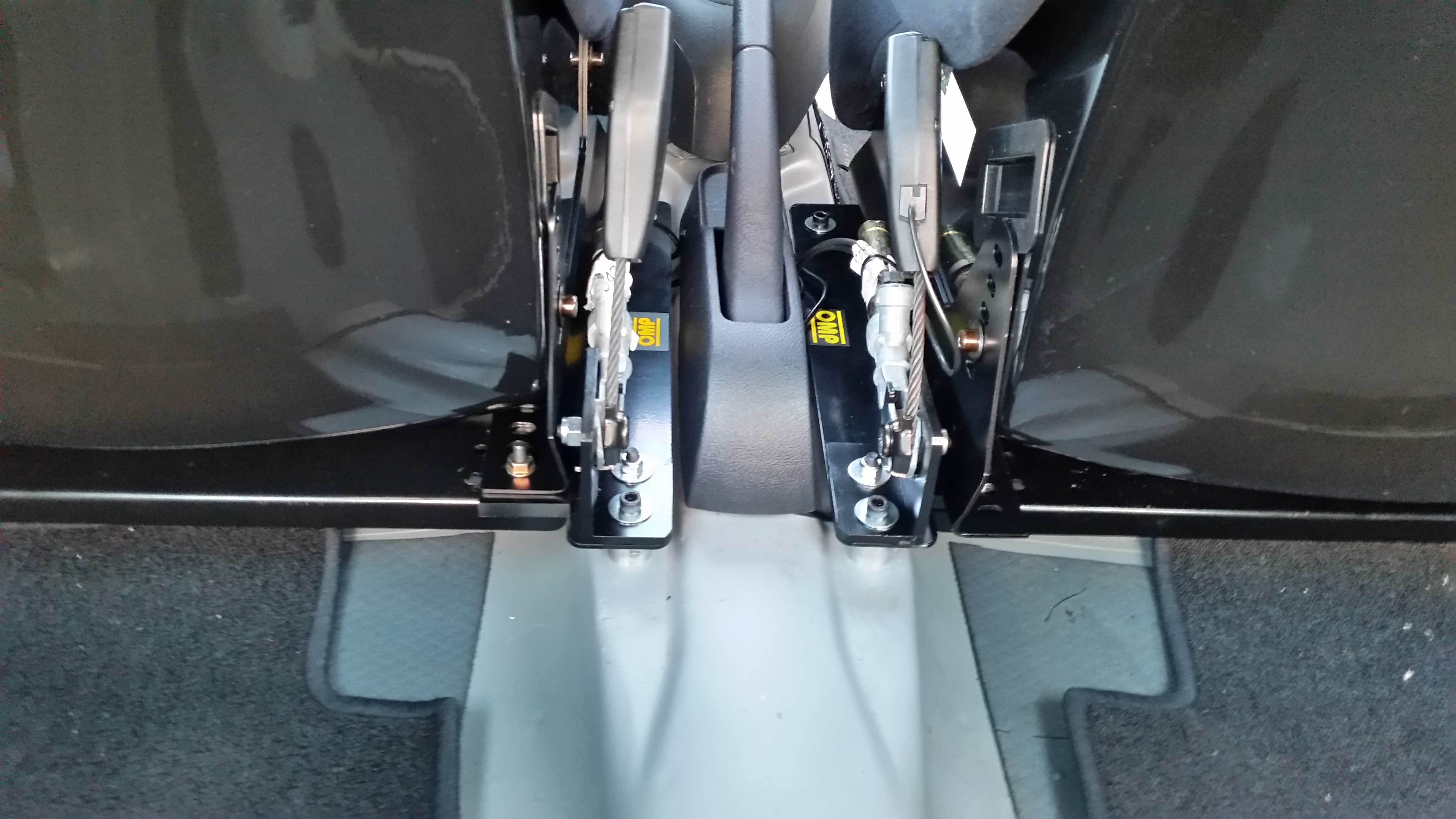

With OMP Bases the seats sit wonky, Ideally you need a spacer under the two inside bolt holes. I think it's around 25mm but it's long time since I did mine.
Aye! We found the same issue near the heater vents, so we just trimmed a small notch into the seat base so it wasn’t being pressed upwards.
@bvnditi with spacers you probably wouldn't have had to notch the base out.
I have included a photo which just about shows the spacers I made.
From memory 25mm diameter Aluminium bar with a 8.5 mm drilled hole through the middle & 25mm in length.

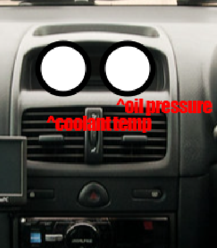

Using this thread as a place to store my thoughts. I've got some GReddy gauges I'd like to get fitted.
Got access to biblical quantities of donor cars thanks to a few of us using Sports & DCIs as trials cars, so gonna pull a dash, laser scan it and hopefully develop my own little gauge holder. Would be a 3D-printed prototype, and then if all goes well, I'll do up a mould. Hopefully I can contribute a bit to the Clio scene in doing so. 🤔
Did a quick 10-second doodle of what I'm thinking.

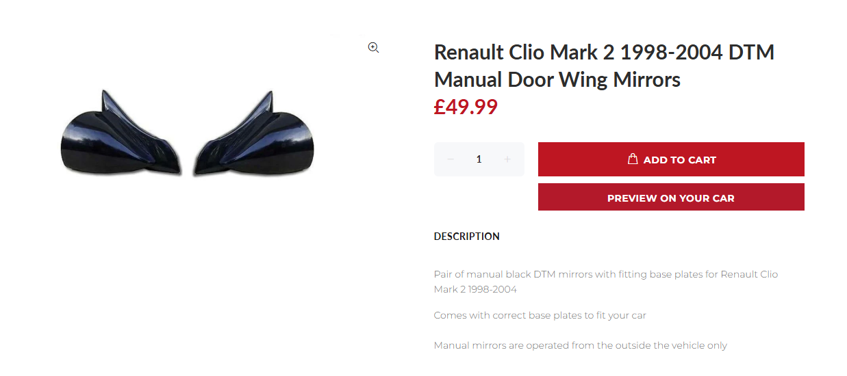

Pending a couple of invoices paying up, but I'm looking to trig up on a set of these DTM mirrors for the Clio. I'm also going to see to sacrificing a set of Clio mirror motors to see if I can jerry rig them to work inside these, as I'd quite like to retain the functionality of the electric mirrors. Same way I put cruise control back into the vehicle after someone decided to remove it.
