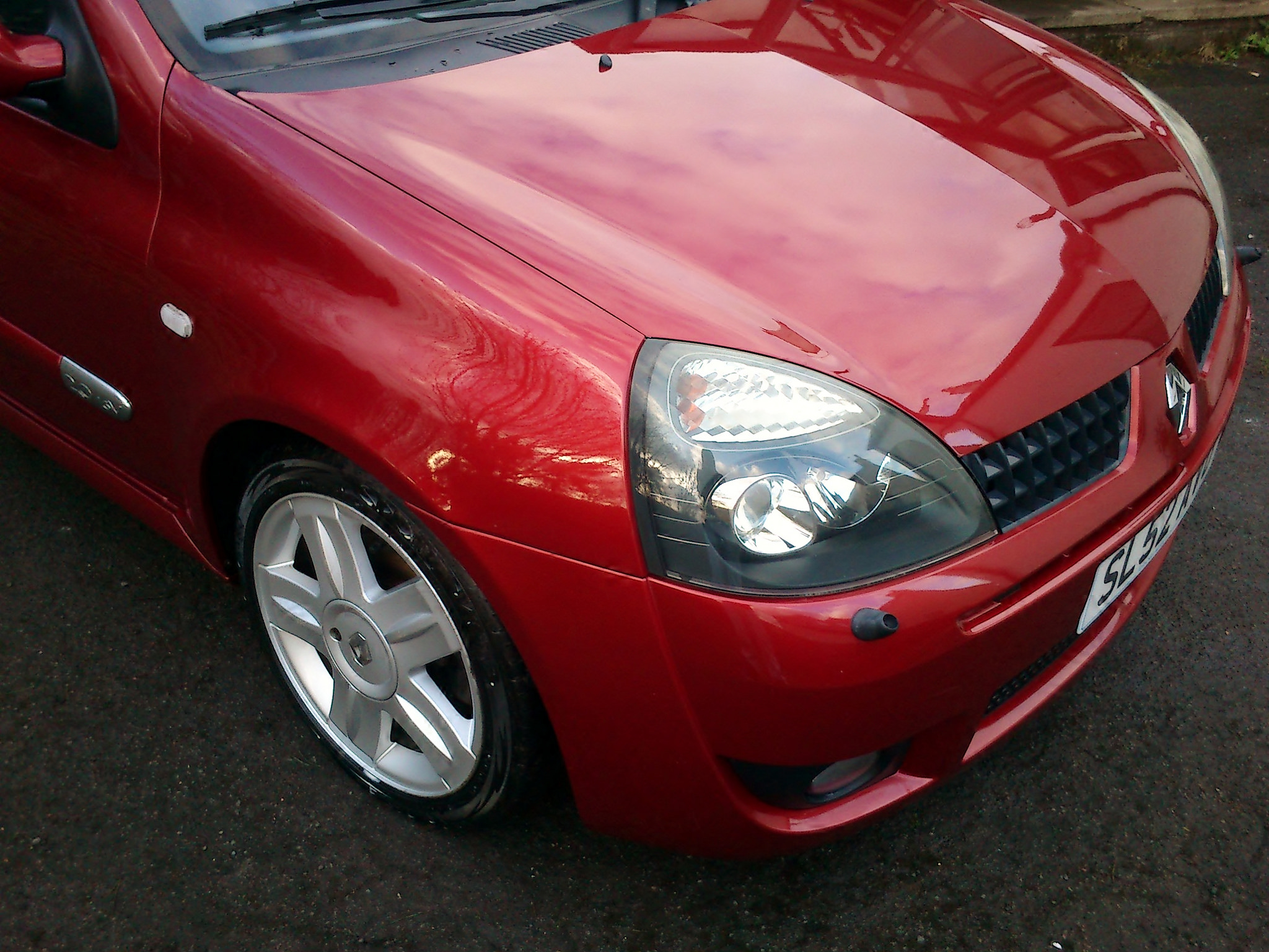

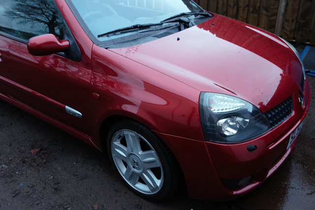

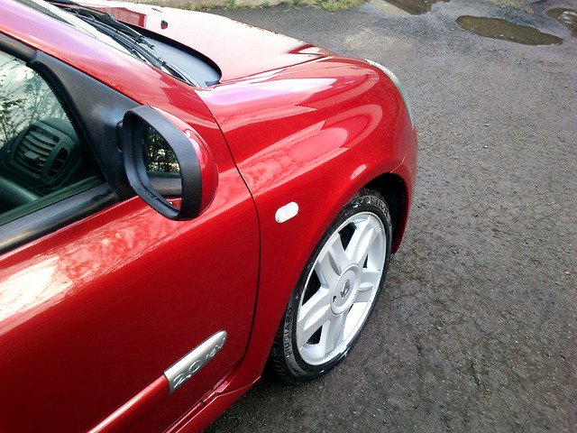

In the last couple of weeks iv done a couple of things to the flamer. First off, a set of 182 side repeaters so no more ginger sideys!
Before
IMG_7271 (2) by thepike1984, on Flickr
After
DSC_0398 by thepike1984, on Flickr
DSC_0393 by thepike1984, on Flickr

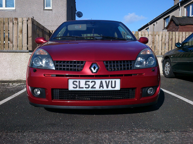

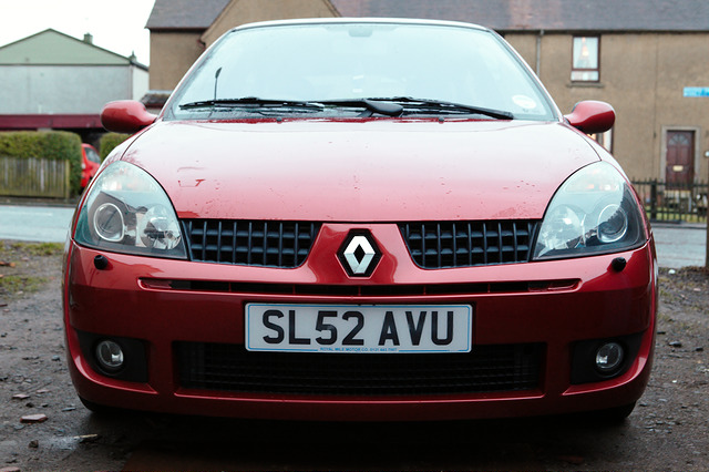

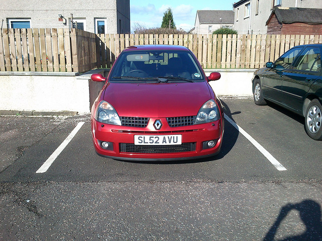

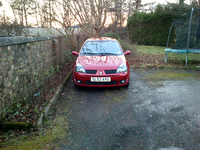

Next was a Fabia splitter
Before
DSC_0325 by thepike1984, on Flickr
IMG_7266 (2) by thepike1984, on Flickr
After
DSC_0450(1) by thepike1984, on Flickr
DSC_0452(1) by thepike1984, on Flickr
Picture quality is crap because there taken with my camera phone. Let me know what yous think. Good or bad.

Looks great , how did you remove the old ginger ones i still need to do mine.
Flathead screwdriver and a cloth so I didnt scratch or chip the paint. Pops off with ease. Once their off you twist the bulb holder 90 degrees to release the lense from the bulb. Make sure you dont loose the bulb holder in the front wing. The wire its attached to isnt the longest
Slide a credit card behind the lens and it will pop off, safer than a screw driver
